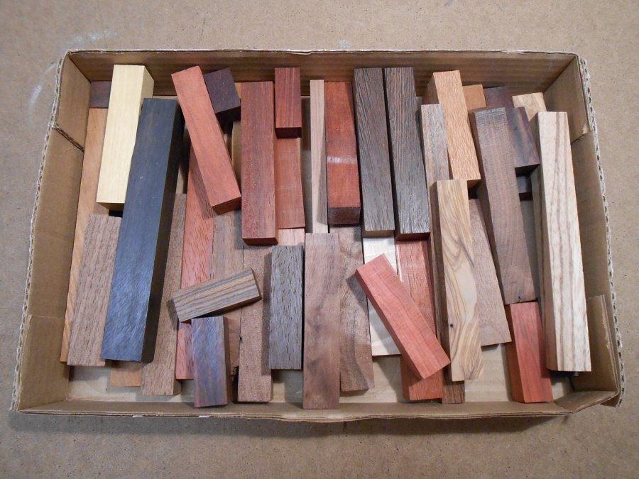

    Well, I tried to warn ya.
    All you really need is a mandrel, a means to hold it in your lathe head, a set of bushings and a sharp brad point drill sized for the given project.
    It's been nearly 20 years but as I remember, by row, left to right, top to bottom.
    No.2 Morse taper mandrel adapter, fixed size, set screw type. Cutter to square off, deburr and trim a blank (with brass tube glued inside) to an exact length (7mm OD tube I think). I just trimmed blanks to length on a table saw with a miter gauge.
    No.1 Morse taper adapter with collet type chuck, basic mandrel installed. The threaded end is drilled for a live or dead center.
    Basic mandrel.
    Yet another basic mandrel.
    Two sets of bushings for different projects. Some sort of "tool" that helps press brass tubes on to the pen/pencil mechanisms (not needed as I remember).
    Two more sets of bushings. "Bushings" are slid on the mandrel at each end of the wood blank and the whole stack is squeezed together and held firm with the mandrel nut. They serve as cutting depth guides and are the same diameter as the pen tips, caps etc.
    Woodness.
