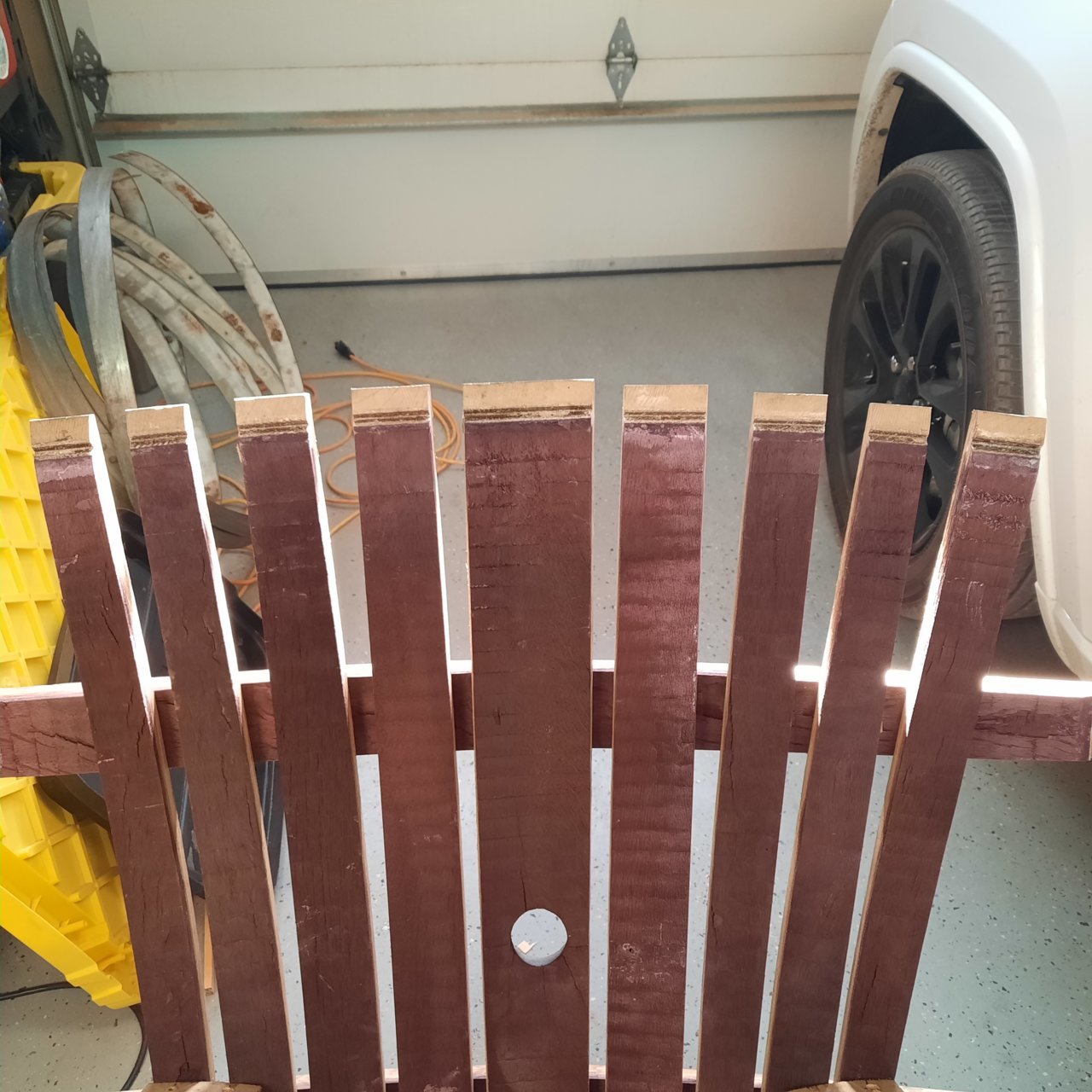

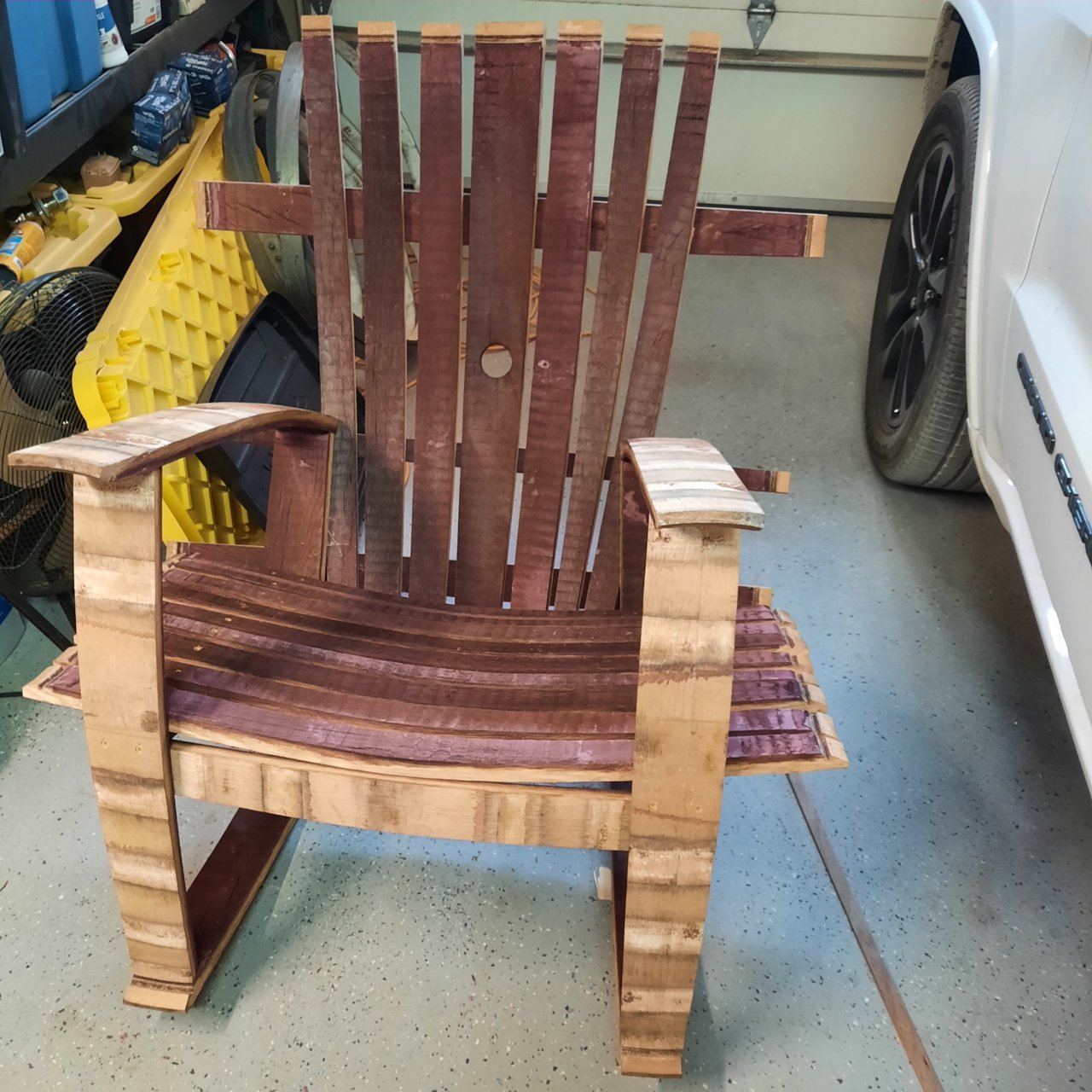

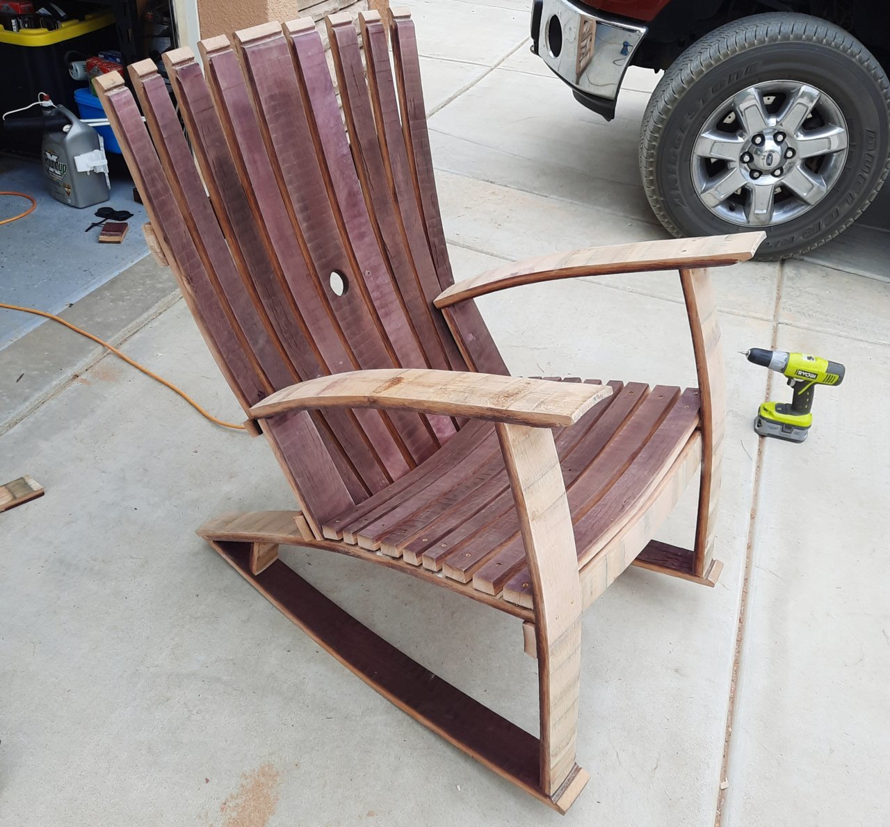

    Some stuff. Not a lot, just some.
    That's badass. I've got some staves left but not that many.

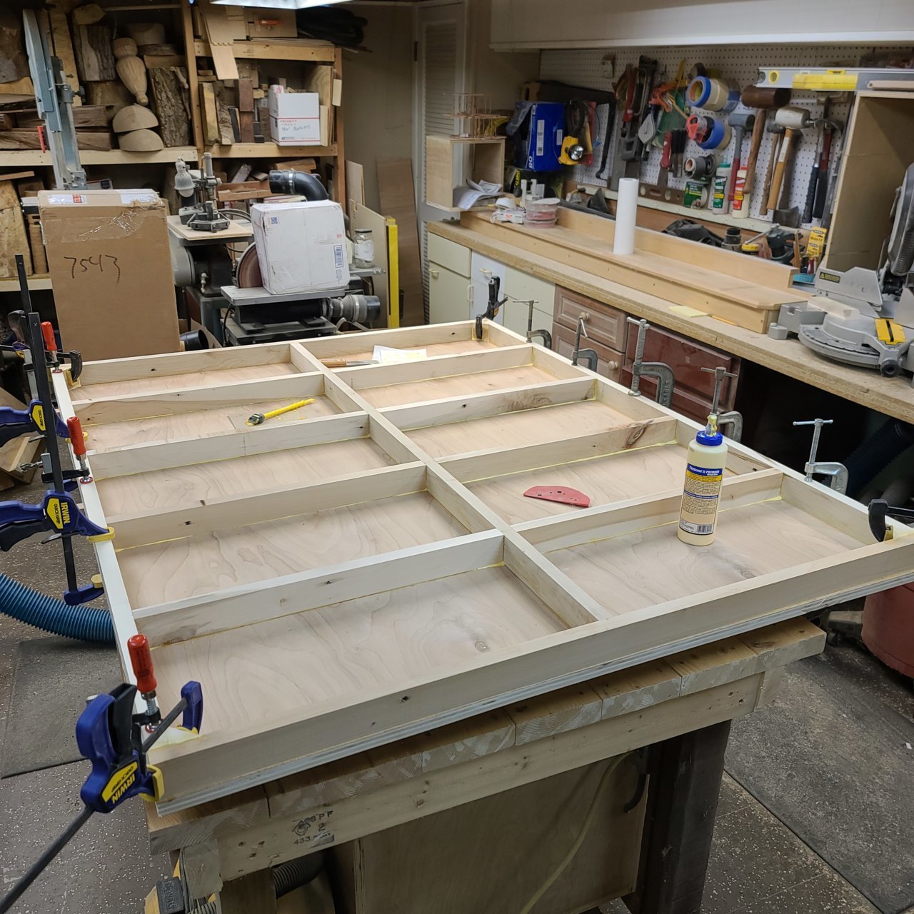

    Since I'm new to the forum and a wood worker I figured I'd post what I'm working on now. I just got a new table saw and the outfeed tables are crap, so I'm making new ones. I had one like this on my old saw but it went with it when I sold it.
    This is the bottom, all maple wood, and 3/4 maple ply for the top. It's 4'x5', it will also be used for assembly and finishing. I'll be working on the legs/base next. It will also get a white formica top laminated to it.

    It looks like the tabletop joins do not have any mechanical fasteners.
    Are you using only glue?

    Ah good eye! Yup, glue only on the top. Reason for that is at a later date I'll be cutting in two router lifts and I done want to hit any fastners.

    Makes sense.
    My Dad and I built my outfeed table 20 year ago. I screwed 2x4s together, and screwed down MDF for the top - making sure nothing was in the way of the extension slots to be routered into the top. I also covered mine with white laminate.
    Still works great after all these years.
    For my router, I just built Norm's Deluxe Table, slightly modified.

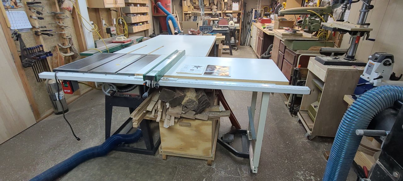

    My plan is to have 3 routers set up in the outfeed tables. I have one lift, need to get 2 more. I want to be able to make cabinet doors without having to change my set up and also to be able to use the tables for support.
    This was my old table saw and outfeed tables. The new ones will be much the same.

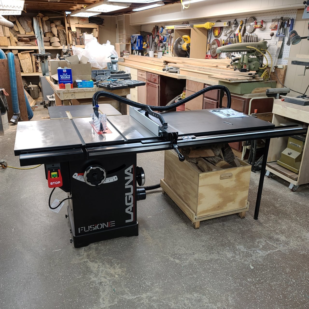

    This is my new saw, the tables are really cheesy in my opinion. But the saw is great!
    Laguna 3hp F3

    What's a saw like that go for?
  19. Jun 21, 2021 at 5:37 PM
    #7579
    woodtickgreg
    woodtickgreg Well-Known Member
    Jun 10, 2021
    #368186
    3,321
    Greg
    Michigan
    $2,500 and it took 2 months to get, takes way longer than that now! I had my old craftsman saw for 40 years, it served me well, but I did a lot of modifications and upgrades to it. This new saw is night and day over the old saw. Went from 3/4 hp to 3 hp, and it actually has a blade gaurd that's not a piece of crap and that I actually use! After 40 years I deserve this upgrade. It has a lot of great features. I've been upgrading a lot of my wood shop tools getting ready for retirement, doing it now while I'm working and can afford them
