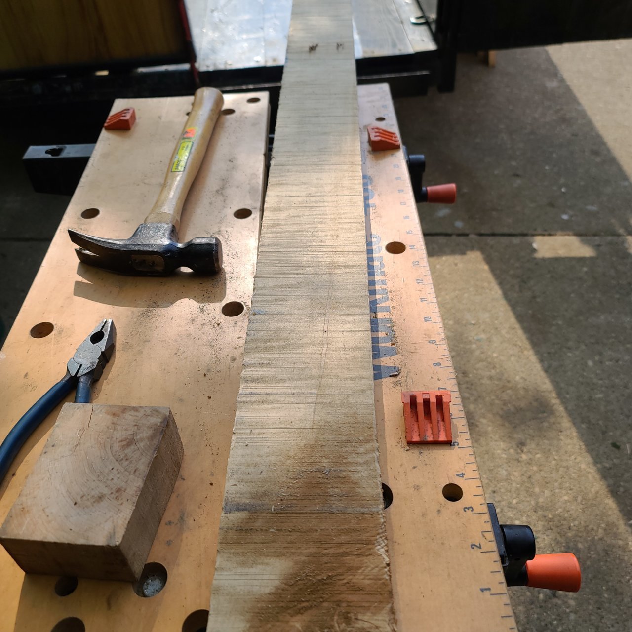

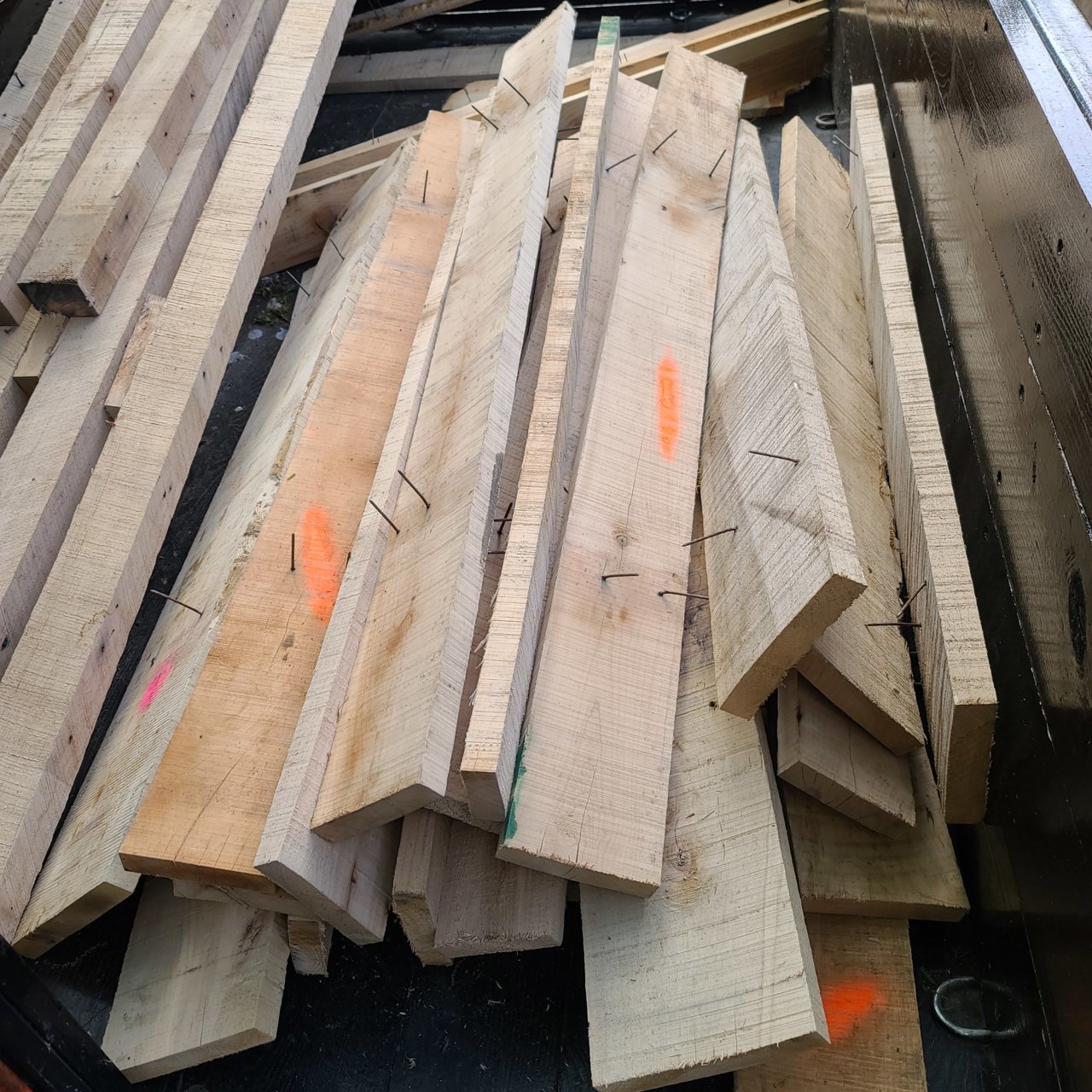

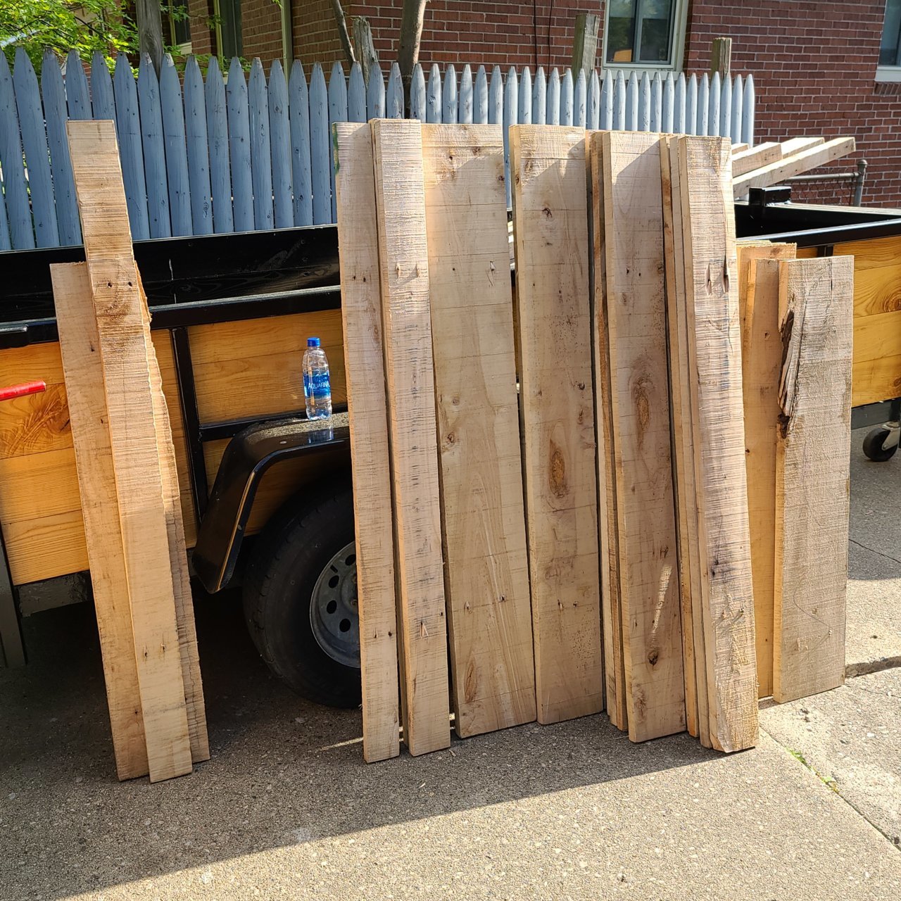

    This was the last find of pallets I took apart for the wood, all 5/4" maple, some soft, some hard, and some curly.
    This is a very curly board.

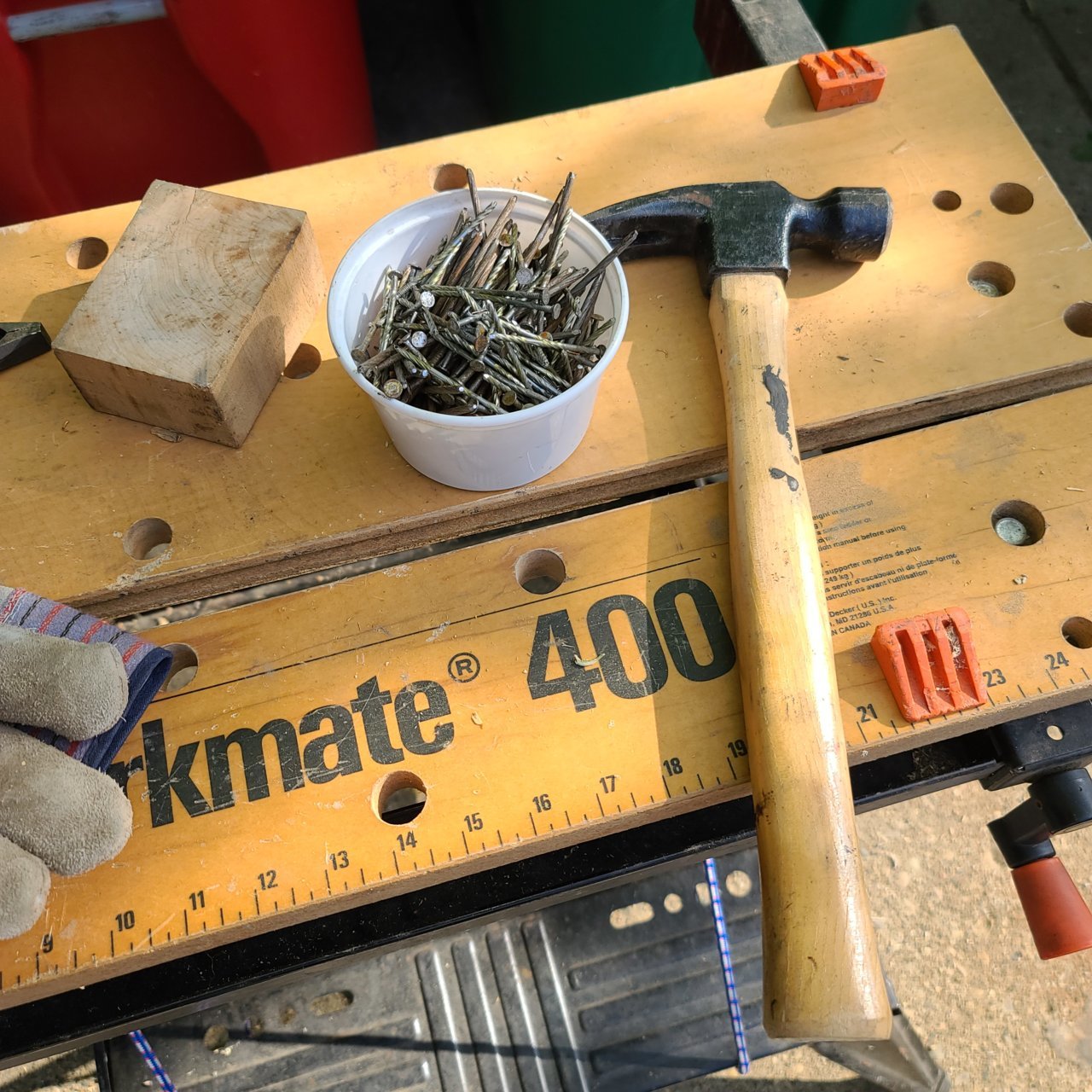

    Yes you have to pull some nails to get the free wood.
    Here's the finished goods, all maple,various widths.
    Stabbed em with a moisture meter and the read 13.4% best you'll get air dried here is 12% so these are pretty good. I'm using them in my outfeed table project.

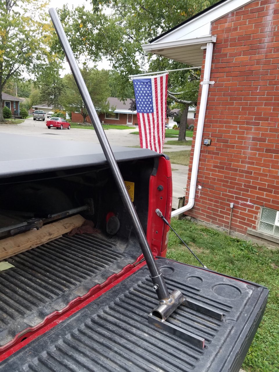

    This is a pallet breaker tool I made. Pops em right apart without damaging the wood. Even spiral ardox nails are no problem with this tool.

    Man, pallets in my neck of the woods absolutely do not look like that! Wood so ugly I wouldn't want it anywhere near my table saw.

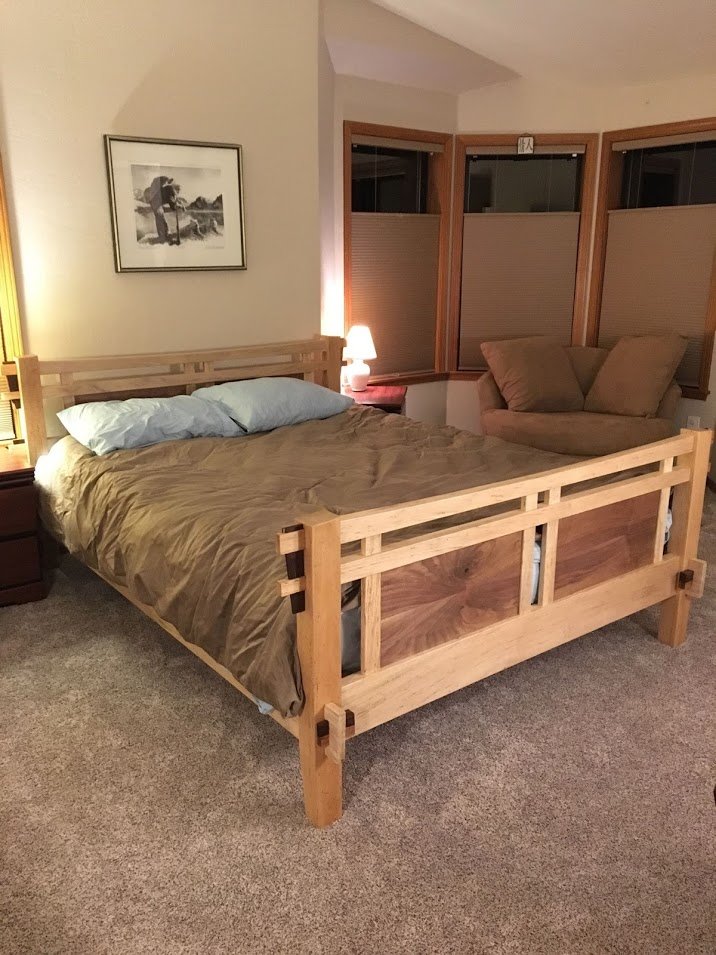

    So instagram links have the whole lot of pics on this japanese style bed, loosely based on a wood whisperer design.
    https://www.instagram.com/p/By6ByRNge08
    https://i.imgur.com/1rxLwLO.jpg
    All of the corner attachments are tusked tenons. No glue or nails, just a little tappy tap on the hammer and these connected like concrete. Might be too firm, @acupunk has kids running around! This was a really fun build.

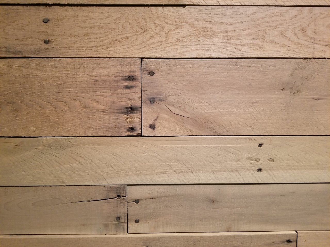

    I just cut my pallets apart with a sawzall and left the nail heads so it would look like they were what was holding the wood to the wall instead of the pin nails. :laugh:

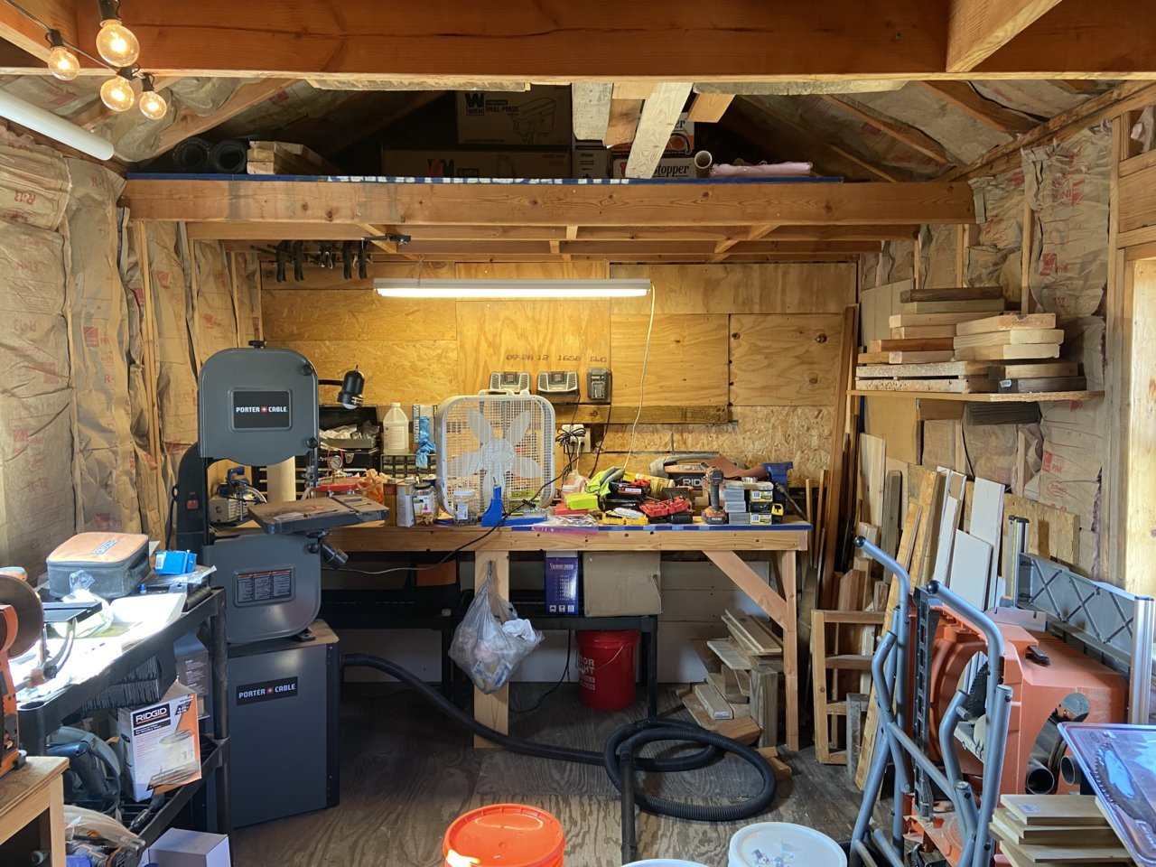

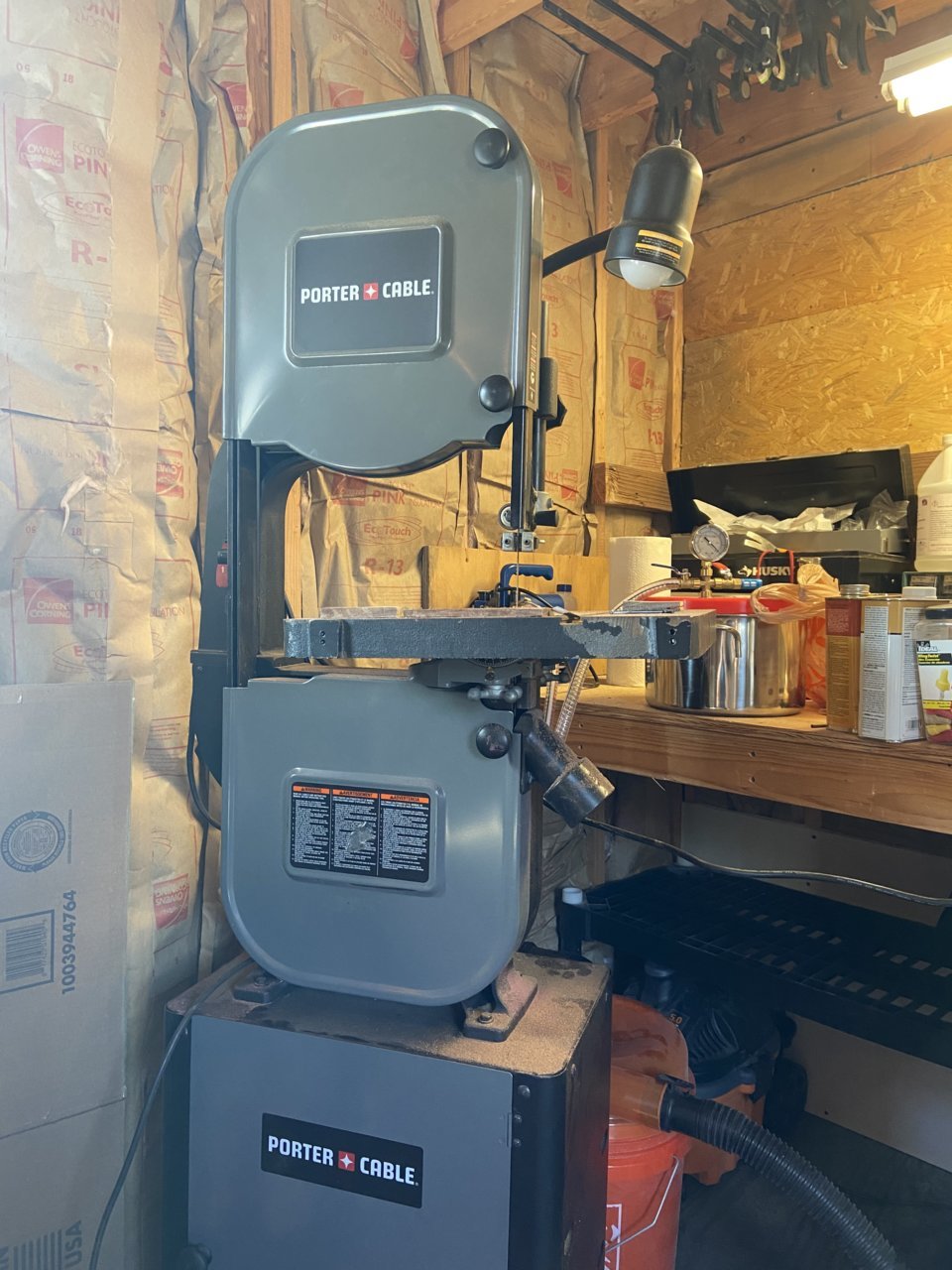

    Picked up a new to me band saw.
    I also insulated the crap out of my tiny shop. Thank for the recommendation to do that.
    pardon the mess. Working on building some selves.

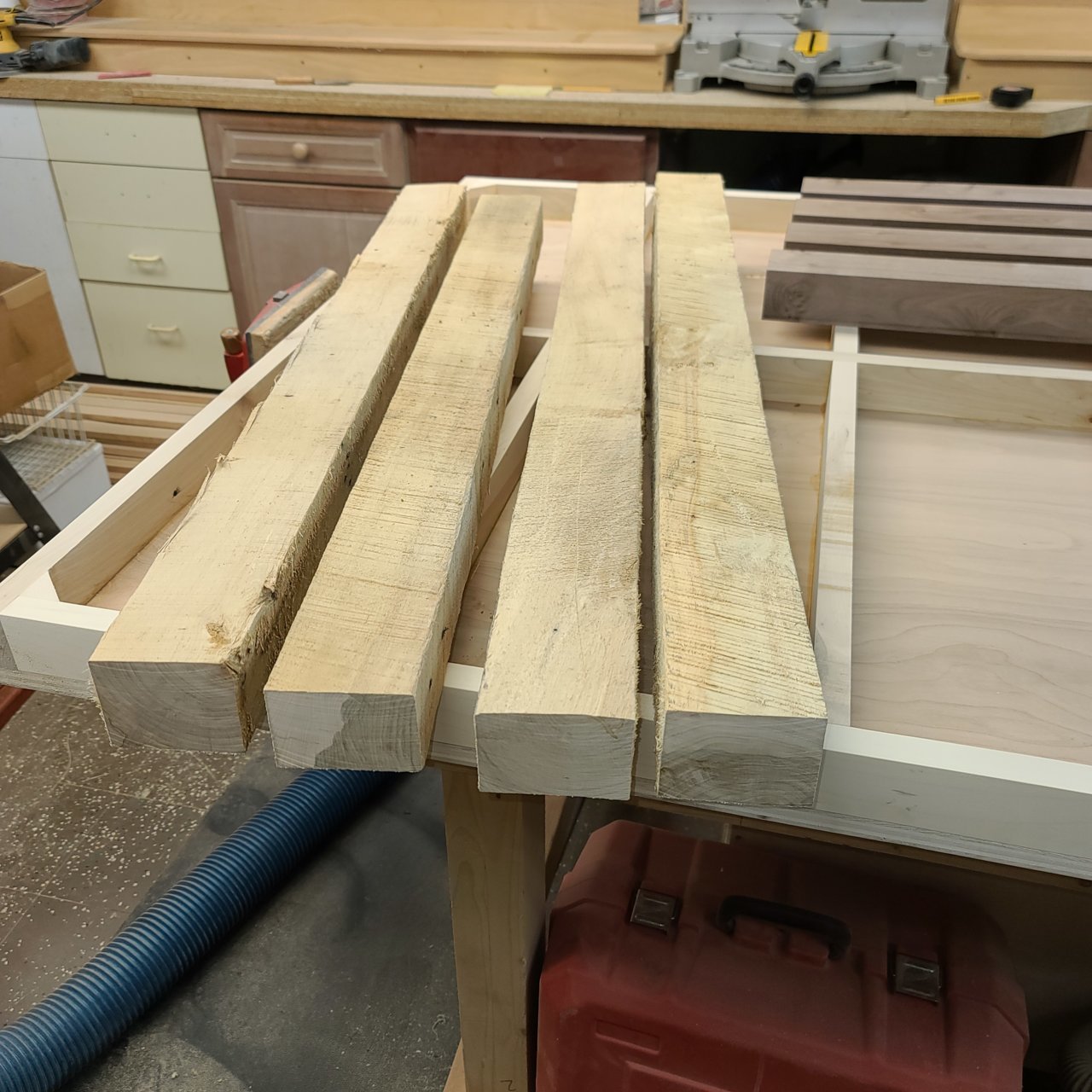

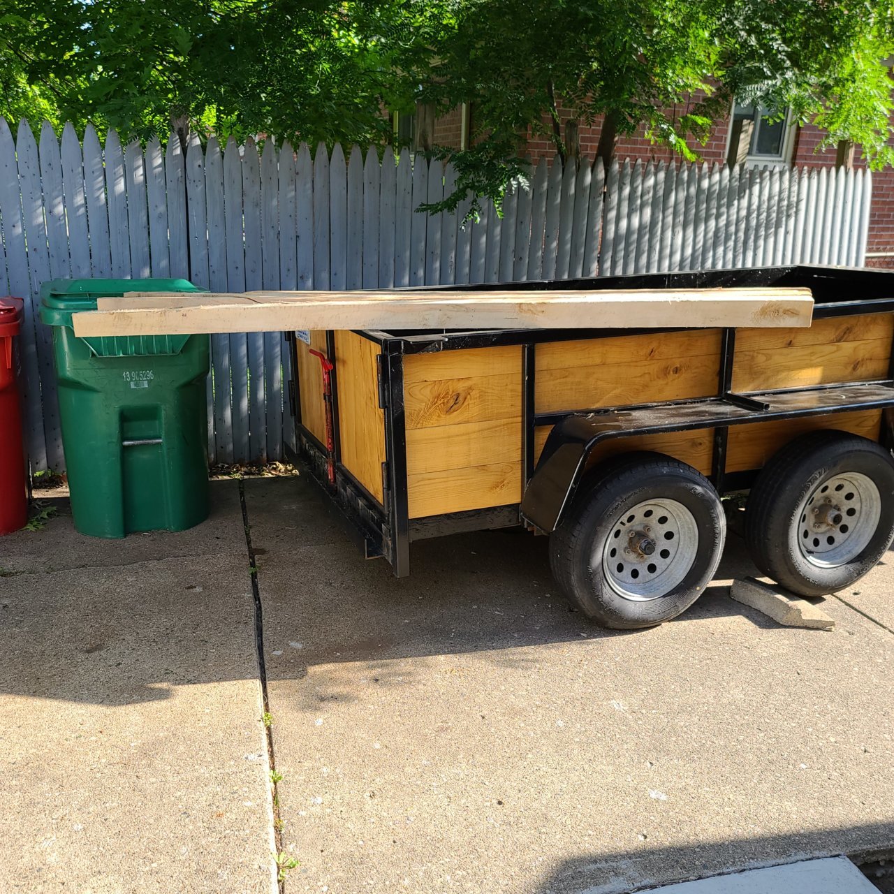

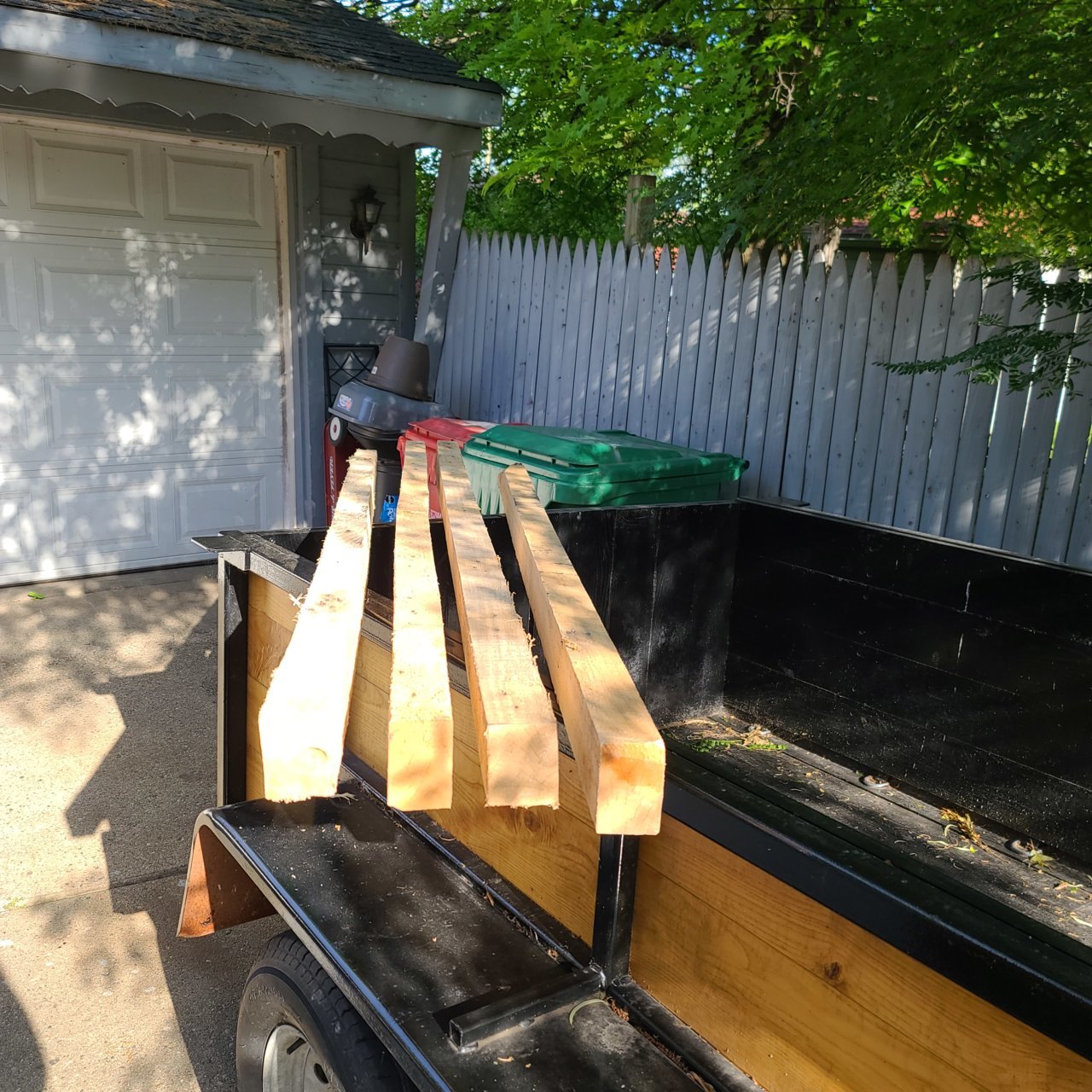

    Dug some more maple pallet wood out of the garage and carried it down to the basement shop. I need some more material for the legs of my table but didn't have any more walnut that I wanted to sacrifice, but I have maple!
    These boards have some defects that I'll cut around but I think I can get what I need out of them. The defects will go to the backyard fire pit.

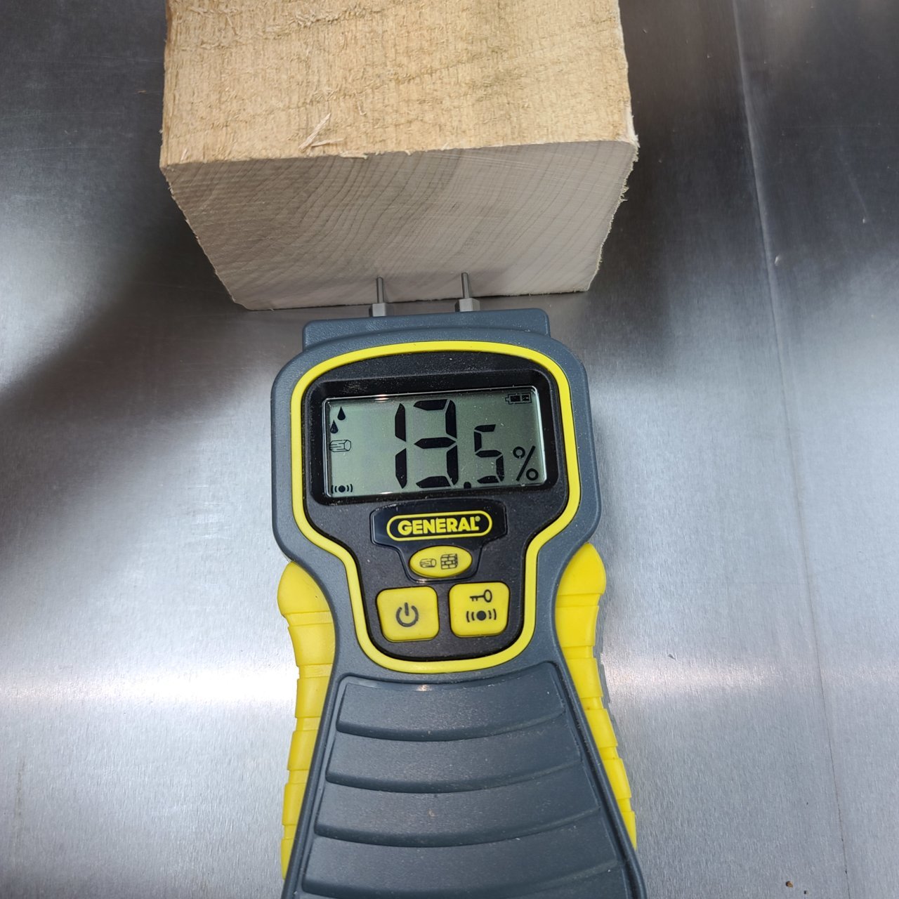

    Fresh cut in the middle reads 13.5%, I like 12% Around my neck of the woods but this will work fine.
    I got the 4 boards I needed out of them. Next I'll run them through the jointer and planner to square and dimension them.

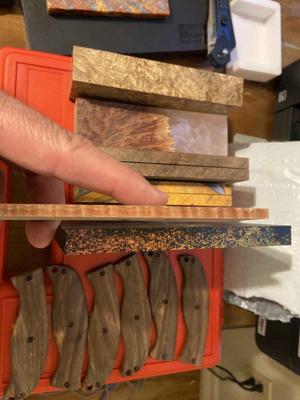

    I need some advice on bandsaw blades. I’ve got small stock that I need to cut down to 1/4”-1/8” thicknesses. The stock is mainly stabilized hardwoods. What do you guys recommend for blade width, tpi, ect

    So you're resawing it into veneer-ish thicknesses? Low TPI for that, I have a 1" blade I use. Might be 1&1/4", came with my bandsaw. But some guys like them thinner to do the same.

    Yes. Resawing to a veneer-ish thickness.

    I dont go for those carbon toothed bandsaw blades. But for resawing the lower TPI the better. That's some gorgeous wood there by the way!

    Re pallet wood...
    I've dealt with pallets for the past 36 years. The wood they're made from varies widely. I've seen some that looked as if they were made of balsa, and some that looked like mahogany. What you have to worry about is what treatment method -- if any -- was used. I mostly see them either stamped HT (heat treated) or not stamped at all, but then again who know what was shipped on them and what environments they may have been in. I've seen other stamps too.

    That's my main concern. I have no desire to aerosolize any of that mystery wood and who knows what contaminants. Make's me a stick in the mud, I know. I would rather overpay for it at the lumber store.

    All the pallets I salvage have had nothing more than steel on them. Ht just means they have been heat treated to kill bugs.

    That's gorgeous. Amazing work.
