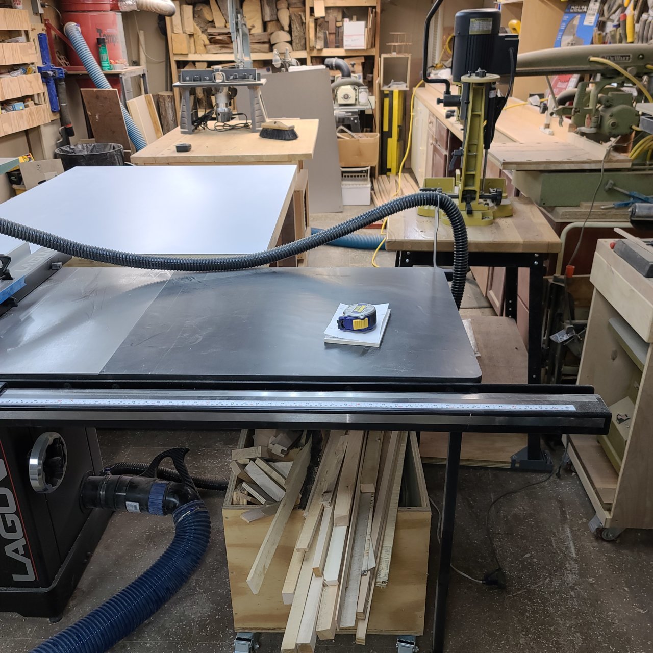

    Well after doing some measuring I determined that I needed one more board, so I dimensioned it and formed a tongue on one side.
    Then I cut the corners off on one of the boards to clear the legs on the bandsaw.
    This is what I was going for, 1" overhang all the way around. There's 2 boards in this pic just set in place.
    I will pre drill all the screw holes oversize on the shelf boards and won't use any glue to fasten them. Hopefully that will allow for some wood movement since this is solid wood and not plywood.

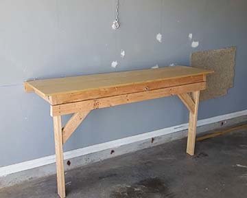

    Made this a few years ago at my old house. used scrap wood and one (yes, only one) trip to Lowe's

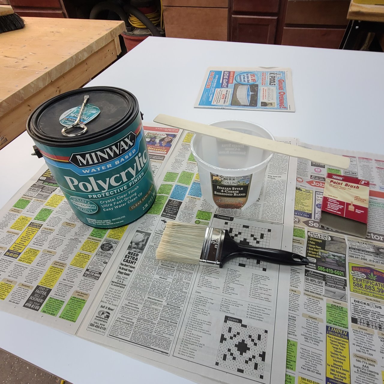

    Today I got all the tongue and groove boards screws down I drilled all the holes in the boards oversized to allow for wood movement when the boards shrink, and they will, humidity is at 74% in the shop. That's the highest I've ever seen the humidity and its been like this for over a week, I have a basement shop.
    Then I sanded the shelf down. If I had a dollar for every time I hit my head on the table top installing the boards and sanding them down, lol.
    I'll seal the shelf up with a few coats of wbp.
    Looks pretty cool with the first coat on. To bad you won't see most of it after I pile a bunch of jigs and stuff on it, lol.
    The tongue and groove made this shelf very strong even without a center support
    This part of the project is almost done. Next will be the smaller table to the right of the table saw. When that's done I'll route the grooves in the outfeed table.

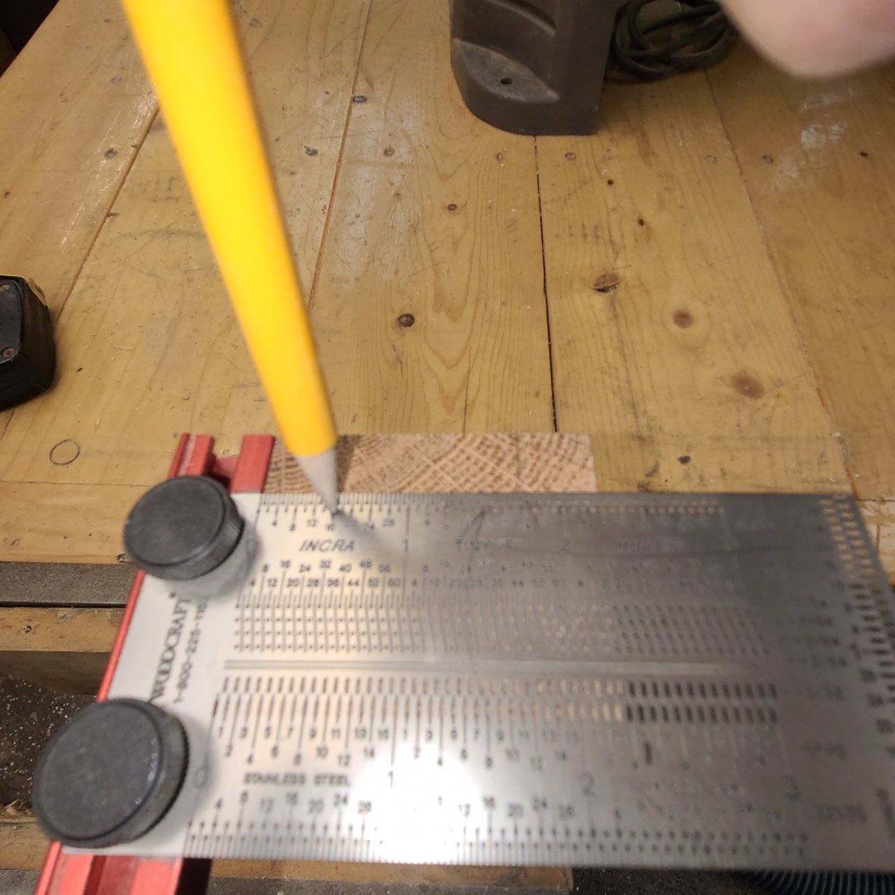

    The framework will be the same for the side table as the outfeed table, 1" maple glued together, no mechanical fastners. 2 pieces are in the clamps. While I was waiting for the glue to set I milled up the oak for the legs.
    Then I did some layout for the tennons.
    Tennons will have a 1/2" shoulder.
    Finished up the layout with the mortices.
