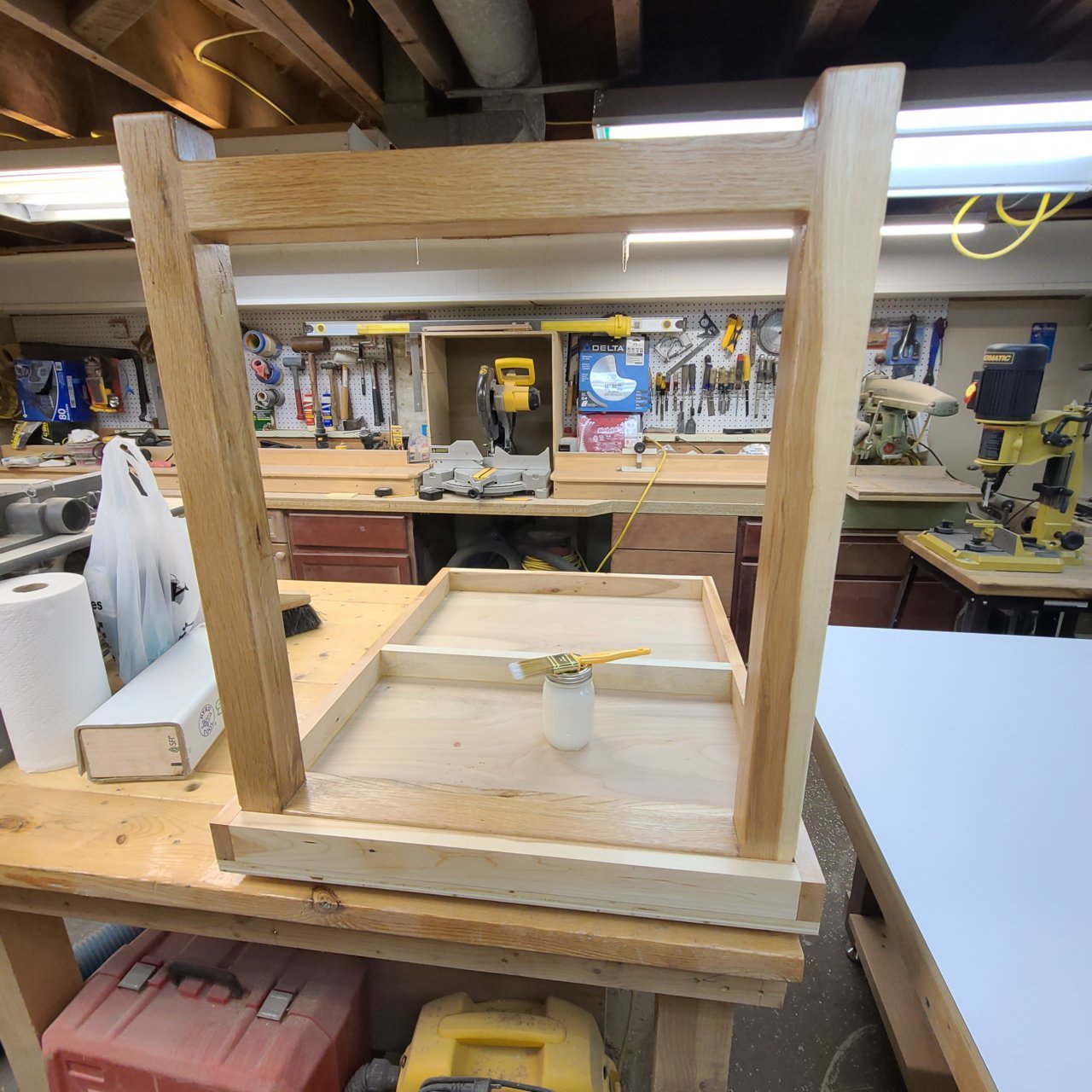

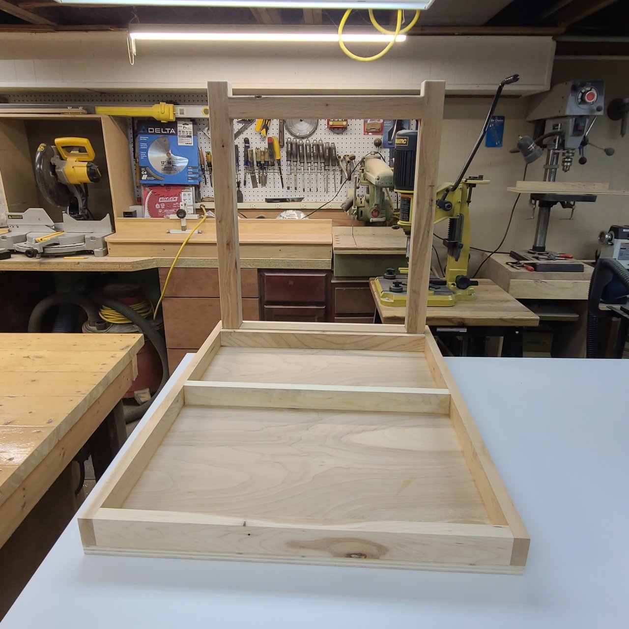

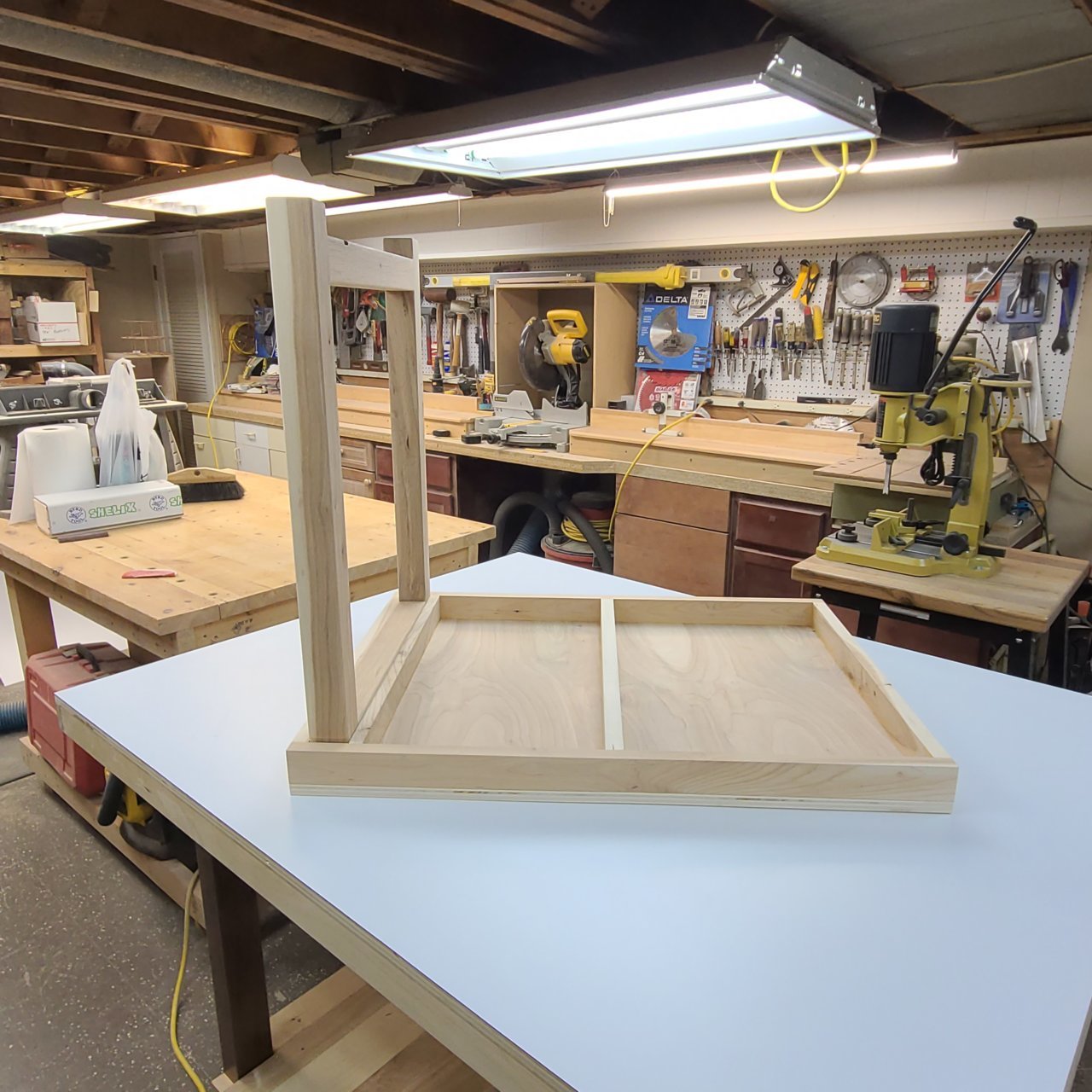

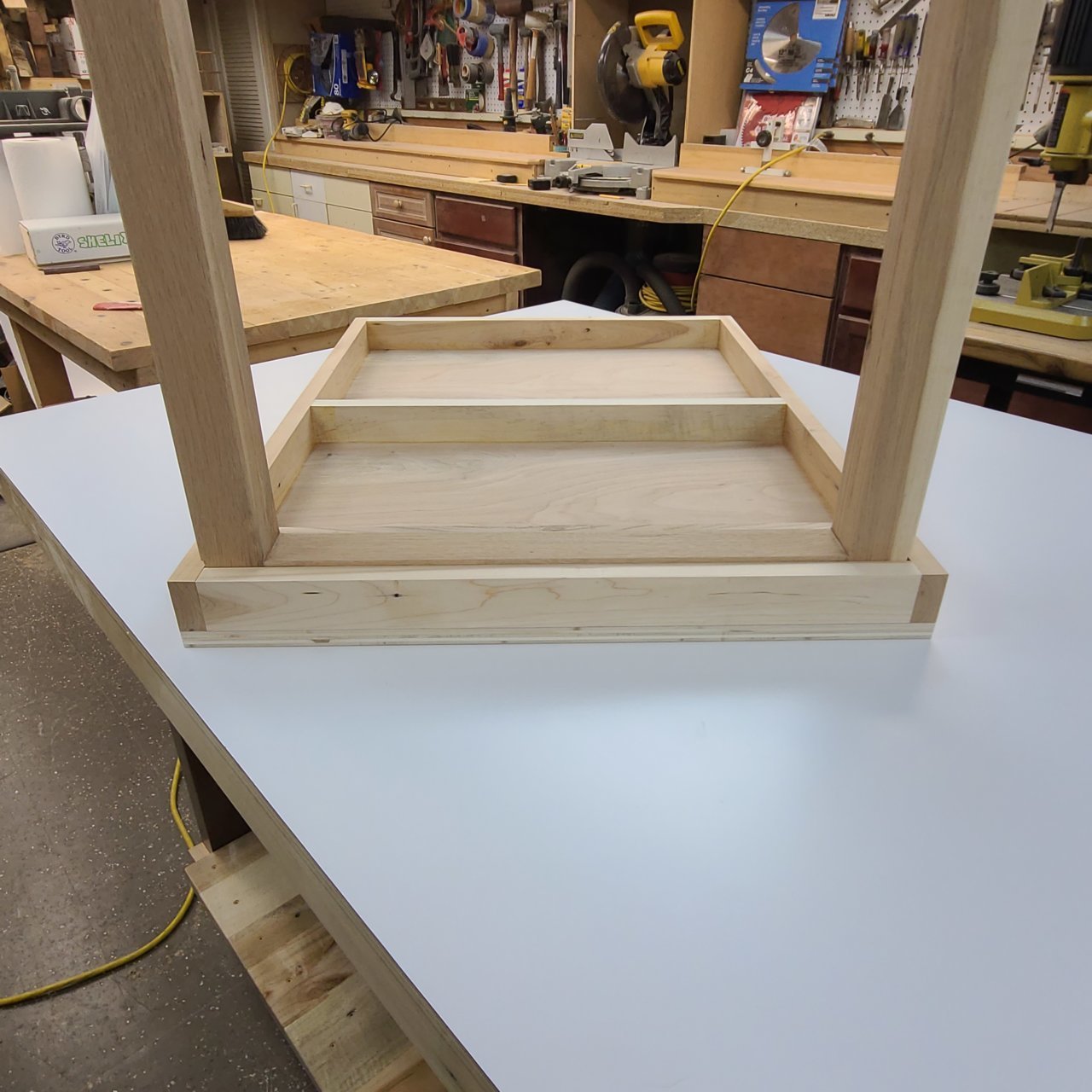

    After changing the oil on my taco I got some shop time today.
    Rounded over all the edges on the legs and test fit them in the pocket on the top.
    I trimmed about 1/8" of the sides of the legs to make it easier to get in the pocket, this will also allow for wood movement.
    The legs will get a few screws right in the center section and no glue, this should also allow for wood movement.
    Brushed on a coat of wbp, maybe do 2 more.
