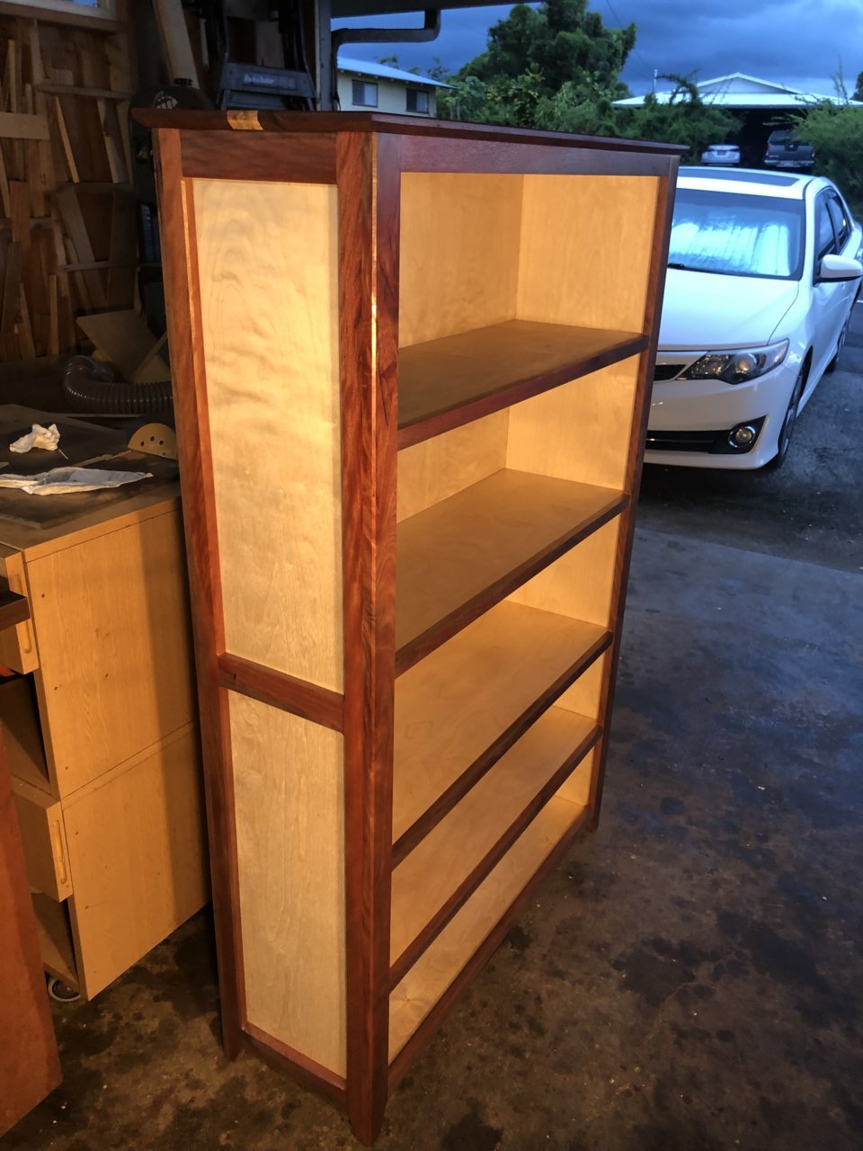

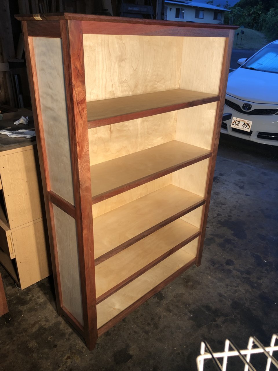

    Totally screwed up on this book case cause the smallest shelves where supposed to be on the top and the bigger on the bottom, but past a point of no return. Lol

    I know how that goes...

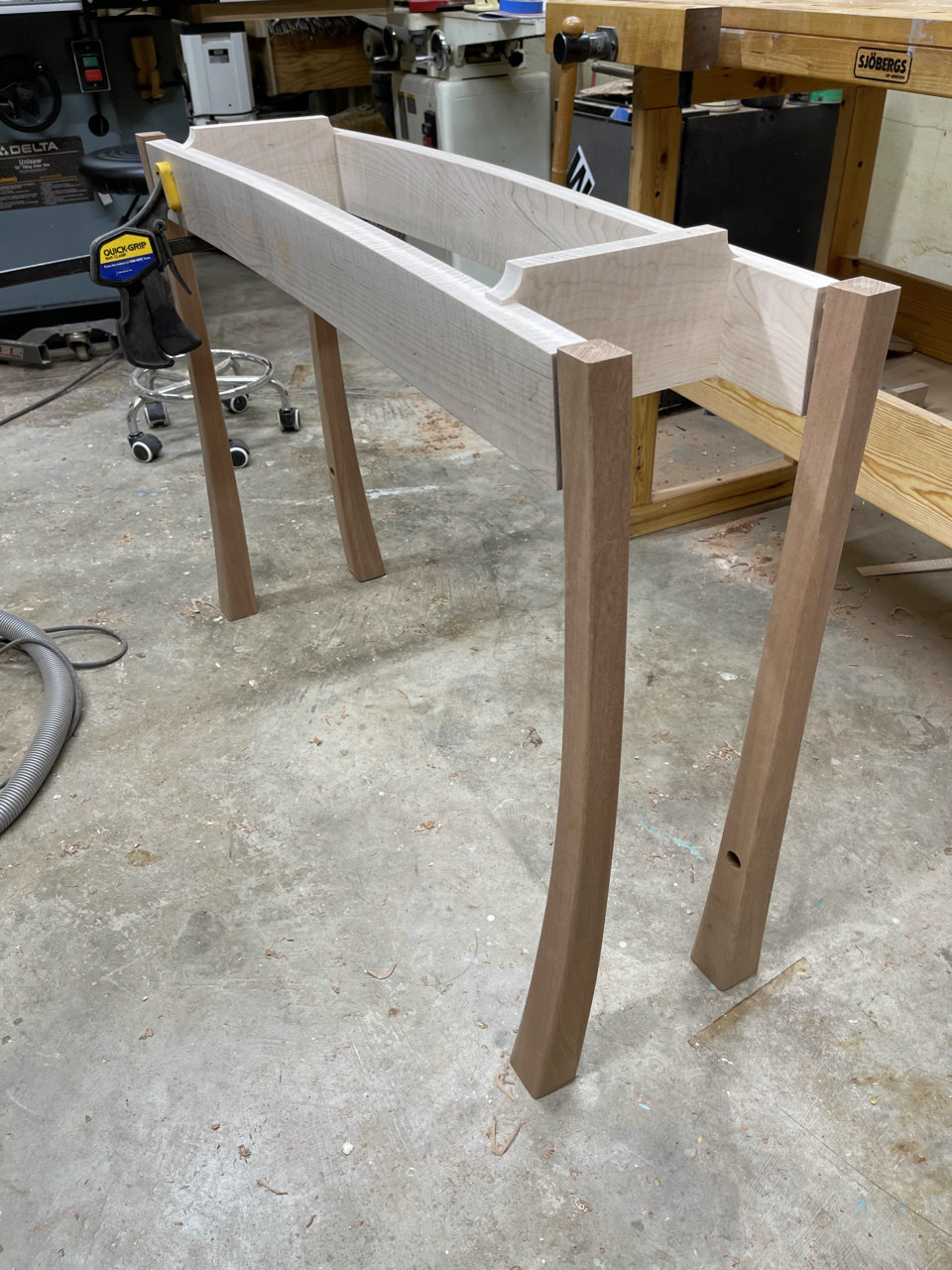

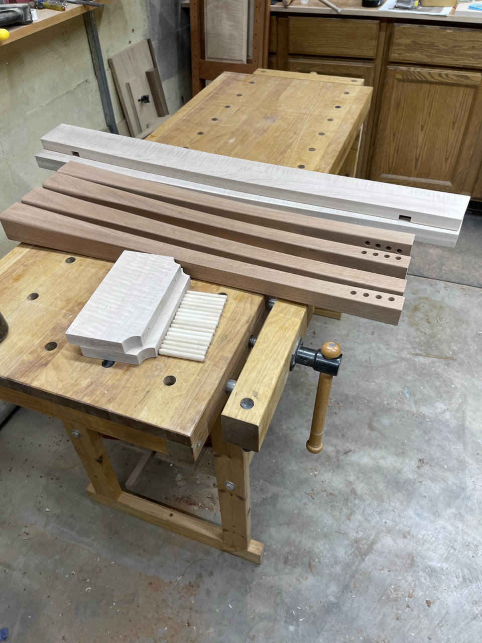

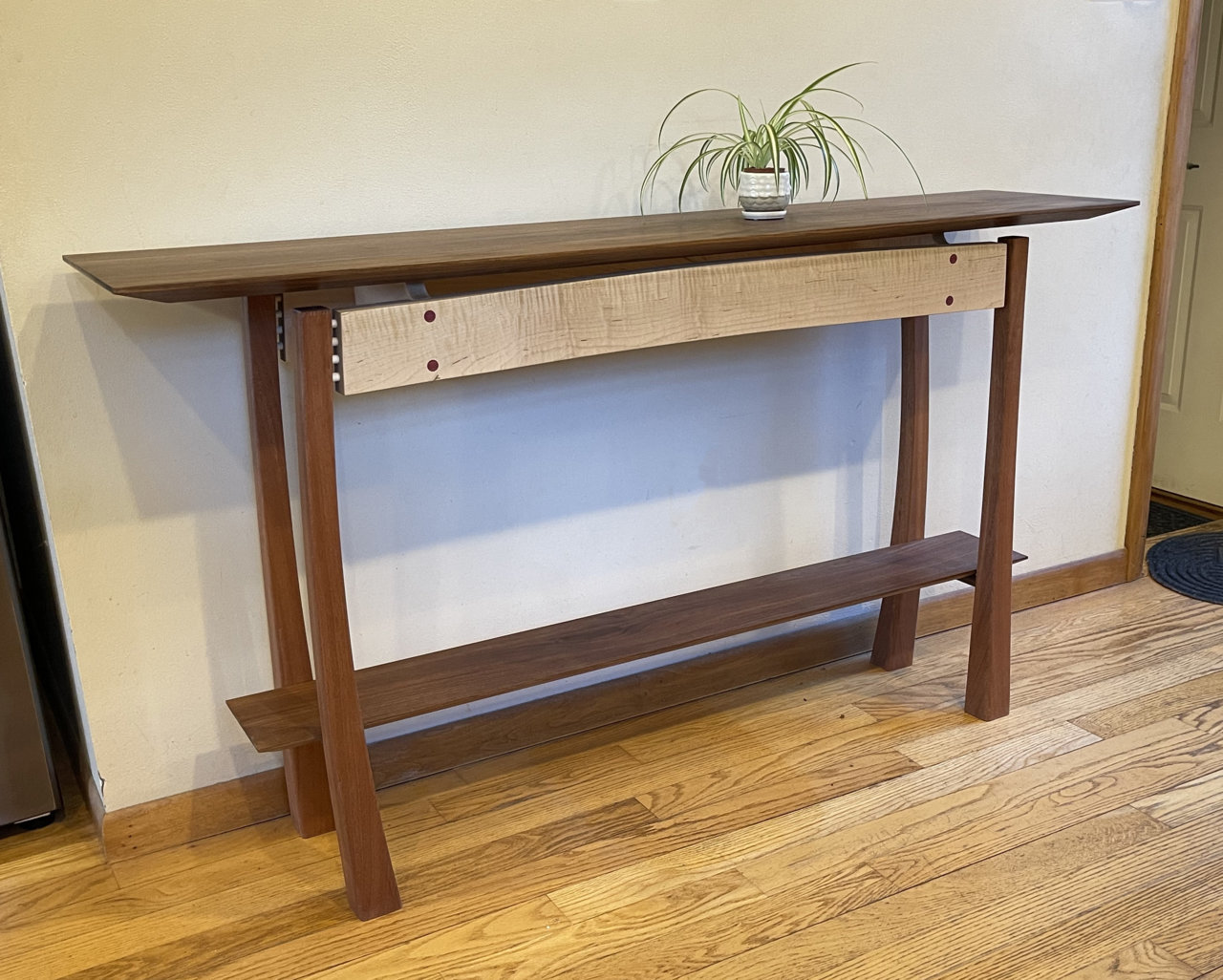

    Working on a table for a neighbor. After a week of cutting drilling and sanding, the test fit looks good. Ready to glue up tomorrow.

    Still looks good!
    Love the contrasting colors!
    That's going to come out great!

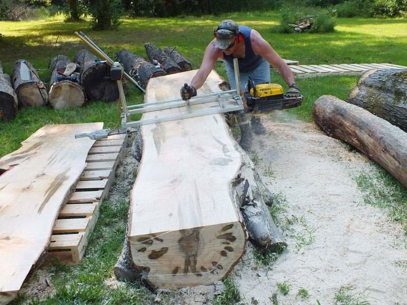

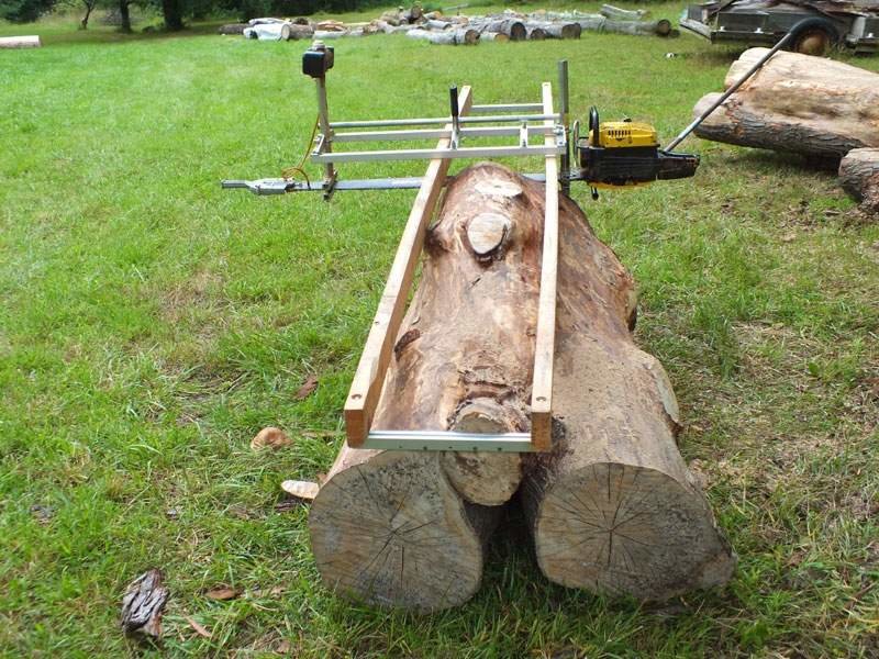

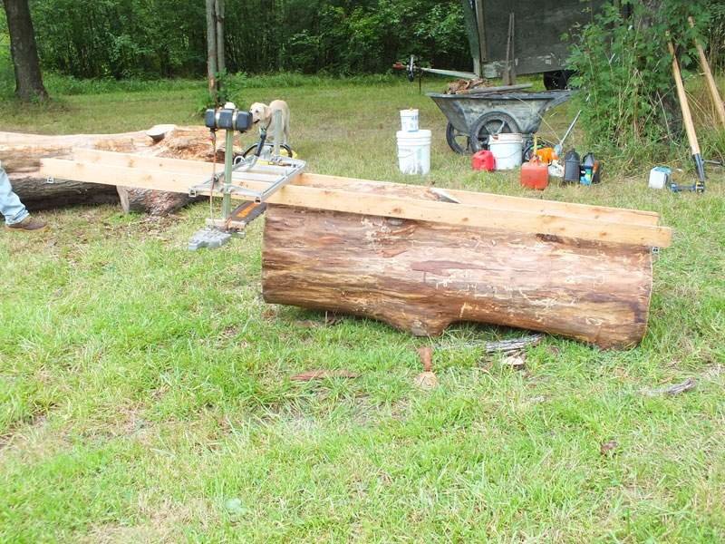

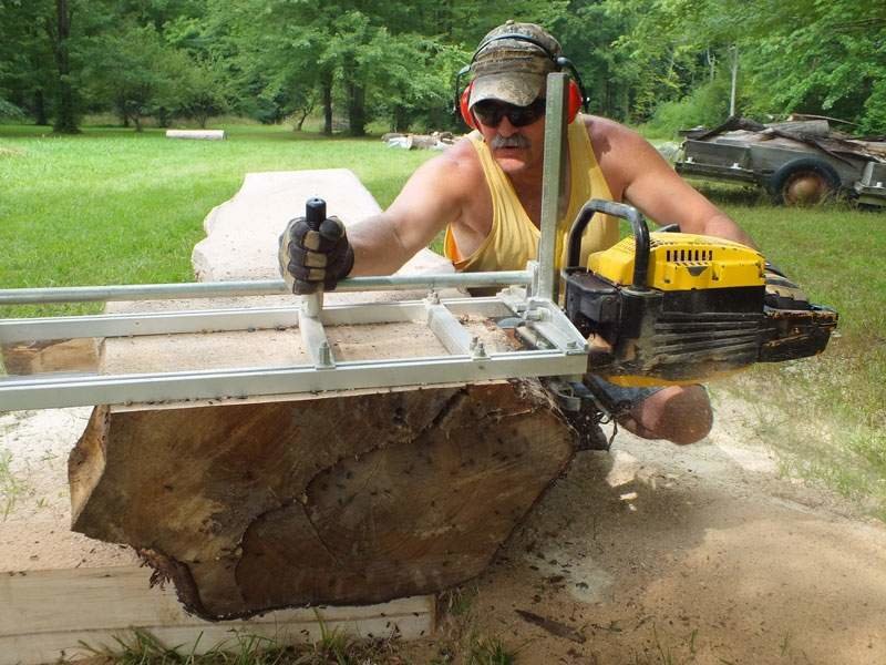

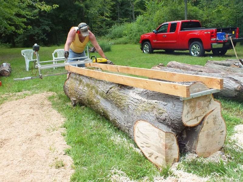

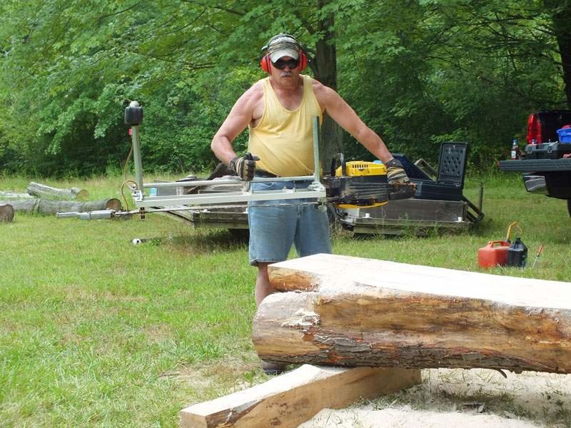

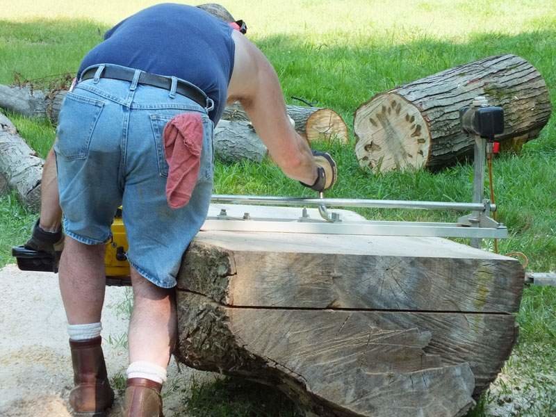

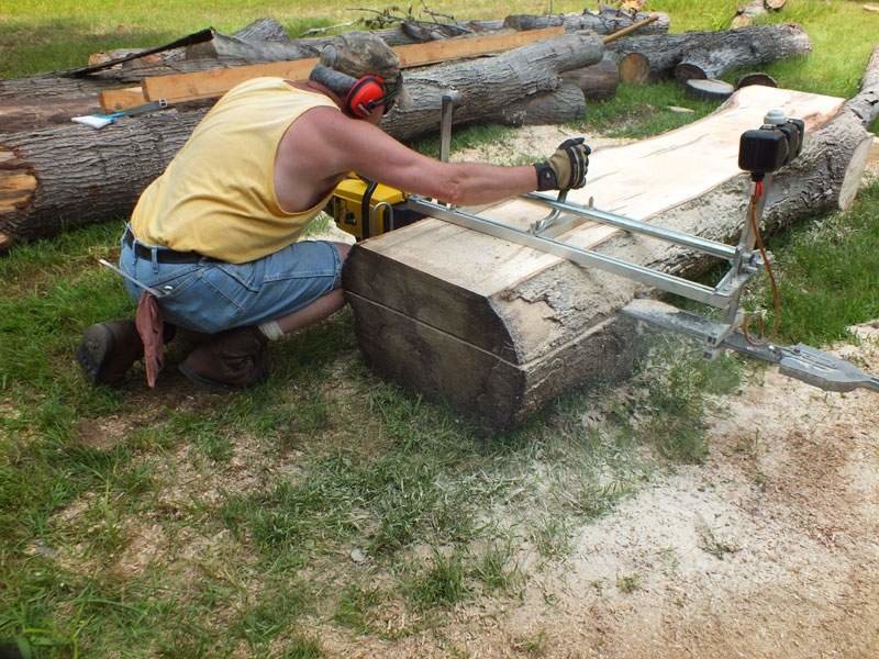

    I have done some chainsaw milling. Here's some teaser pics.
    milling-day-3-009.jpg milling-day-3-007.jpg milling-day-2-006.jpg milling-day-3-022.jpg milling-day-2-007.jpg milling-day-1-018.jpg
    A 5" thick maple slab to be cut up into bowl turning blanks

    This is exactly what I want to do... What size of saw are you running?

    This is an old McCulloch 100cc chainsaw, no longer made. And I have since wore it out and upgraded to a 125cc Husqvarna, I also have a 90cc Husqvarna that I'll be rigging up with a shorter bar for smaller logs.

    Are you running bar oil in the auxiliary tank on the end or something lighter like vegetable oil?

    I run bar oil, good quality oil I get from my local tractor supply at a reasonable cost. Sometimes in the winter when it's cold I'll mix a little diesel fuel or kerosene in the bar oil so it will flow. Milling is really hard on bars and chains so you need lots of oil and don't cheap out and buy crappy bar oil. I'm just a hobbiest myself, but chainsaw milling has provided a lot of lumber that I otherwise couldn't afford to buy. It allows me to do wood working. In fact it gets me stuff that you can't buy from your local hardwood supplier. 3' wide slabs of whatever species you want to mill. Yup I get the regular stuff like oak, maple walnut, etc. But I also get elm, apple, locust, box elder, etc
