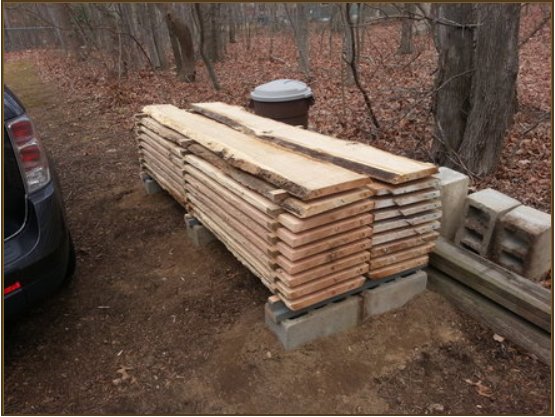

    Would you stack your wood like this?

    I would also put a few cinderblocks on top.

    to keep them all from twisting as they dry right?

    Yeah, the bottom boards have the weight of the top ones. The top needs to be weighed down too. I have 6 blocks on each of my stacks.

    Good idea. I forgot about that. I've used ratchet straps too.

    That's a really good idea ... you can "control" the pressure

    All ideas above are good ones, also cover the top and keep the sides open for air movement. I stack and sticker my boards in my garage for drying. I also plug in a fan for the first few weeks to keep the surfaces dry and to prevent mold. In the beginning when I first started milling and drying lumber I had some mold issues and that's why I use the fan. But the mold really wasnt damaging, it was just on the surface of some of the really wet boards and it planed right off in the first pass.
    Trees milled in the spring will be very wet, less after the leaves have dropped in the fall, and winter is always a good time to harvest logs. Me I just take em when the opportunity arises, like when a neighbor removes a tree I ask for the log. Most small tree companies will be happy to give you the log. And some tree companies will sometimes deliver the log for you so they dont have to pay for the disposal of the log. Some tree companies process the wood for firewood so they keep everything. Most of the time I get my logs for free. My motto is wood is everywhere and it's free, you just have to know where to look for it.

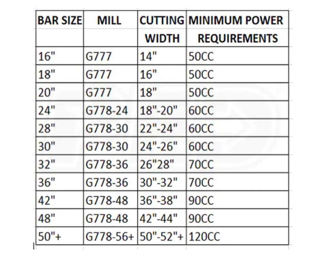

    @woodtickgreg
    So.. let's talk about saws.. obviously I'm just starting out on this adventure but I see that Stihl saws are around 79cc max (there may be higher ccs available but nothing local) - that was on a MS 661 C-M with what appeared to be a 36 inch bar.
    Is this something I should consider or do I absolutely need the higher cc saw?

    You can get by with that but if you can afford it go as big as you can. Milling is completely different that cutting logs, it's insanely hard on the saws. A 79cc saw will be very slow going and it will get stressed. Go to a good saw shop. Keep in mind that all manufacturers have commercial and consumer models of similar saws, they are night and day different as far as durability. Most consumer saws will have plastic crank cases and the can't take the heat that milling will create. With a 36" bar you will run that saw full throttle for about 10 minutes straight under a full load. It's a saw killer! So go big as you can. The ms660 will work but your going to have to pay attention to your chain angles and type of chain you run. And make sure it's a commercial model!
    Edit: and I just looked at the model you listed, fuel efficiency is not something you want when milling, you want it to run just short of being rich, not lean. Try and find a older used ms660 or even better yet an 880. But the 880 is tough to find used, and pricey.

    I just saw this for the Granberg Mill it's the Mark IV 36.

    That would be a bare minimum suggestion. Like I said, it will do it but put major stress on the saw powerhead and be very slow. If your not in a hurry and just doing it as a way to get wood you'll be ok. But anybody you talk to that has been chain saw milling for any amount of time will tell you to go as big as you can with the powerhead. This is one instance where more is definitely better.

    Yes sir! I totally understand that! I'm just not having luck finding the bigger saws locally...I'm the kind of person who likes to put their hands on something before I pay for it if I can.
