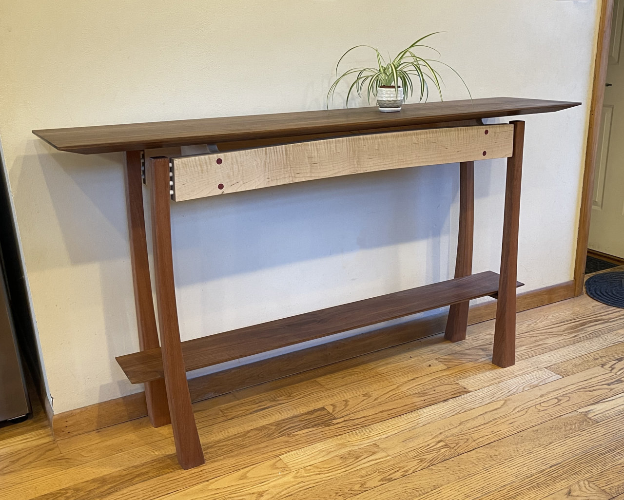

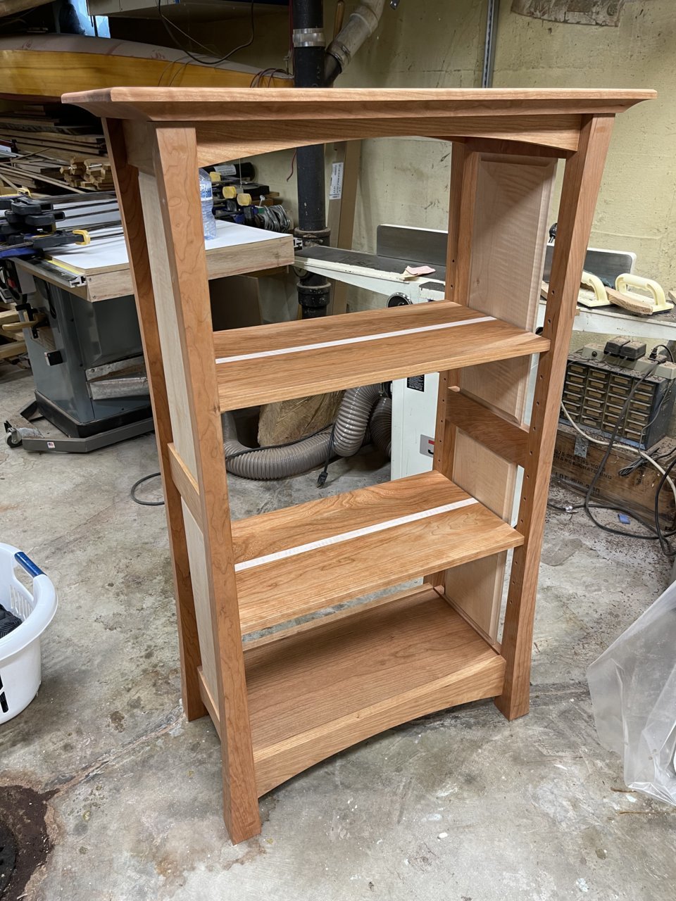

    My understanding is that it’s not possible due to how it was designed, to attach a true Irving knife to an older saw. There are a few aftermarket options that work somewhat, although I’ve never tried any of them.
    I had that very saw for 25 years and it did good work and I never had the kind of kickback that you are trying to avoid.
    That being said, upgrade to a cabinet saw as soon as you can. I feel that I wasted a couple of decades thinking I just had no skills, then on a lark, I bought a Unisaw, now I’m making fine furniture that I never thought I had the skills for.

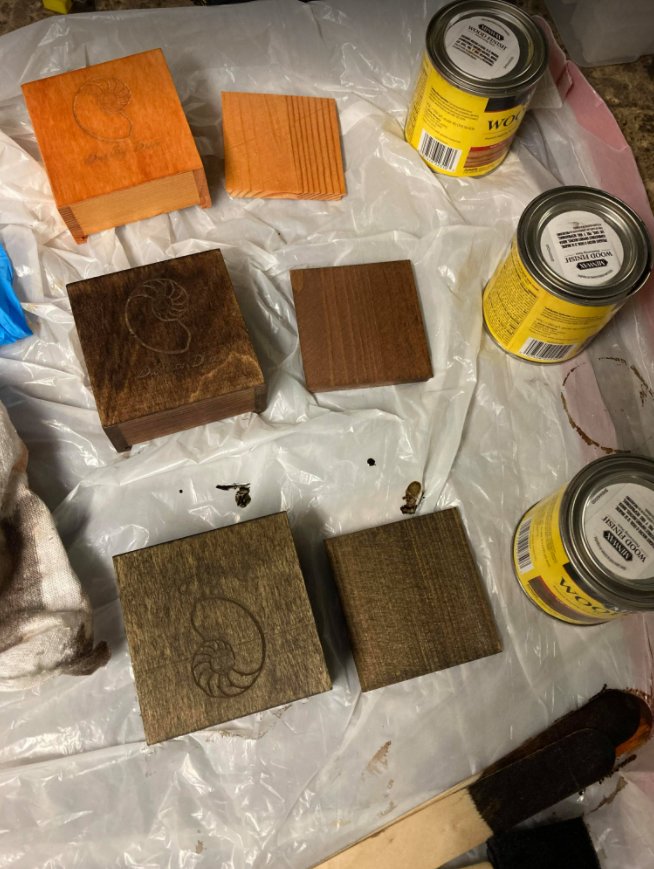

    Wanted to pop in and say thank you guys for the advice when I was working on my dice boxes! I got the first one done last night; it has some flaws in the painting on top, but I needed one for an upcoming giveaway so it'll be perfect for that.
    I ended up going with minwax and satin varnish. Finished the bottom with some felt.
    Bought 2 more colors to play around with. I'll have to see if these sell well enough to invest in more colors down the road.

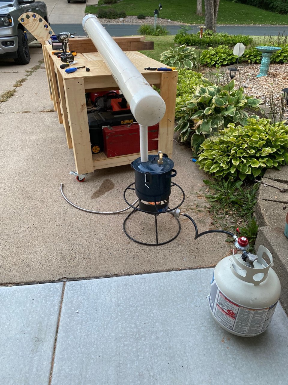

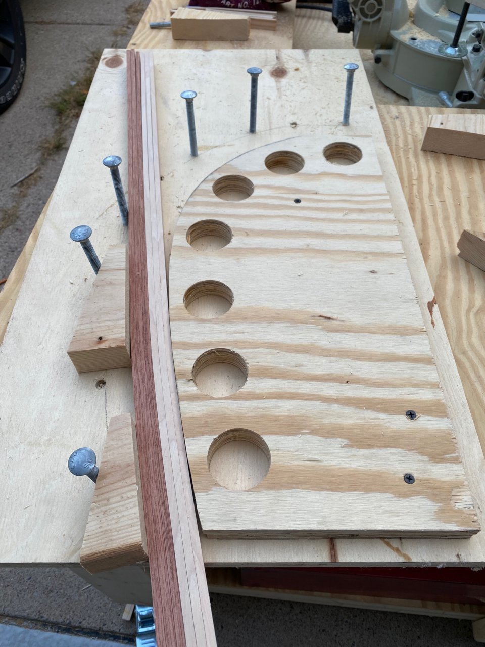

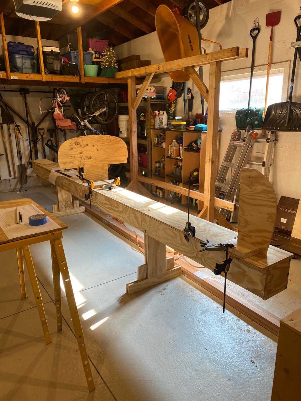

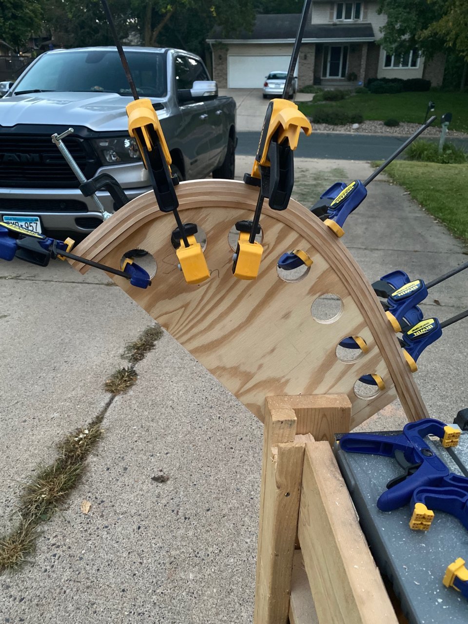

    starting a fall project in my garage, have played a carpenter for many years, and done a lot of finish work, but am currently undertaking a cedar strip canoe build that is a whole different set of skills. Ive got my table built, and my forms cut, now im learning ALOT about how to ruin expensive pieces of wood while steam bending.
    So far ive snapped a good amount of pine, hickory, and mahogany because i couldnt get things clamped up fast enough before it cooled off. The ones i did get bent had so much spring back after i removed them from the clamps they snapped when i tried to reclamp them gluing them uRebuilt a new jig that should allow me to move quicker. Picked up a big chunk of ash to cut up and try out also.
    If anyone has any tips for steam bending laminated wood pieces, im all ears. Current plan is to soak my 1/4" strips for a couple days, then steam them for 20 minutes, then haul ass to get them clamped and wedged in my latest form.

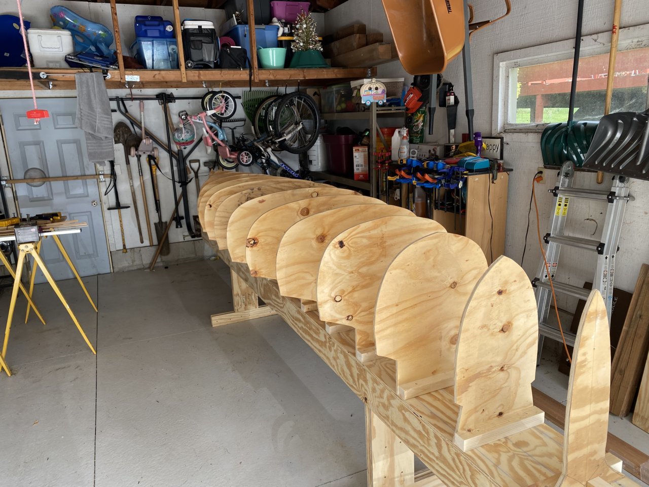

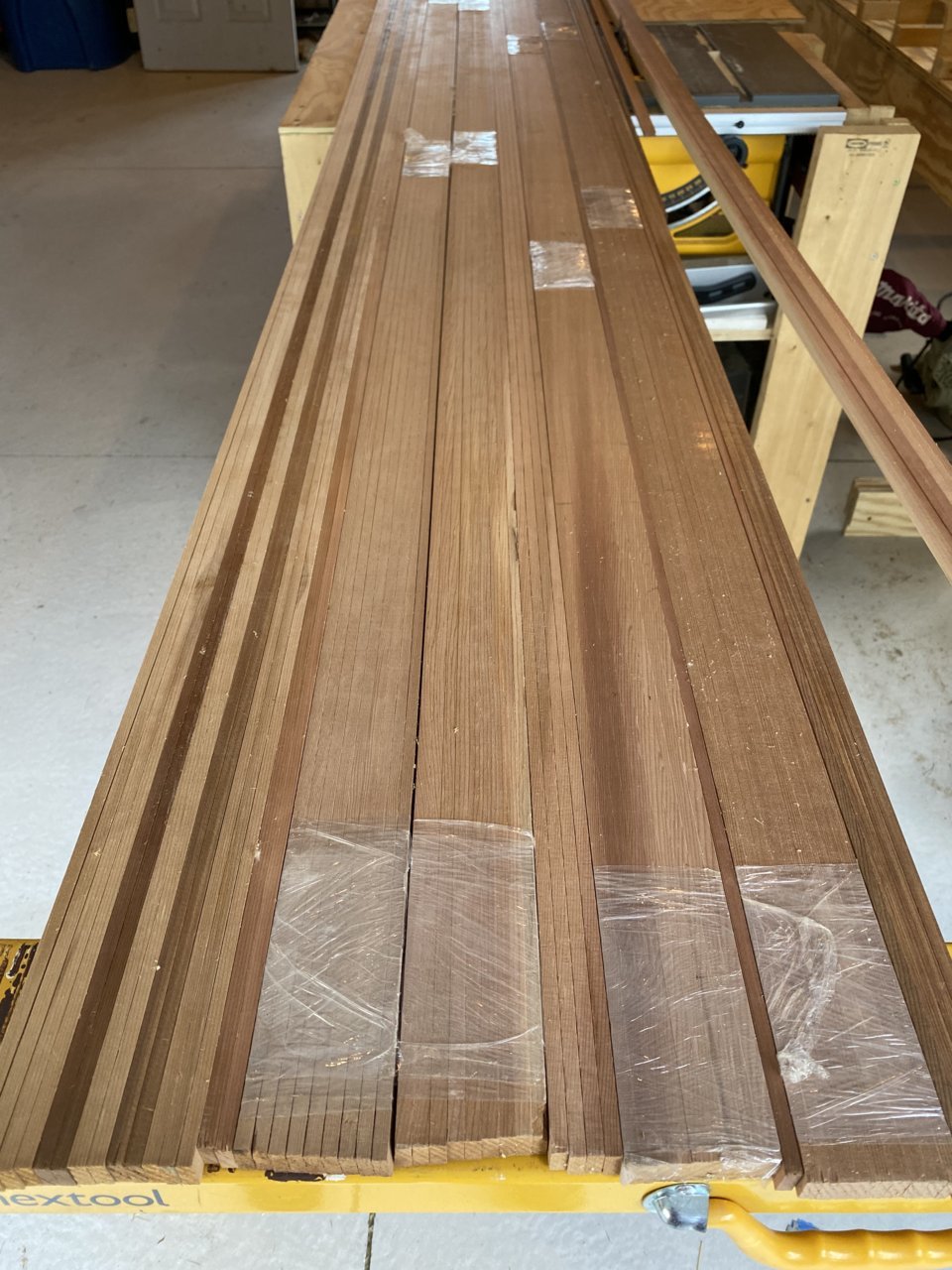

    Boat progress… still soaking my stem strips for steaming/bending day Friday, so I got the main forms set up and started arranging my cedar to pattern the sides. Think I figured out a pattern I like, but I’m sure I’ll rearrange it
