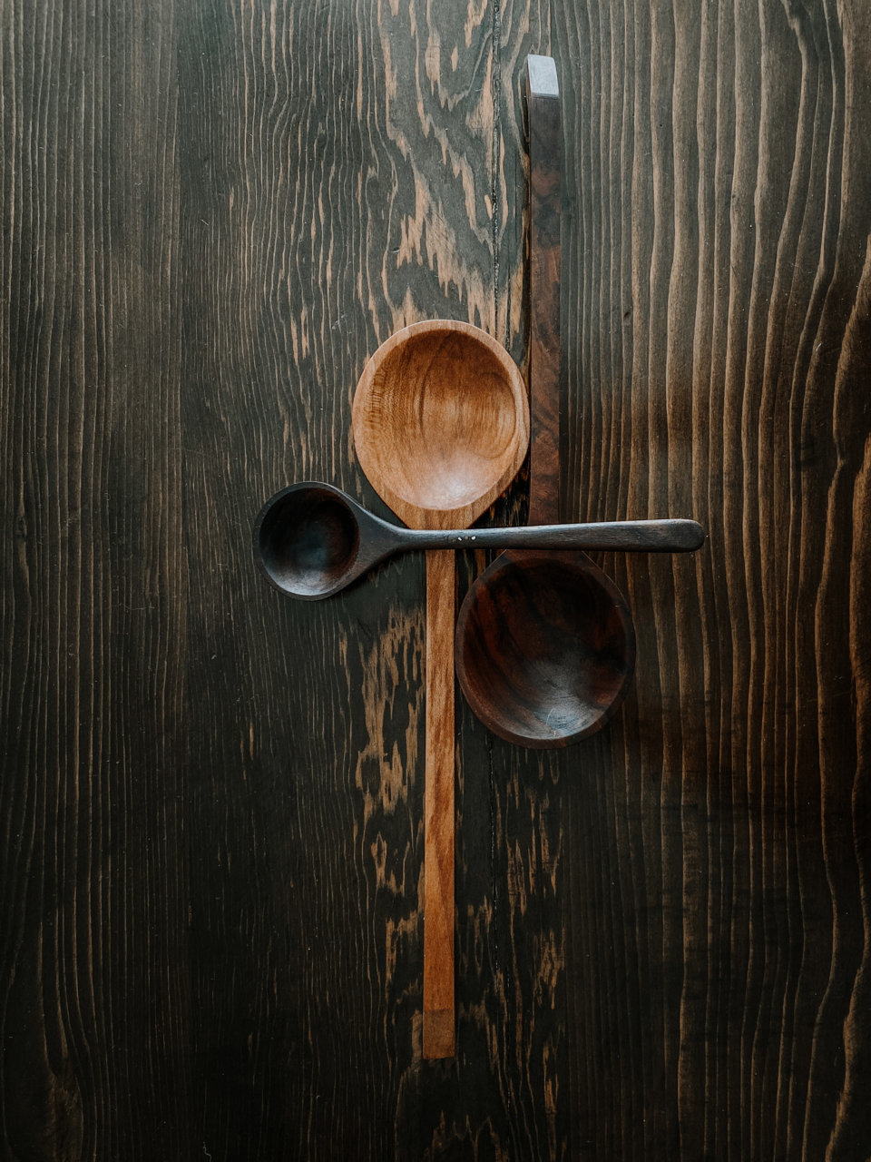

    Just knocked out some spoons for my mother-in-law. Not my usual work and my fingers hate me for it!

    How do you do that? Wow!

    YouTube videos, a sloyd, gouge, and hook knife! To cut the shape of the spoons (not the bowl), you’ll need a combo of either a bandsaw, hatchet, coping saw, and a sloyd and/or saw rasp. Seems like a ton of work, but it’s mindless and extremely therapeutic, and I’m a psychologist.

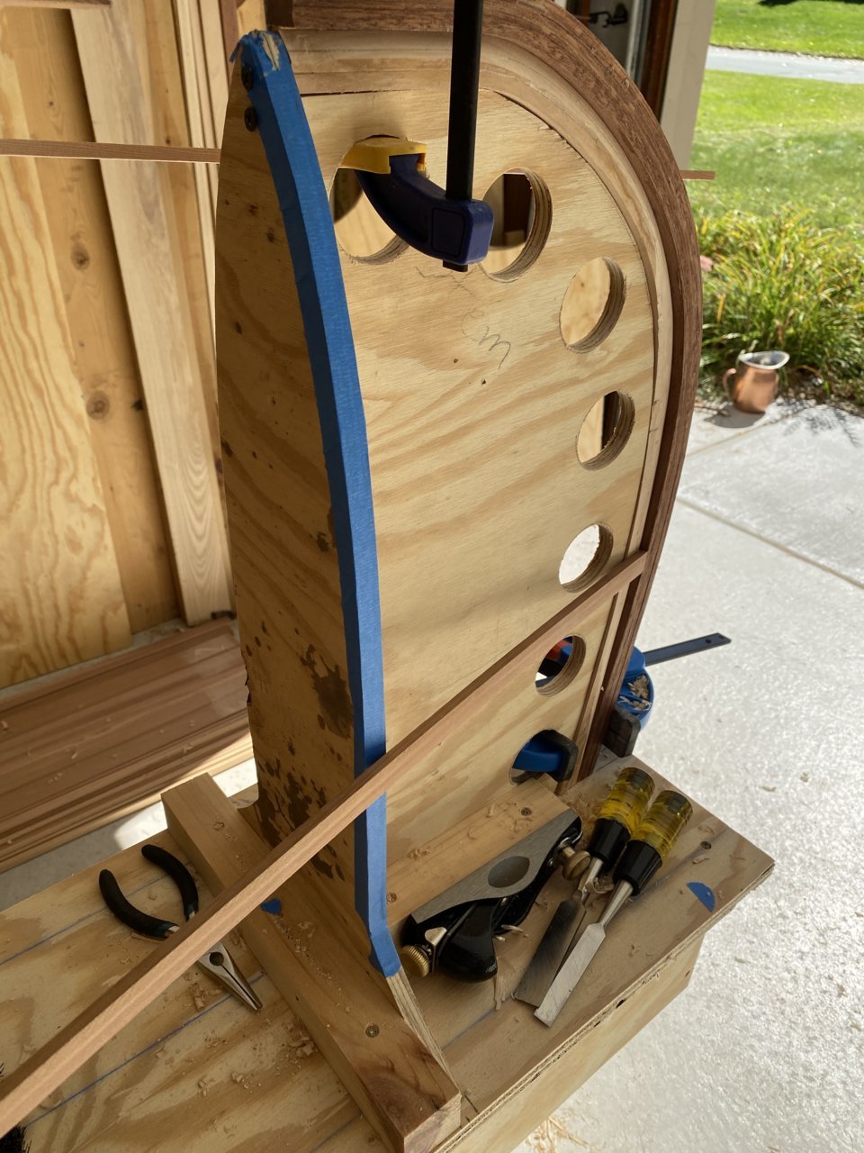

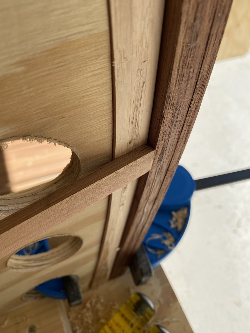

    Still learning, I’ve got two complete sets of stems steamed and glued, but I’m still not convinced they are my final ones. Practicing shaping one for now, promptly ruined it and ordered a spokeshave instead of trying to make my block plane and chisels work….
    current lessons I learned the hard way. When gluing up laminates, mark them so grain orientation matches, I managed to accidentally have them alternated across 3 pieces and my plane and chisels just gouged it where it changed.
    don’t be so fancy with the wood type the first time you build something complicated and new. Currently steaming ash, which is what was recommended in the first place, but I wanted to try the pretty stuff.
    min never going to have this fiberglassed by the time it freezes here. Haha.

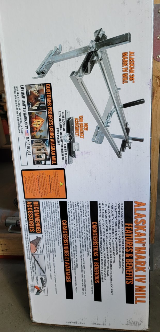

    @woodtickgreg I've got my mill and I've got my saw.. so let's talk about ripping chains.
    The fella at the Stihl shop wasn't familiar with milling so he was confused about the ripping chains. I know you grind your own etc, but any advice on half skip, full skip etc would be super helpful to me.
    The saw has a rollermatic bar on it.. do I need to swap that out too?
    Thanks in advance!

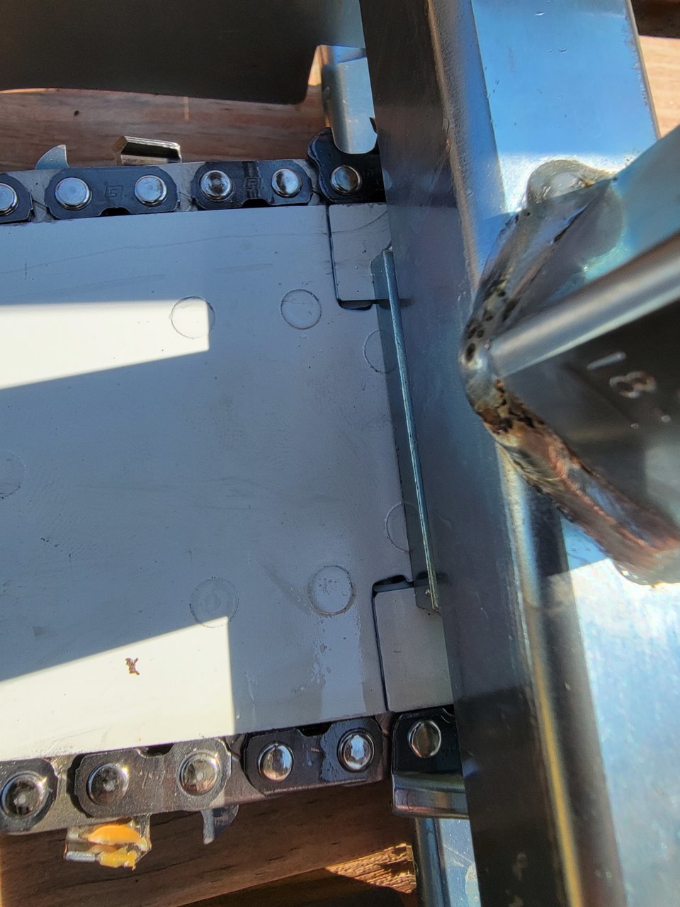

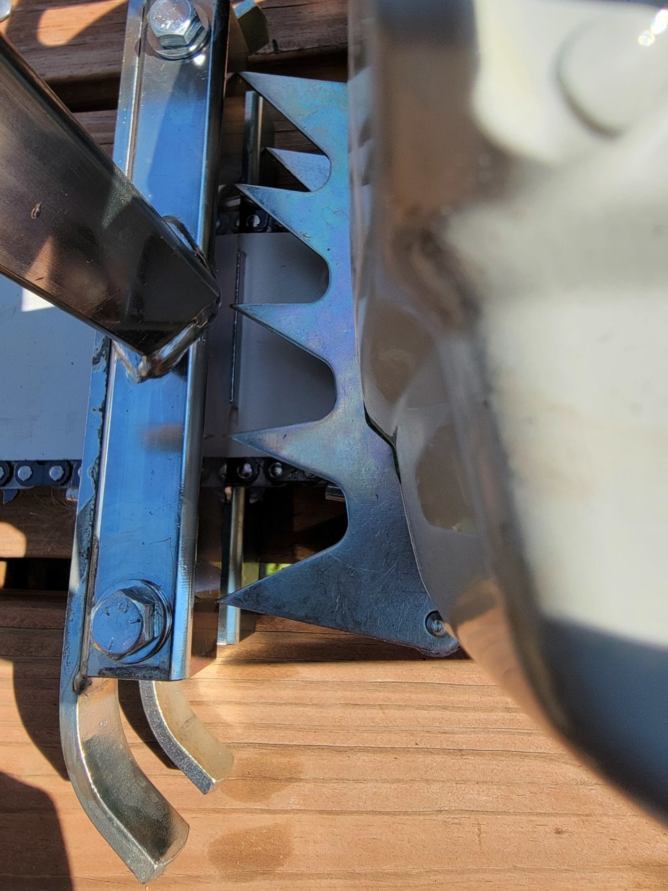

    Hopefully this appears to be correct on the thrust side.
    This is as far back as I can set it on the Rollermatic bar...

    Mount looks good. Nothing wrong with the roller bar, you can keep that. You can check with grandberg for ripping chains, or bailey's on line. When you first start out I would recommend using a commercially bought ripping chain until you get a feel for how the milling operation feels. Then you can move on to a custom ground half or full skip chain. Which one? I would try one of each to see how your saw works with them. I like to grind my chains to about 15 or 16 degrees. Milling chains are usually around 10 or 11 degrees. And standard chains are about 25 degrees.

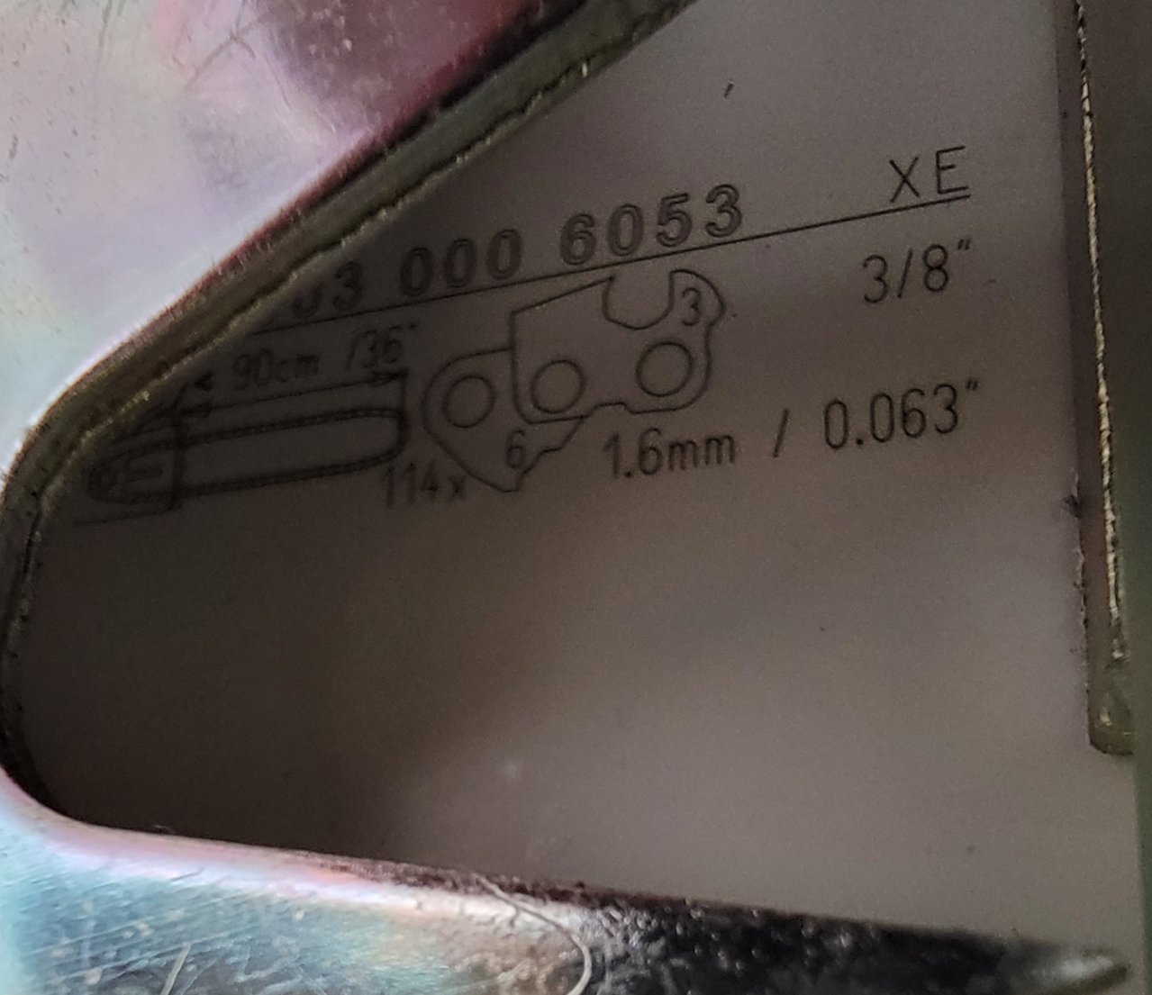

    Of course it's kinda buried on the bar.. this is the best photo I can get.
    I'll wait to start grinding my own chains until I have more experience. For now, I'd like to have a couple of extra chains like you said and grow from there.
    Again, appreciate you sharing your knowledge on this subject!

    That's a 3/8 pitch, .063 gage, 114 drive links.
    Look at the granberg milling chain to get you started.

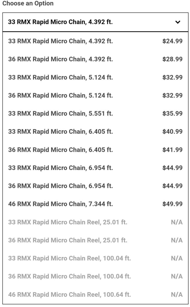

    Yup.. understood that.. thank you! Unfortunately for me, there's a 4 week lead time and a $50+ cost on these chains.
    Stihl does make ripping chains but ordering one from them is more complicated it appears.
    Here's what I mean by that...

    Check with bailey's on the chain. They used to make them up per order.

    Go with Baileys, I have bought ripping chain from them before.
