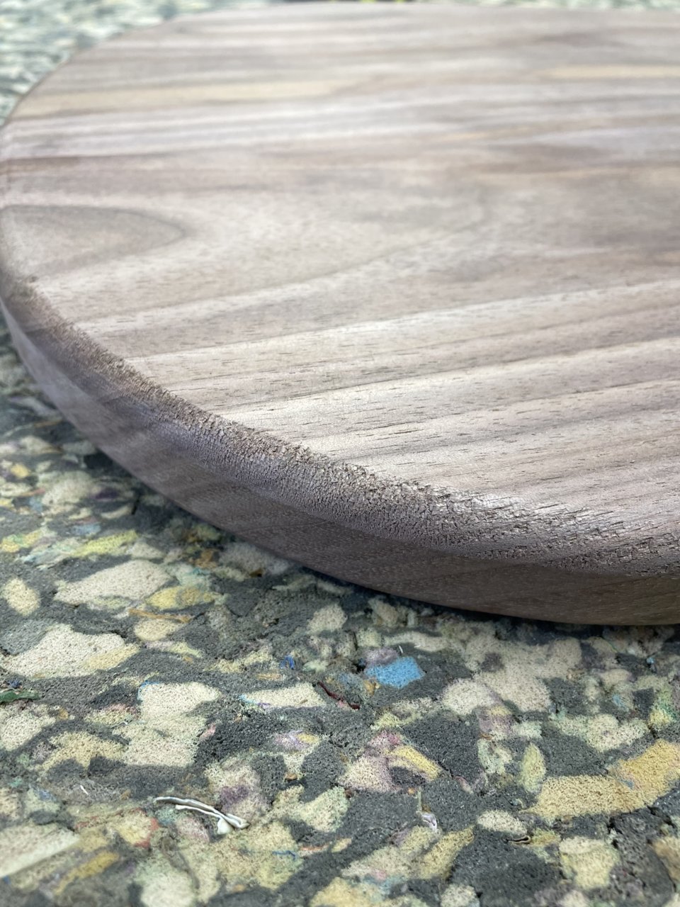

    You might be taking off too much at once but I would try lowering the speed first.

    Also may be moving the router itself too fast...

    I assumed he was using a table but good point.

    Or moving the wood too fast. ;).
    Part of my problem using a router, going too fast...

    Is it just happening on the end grain or on side grain as well? End grain is a bitch cause of you are going against the grain and tearing it instead of cutting it. Try misting the wood with water to swell the fibres and take a slow shallow cut. I know the misting helps tear out on figured woods when planning.

    It is just on the end grain.

    I'm guessing it's mostly on the end grain in the area where you are cutting against the grain.

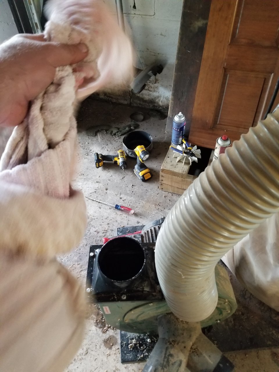

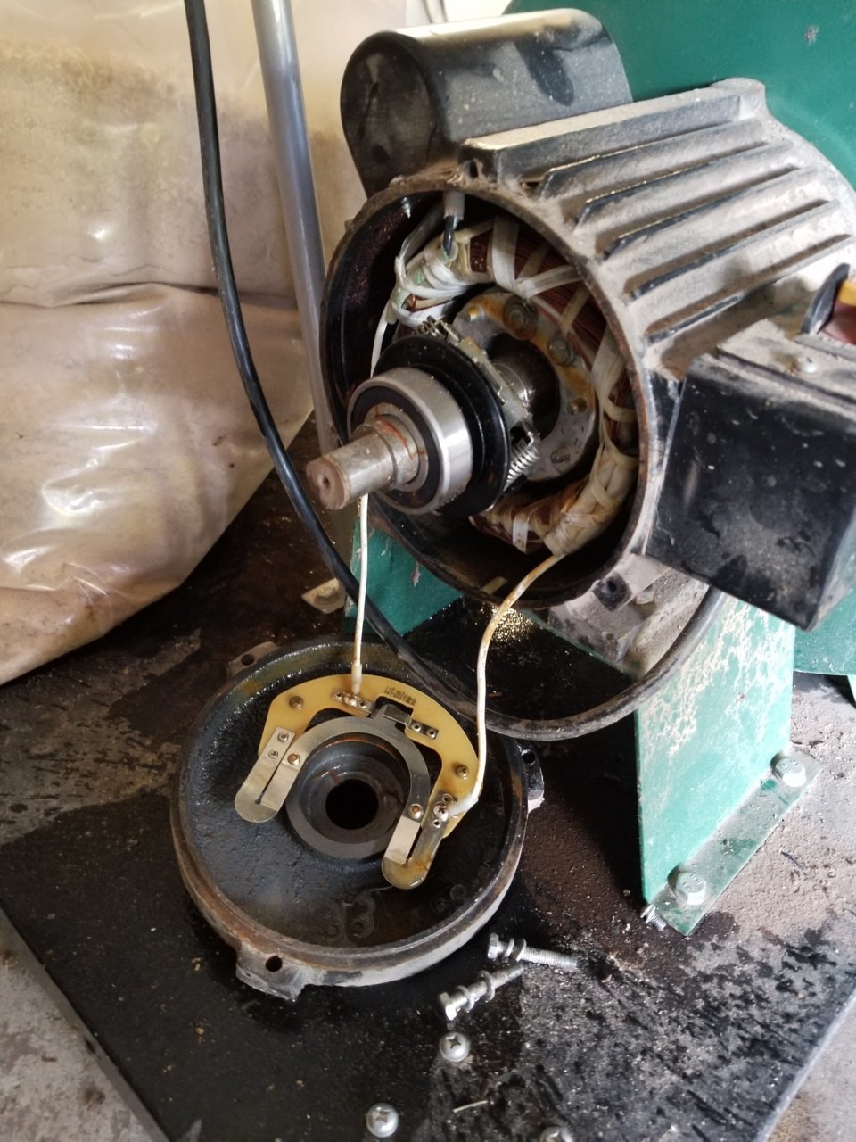

    Just incase anyone was wondering, a HF dust collector motor holds about a quart of water. 20211002_161530.jpg

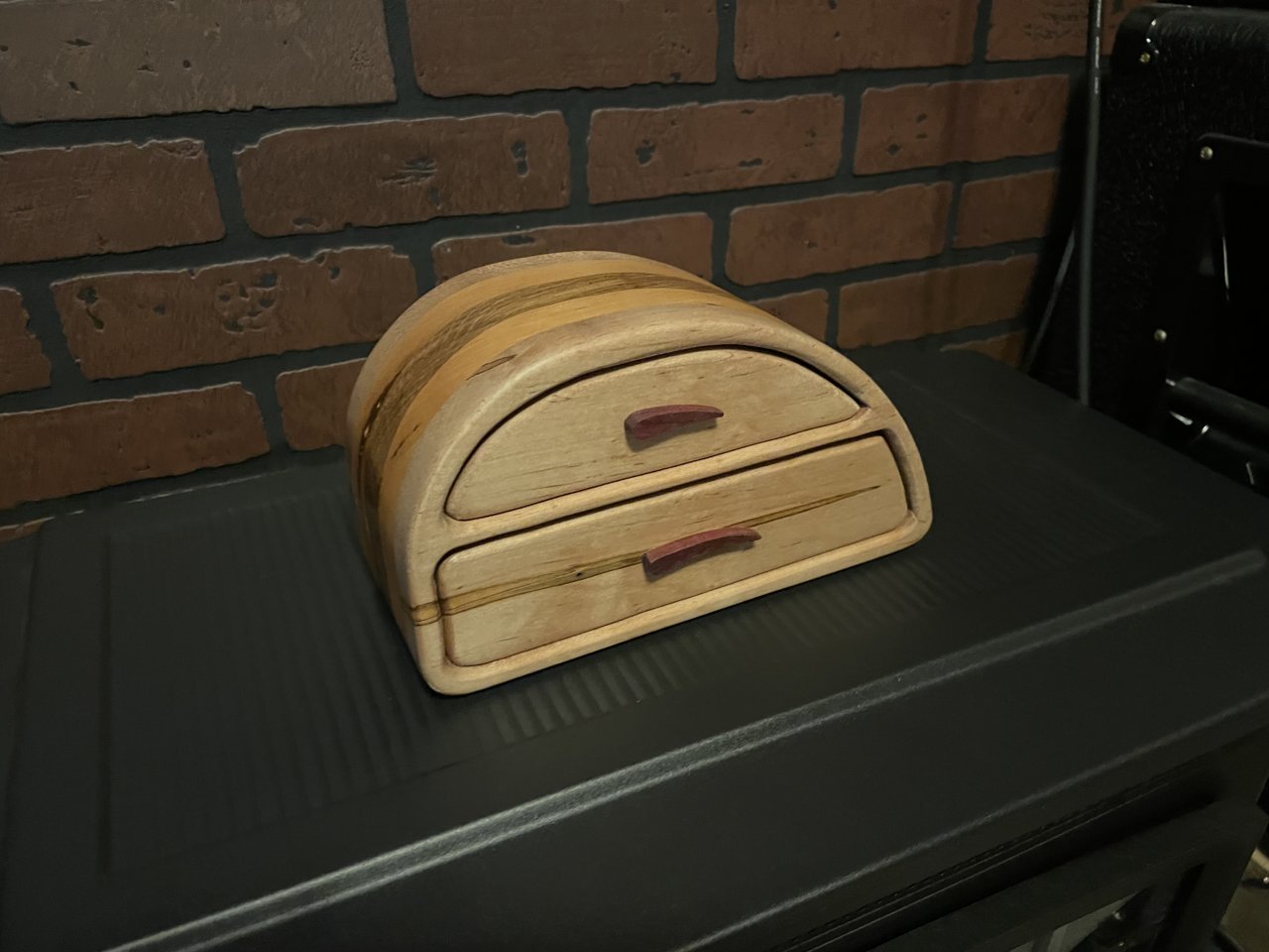

    Made this one and realized it looks like a mini tear drop trailer..

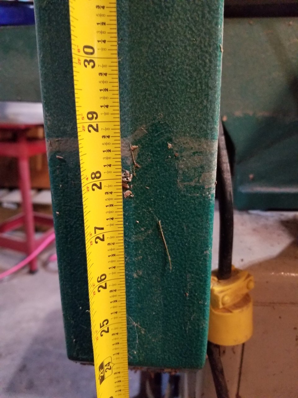

    Had almost 28" of water in the basement last week. Everything fired up fine but the dust collector.

    Wow that sucks. You get dust collector going?

    I'm going to let it dry out. I had to do that with the bandsaw as well. All of the Grizzly stuff fired up without incident. I was shocked.

    Back to life!

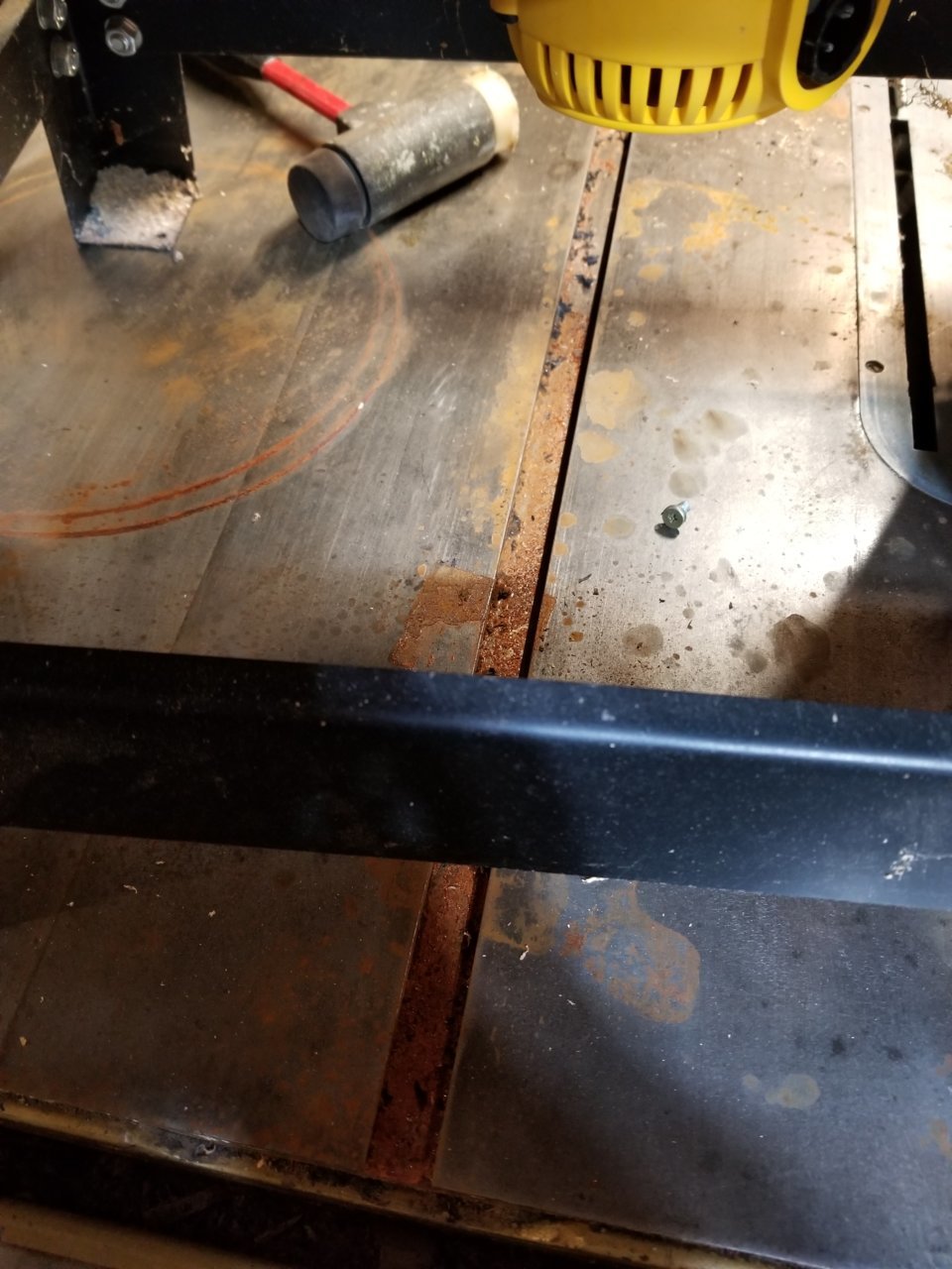

    Paste wax?
