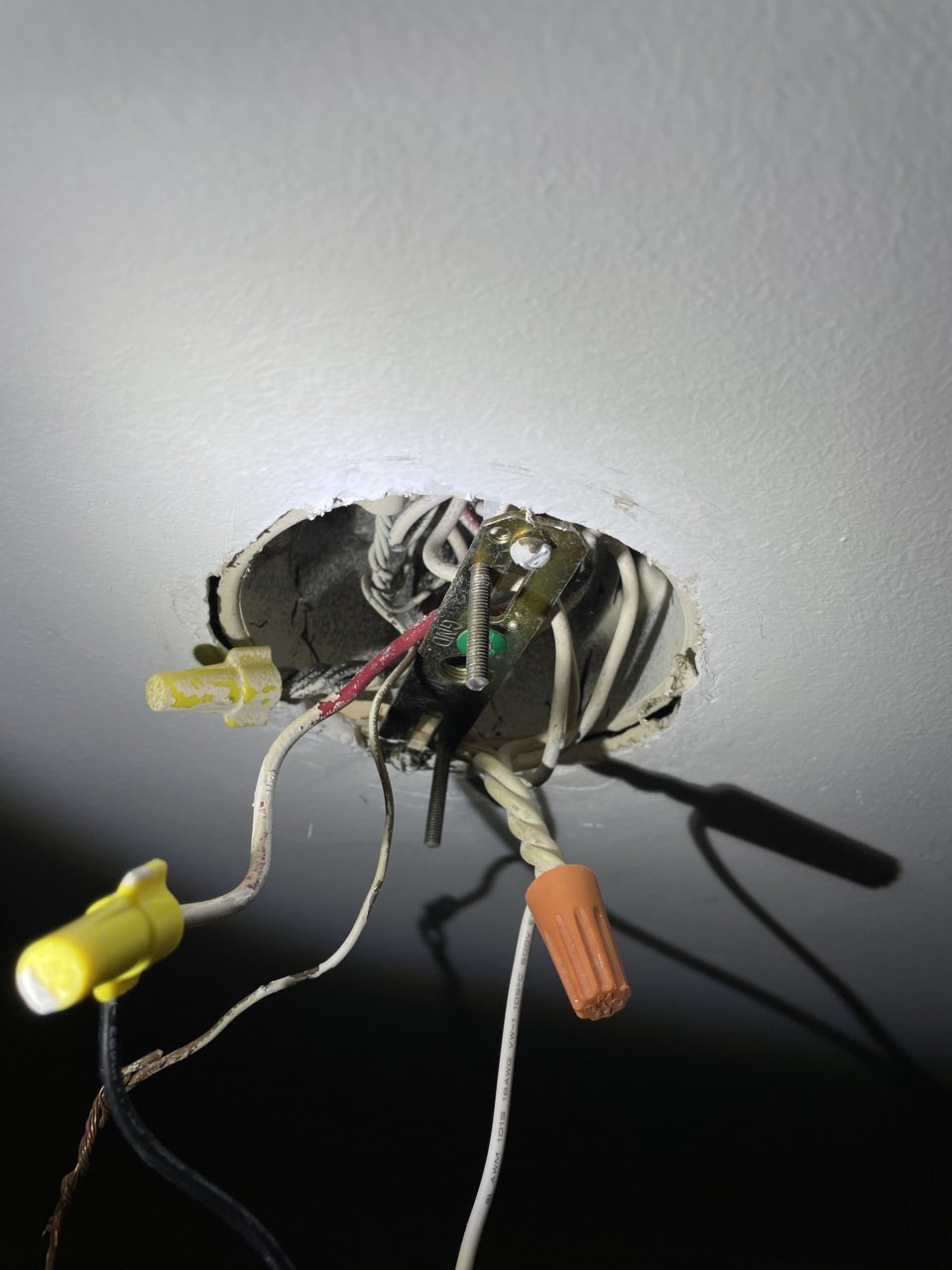

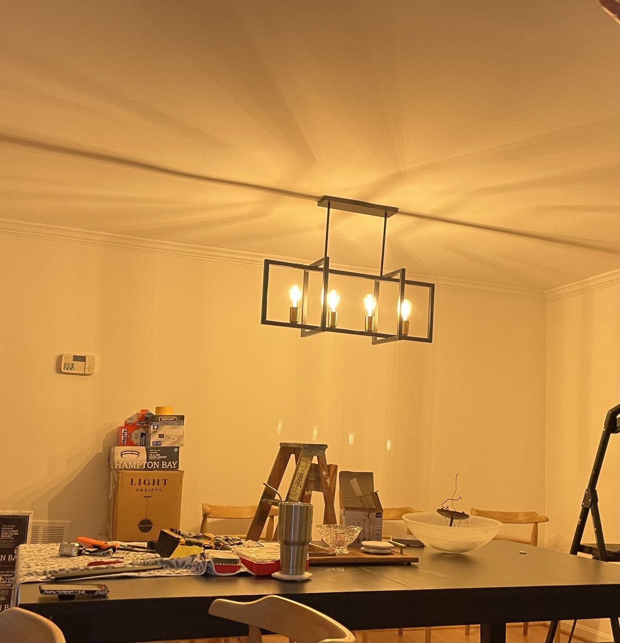

    The black wire on your fixture? Yes, it looks like a three way switch set up.

    I assume you’re changing out a ceiling fixture?
    The red typically is an extra wire running from the switch location. That wire would normally be meant to turn on the fan if you have a fan light combo. Black would be for the lights. If the wire is extra in the box and wasn’t tired to anything before, leave it as is(with wire nut on it) and push it back into the box.

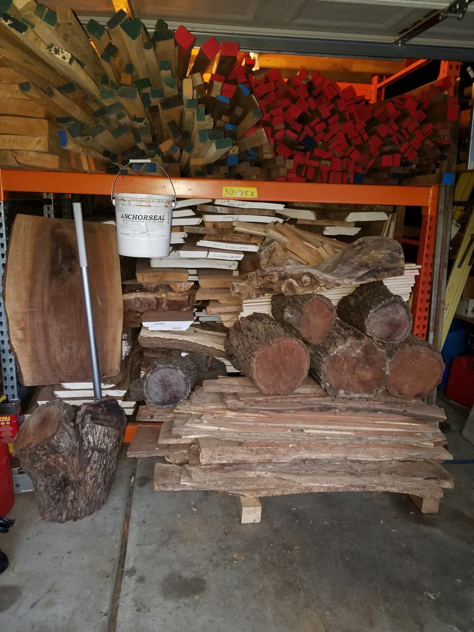

    What species is that piece in the 2nd to last pic, to the left of the white bucket?

    Yeah, I didn’t realize at first there is a dimmer switch.

    That's walnut. The logs in the round are mesquite.

    The dimmer switch shouldn’t have anything to do with the red wire. It’s a bit hard to say what exactly is happening. If you’re replacing a light with a light and the red wire was hooked up to the black wire coming from the light then hook up your new one the same as old.

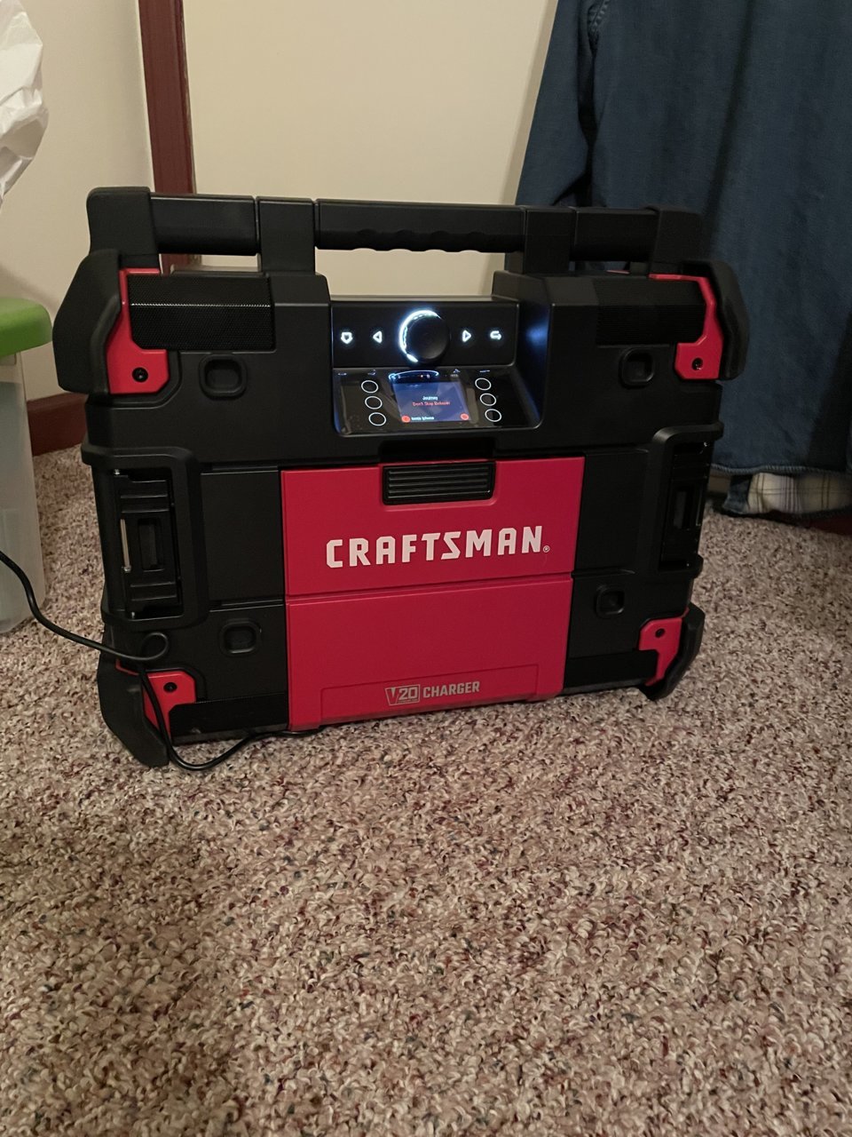

    Spend $89 on a craftsman battery for my drill. Got a $200 job site radio free! Lowe’s online.

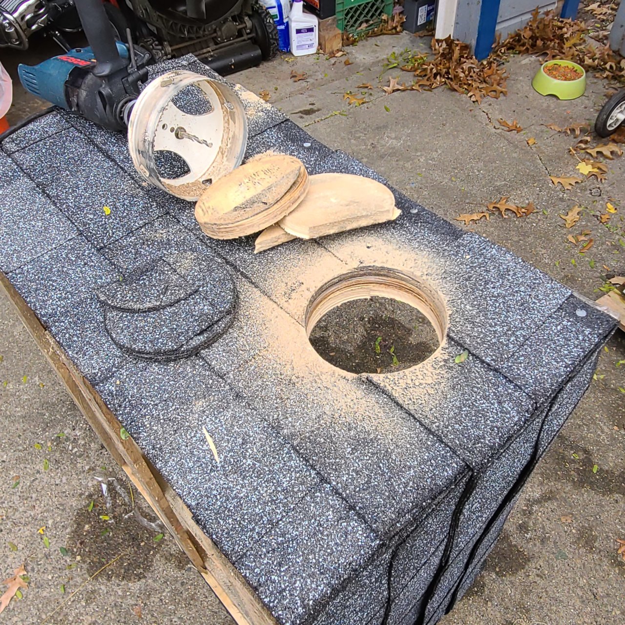

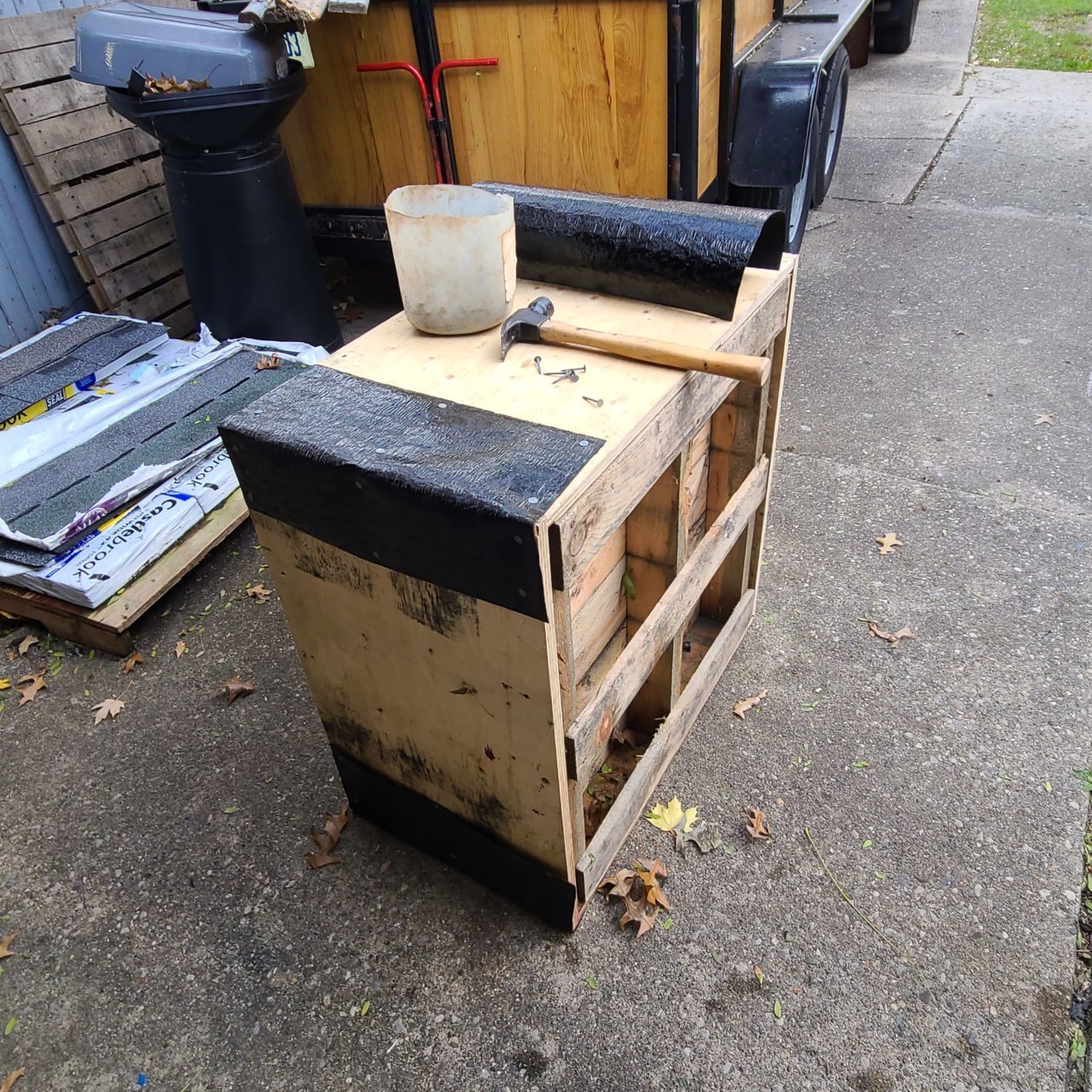

    I worked on the outdoor cat shelter a bit today, I covered it in leftover roofing materials from my garage roof job. This should make it very waterproof and cozy.
    I wrapped the corners in ice and water shield.
    Then covered the box in shingles.
    Most information I found online said to use a 6" hole for the entrance hole.
    Next is the roof.........
