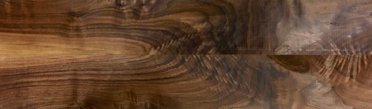

    I haven't done any woodwork since high school, but recently did a spiral staircase step stool which gave me the bug. A friend has a garage shop that was used to make it and I wanted to thank him, so I'm making a small walnut box that will have some things he needs in it (i.e. dowel pin markers).
    The walnut treads on the step stool was the first time I've worked with walnut, but I haven't put a finish on those yet. Anyway, I've been stopping by the store periodically looking at walnut boards for the box. Not having any idea what to look for, and there are a lot of variations in grain, I just kept hesitating.
    Hard to tell much when they are dry, so in the store I got my hand wet from the rain water on the cart and wiped it on the boards that interested me. Yesterday I found this board and I thought it was so visually striking that I bought it. It's 3/4 x 3 1/2 x 5.
    When I got home I wiped it with mineral spirits. The pic is about 2 feet of one end of the board; the top of the pic is one side of the board and the bottom of the pic is the flip side. I cropped both pics and spliced them together to make it easier to look at and decide which would be the outside of the box.
    I'm curious about the grain and figuring. I can see the sapwood and that doesn't bother me. Does anyone have an opinion on whether this is a good piece for a box?

    That looks like an excellent piece for a box.

    You'll have no problems using that for a box, it will add lots of visual interest. I'm assuming if it's store bought it'll be dry. Walnut is a very stable wood and one of my favorites to work with.

    Yes, kiln dried. Believe it or not, I got this piece from Home Depot. I have spent so much time during my visits there digging through the rack of walnut, pulling out many many boards, to find something I liked. Biggest problem was the number of them that were bowed or cupped. The first one I bought has about a 3/16 bow over the 3 foot length. After that I meticulously looked at each one. Still not sure what I'm going to do with that one.
    I read some kiln dried wood, if they steam it to even the color out, is grey and dull. In preparation for that I bought some amber/orange shellac flakes to warm it up. The finishing schedule will be Tung oil finish (wet sand the last two coats), several thin coats of shellac (will be blonde now that I see the wood looks good), then a few layers of satin varnish sprayed on.

    Nice piece of walnut, great grain. It will make for a nice project. Tung oil may not be your best choice as it takes a long time to dry, if ever. I've had good luck with Watco Clear Danish Oil and then coats of Poly. You can thin the poly with paint thinner and wipe/ brush it on. It will take 4 or 5 coats with a very light sand between coats. Google wipe on poly. Are you going to do some finishing samples first? I'm just speaking from trial and error and lots of research.

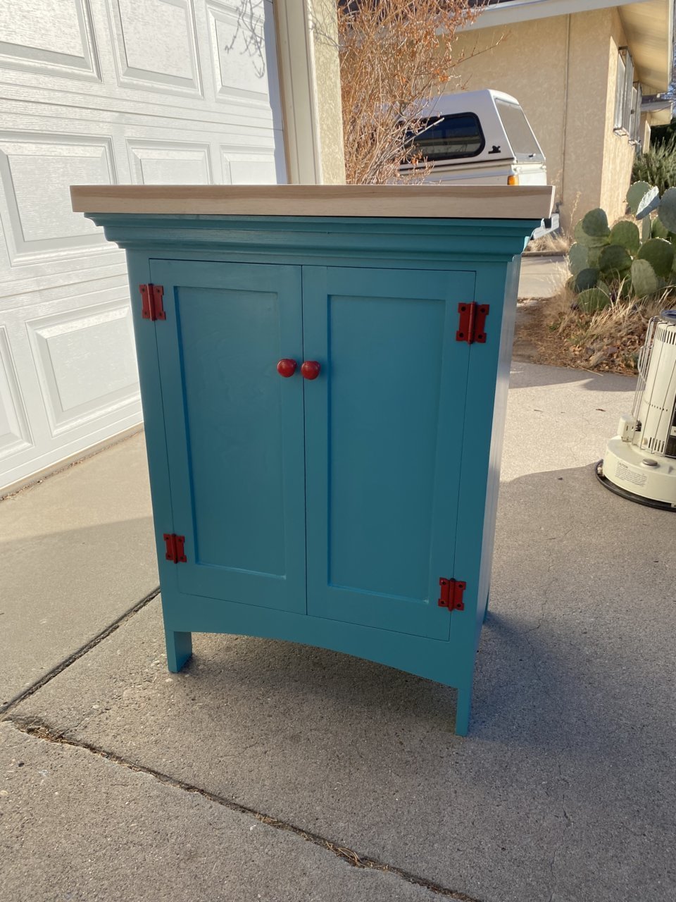

    Wife’s Christmas present

    That's cool, where's it going?

    It’s an addition to some vintage cabinets that I had rebuilt some years back for my kitchen, the other cabinets have a butcher block top so that’s why the top on this one looks thick.
