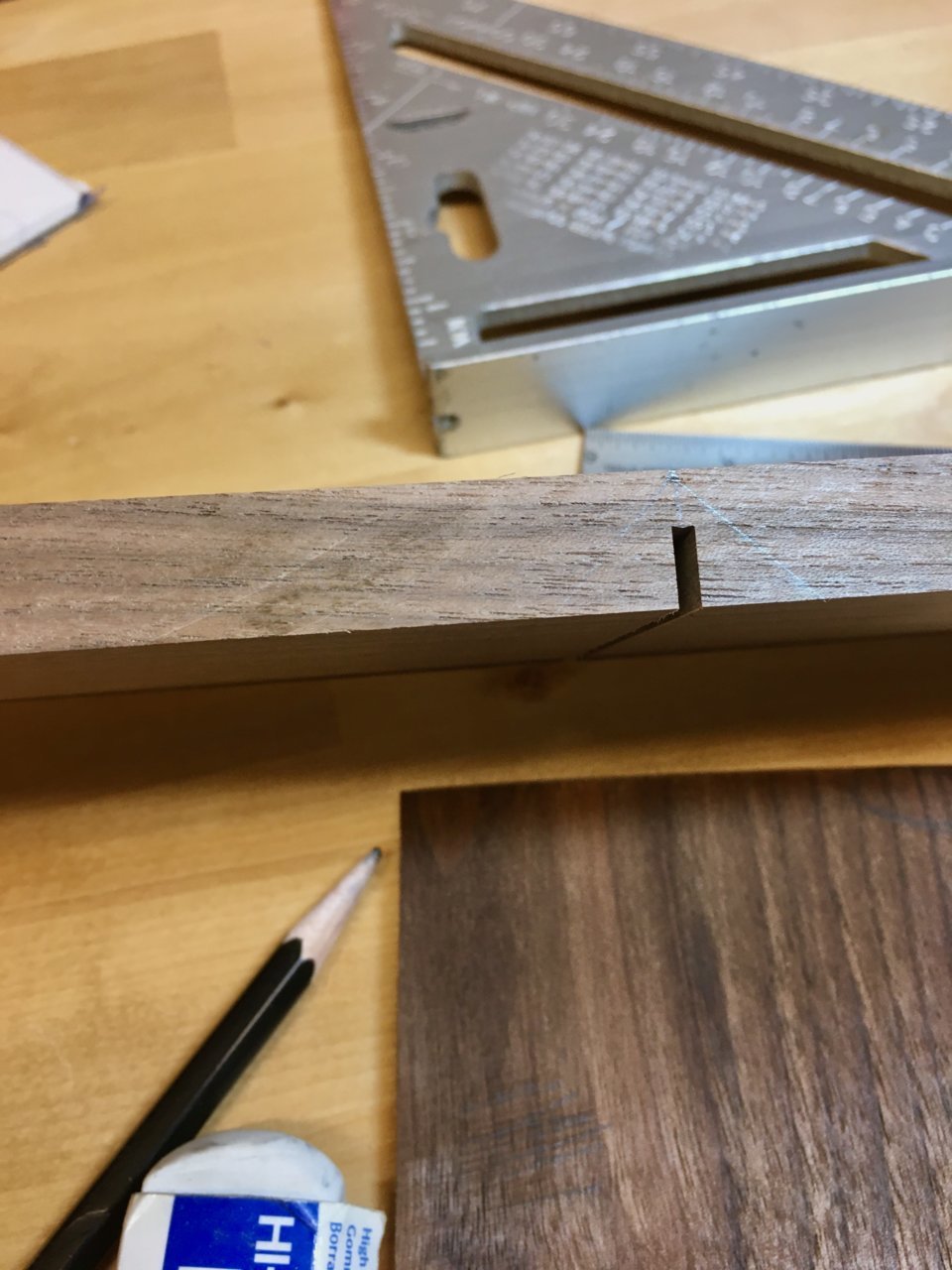

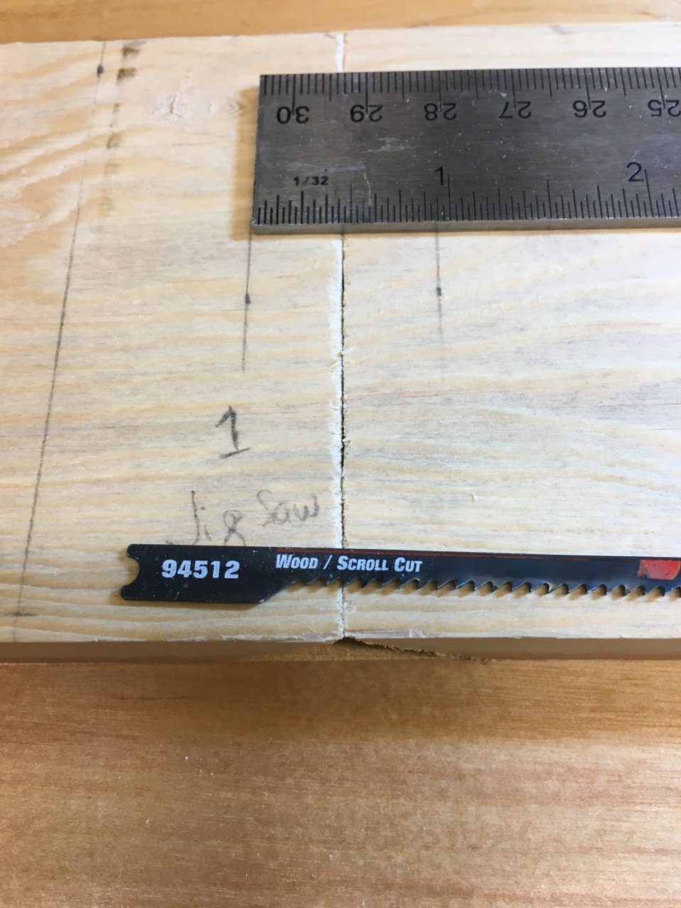

    If you're set on doing the relief cut you mentioned, instead of a jigsaw to seperate the pieces, try bringing the table-saw relief cut up slightly more, and then you could go with a crosscut hand saw, or if you get pretty close even a straight edge and a marking knife over and over again to score thru. It's a good exercise to practice building, but honestly I don't think you're going to notice too much of a difference from just cutting all the way with a regular kerfed tablesaw blade.
    The 'faults' you see are going to seem 10x worse than what any person you give this piece to will see. You're going to be your harshest critic

    A truer statement has never been made! I think I'll just keep it simple for now and just use the regular saw blade. More pressing is the hidden barrel hinges. Those bastards are tricky and require exacting precision. I should use a regular hinge but really want to get these to work. I have a digital caliper coming that will help. Even <1mm makes a difference. I finally was able to make a template for the holes that worked and got them temp installed on the prototype box last night.
    The 8mm barrel on the hinge is exactly 8mm. An 8mm drill bit makes exactly an 8mm hole, so the barrel won't go in. I looked through all my bits and couldn't find one that was 8mm-. So I got one that was too small and taped sand paper to it. Ran that in the 8mm to open it up a bit. Worked, but look at how thin the walls of the hole are. Danger close. My actual walnut box will be slightly thicker.
    The other tricky bit is clamping the lid to the box in the open position to drill the holes. The top is barrel shaped and not the same height as the bottom. Clamps and shims helped, but tricky to maneuver around the drill press table. It's been a struggle but a fun challenge and I'm learning a lot.

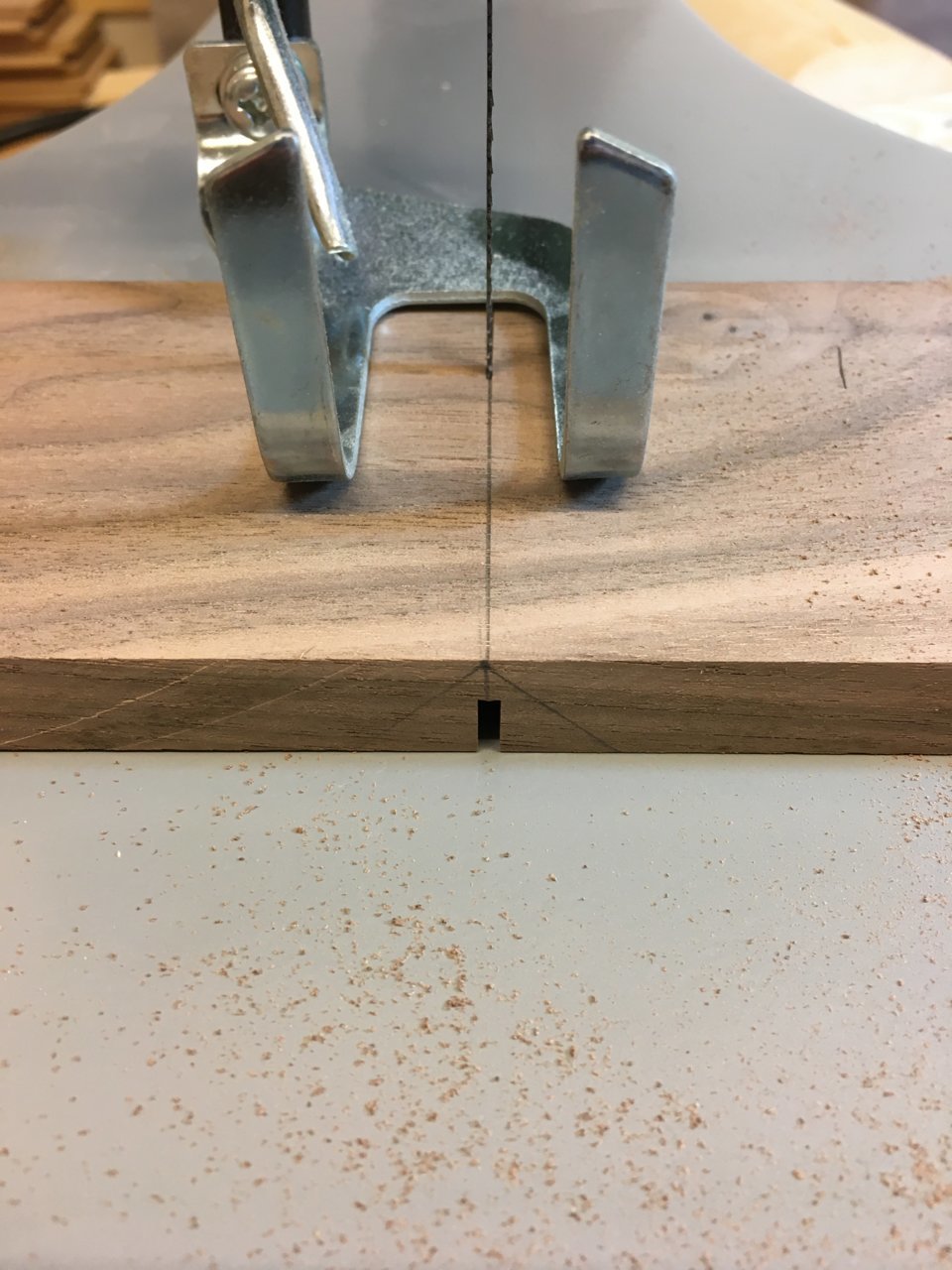

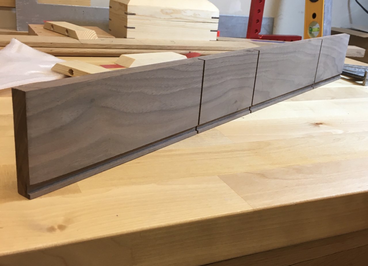

    Well I tried the scroll saw on a scrap of walnut and it went so well I decided to try it on the real wood. It went better than I could have hoped for! There was next to no tear out and the kerf loss is about as minimal as reasonably possible - I think about 1mm.

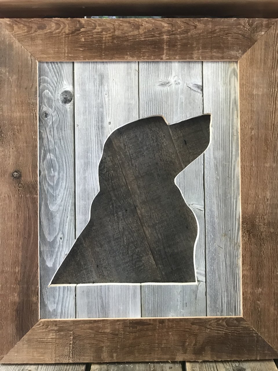

    Like to doodle some ideas down then try to bring them to life. Try to use old odd wood laying around from old docks, barns ect. Like to create something unique to talk about.
    Here are some of my oddball creations lol.
