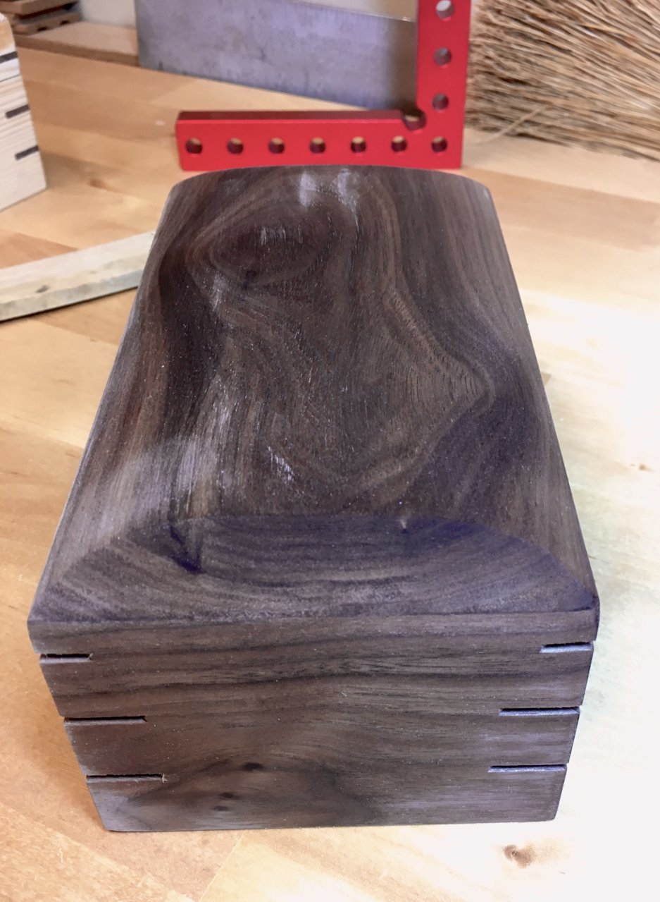

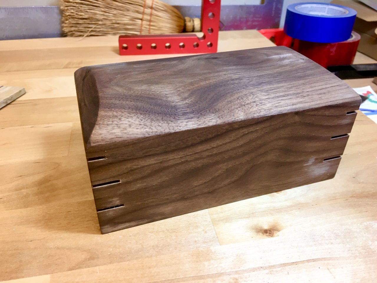

    I got the top glued on then got the barrel shape roughed out. It needs a bit more work on the shape before finer sanding. Cut the miter key slots then wiped it with a damp towel to see what the grain looks like. I think the grain pattern on the top is going to look really good.
    Once I get the miter keys in and cut it will be time to cut the lid. I'm hoping there's not a lot of glue squeeze out on the inside. Install barrel hinges, then a lot of sanding and on to finishing, which will likely be 4 or 5 days.

    That's looking great! Can't wait to see that grain pop!

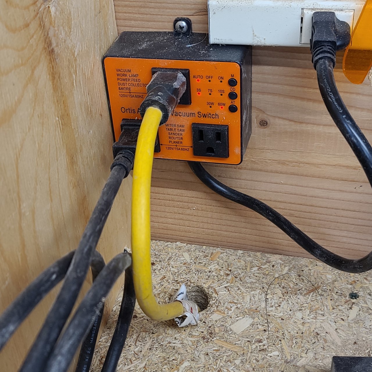

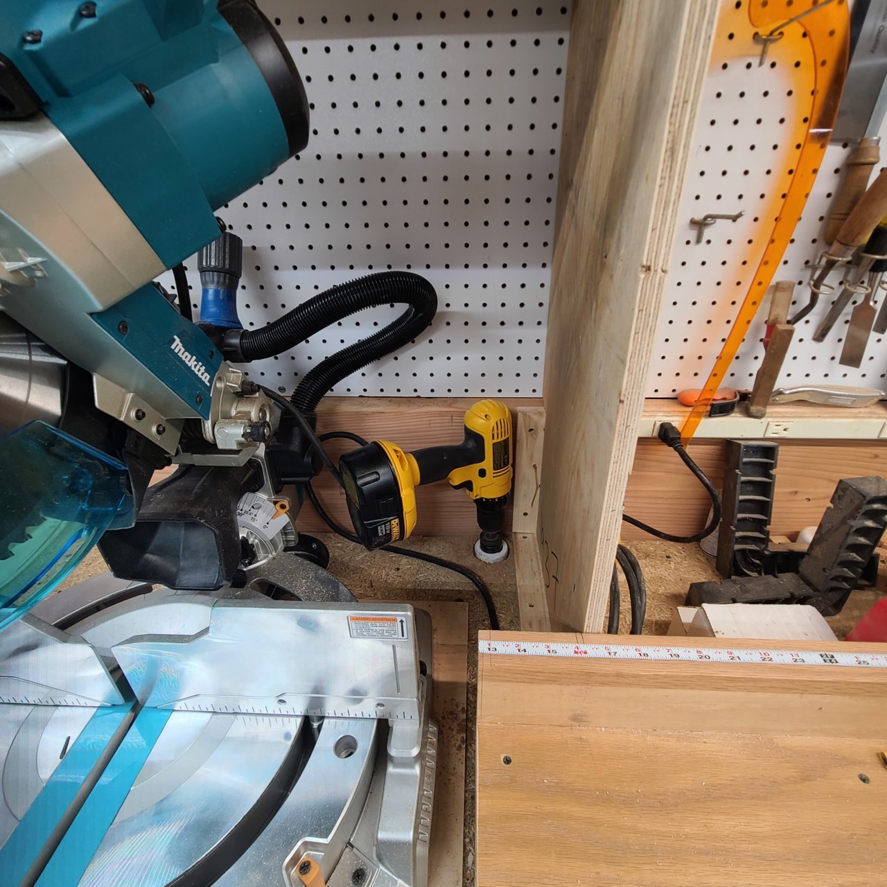

    Well I finally got some time in the shop to finish the install of the new miter saw. I made a plywood dust hood with free wood, lol. I did cover the pegboard on the back too.

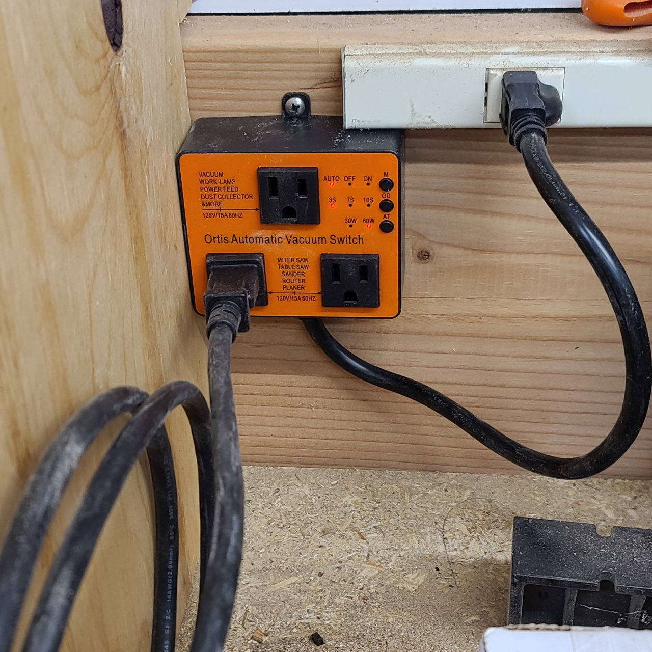

    I hooked up a automatic switch for the shop vac.
    I had to drill a hole to pass the yellow cord for the shop vac through.

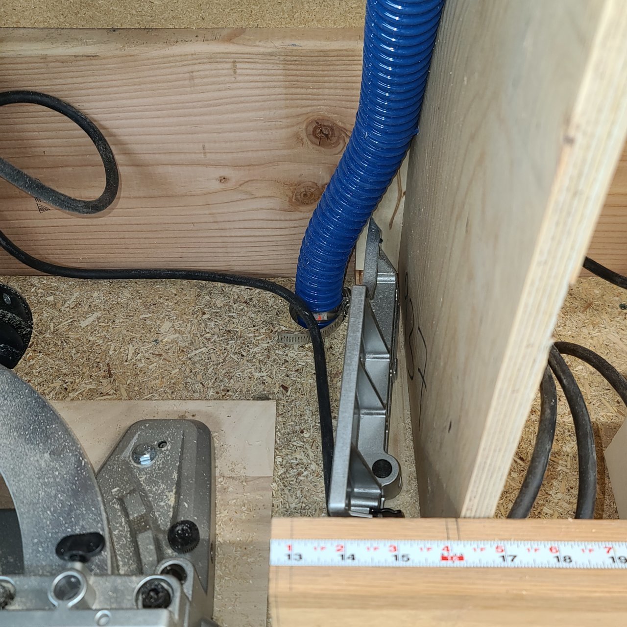

    Then I drilled a 2" hole for the rockler dust hose to pass down through to the shop vac.

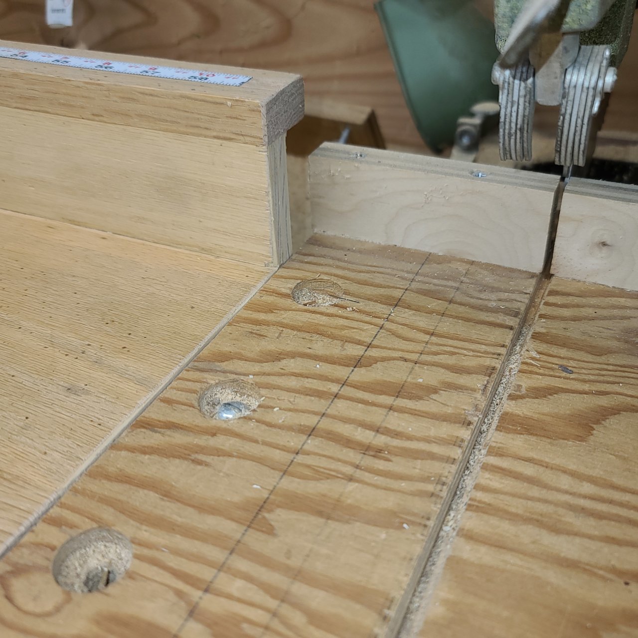

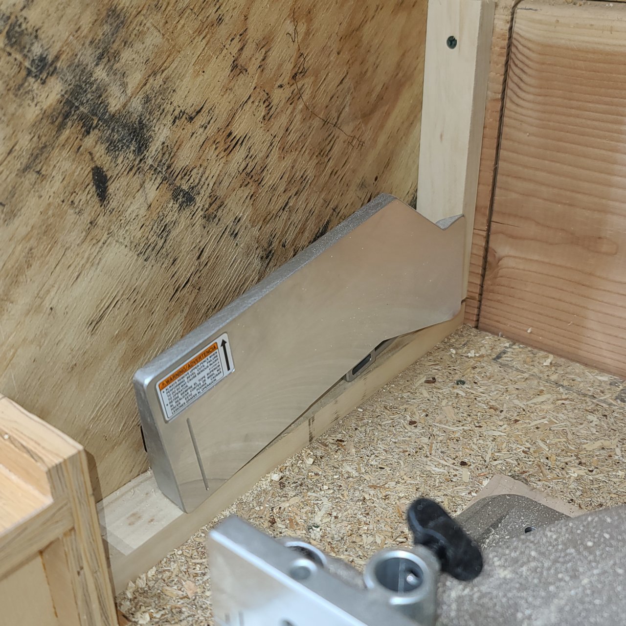

    Since I don't always need the tall fences I also drilled a hole for the post of the fence to go into for storage next to the saw.
    Same thing for the right fence. Here you can also see the dust collection hose.

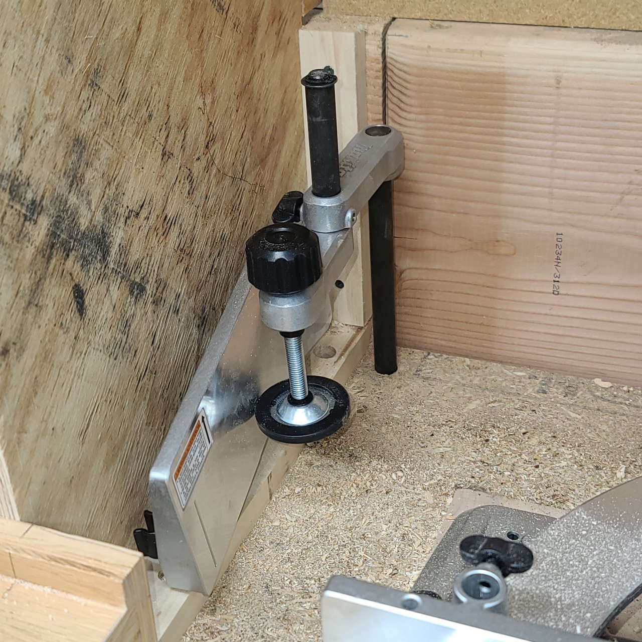

    I did the same for storage of the hold down clamp.

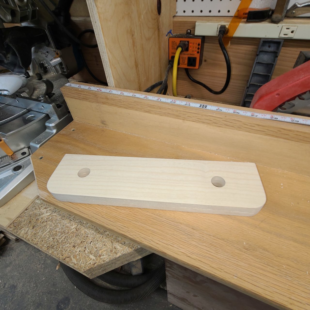

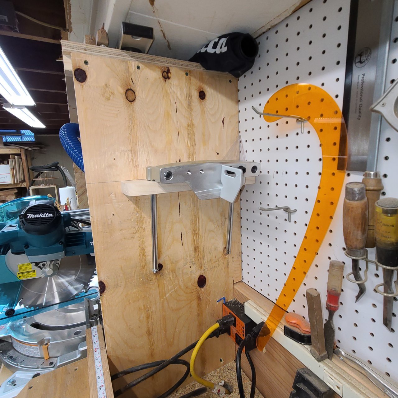

    Since I took off the table extensions I made some holders to store them. Made from some scraps of wormy ash.
    And I mounted them to the sides of the dust hood.

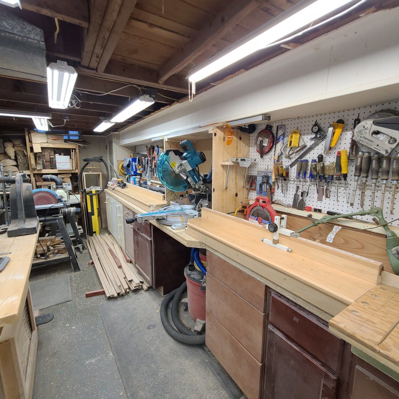

    So I'm going to call this install done, back in business!
    The only thing left to do is remount the ras saw so the fence lines up. But that's for another day. I only use the ras for breaking down rough sawn lumber.
