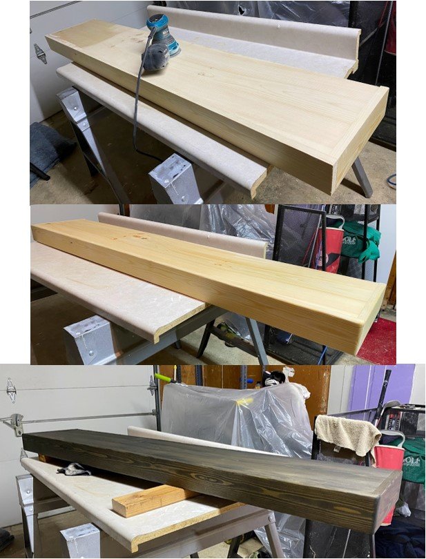

    Built a floating shelf for the laundry room over the weekend. Not sure if i wanna add another coat of stain or not.

    Can you use a water-based Poly over a oil-based stain? Are oil-based products better than water based?

    Yes as long as the stain has dried. Personal preference. I prefer oil based. I don't like the feel or look of the water based stuff.
    Water based will raise the grain. You may want to lightly sand after a first coat to knock the grain back down.
    As far as "coats of stain" goes, stain penetrates wood. It does not lay on top like paint. Wood can only take some much stain as well. I have seen people "paint" with it though.

    Thanks! Just wasnt sure if you should be consistent with them or if it didn't really matter.
    Also thanks for clarifying how stain is absorbed by the wood and your not coating it like paint. Sorry for my newb language. So, do you typically just do one application of stain before Poly?

    Hey man, has anyone spoken to you about Transtint dyes? Water or Alcohol soluble, mix in to almost anything. Incredible colors, and you can mix them to any tint. Cheap effective, and removable until topcoated.
    Also my opinion on poly.
    Just my opinion.
    Feels like plastic, looks like plastic, scratches easy, and I just dont like it.
    Rubio monocoat is my goto finish, shellac thinned to 1lb cut, padded on with a bit of mineral oil to smooth the several quick layers it takes. ( look up french polish and think on how to use the information, not necessary to go all the way to have a amazing touch me finish)
    I sometimes use boiled linseed, or danish oil.
    Again just my opinion, but if you try rubio monocoat you will love it.

    Yes, I only do one application. The only thing I stain is pine and sometime maple or birch plywood.
