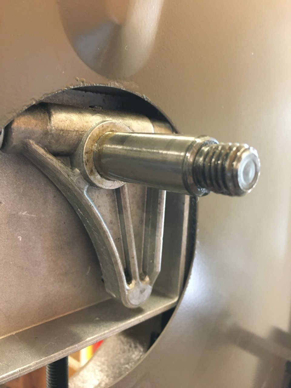

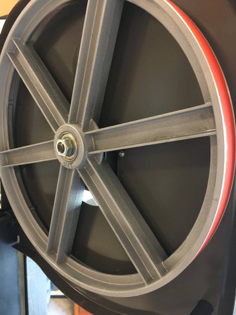

    I’m in the process of assembling my HF 14” bandsaw. I decided to change a few things while I’m at it, such as Accu-Link belts and urethane tires. I took the top wheel off, muscled on the tire and put the wheel back on. Trouble is, I don’t know tight the nut is supposed to be. It contacts the inner race of a bearing. If I spin the wheel and tighten the nut finger tight, the wheel spins freely. If I put a socket on it and go a 1/8 turn it slows the wheel down noticeably. Any more than that it stops. Is finger tight sufficient? How tight should this nut be?

    Id assume it would have to be free spinning. So put some blue thread locker on it

    pressing on the inner race with the nut wouldn't slow it down. the wheel rides on the outer race. I would check behind the wheel to see if anything is pressing on that outer race as you tighten the nut. I would be super nervous to use a band saw with a hand-tightened wheel, thread locker or not.
    also, it looks like the wheel is much wider than your single bearing. likely there is another on the other side, which means there should be a sleeve between the two to prevent side loading. if you pulled it off, it may have been easy to miss the sleeve if it stayed in the wheel between the bearings and dropped out of position when you removed the wheel
    wilcam47 and 916carl[QUOTED] like this.

    Thanks! I'll take a look this morning. I'm being extra careful when I remove something to either put the hardware back on immediately or put it in a special box. It's frustrating to lose a part that you had in-hand minutes before. I don't remember a sleeve but that doesn't mean there's not one. I'll also look for a parts diagram.

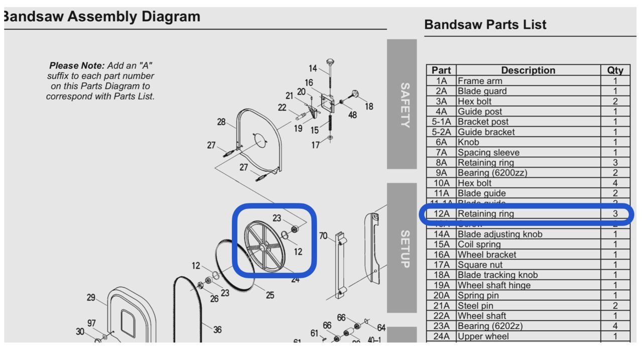

    Edit - well, crap. Found the diagram and there are several retaining rings. I don't remember those and there are no extra parts laying about. I'll know more once I can get out there and pull the wheel off. I hope I just put the rings back on when I removed the wheel, and when I put it back on didn't remove them first. I'd feel stupid but at least they would be there and I'd be good to go.

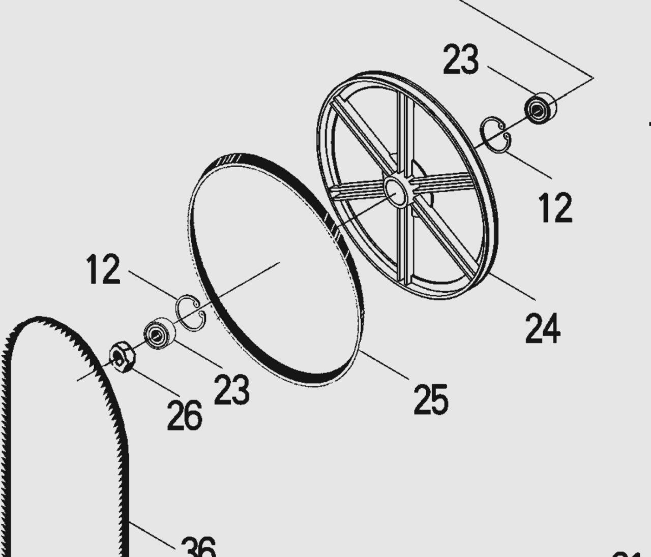

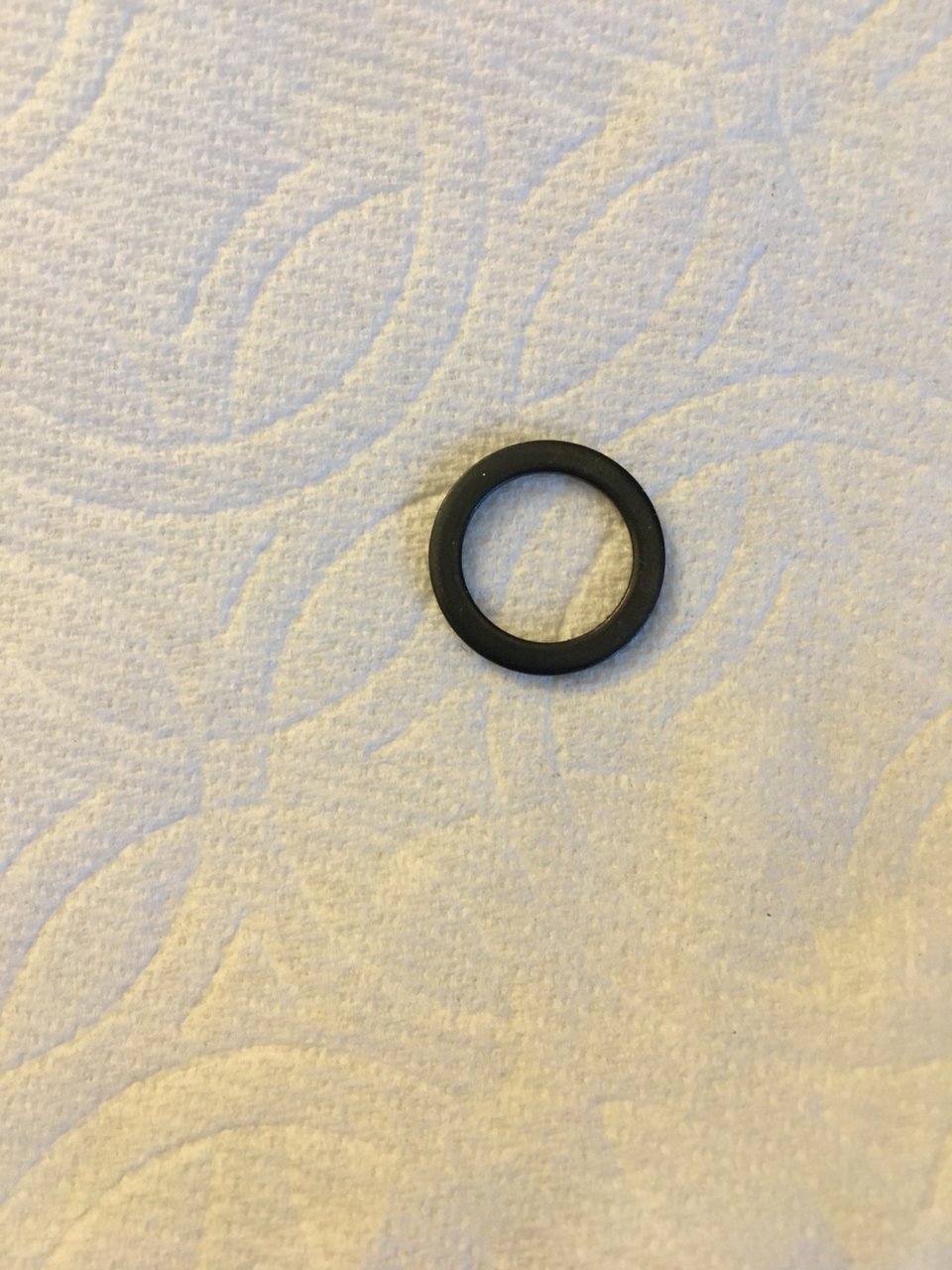

    FFS! Frack. I pulled the wheel and there was 1 washer/spacer there (see 2nd pic below). I went back to the schematic and zoomed in. The two rings (part #12) are C clips, not washers, and in the drawing go inside the wheel hub. There is no washer or spacer between the nut and the bearing in the schematic. In fact, the washer/spacer I did find isn't even listed on the schematic.

    if that washer is the same diameter as your spindle, I would guess it slides on before the wheel to keep it from making contact and rubbing. worth a look.

    I'm on hold. I've looked at schematics on-line for Grizzly and Delta 14" saws (almost exactly the same as the HF) and neither show a washer on the top wheel. I wonder if HF added the washer because an issue was found after production and have not updated their diagram? I may go to the hardware store and pick up another one and see if that does it.
    While typing this someone picked up. He agrees the washer I found isn't listed and is reaching out to someone else. I also explained the issue with friction when tightening the nut.
