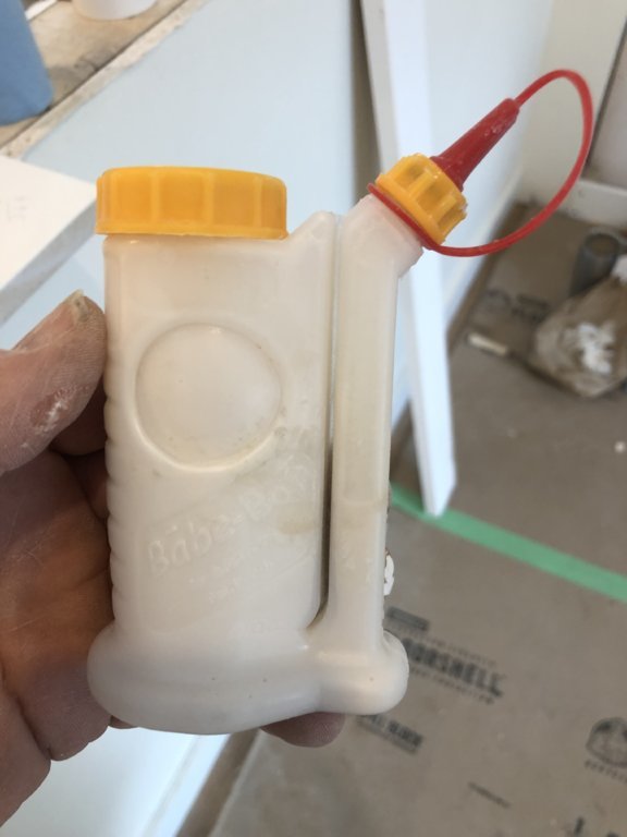

    New favourite tool at the moment ...
    I'm trimming out my current client build and picked up one of the 'baby' versions of the FastCap Gluebot glue bottle , awesome little addition to my finishing kit . No run on from the nozzle so I don't have to worry about accidentally dripping glue all over myself and the job

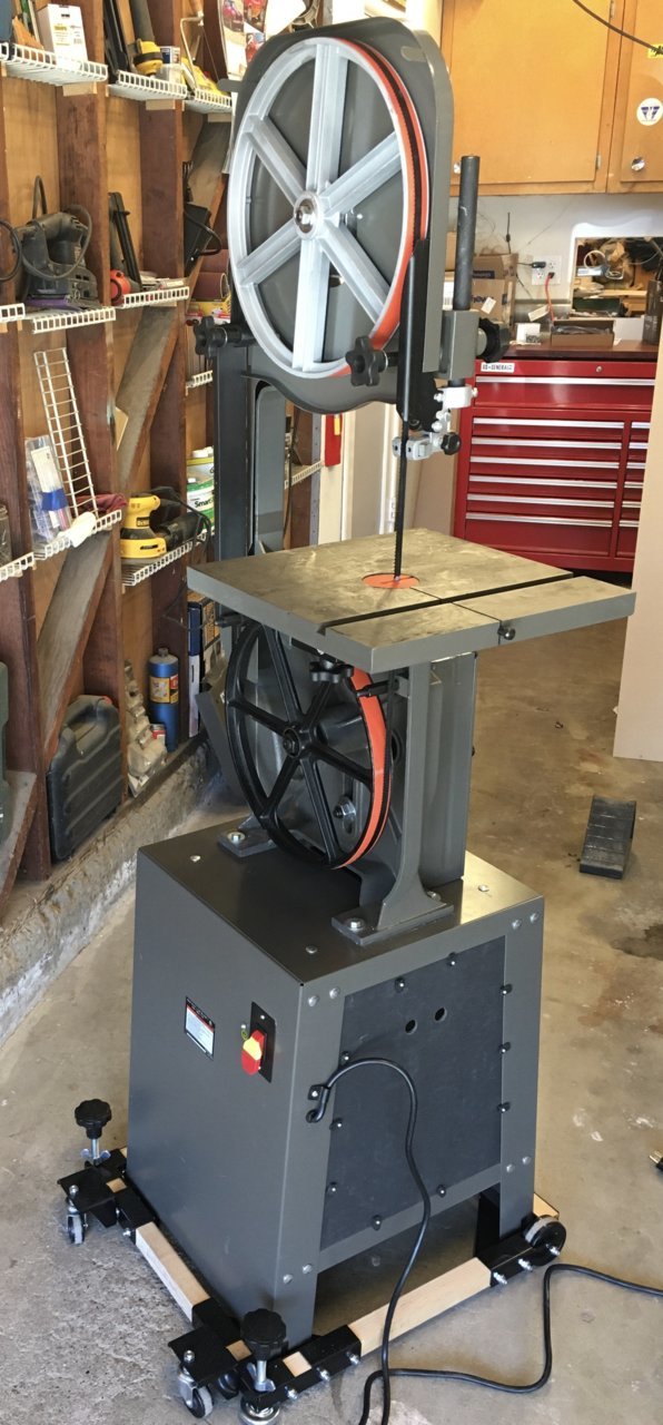

    Quick update - haven't heard back from HF rep (not surprising since it's the weekend). I got everything on, including the urethane tires. I didn't have a metric socket big enough to remove the bottom wheel (nut is bigger than 1 inch) so I had to install the tire on the wheel in place. PIA factor x2.
    Regarding the top wheel, the washer not listed in schematics and the wheel rubbing. After trying different combinations the only place it could go is between the back of the wheel and the frame. I tightened the nut finger tight then another 1/16th or so with the socket wrench. I ran it for a bit, kept checking, cut a few pieces, checked again, etc. Everything looked good and no terrible sounds. If it wears out the bearing prematurely I can replace it.
    I fired it up and it runs great. I really don't have a reference as this is my first bandsaw, plus I put in the urethane tires, cool blocks and accu-link belts. So, my experience would be different than a stock saw. I put on a 3/8" 6-TPI blade as a general purpose blade and have a Wood Slicer 1/2" 3/4-TPI blade on order for re-sawing. That said, I re-sawed a 1-1/2" piece of pine with the 3/8" blade and it didn't go as easy as I would have thought. I do believe there is too much slack in the belts and will tighten them up, plus it's not really the right blade for re-sawing. When I ran 3/4 pine through it and just cut straight or curved lines it worked well.
    Not quite done in this pic but close

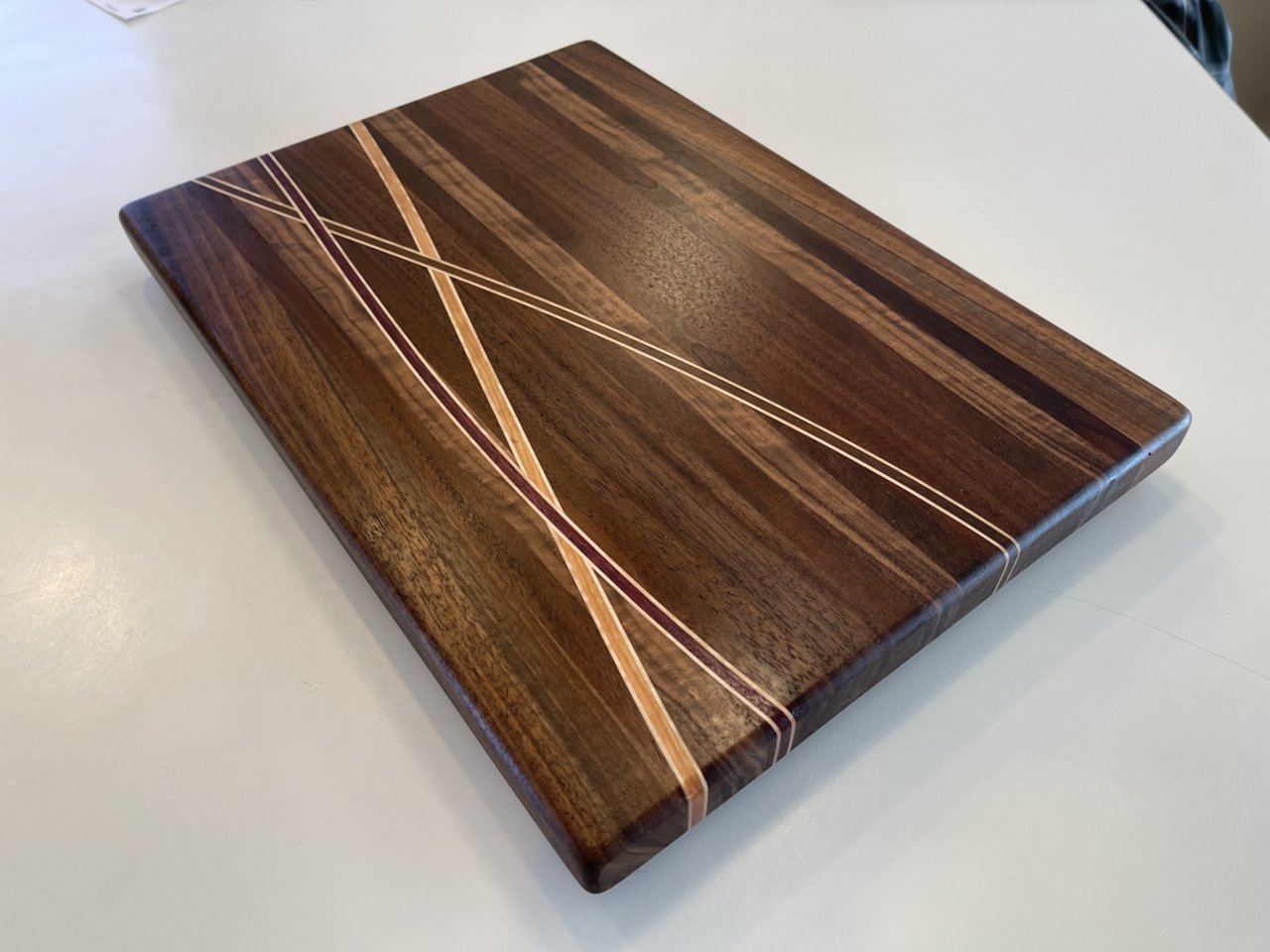

    So I helped my son make a cutting board. He’s giving it to his girlfriend for Valentine’s Day. I hope she likes it.C34146E5-845C-44B2-B3D5-CB38CA30B0BC.jpg

    That looks great! Some details? What finish process?

    Thanks, just sanded to 220, then 4-5 coats of mineral oil and board butter to finish it off.
    It’s made of Walnut, Curly Walnut, Curly Maple, Cherry and Purpleheart.

    How did you do the inlay? I saw a video once but can't find it.
