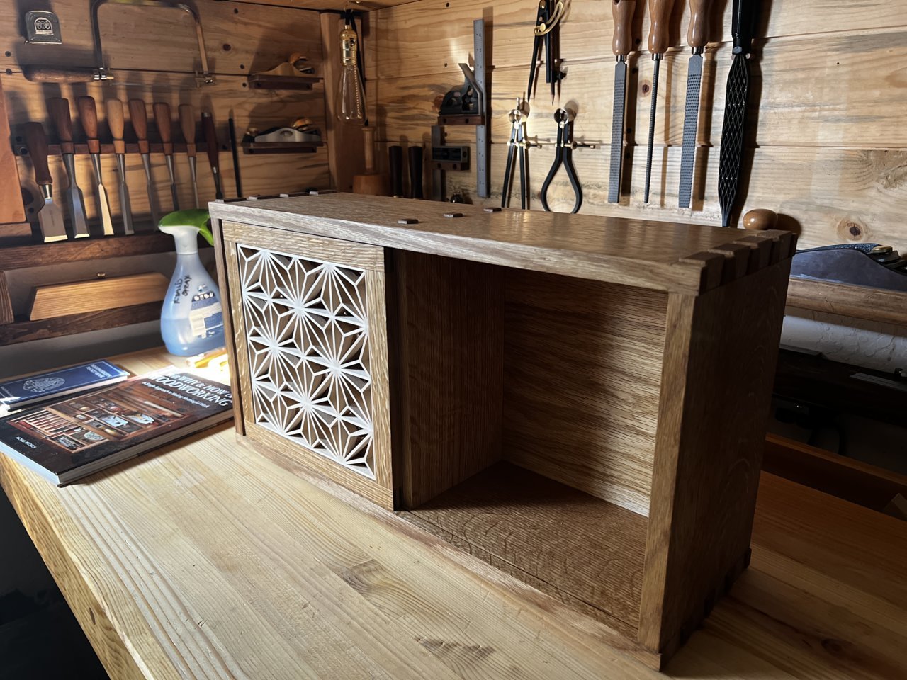

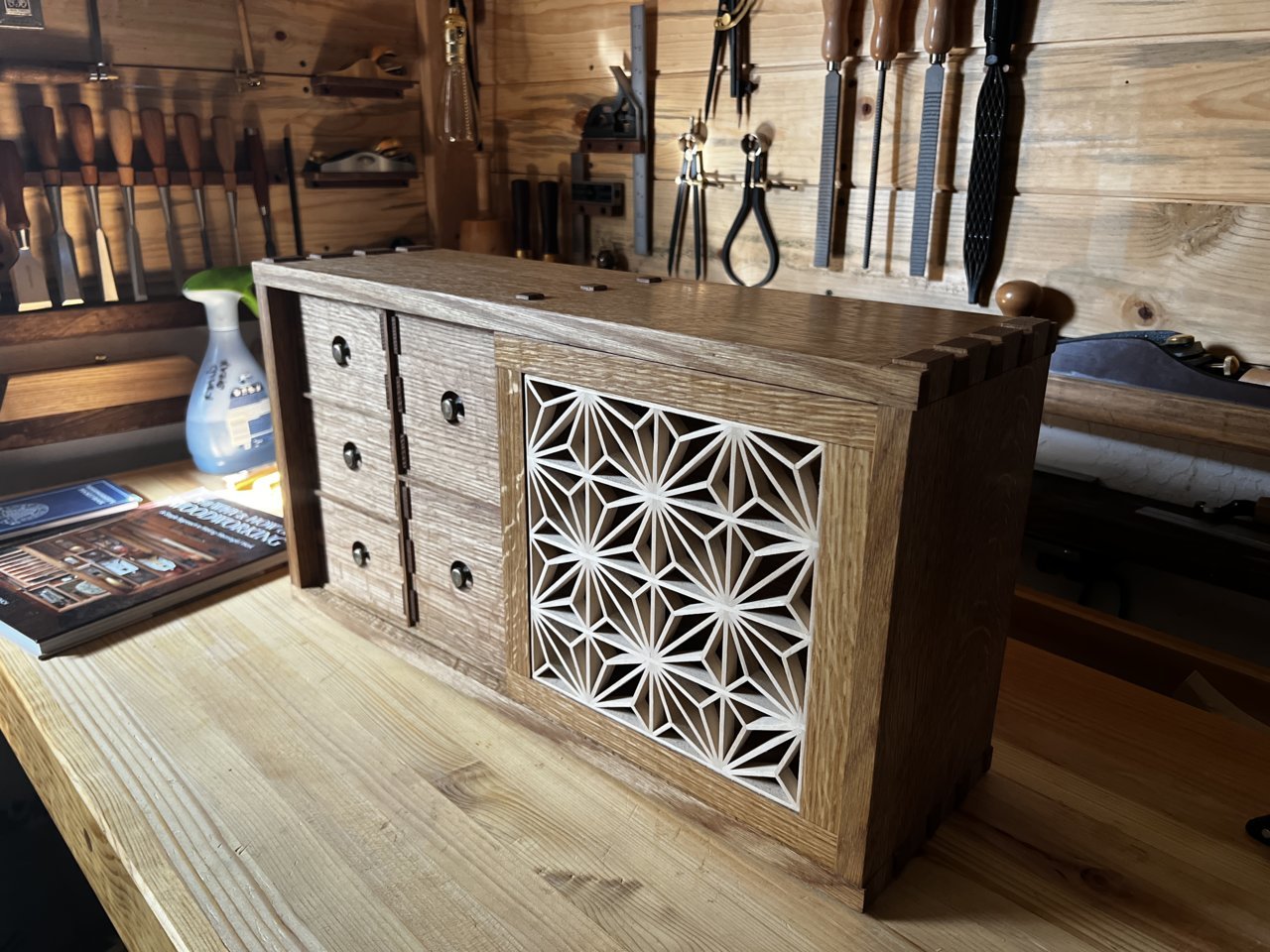

    Just wrapped this up and my Tacoma didn’t help one bit!

    That’s awesome! How long did the Komiko take?

    Thanks! If you already have the jigs and basswood to strips, it goes real fast, relatively speaking. I’d say 2ish hours for this one, over 2 days.

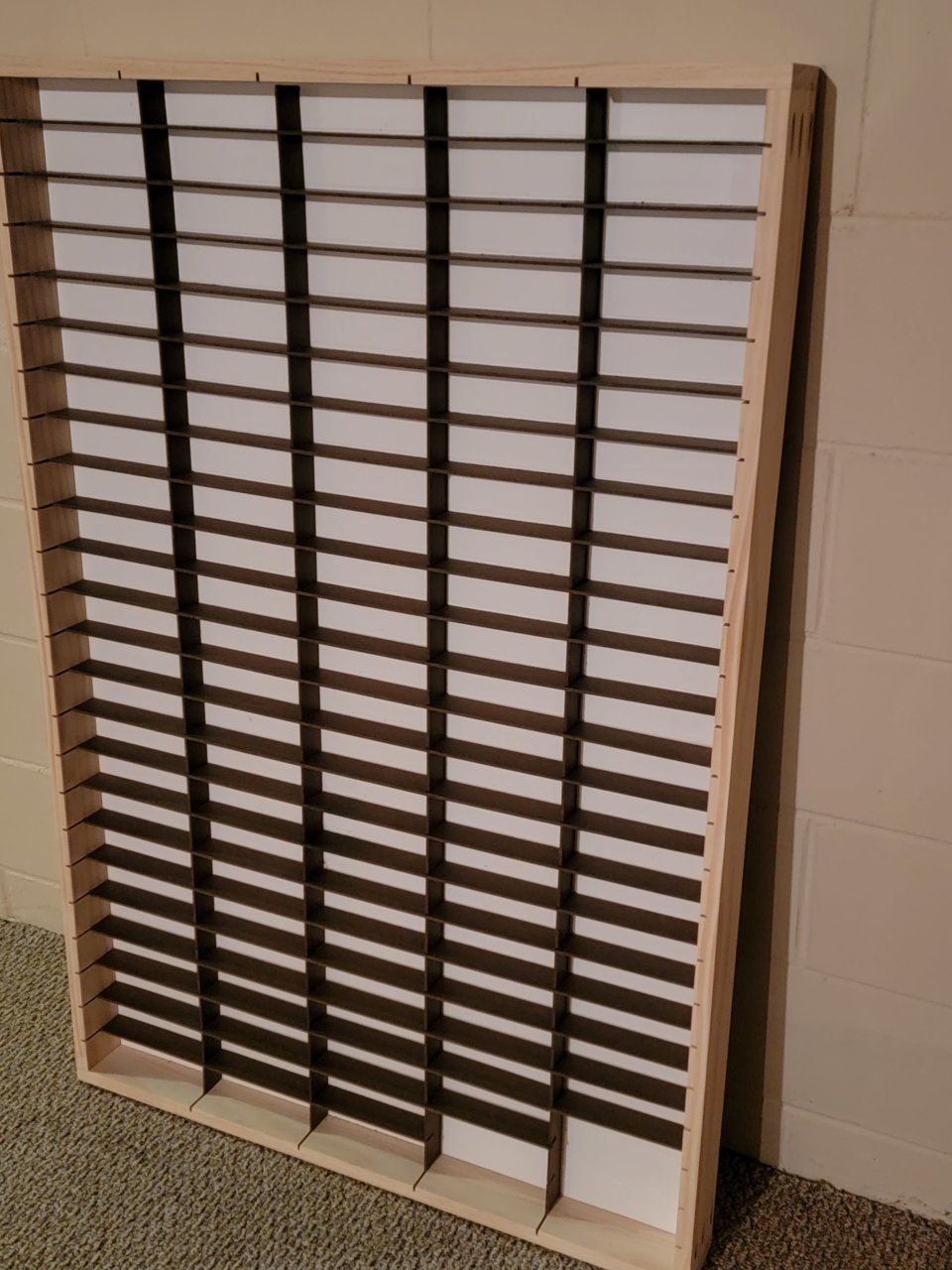

    For me, I'm looking for the wider kerf as I am using 1/8 in hardboard and it's thicker than the Diablo Blade kerf.. so I'm looking to reduce my time trying to make things fit.
    As you can see in this photo, the 1/8 inch hardboard is not only set into the outside pine, but each intersection is cut to overlap.. which equals too much fitting time when the saw blade is too narrow. The Back is also slotted into the pine and luckily this white hardboard was less than 0.125 so it slid right in.
    Additional cases like this will use the regular 0.125 hardboard back so I have to figure something out.
    I can easily get a Freud Ripping Blade that's 0.126 which should allow everything to drop in place as it's a flat toothed blade too.. but cross cutting with a ripping blade is not recommended.
