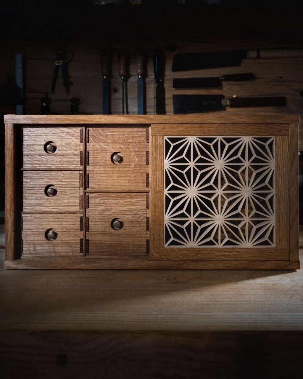

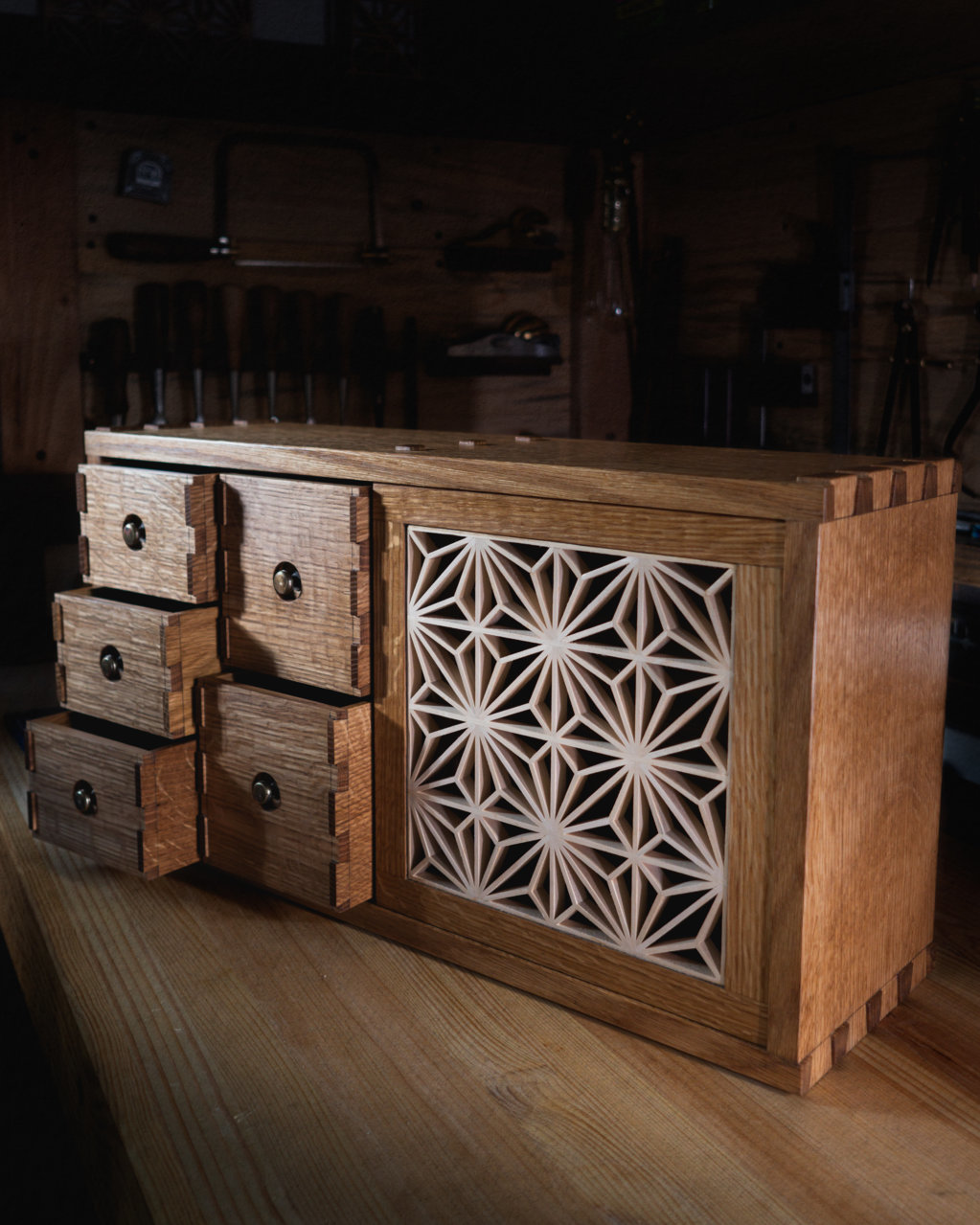

    Love it! Kind of Greene & Greene esque. Kumiko turned out great. Quartersaw oak?

    Appreciate it! I spent at least an hour looking for it in the lumberyard. Here’s a better look at it.

    That is beautiful.

    Is this "done"?
    I looks great BTW.

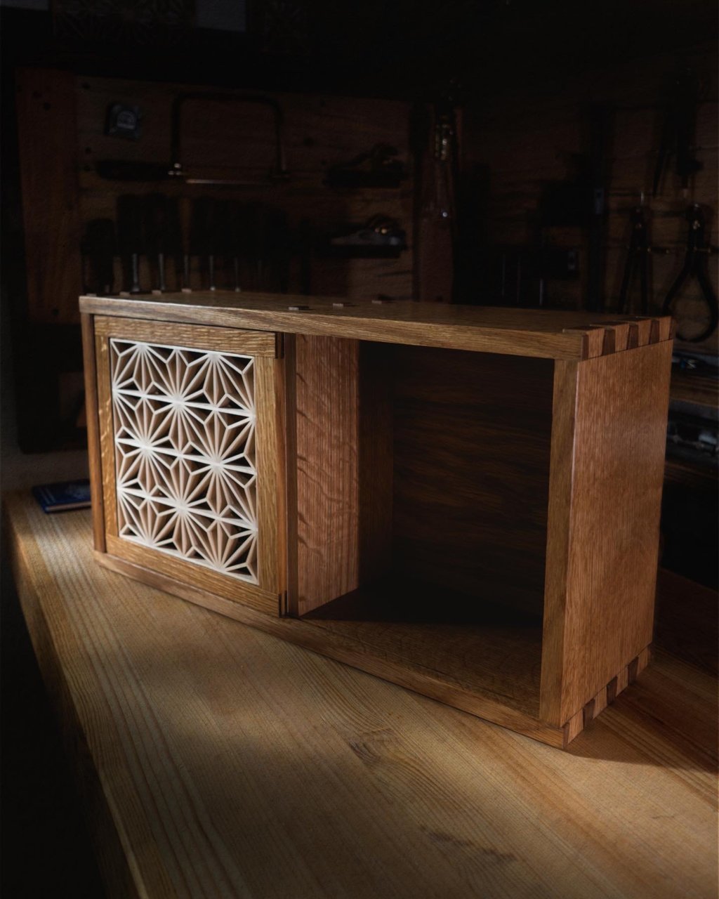

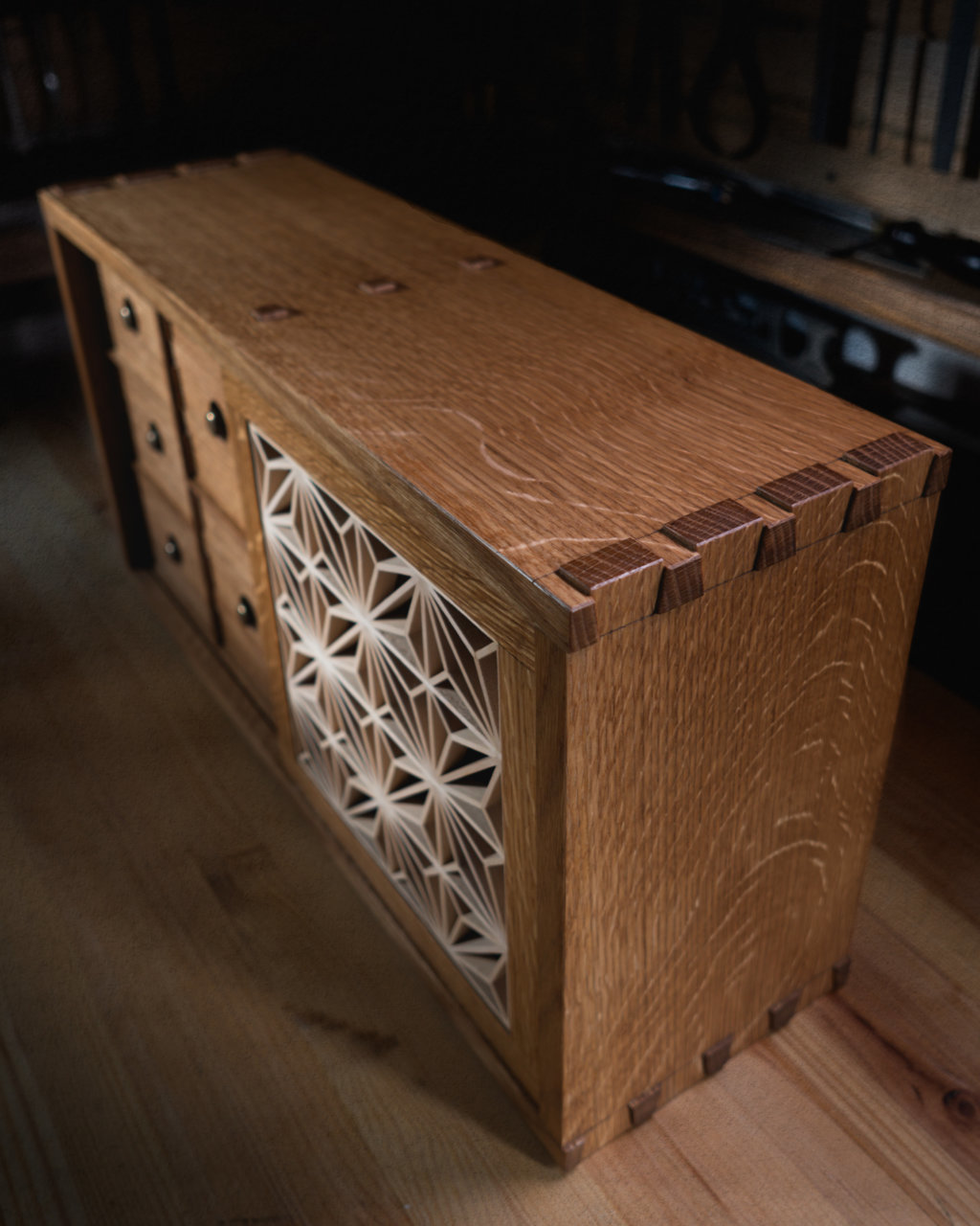

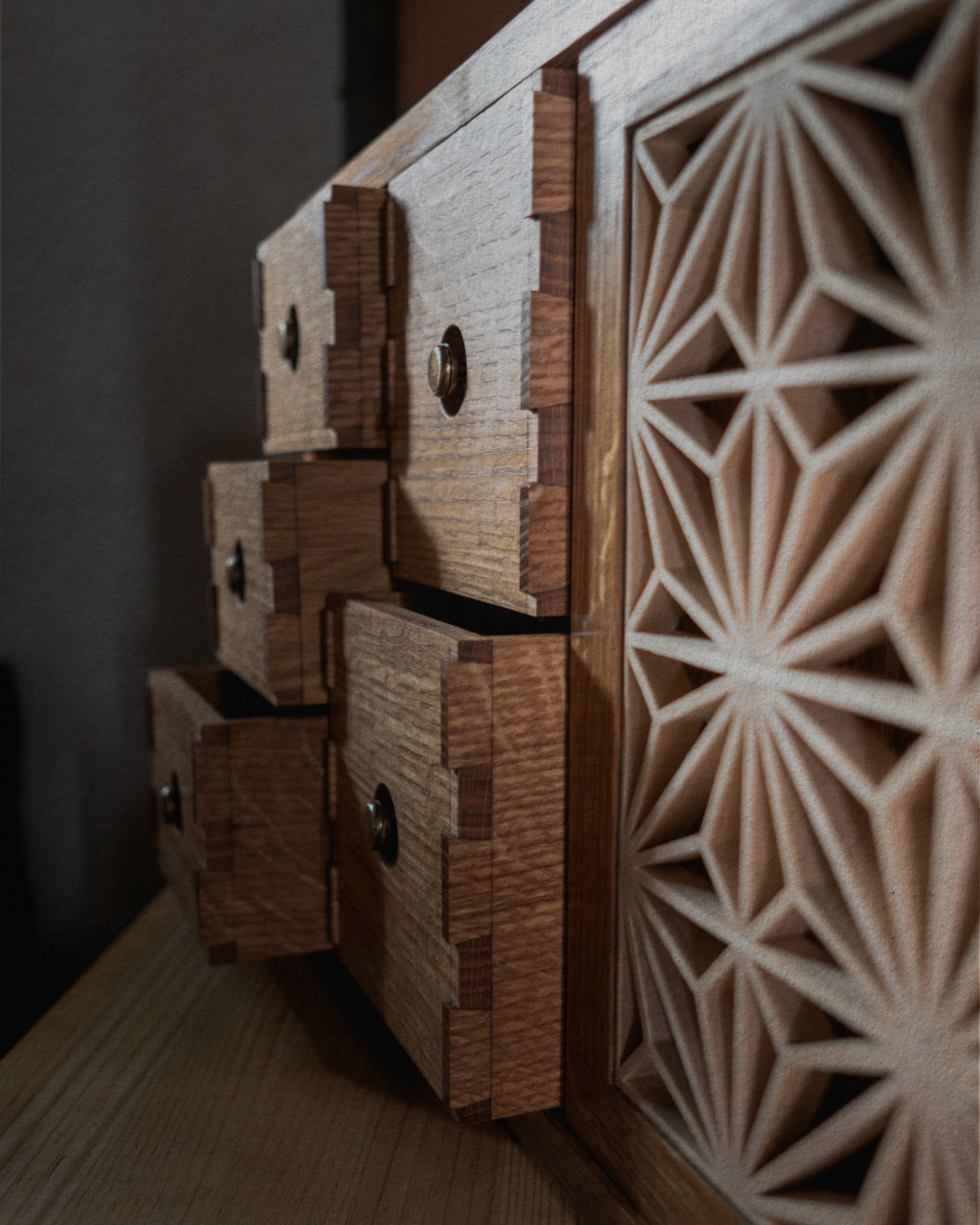

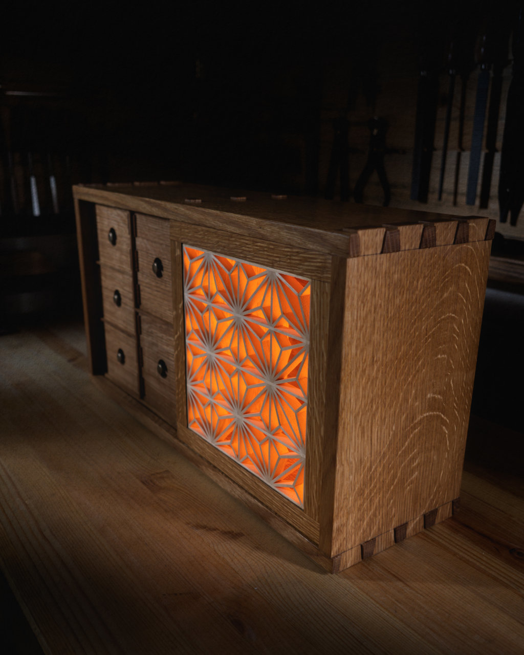

    Thanks! I’m not convinced about the hardware, but otherwise it’s done. What’re you thinking. Here’s a few more:

    Impressive work. Very nice lines, and design. I like it alot.

    What are the lines between the dovetails?

    The sign of hand cut dovetails. It's from the marking gauge.

    Typically, they aren't as visible, but the tannins reacted to the finishing method I used. Some people love them, others sand them away. I appreciate how they distinguish the difference between handcut and router cut.

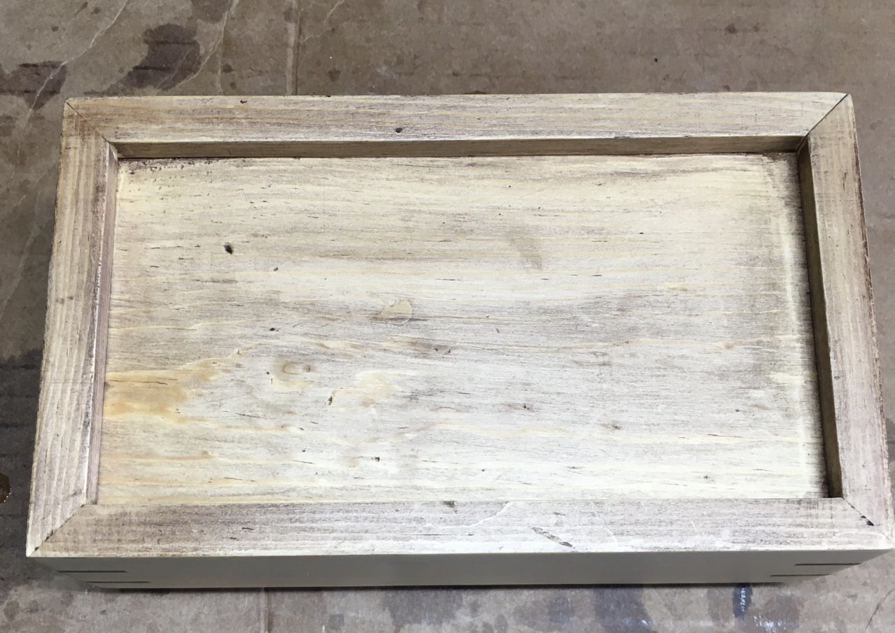

    Well... that didn't work. Applied the gel, let it sit for a few minutes, wiped it off and got this. Looks like it was drug through the dirt. I think there's too much shellac on the surface. I'm going to sand it to remove the surface shellac but leave the shellac in the pores/grain. Then try wipe on/wipe off penetrating stain. This is a test box and it's the bottom, so not too worried about it.

    Denatured alcohol gets shellac off i believe

    Or it will drive it into the pores more. Shellac has DNA in it. It's the solvent that dissolves it.
    @916carl
    Do you have another pine board you could use instead of the box?

    I mean, this AND you could probably get rid of most of it...but is it worth all that time? Would take a pile of rags to be sure.
