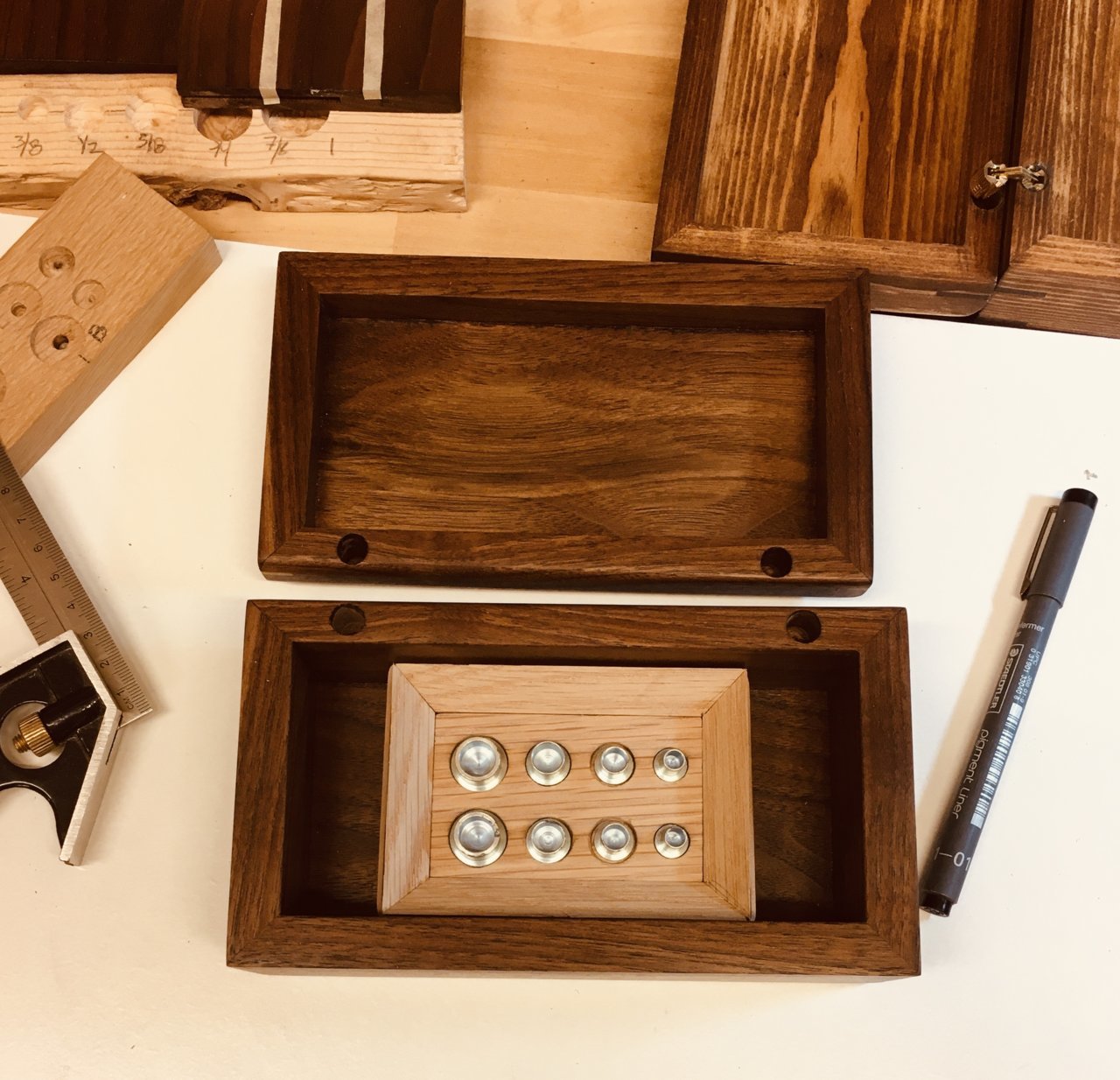

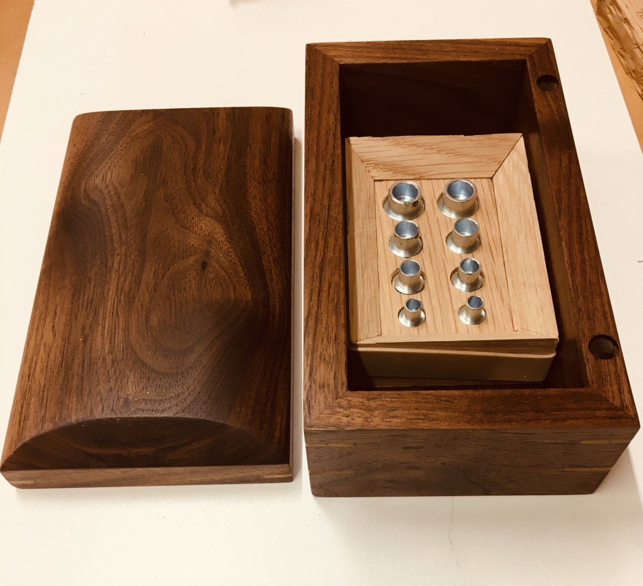

    I ended up sanding it. Hard. Got most everything off, then used a penetrating stain on the whole thing. Still looks like crap, but I'm moving on. I'll revisit the finish another time. I glued in the hidden barrel hinges on the bottom (actually used epoxy) yesterday. I'll need to enlarge the holes in the top in order to get enough movement to line the top up when I epoxy the top onto the hinge. That was practice for how I want to glue up the walnut box. I'll do both the top and bottom at the same time, close the lid and get everything lined up. Let the epoxy cure for 8 hours and see if it opens!

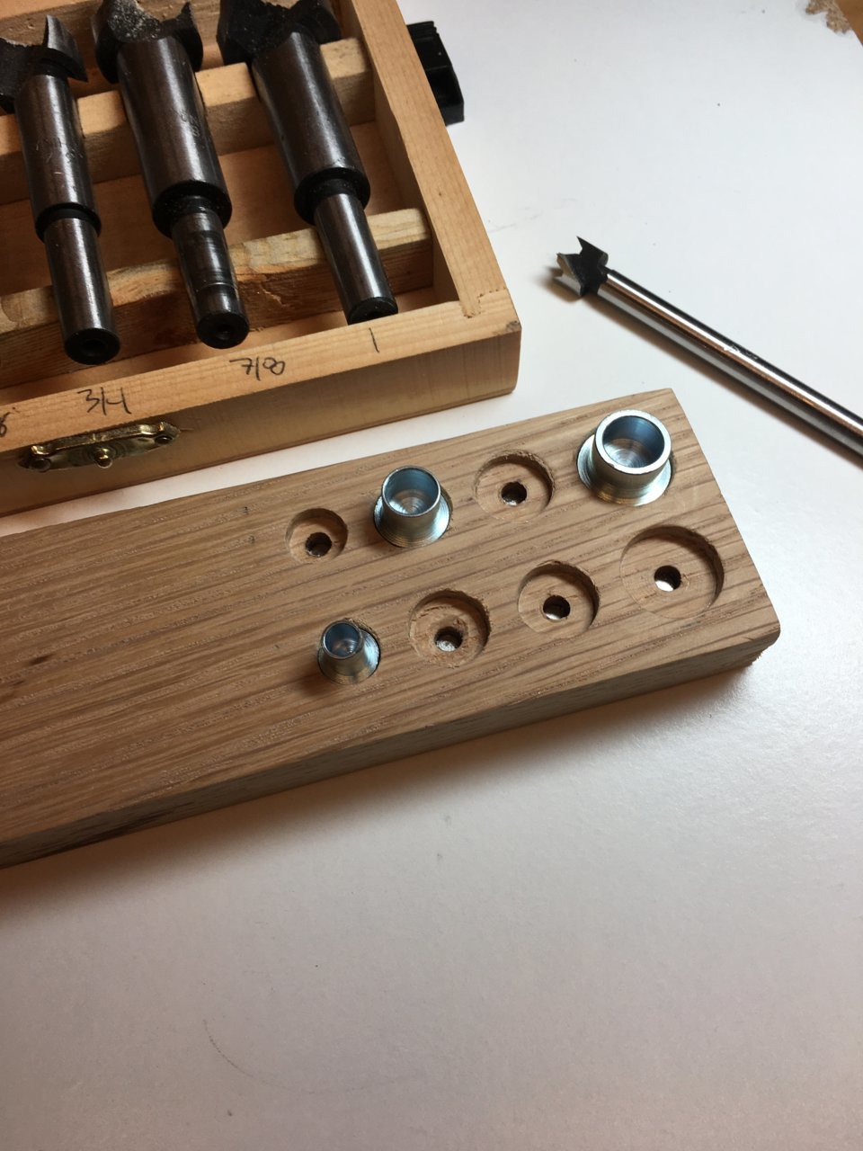

    Today I made a tray for the dowel pin markers that are going in the box. I cut down a rift sawn oak floor board and made this thing. It's just held together with a big rubber band for now. I've got to sand and shape it for a tighter fit. The little magnets and the forstner bit drilled flat holes work great.

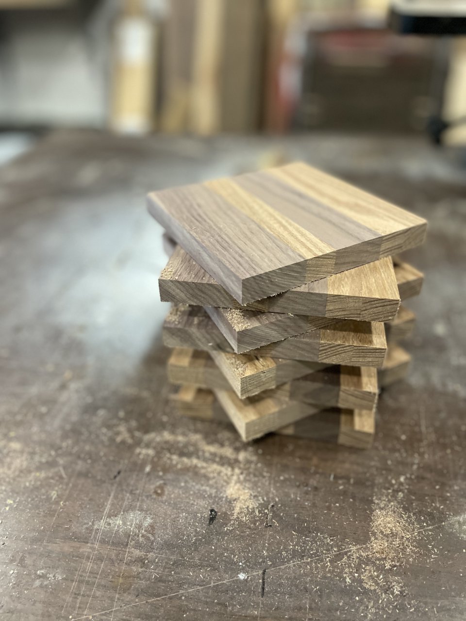

    26A63705-DD62-4089-81C3-611971EA2B15.jpg Working on 2 sets of coasters from some scrap Walnut & Red Elm I had. Still need to Chamfer and then probably going to laser engrave a set with TRD before applying Walrus Oil, hah

    How do you like working with the Elm?

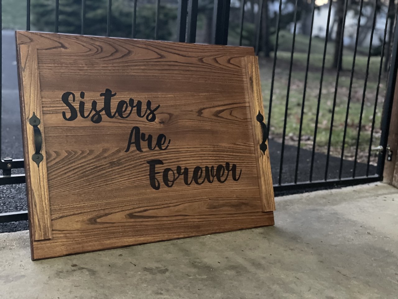

    I actually really like it. Fairly easy to work with. I did this Stove Top Cover for a customer in December so I could test out flattening it on my CNC. This is stained with Varathane HoneyA3753D83-49AE-405A-8F52-F6821F23FC87.jpg

    Very nice. I like the tone of the wood.

    Picture quality doesn't do it justice but I love the grain on it. Red Elm is up there with my favorite Cherry now.

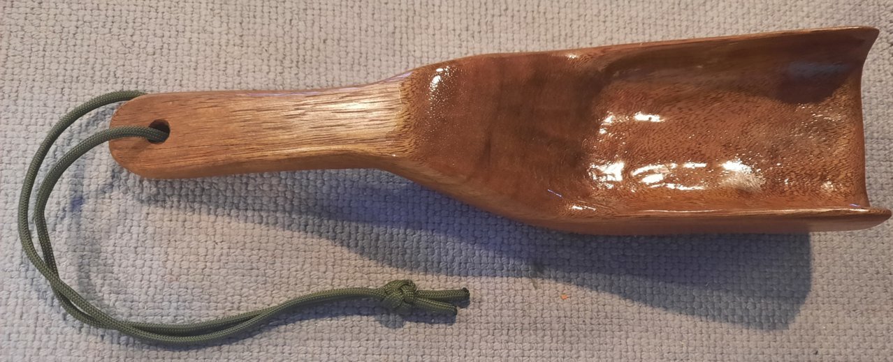

    Utility scoop

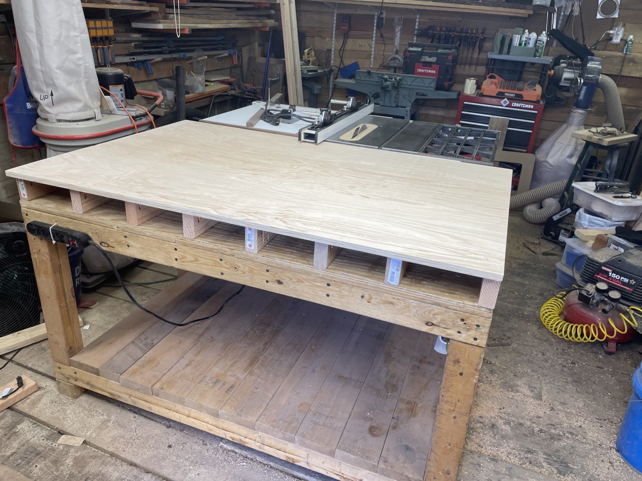

    Finally made time to lower my outfeed table to match the height of my new table saw.

    Looks good. Going to add miters? Where's your router table? I didn't want to fork out the cash to add one to my table saw, so I built one into my outfeed table, just an unsolicited suggestion.

    Router table is in the wing of my table saw. I installed a Jessem lift and I love it.

    Ah, now I see it! I might have to upgrade soon, so I'll definitely look into jessem.
