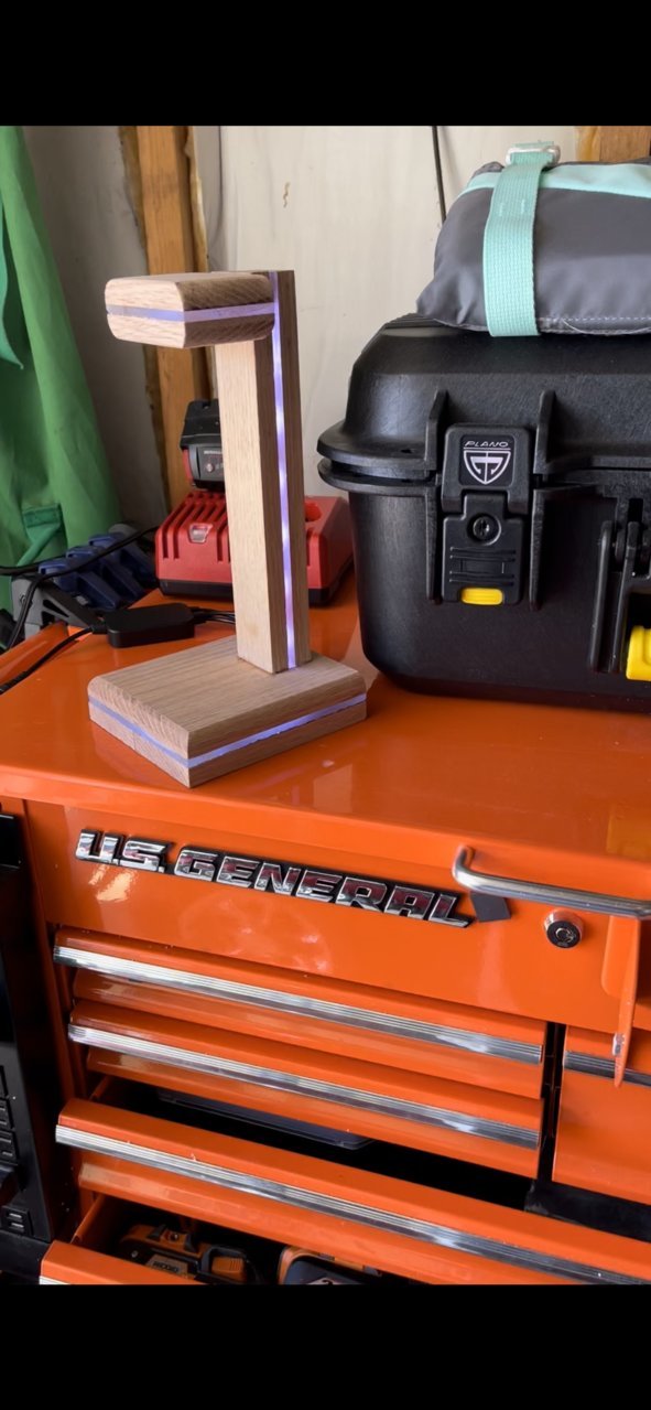

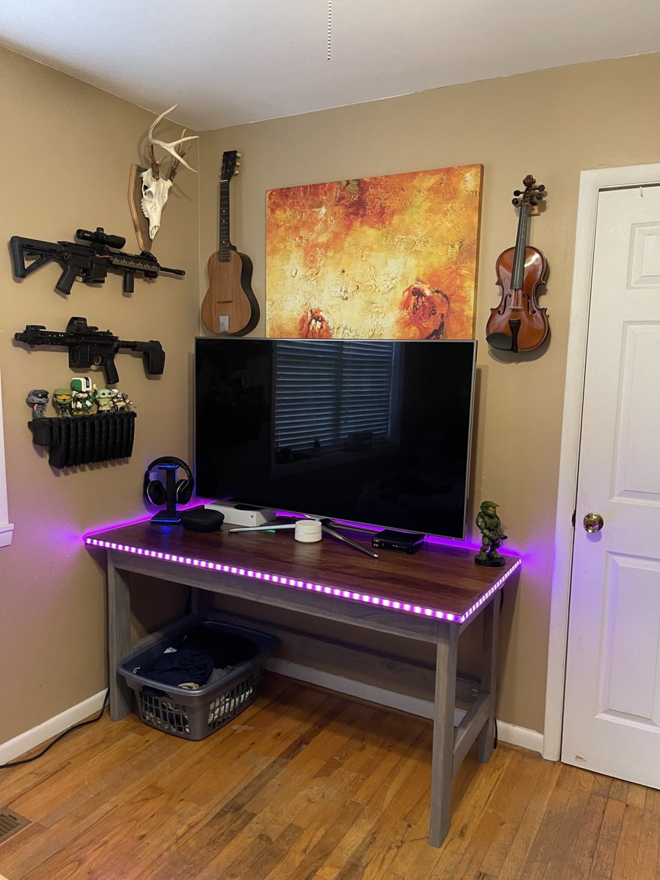

    I have not, but can if you guys care to see. Just disregard everything else in the room; its kinda just a placeholder for the time being and lots of things being moved around, so disregard any "decor". I'll also attach my other project, which was a DIY gaming headset stand/holder/thingy.

    Couldn't figure out how to upload video, so just snagged a still shot from a video I took of it. The LED strip is RGB, and extremely customizable. It looks horrible in that pic at 100% brightness, but is pretty well diffused on lower brightness, so you can't see the individual LEDs. It usually doesn't stay on pink either, but that option is there if I want it! haha. The headset stand is oak with plexi sandwiched in between each piece. Each piece got a channel routed on the inside piece facing the plexi, and routes to a single wire coming out the backside. Those LEDs are also RGB.

    Not gonna lie, first thing that popped into my head when I saw the first pic is "The devil went down to Georgia, he was looking for a soul to steal...". Now I'll have that song stuck in my head for the rest of the day.

    Music equipment and pews make great wall art lol. Takes the attention away from the fact that some idiot tried to build a desk out of cheap warped 2x4s and 2x10s lol. I'm happy with the outcome though. I hope the grainy pic hides all the other imperfections haha. I'm happy with it though, and it serves it purpose at the end of the day. If I ever decide to build a better replacement, I'll have a fancy stained workbench for the future garage haha.

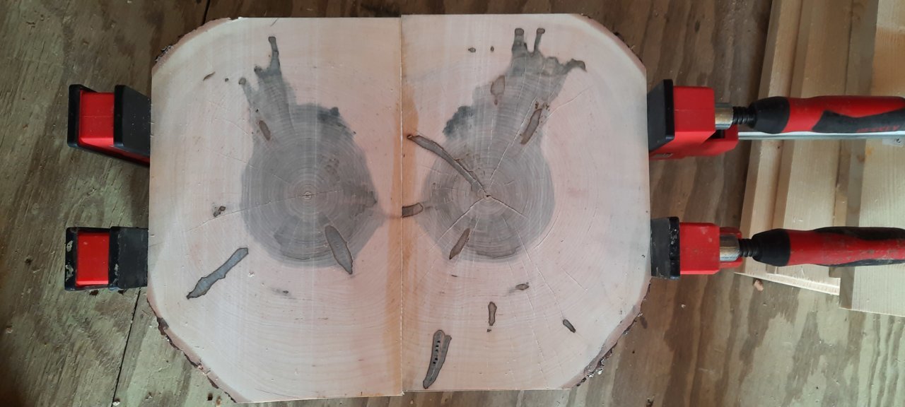

    Unique cutting board in work...

    Nice. Ambrosia Maple

    Yep, was trying out the NOS, delta planer. I think i nicked the blades on something in the bark. :eek::anonymous: its not bad but i still noticed it..i can sand it out.

    @wilcam47 if you're running that through a planer on the end grain like that you're just asking for trouble. The wood can break out on the ends or the sides and not only ruin your piece but anything in its path.
    The only way I've found to do end grain in a planer like that is to make a frame for it. I usually use scrap pine 2 x 4 and trim the height down to close to the thickness of your wood. By doing this, it reduces the chance of a tear out or a chunk of wood through the wall or your eye.
    Safety first gents!

    Definitely. Not sure if it was this or the hickory board i was planing down causing the nicks. I do stay clear of inlet area. Just for that reason.
    Ill do the planer box next time.
