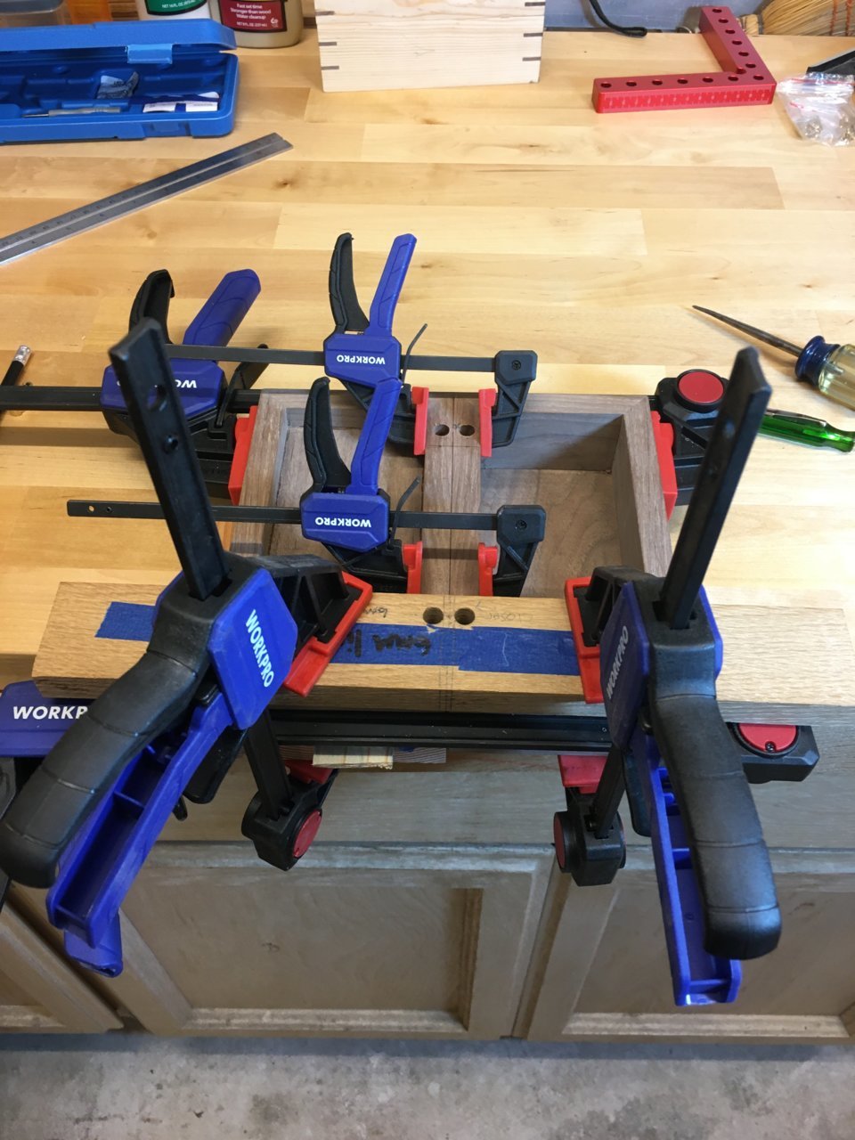

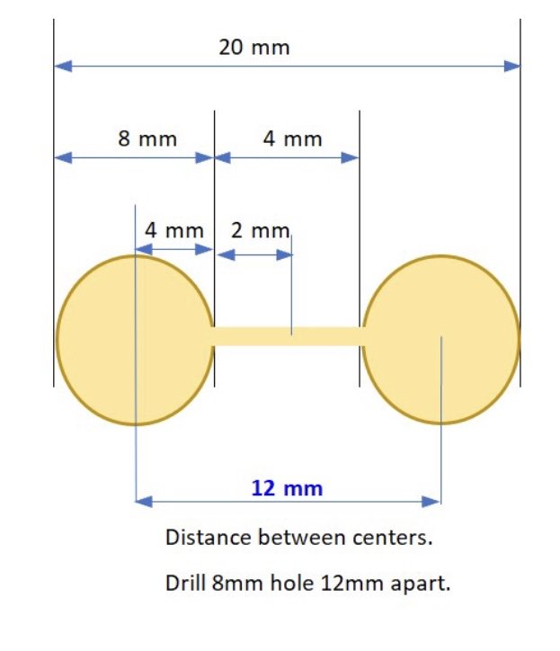

    There is no adjustment or room for variation. Everything has to be exact. For instance, I needed to space the hinges 4mm apart, but had one at 3.78 (or something like that) and it wouldn't work. When open, the distance between the near edges of the holes is 4mm. That means the holes have to be 2mm away from the edge. That's a pretty thin wall. Also, the 8mm barrel hinge is slightly larger than 8mm (something like 8.1). So an 8mm drill bit is too small. I had to drill 8mm, then use a smaller bit wrapped in sand paper to enlarge it. It's hard to make it consistently larger in each direction, which throws off the exact alignment off. I ended up jamming pieces of toothpicks around the hinge to hold it in place, then try opening and closing, adjusting the toothpicks, try again, until it worked. Then JB Weld them in.
    I tried a jig, clamps, etc. on a lot of test pieces but didn't find a sure fire method. I will say I'm new to woodworking, so it may be easier for someone with experience.5FD890F8-8E5E-4E76-85DB-0000B5DEA0E2.jpg

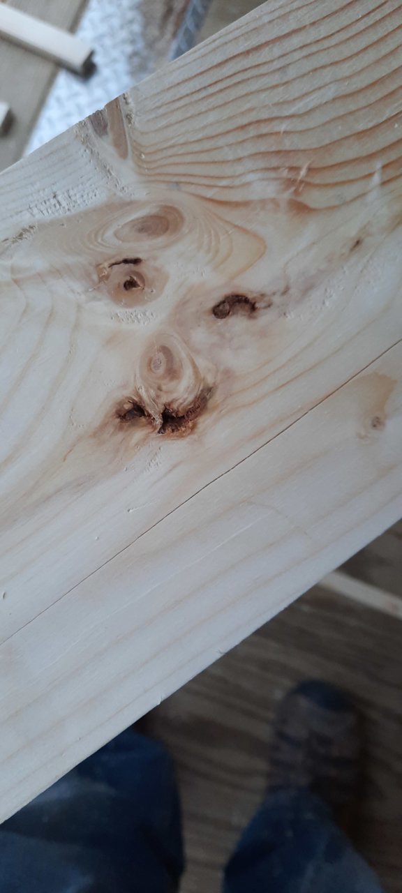

    Funny looking knot in a board im using

    Sort of a Salvador Dali thing going on there. What are you using it for?

    Its in a drawer for a side table. I'll take pics tomorrow

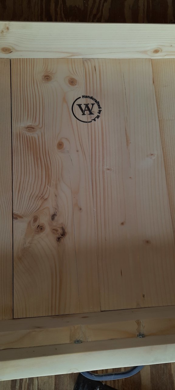

    Working on a endgrain cutting board also

    Hey! You got a branding iron too! Nice table. Night stand, side table or...? Edit - Maybe it's ink and not an iron...

    Branding iron

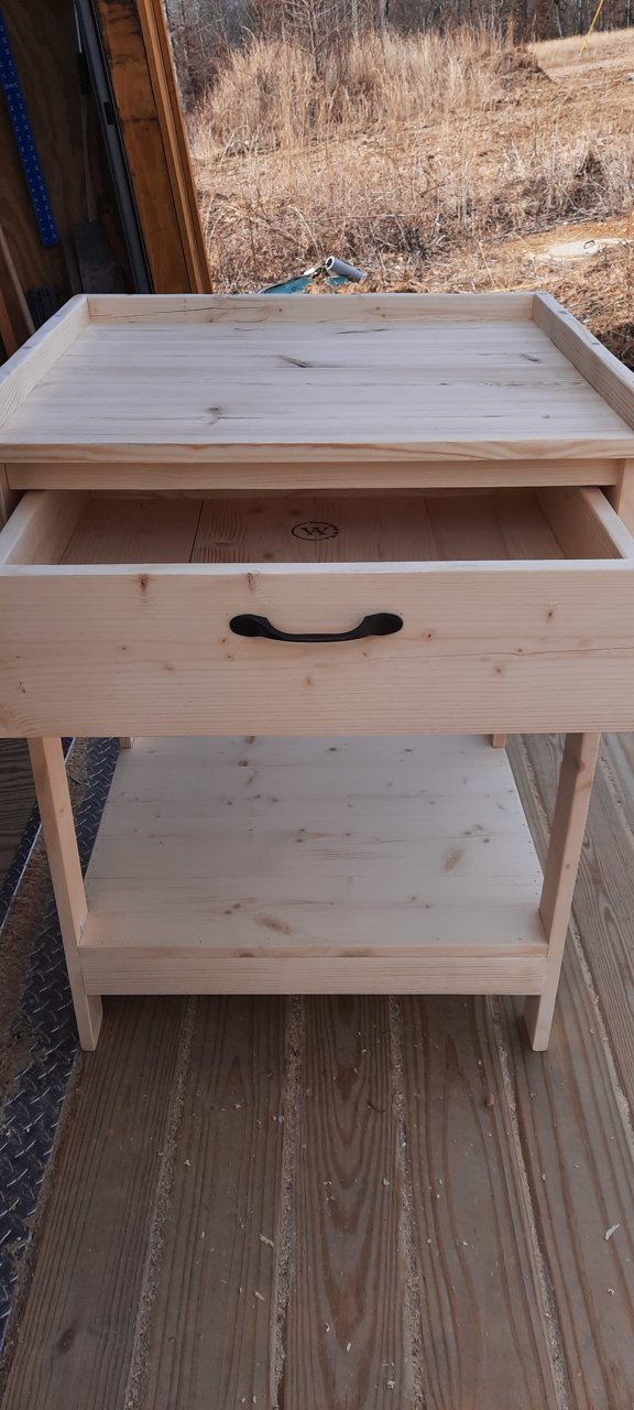

    Side table/storage. Stain tomorrow...too cold outside to cure the stain

    Pine? How are you going to stain?

    Yep, good old "cheap" stuff. I just hit it with ebony stain wipe excess off.

    I'll have to see if I can find a pic of the GF's kitchen before we remodeled it. It was knotty pine cabinetry and there were "faces" everywhere. They weren't very pleasant looking either.

    Yeah some can be scary AF
