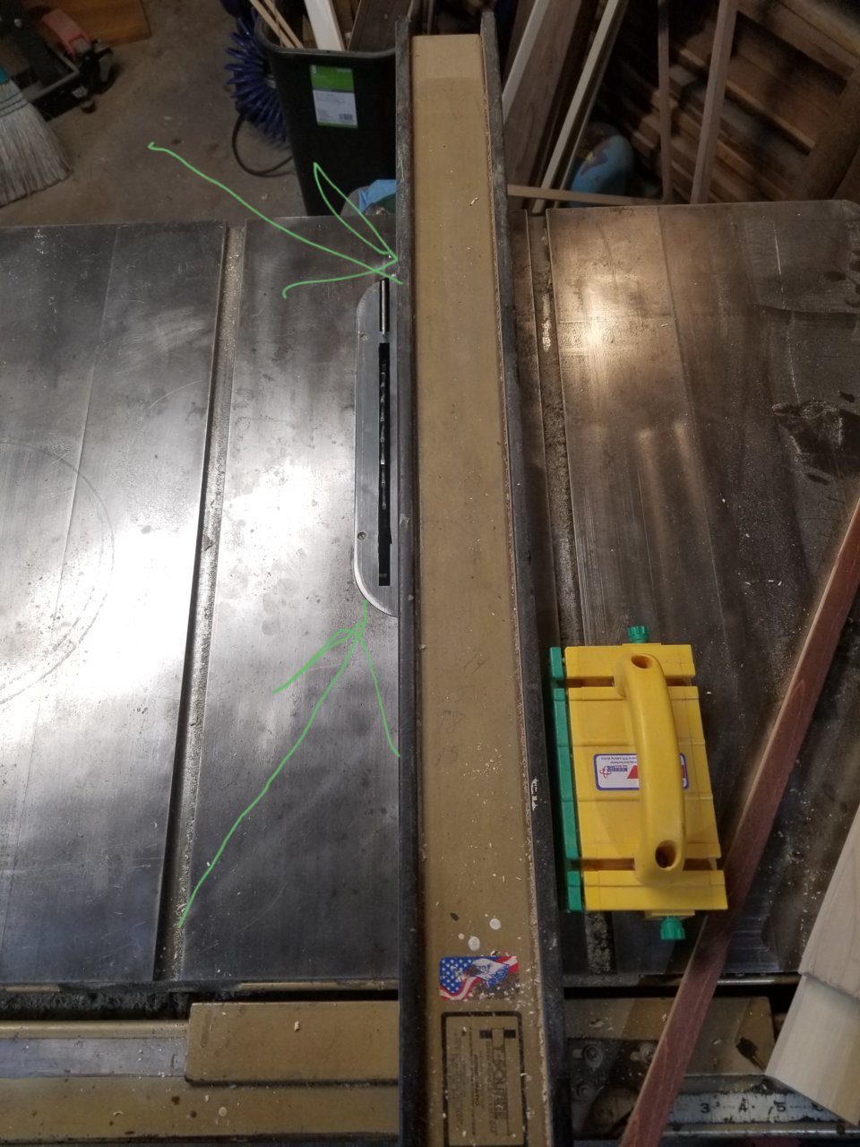

    I have a brand new Freud blade in mine.. so I checked a few other blades with the same sort of results and two different digital angle finders etc.. I've just resigned myself I need a new modern table saw.
    If you make a cut in say a 1x4 then take those two pieces and stand them on edge and put them together- you can see how off the cuts are.
    I'm not smart enough to know what the real fix is.

  2. Mar 11, 2022 at 8:21 AM
    #8742
    xJuice
    xJuice My spoon is too Big!
    Oct 24, 2007
    #3208
    9,910
    Josh
    N. Texas
    19 Tundra MGM
    TRD Front & Rear Sway Bar, TRD Pro LED Headlights, Undercover SE, Rear diff. Relocate, console organizer, debadged, color matched handles, mirror caps, and grill
    Maybe the table is slightly out? Bows down to one side?

    That means the table needs adjusted if I understand you correctly.

    For me.. using a magnetic digital angle finder stuck to the blade, it takes the table imperfections out of the equation.

    i know you can flip one board 180° and it should mate properly.
    its more of a square issue like kilo charlie says above. But you prob wont notice it on a table leg but when making cutting boards you notice it in the rip side lenghths.
    perhaps. I havent dug into it to see where i can adjust it. The top is flat with a level and if i square it with speed square right side is 90° but left isnt. And vice versa. Just seems odd.

    Are you talking about a difference between one side of the blade versus the other?

    Perpendicular

    Ok. Yeah that's weird. Not sure how one side can be 90 and they other isn't if the table is flat. When you rip a board, is the cut off square?

    Could you flip the blade and put it in backwards (obviously don't run it) and measure how much it's out by? If the side that is out flips, then it's the blade thats out... if the side that is out stays the same it's the table.

    Could it also be variations in the arbor or even something on the saw blade shaft?

    took out blade...mofo is definitely not square...:annoyed:one side is flush with speed square one is not:goingcrazy::frusty:

    the blade isn't flat?

    One side of the blade is...

    What brand of blade?

    As in, teeth on one side were ground flat relative to the saw plate, but teeth on the other side were not?
