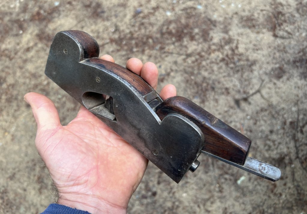

    Was given this today by my uncle ~
    my great grandfather's Preston plane , circa 1900

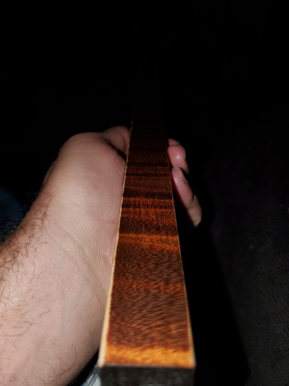

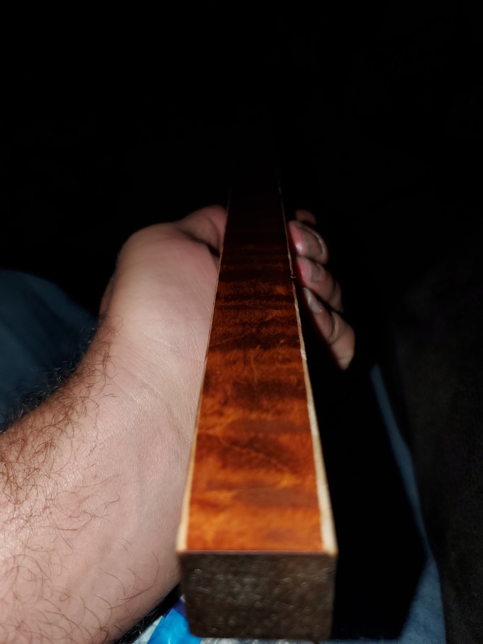

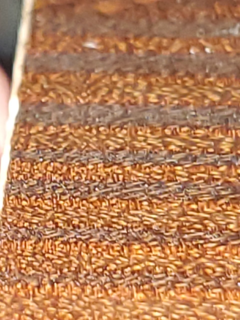

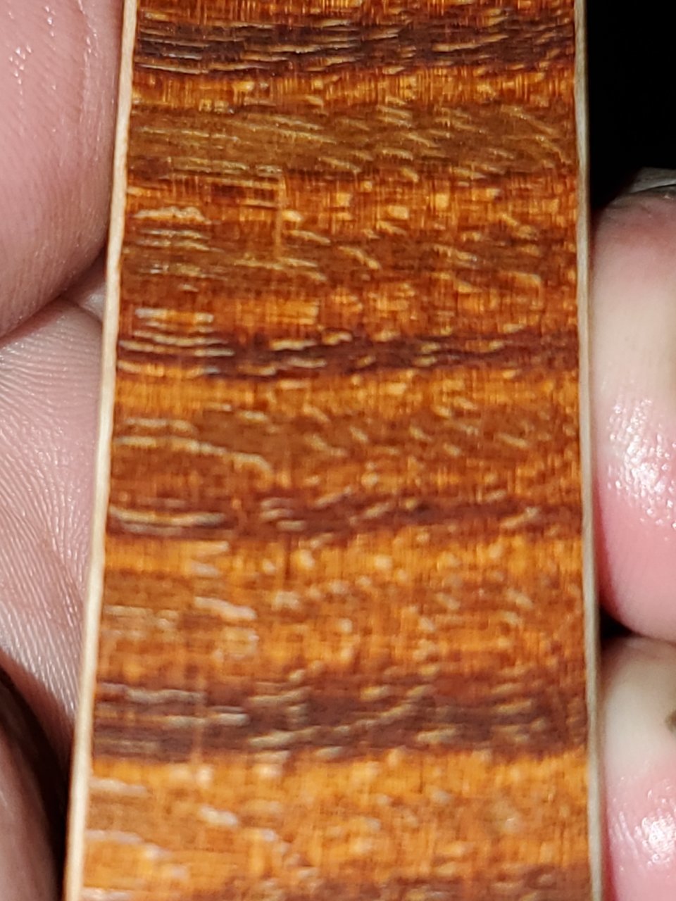

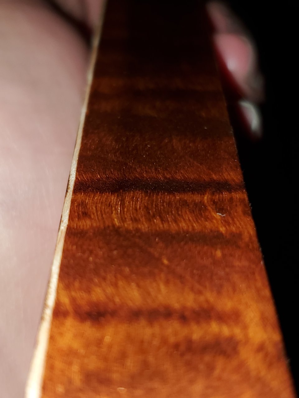

    I found a 1931-1932 Bailey Stanley #3 hand plane for 20 bucks today. The blade was in upside down, and it looks like a sharpening attempt was made with a file. Since it couldn't work anymore I guess somebody tossed it on a shelf and there it sat.
    A young man inherited the machine shop I found it at, from his grandfather.
    I spent about 2 hours after morning church getting it cleaned up, and the back of the blade flat and polished.
    When I flipped it to start fixing the primary bevel it had been filed or ground completely off square. So another two hours to get the primary set.
    Here is a photo of another aqua fortis test no sand paper straight off the plane on a piece of cut off scrap.
    One photo is 10x magnification.
    The edges were just blocked planed afterwards to keep my son from bashing himself or someone else with a sharp edge. 16544873419205877021607814460867.jpg 16544873893728214820250727261333.jpg 16544874117435491181246521358073.jpg 1654487482936739706801117926016.jpg 16544875129338044162737716557998.jpg
