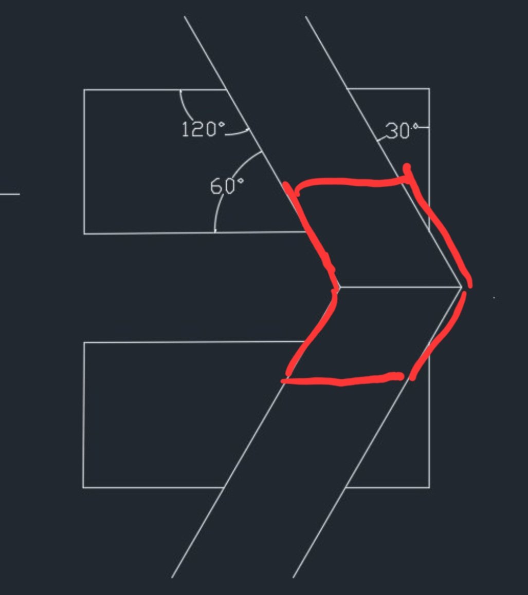

    Can somebody coach me on how to clamp a 60 degree miter?
    is it as simple as clamping a jig to get a parallel force to get 90?

    If you still have the offcuts, you can flip them around for the complimentary angle. Check out this video around the 5min 30 second mark for about 2 minutes for a visual.

    What material? If it's hardwood you can use CA to glue some plywood blocks to it. Clamp them up and then knock the plywood off after. The veneer from the plywood will stick to the hardwood and you just sand it off to clean it up.

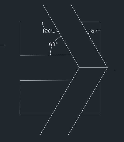

    I am building a hexagon wedding arch using East Texas cedar. I'm joining 2 boards, each with a 60 degree cut from a plan that I bought off of etsy (Don't judge, I'm new to this and really bad at math)
    My solution was to build a jig utilizing block clamps as others mentioned to get a parallel force through the middle of each of the boards; if they're joining together each 60 degrees, i just need to figure out what angle to cut the block at to get that force through the middle. Pics below if it helps

    Glued end grain is not very strong. Metal straps or plywood gussets across the joins would strengthen it. And it would be easier to assemble and disassemble

    You can use the blue tape super glue method to attach them.

    i would make a simple splined miter at the angle. Just make it 1.5"-2" then you can glue and screw into the spline. On the flat side if that makes sense

    Dado or router with table you can do it. Basically run the angled piece on the table. Depends what tools you have or you could dowel it also. What thickness are the boards

    Or make a template piece like this. Then screw from front, fill screw heads with sandable putty
