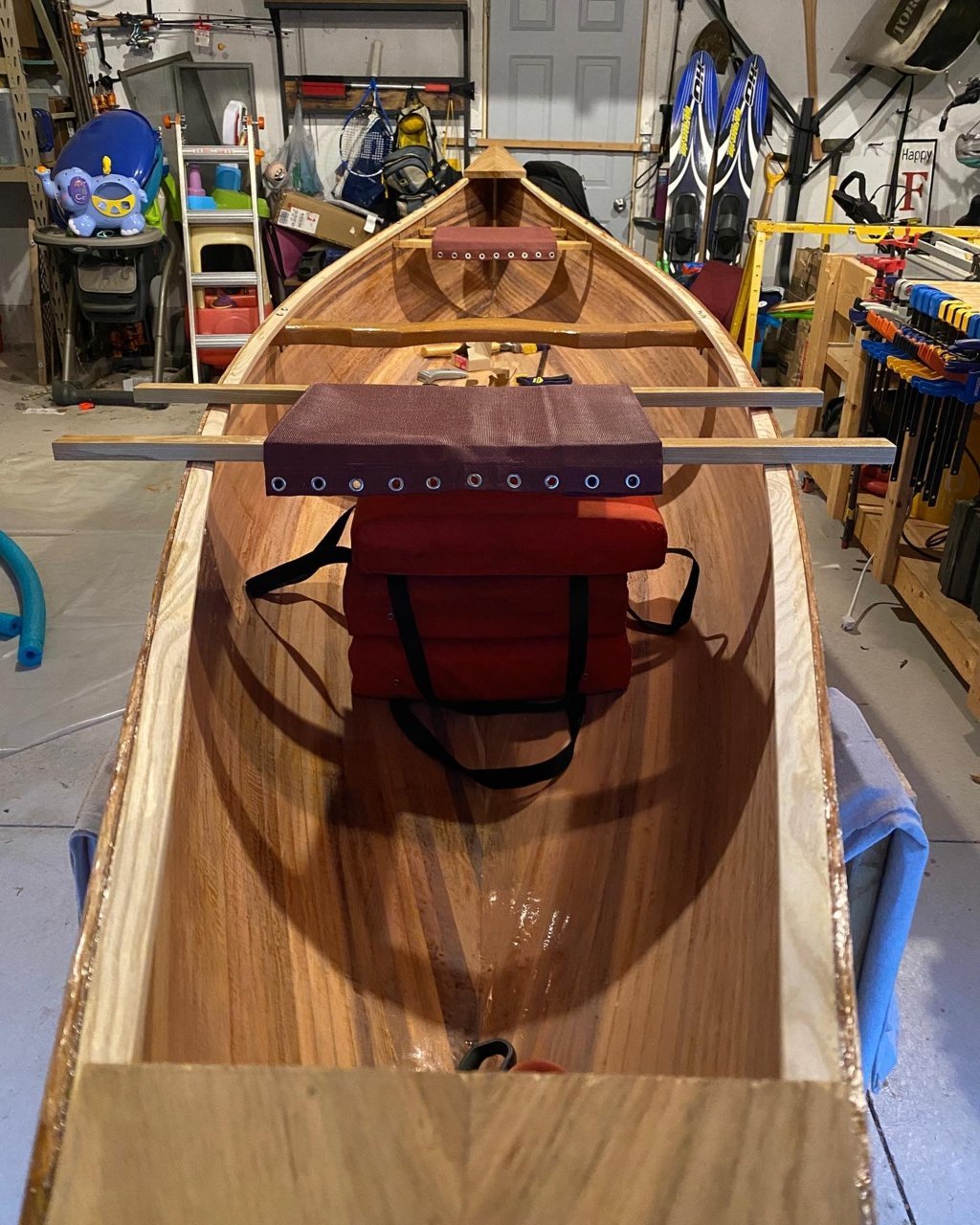

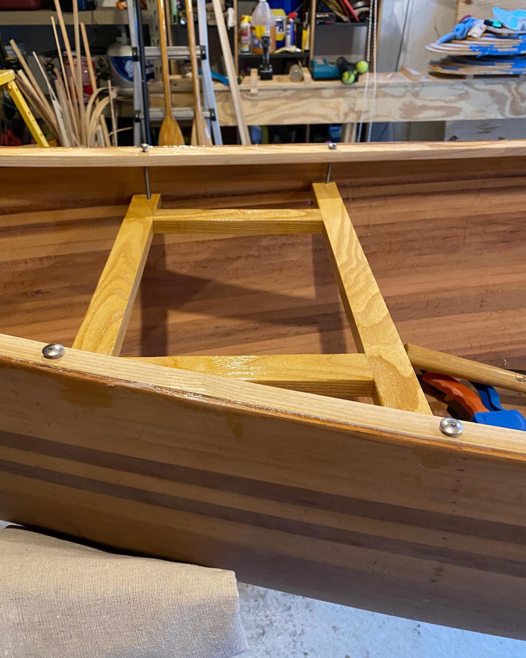

    Getting closer…

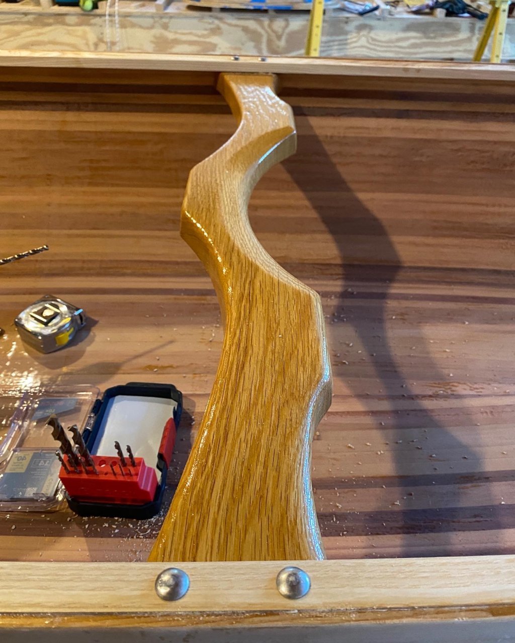

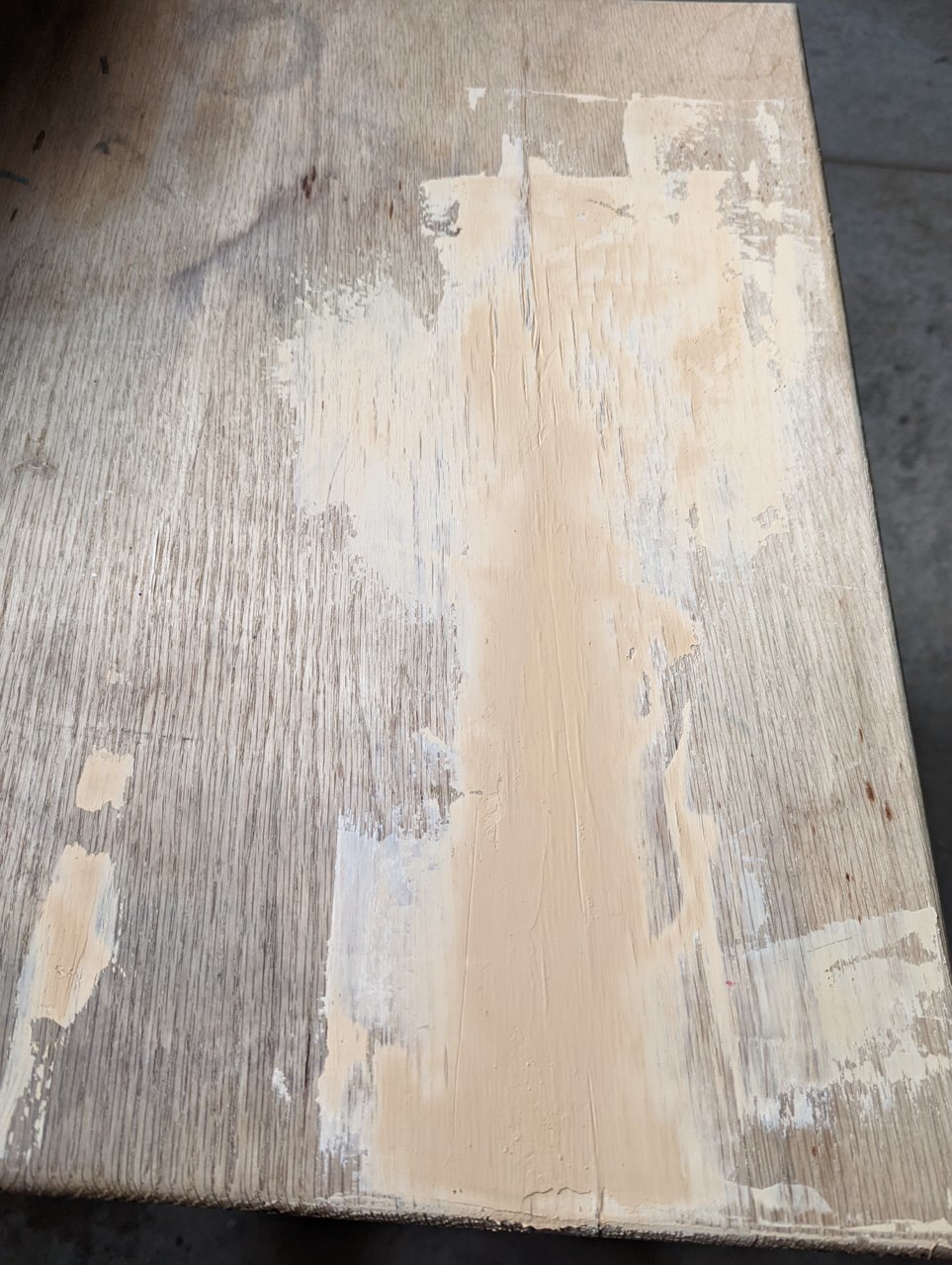

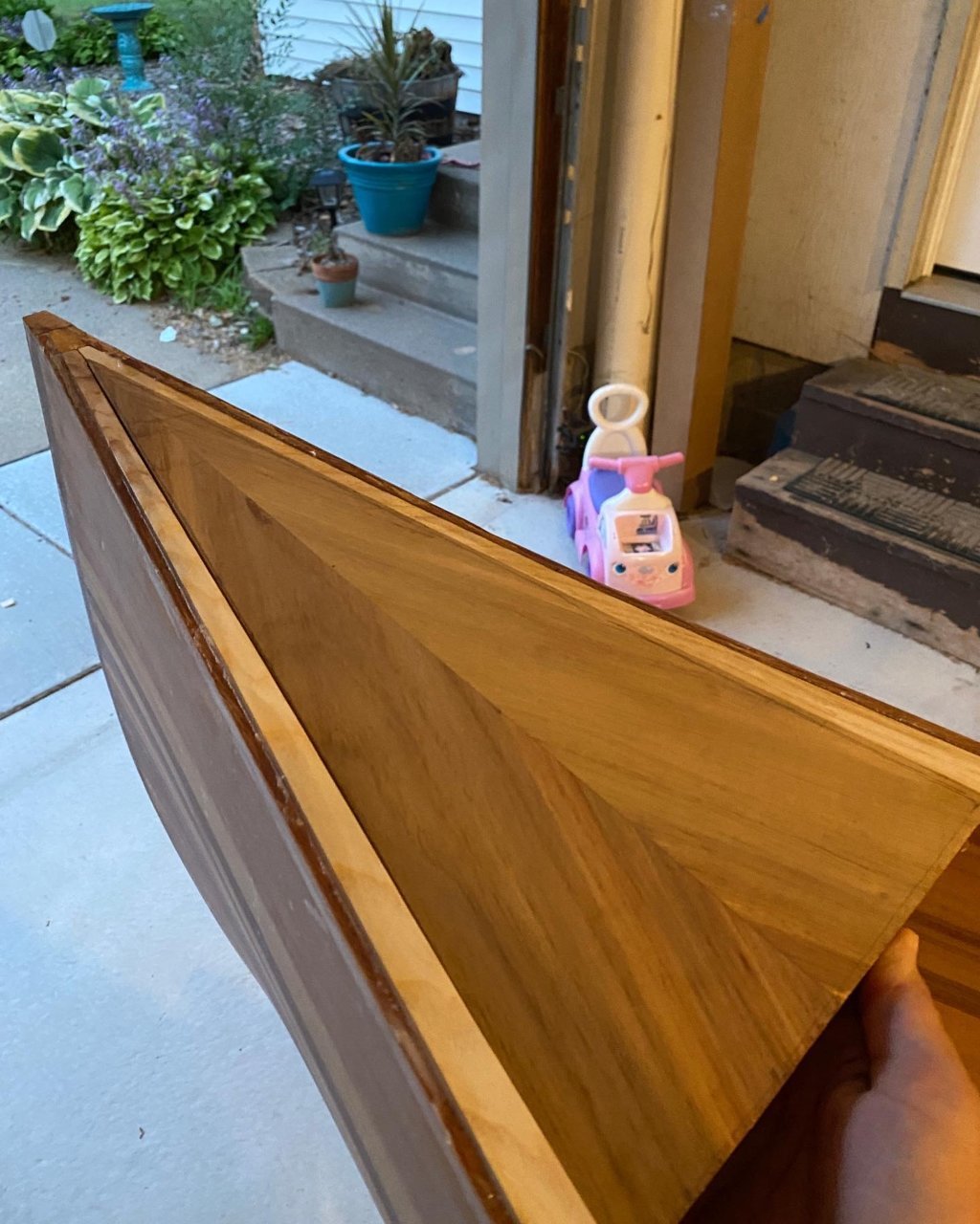

    Honey-do project today. She got this for free from someone who let it sit out in the elements for the past 10 years. I filled in the large cracks with wood filler. Apparently there is a depression in the oak as well.

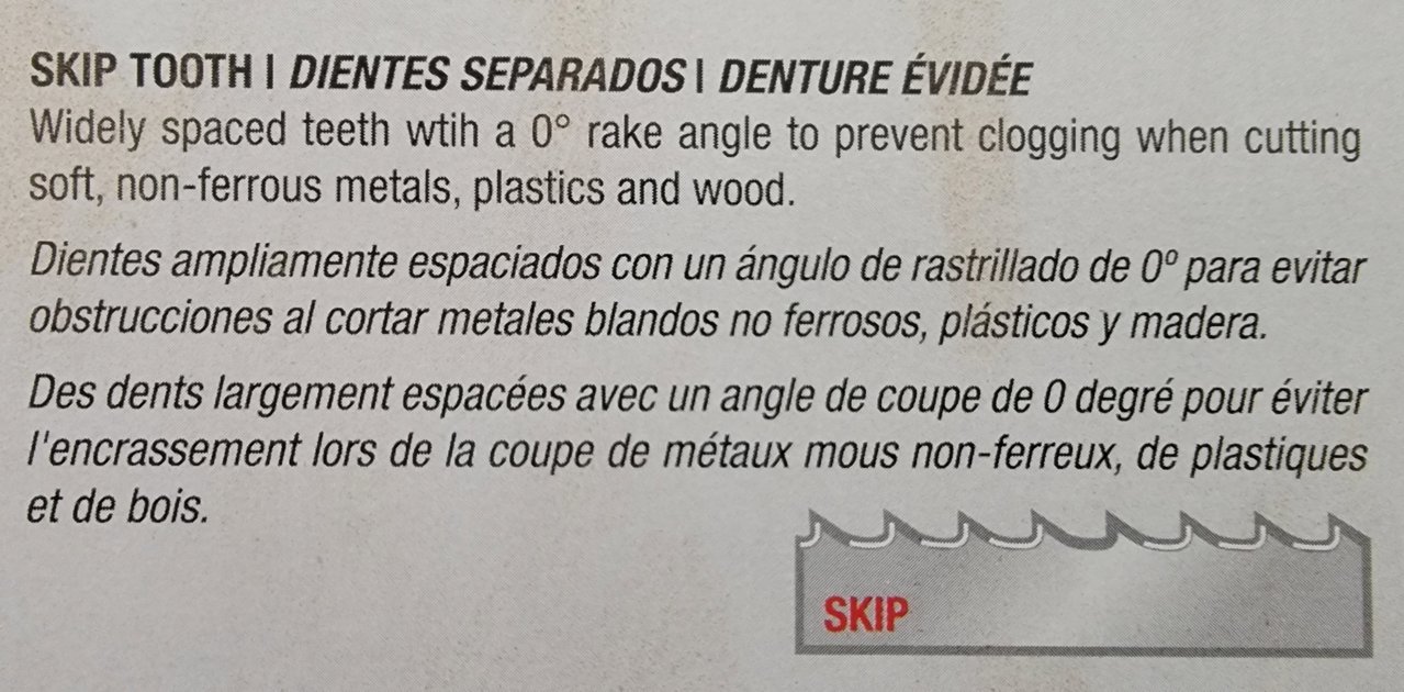

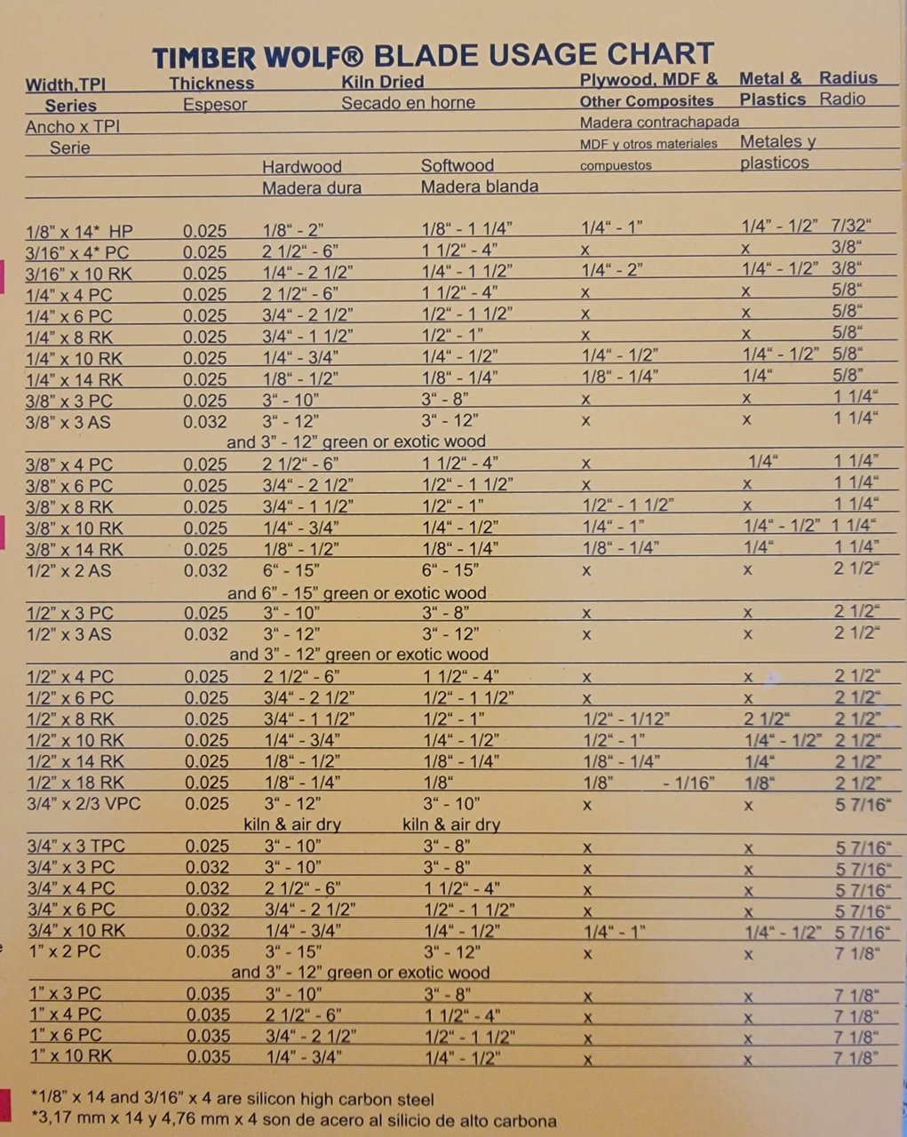

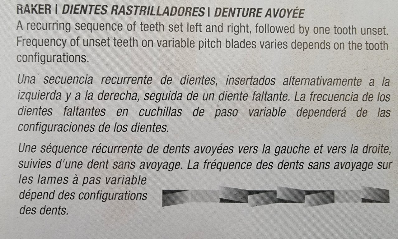

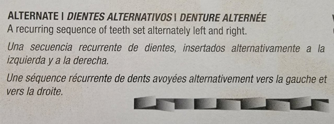

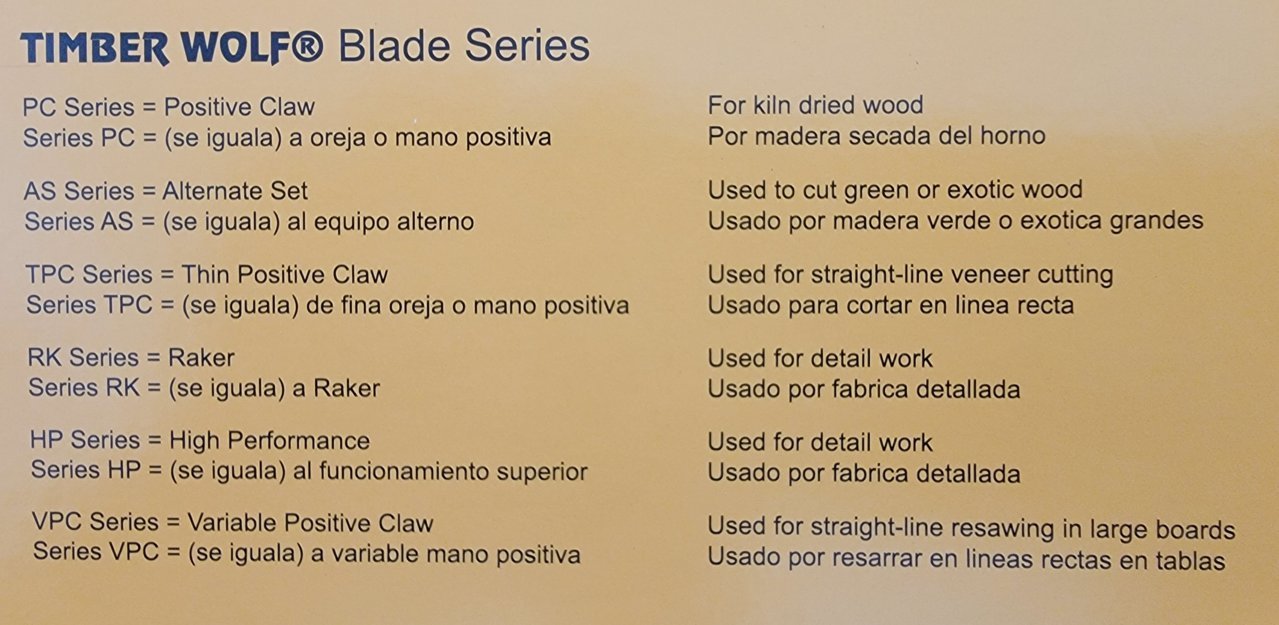

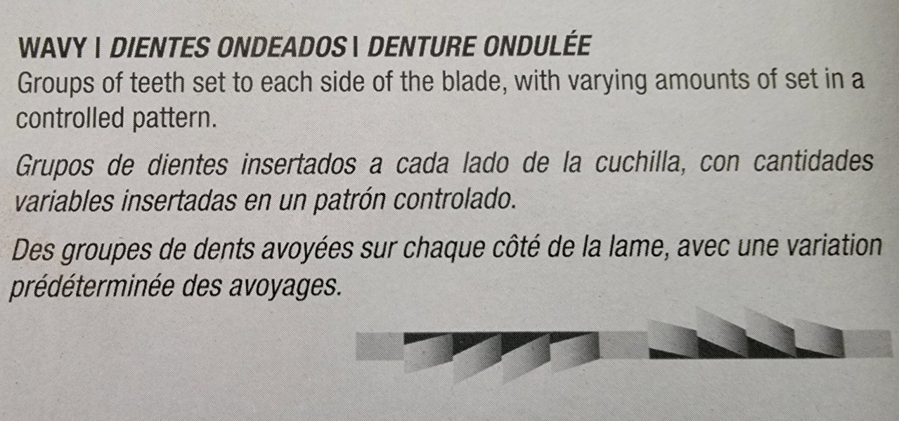

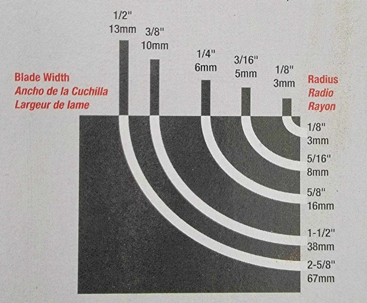

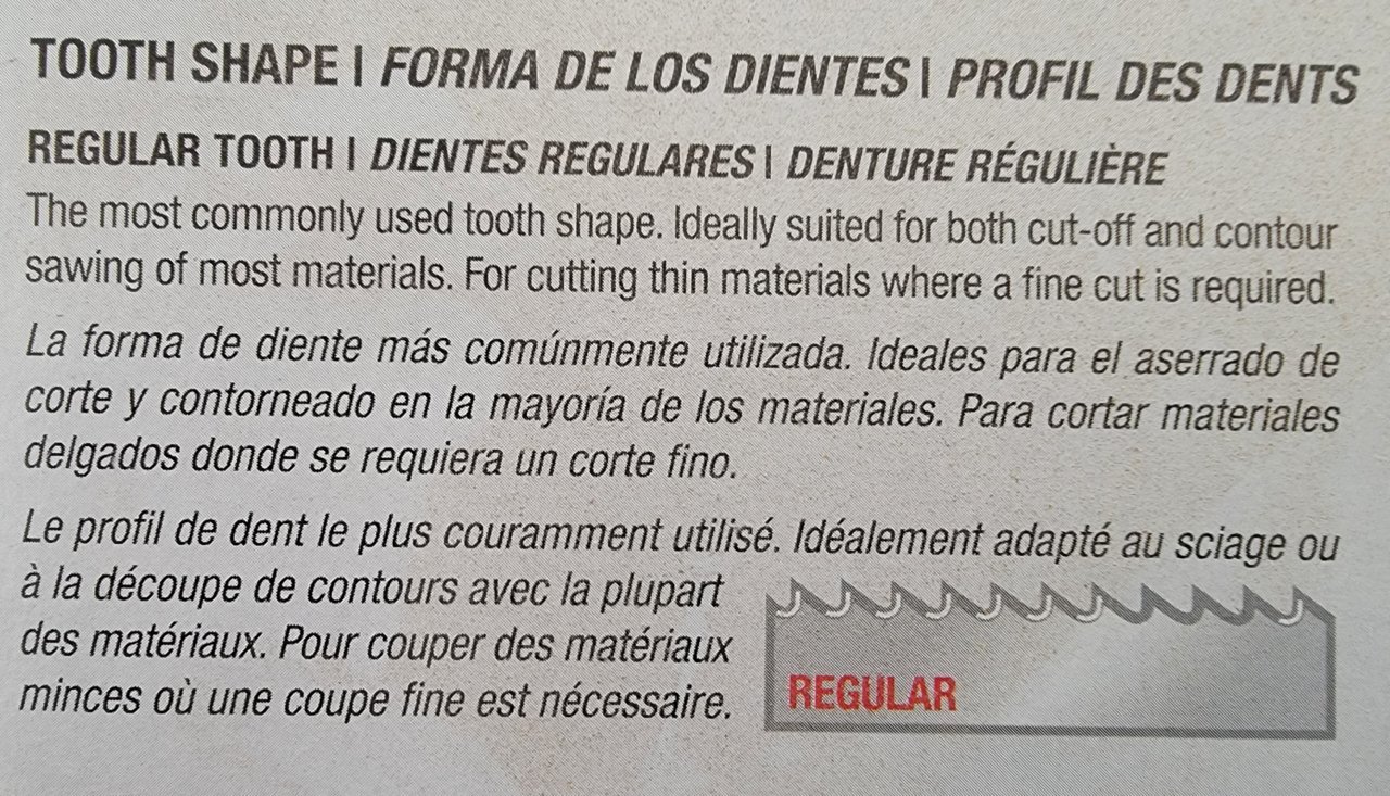

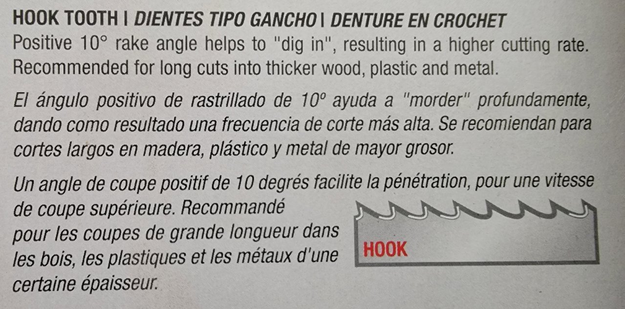

    @wilcam47
    I use both Starrett and Timber Wolf blades. It all really depends on what size is available in which brand.
    I've included photos I took from the back of both brand's boxes to help explain what's used for what.
    I've used my Rikon 10 inch to cut everything from 1/4 inch aluminum plate to resawing multiple species of hard woods.
    Hope this is helpful!

    i grabbed a skip tooth timberwolf blade at Woodcraft, just cuz it was what they had. Couple of you said it was good so i figured it will be ok to test. I definitely appreciate the info.
