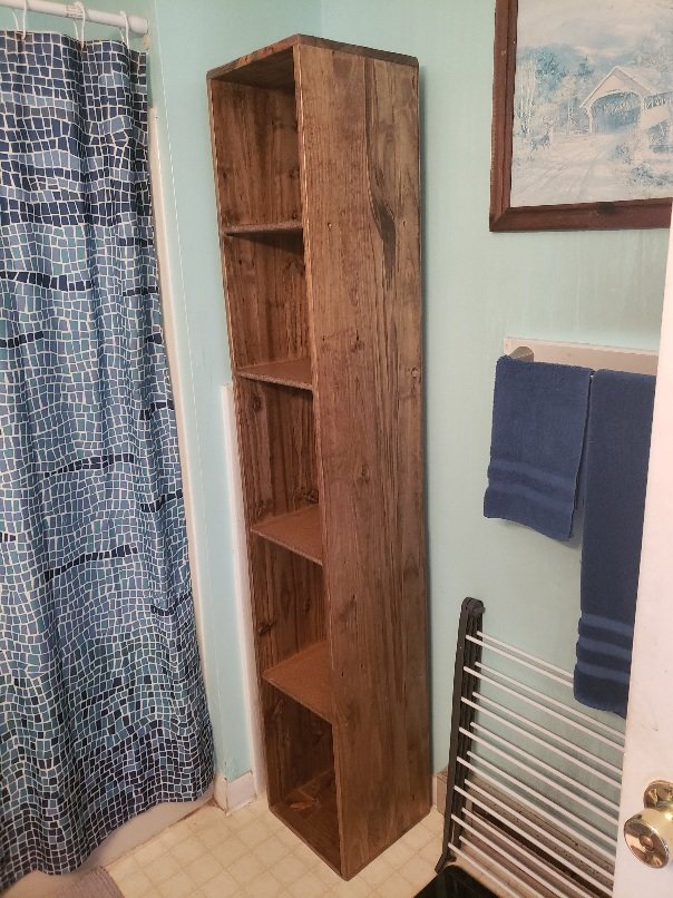

    Its very imperfect, but it works and it looks decent! Win!

    Nice! Looks good, you will only get better!

    Good job.

    Looks great to me!

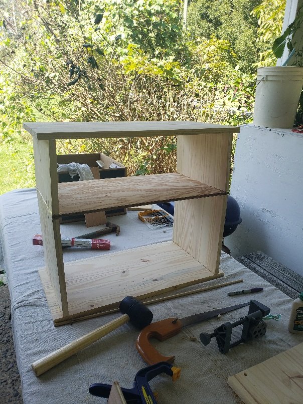

    Is it possible to cut a straight line with just a circular saw? Working on this night stand.

    Circular saw=best handheld saw for a straight line lol they only cut curves if you’re doing it wrong
    watch out for kickback

    Finesse trumps power when running a circular saw, you can literally feel/hear when it’s running true. A sharp blade helps :)
    A straight edge (or track) clamped to your workpiece like wilcam mentioned is the only way you’re going to get a perfectly straight line short of using a table saw

    Yeah I need to make the guide.
    I was trying to get it straight free hand and its kinda close but hands are not perfectly steady. Sanding got it closer, but the pieces don't lay flat.
    This is all part of the learning curve. :)

    Find yourself the straightest 1x you can find and use that with a couple clamps; it's what I do when I don't want to get out the table saw.

    So simple and yet so effective. Thanks for the input all. This is exactly what I needed to know and my life has drastically improved today from this advice. :thumbsup:
    Having another go at the drawer today. :sawzall:
