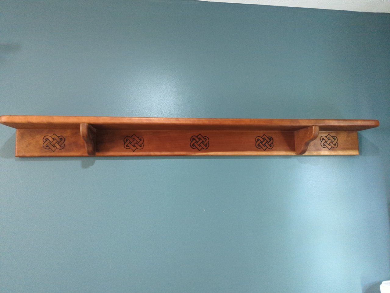

    Just got this hung up today. I made this for the wife for our 5th wedding anniversary.

    Nice!

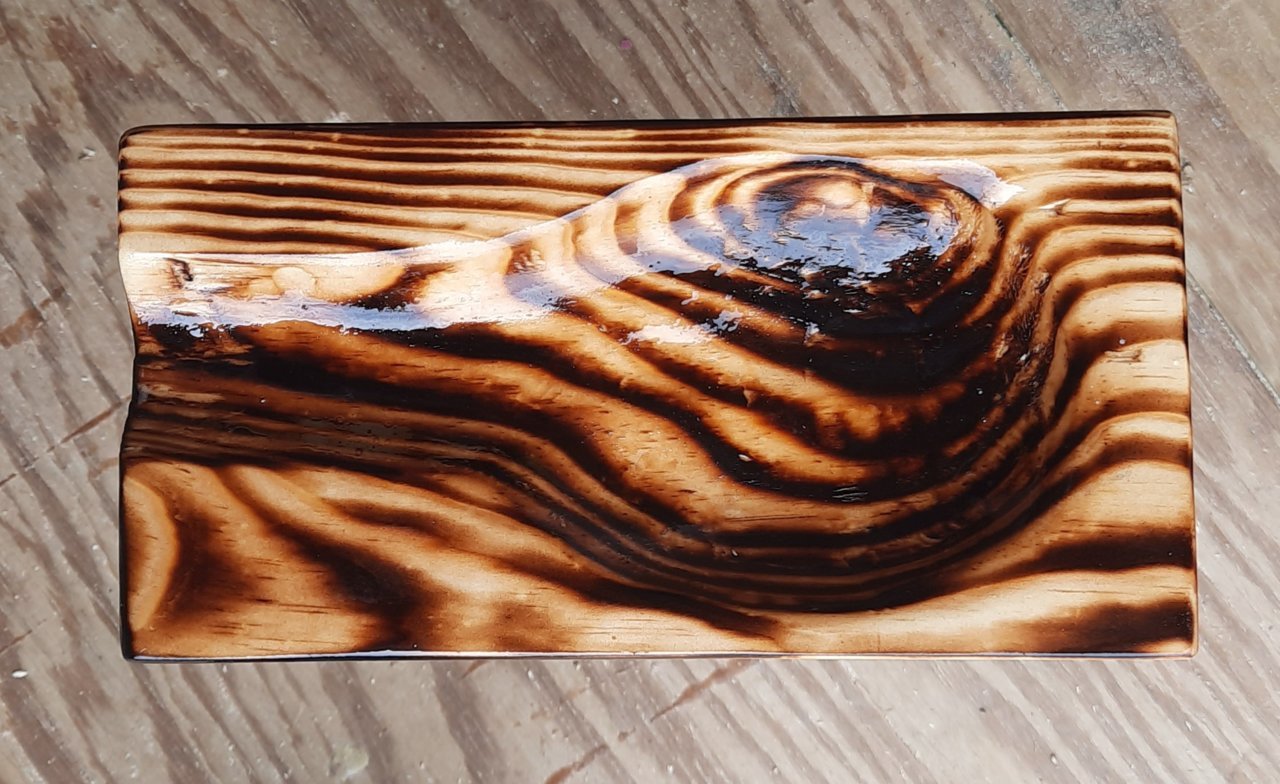

    Kitchen spoon rest my wife requested i make.

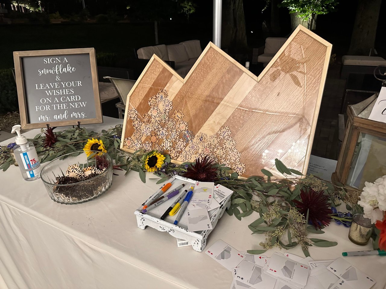

    Made this for a friend's wedding, and had a buddy lasercut the snowflakes. Background is oak/cherry/maple, trim is maple. Bottom trim is removable, so we can slide the plexiglass out later and rearrange the snowflakes so they're all upright. I'd router'ed two slots in to the top of the frame, if I did it again I'd do three, so the flakes didn't all end up concentrated on one end.

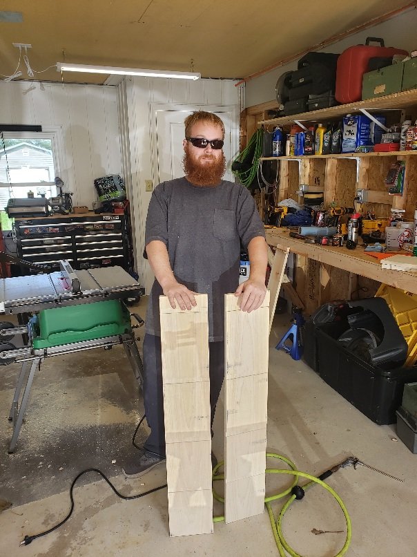

    Got the channels cut for the shelves today!

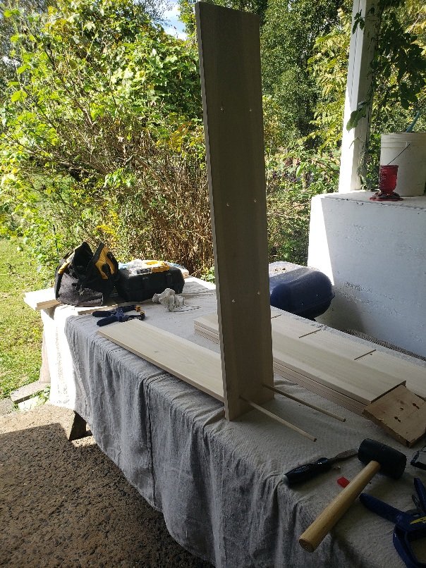

    First dowels are going in. Do you always use glue? I was planning to, but these things are in really tight!!

    Yes to the glue. Never forget, wood moves.

    Yes, glue is a lubricant, but also causes wood to swell quickly. Firm slipfit is the best way I know to describe the 4 thousandth of a inch clearance we shoot for.

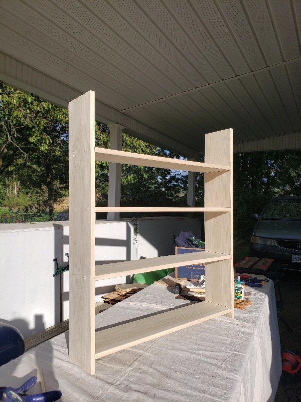

    Here's what I got done today. Some of it is glued and some of it i couldn't get back out. :anonymous:
    Learning. Learning. Learning.

    Looks good!

    That's where a soft faced hammer comes in handy. Sometimes it needs a gentle persuasion. Also, Hide glue won't make the wood swell like regulat wood glue. It acts like a lubricant as well and gives you a longer open time.
