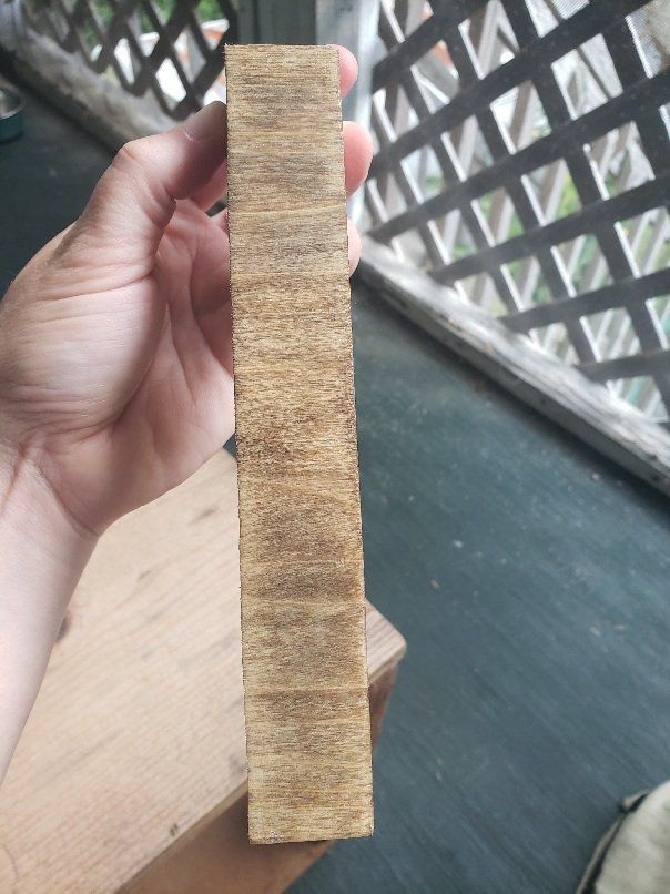

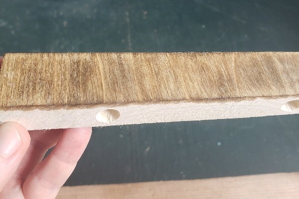

    Test piece. Poplar with special walnut stain.

    Looks good! Poplar has a green tint as you are aware

    I am. And word on the street is that it does not stain well so I'm gonna let it sit overnight and see if I like it in the morning.

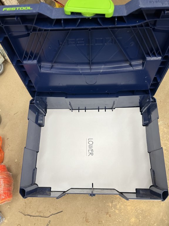

    Not fancy woodworking but started on a project that anyone using Tanos/Festool systainers might find useful
    I'm going to build some custom plywood inserts for some of my empty systainers . Downloaded a .dwg template file from a thread in the Festool Owners Group Forum and had my structural engineer print it for me.
    Glued his paper copy to poster board to make it more rigid and just test fitted it
    Next up I'll glue this template to 1/4" MDF or plywood for a permanent template
    found the file in this thread for anyone interested
    https://festoolownersgroup.com/fest...-t-loc-systainer-inserts/msg283542/#msg283542
