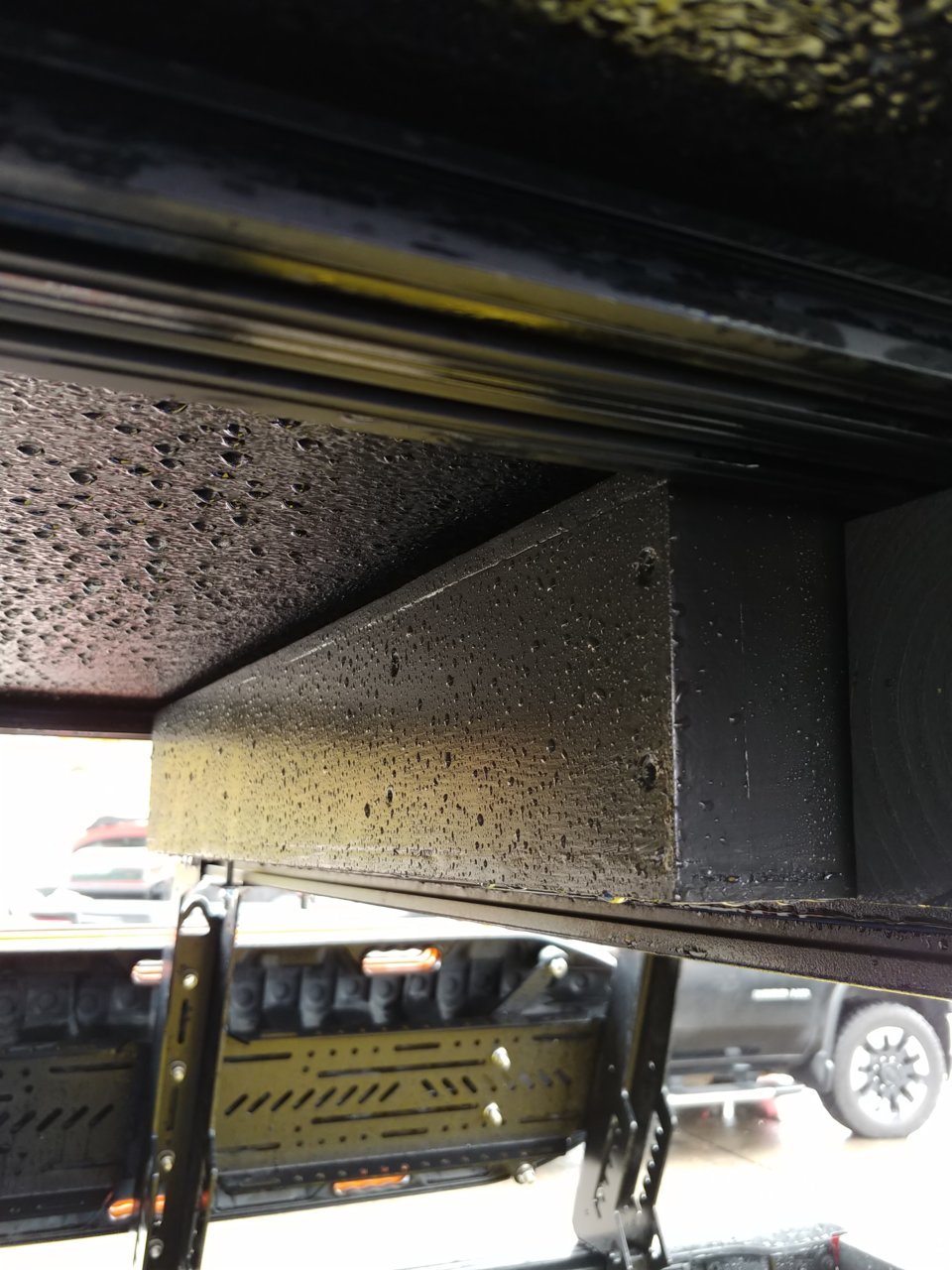

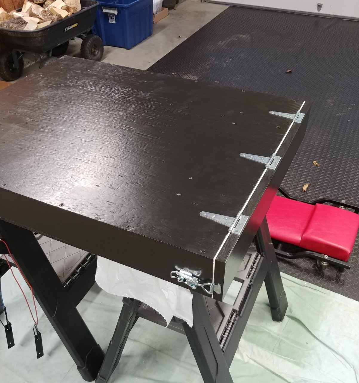

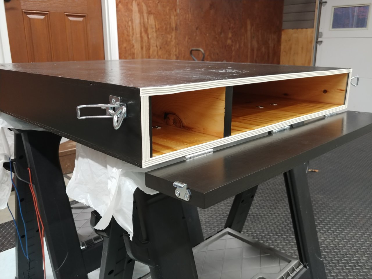

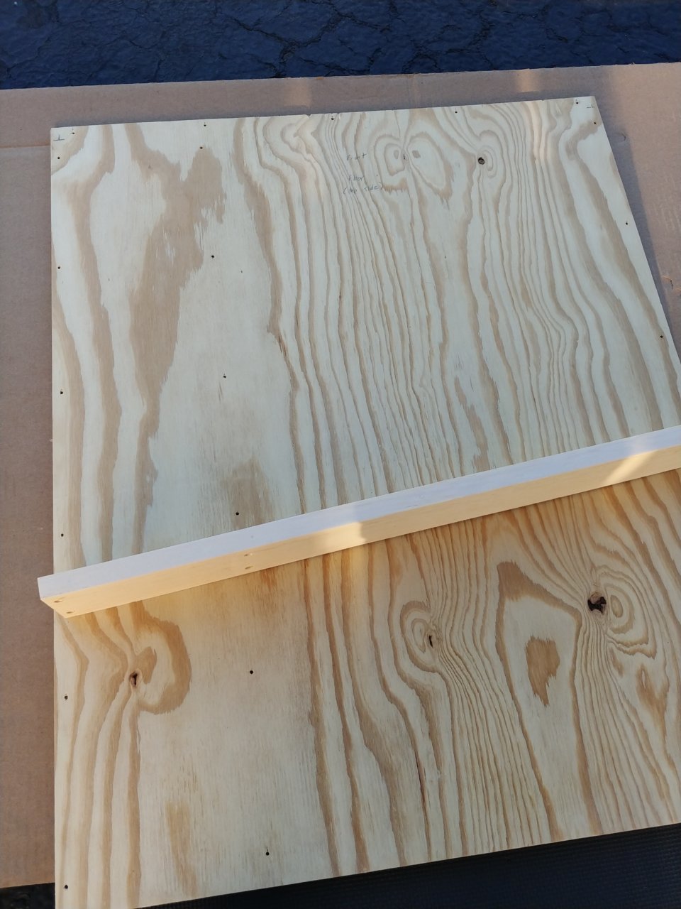

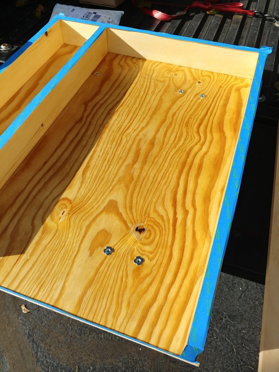

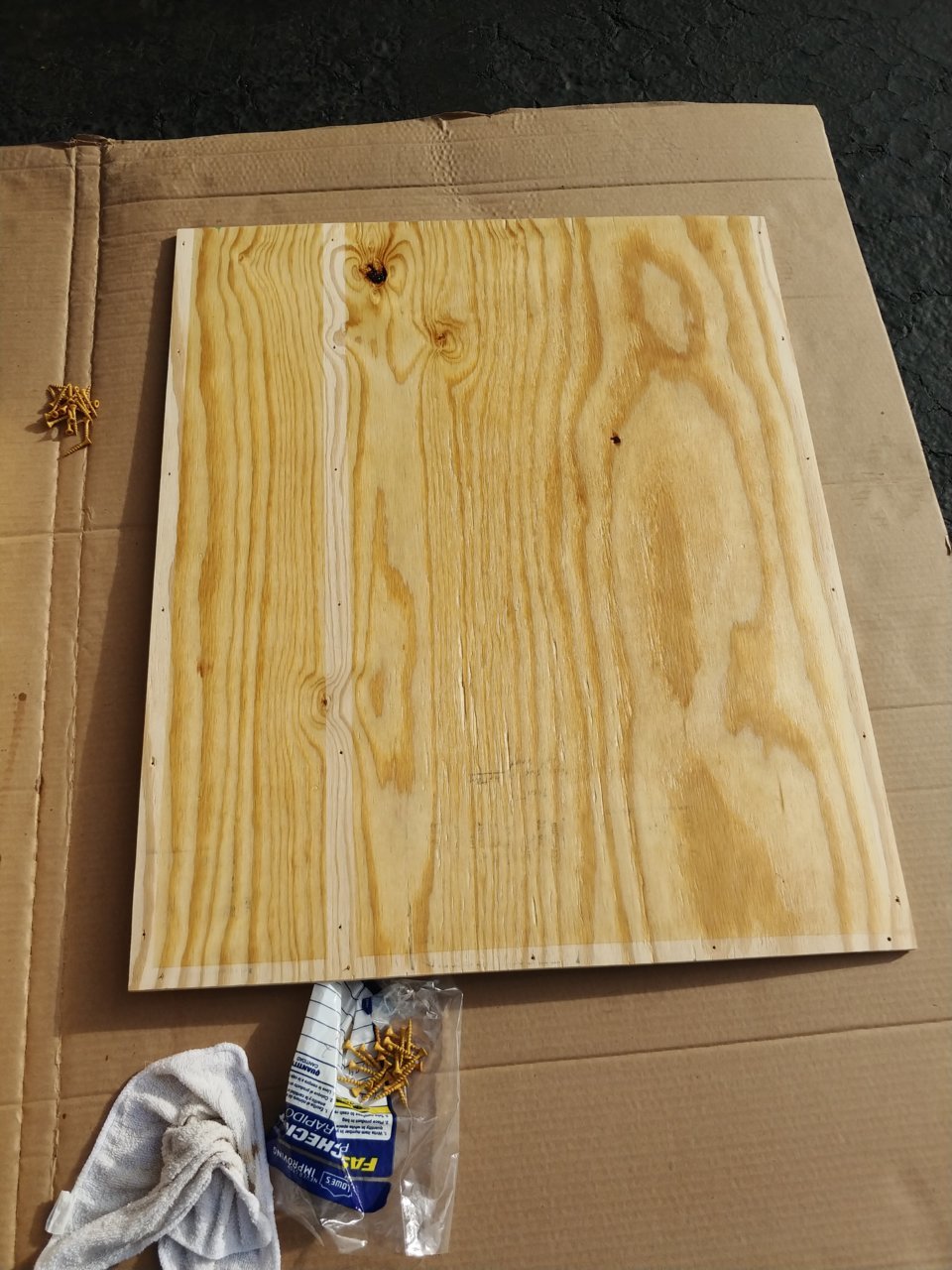

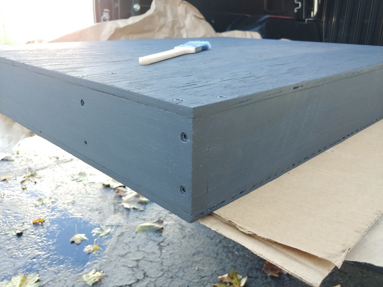

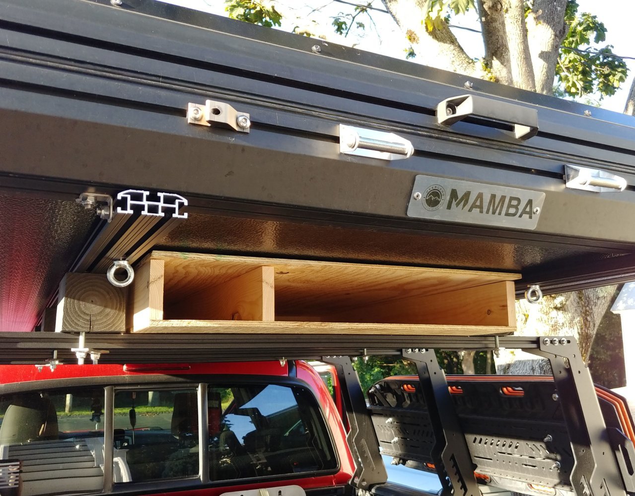

    Thanks to those who chimed in, figured Id post a few pics of the process and final product. I ended up doing two coats of black deck stain on the outside, then two coats of Minwax Helmsman spar urethane - satin. It was a very time consuming process / project but I think it turned out well. Been through some rain storms and the water beaded off very nicely.
    Drilled the top and bottom at the same time so everything lined up. Had to triple check myself to make sure nothing was mirrored or flipped upside down :D
    Two coats of Helmsman on the inside as well for maximum weather proofing
    Figured wood glue wouldn't stick to urethane so masked off the approx. locations
    Stained and ready for the urethane
    All done! Used three strap hinges for the door with very short 3/8" #8 screws. Even then had to grind the tips off so nothing stuck up into the floor of the box.

    Beading water perfectly with only two coats

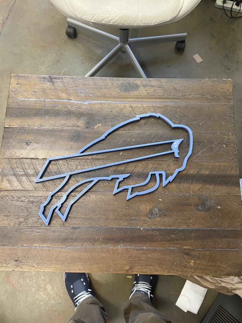

    Old friend of mine has a 3D printer company and printed me a stencil I had been looking for @wilcam47
    as soon as I get back from Texas I should be able to wrap this thing up fairly quickly
