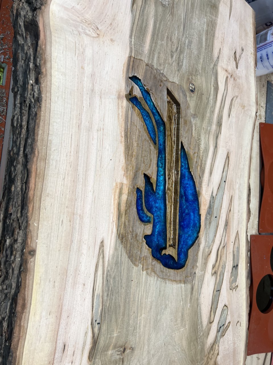

    For a friend of mine who’s from buffalo. He had a shed full of a ton of lumber so I made a trade with him

    wilcam47
    wilcam47 Keep on keeping on!
    Jan 27, 2016
    #176243
    55,260
    Will
    Bourbon state
    I meant the epoxy...lol

    Oh it’s just finicky and requires sitting over it with a torch popping bubbles :rofl: too tedious for my taste

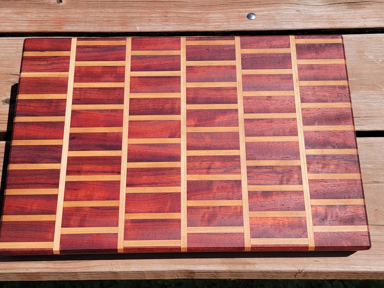

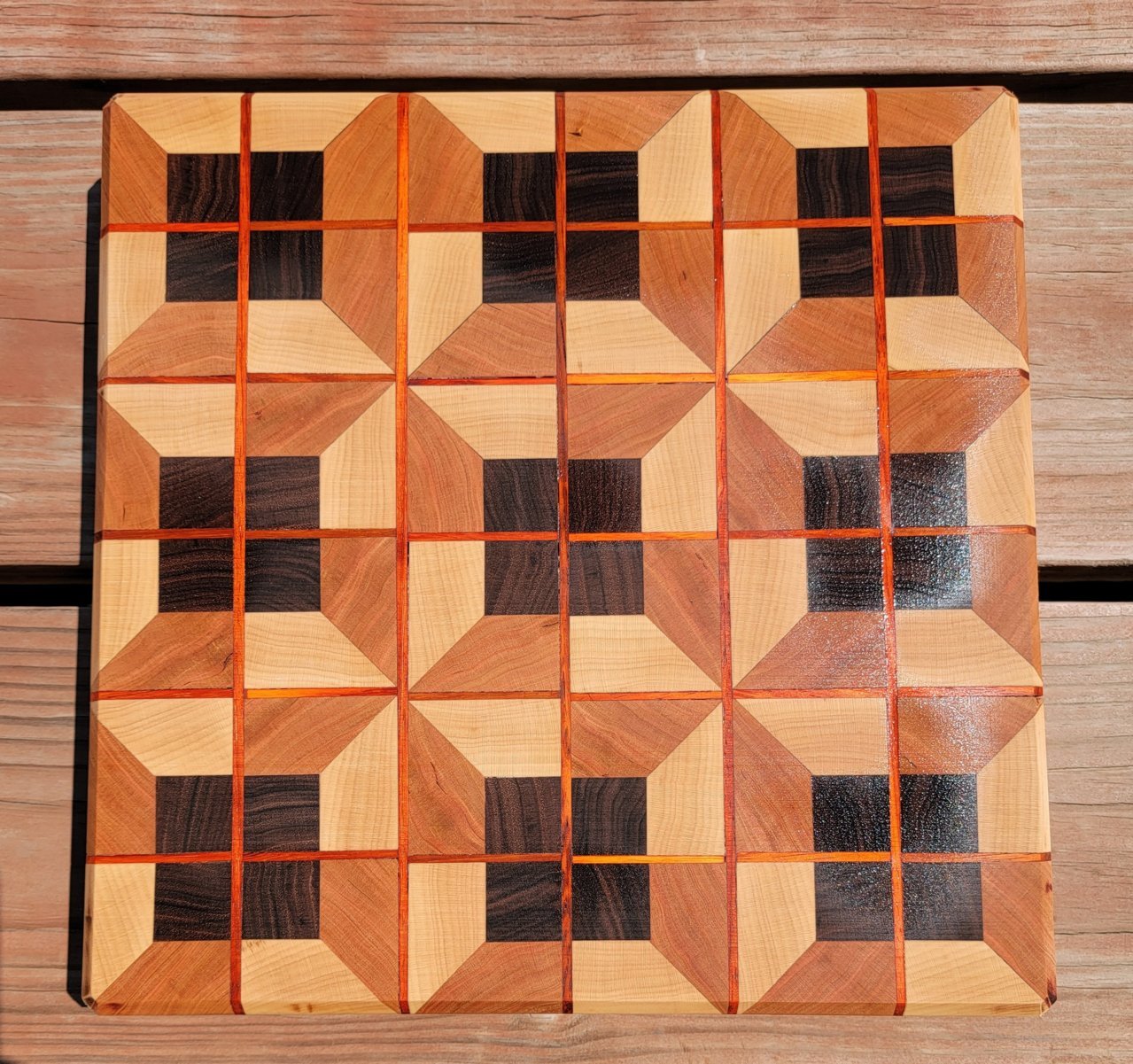

    Here's just a few I've made

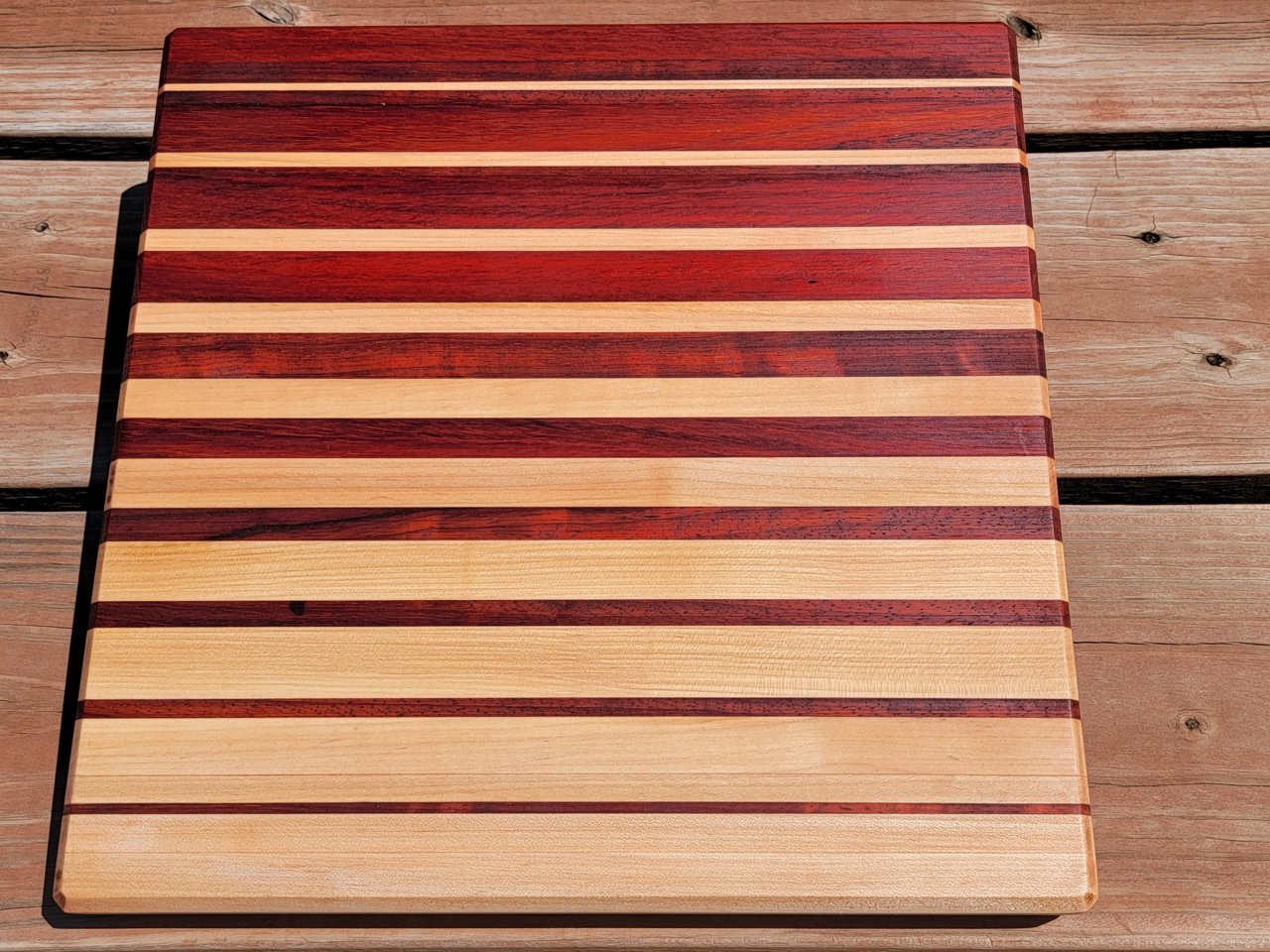

    Those are lovely! I chose a simpler design. They are 5 pieces each with varying widths and color. Just want to get the practice/experience so I figured I should go easy to start.
  11. Dec 9, 2022 at 1:07 PM
    #9951
    wilcam47
    Jan 27, 2016
    #176243
    55,260
    Will
    Bourbon state
    heres an example

    Yes.. the ones I posted require a few more cuts and glue ups etc.

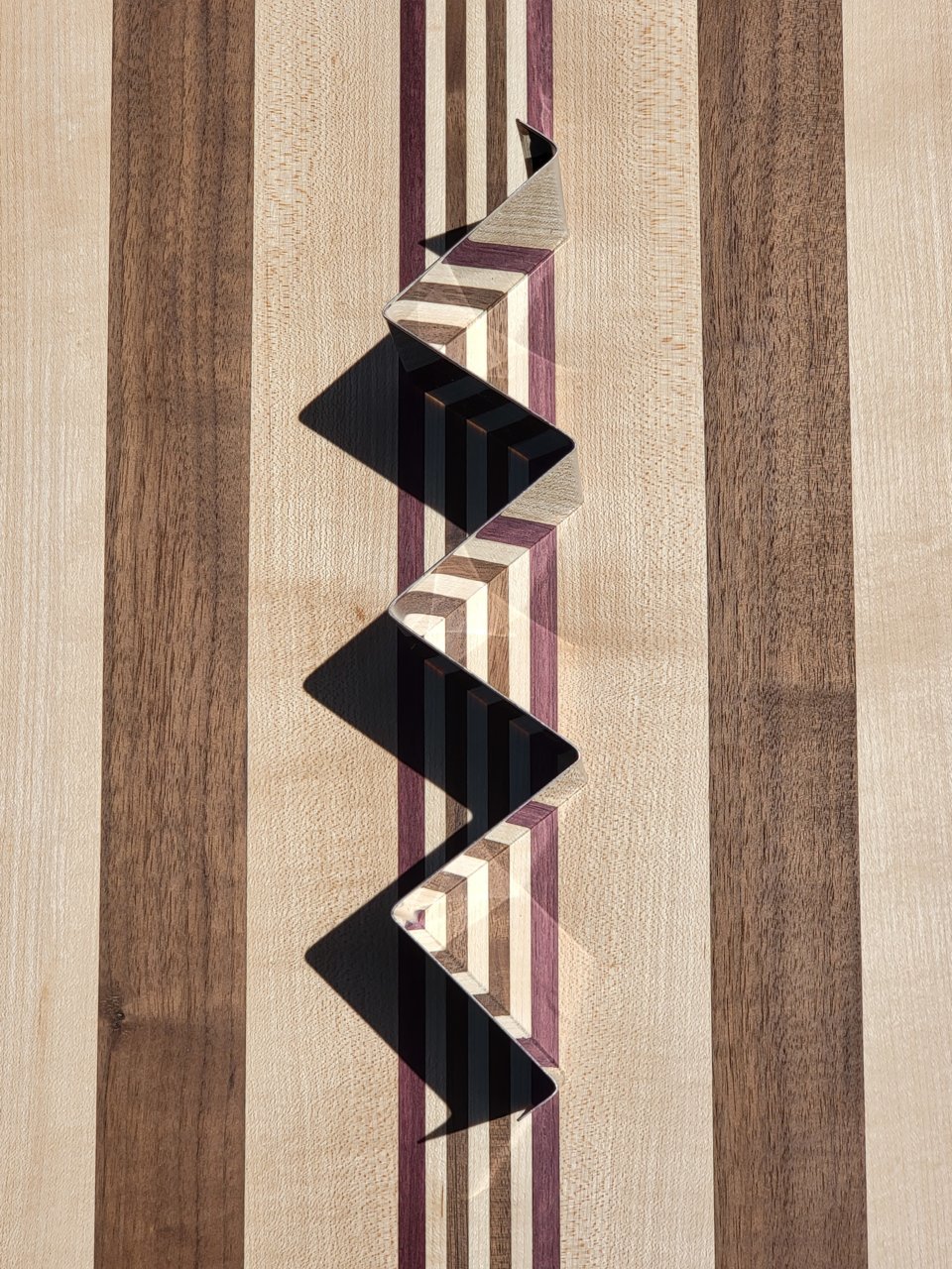

    When I mentioned finishing the edges, this is what I am talking about.
    That's a freshly oiled board with a 45 degree chamfered edge top and bottom and corner. That was all done with a router table and chamfering bit

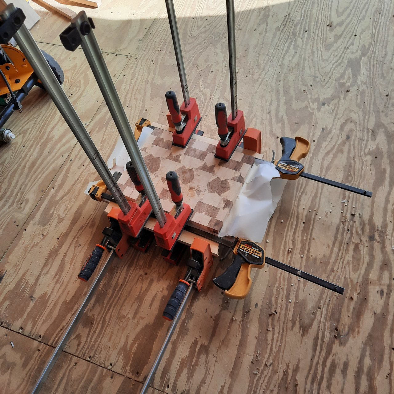

    Here's what you're doing.. (ignore my Taco holder)
  15. Dec 9, 2022 at 1:14 PM
    #9955
    Gen1TacoLady
    Gen1TacoLady Local favorite
    Jan 2, 2022
    #386148
    10,288
    Pond Princess
    Washington County, MD
    '95 Red Tacoma
    yes. basically.

  17. Dec 9, 2022 at 1:23 PM
    #9957
    Kilo Charlie
    Kilo Charlie One flat foot on the Devil's wing
    Nov 10, 2011
    #66805
    11,649
    Iowa
    2017 Inferno Off Road
    This!
    And you have to take the time with patterns to make sure they're oriented correctly! I made a mistake in the first one I posted today but didn't realize it u til I was wet sanding it because all the wood looked the same during glue up
    wilcam47 and Gen1TacoLady like this.
