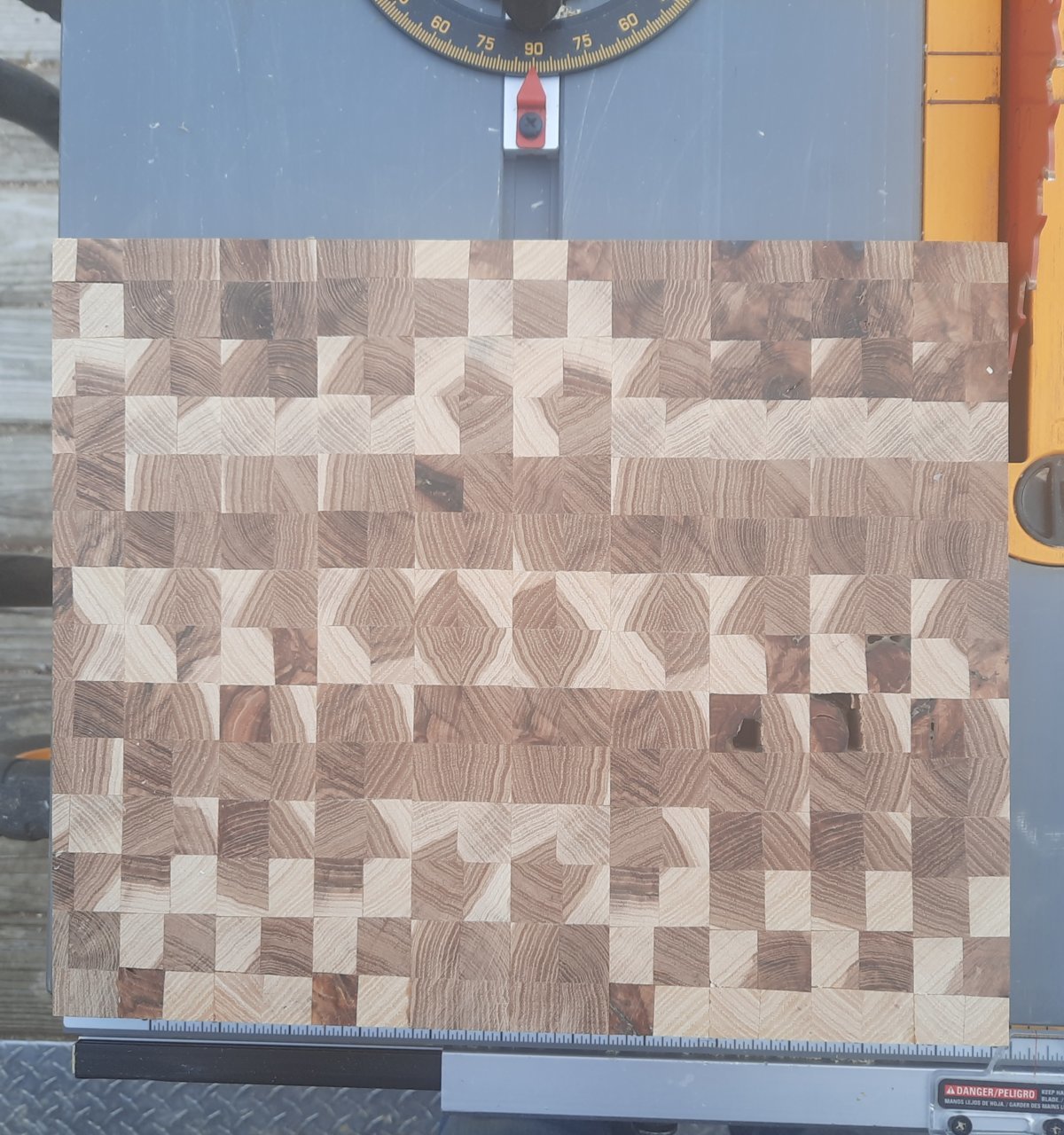

    Trying out an end grain board today. :)20230113_132747.jpg

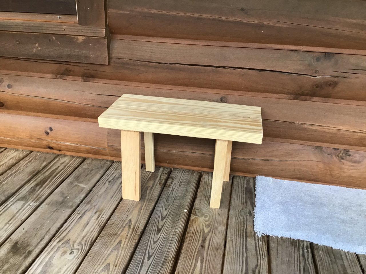

    Woodworker are you kidding me I’m a furniture maker and you lucky peeps have the chance to purchase this beauty , real Tennessee pine , just fight each other for it 0FF334F4-AF6D-445F-A73B-8E454B5B836C.jpg

    o_O:thumbsup: GLWS

    That will be a edge grain board. If after gluing in that direction, you would slice across the glued plane, fip them up, and reglue to make a end grain board. They are very difficult to deal with.

    Ah. Right! :facepalm:I'll have to try again. :)

    Once you make that an end grain board.. do NOT run it through a planer!!

    Edge grain boards are 90% of what is made. You are 100% on track. Work on edge grain boards for a while.
    The skills give a solid base to build from.

    Ok. Does it do something bad?

    Can catch board and shoot it out the back...usually destroying it:anonymous:

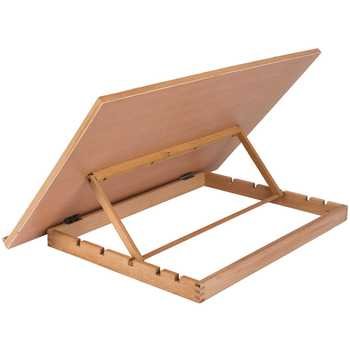

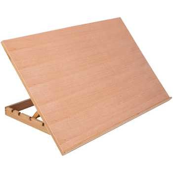

    Also pondering what kind might be best for making a desktop easel. Hardwood, but lighter weight so it's easily movable for the user. Red oak is suggested. :notsure:

    i havent used sycamore.
    what size easel? Theres a premium pine at lowes and home depot. Its a little denser than yellow pine but more expensive. Or redwood (not redoak) in decking.

    I was thinking this kinda design. Probly under 2' so it will fit on the desk I just built. :)
