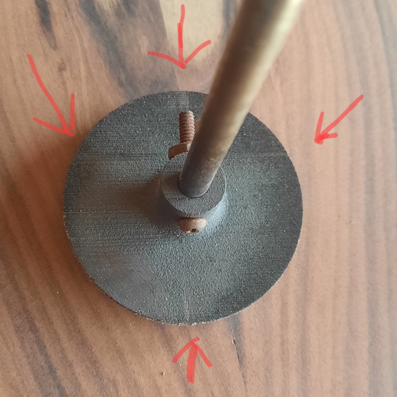

    Also i put some scratches on the back to give me a better oreintation. Kinda hard to see on this but it does help

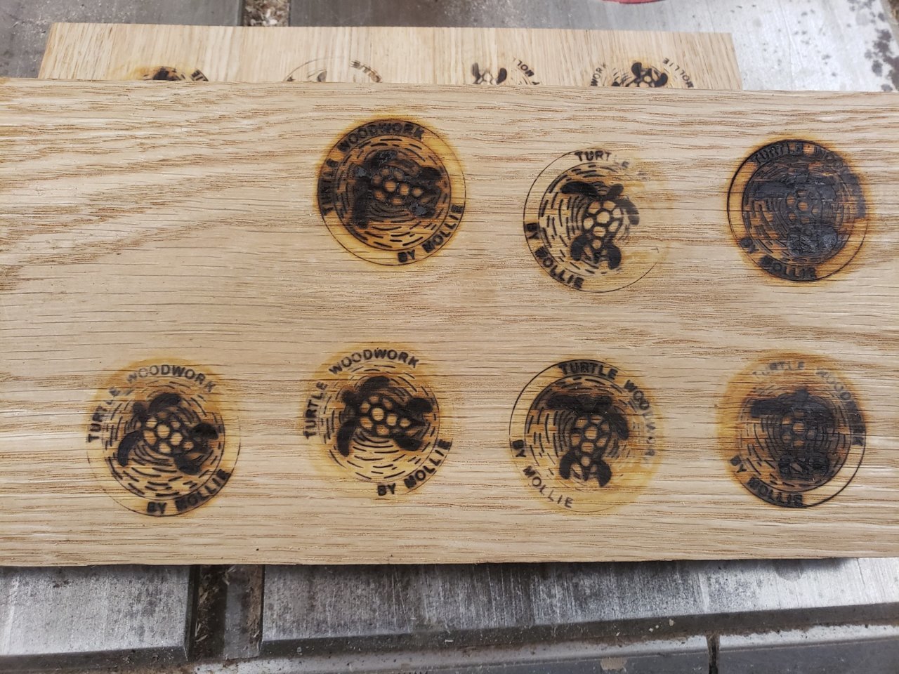

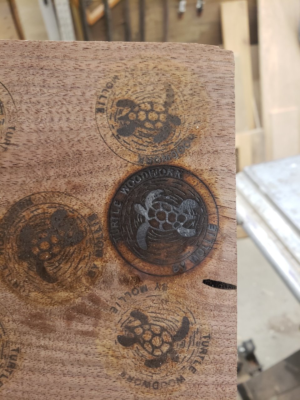

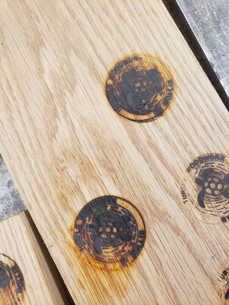

    Used a propane torch and got a lazer thermometer. Its over 500 degrees now. I think the walnut is my best one yet. I used the wet cloth on all 3. Getting better.

    Closer
    wilcam47 and wrightme43 like this.

    On the "burnt" ones, try sanding lightly until it comes back

    Or a soft wire brush just to remove some of the char.

    Ok it looks like the turtle is transferring more heat to the wood than the letters. Maybe heat the hole thing and give a little extra to the outside ring.
    It looks like a good turtle leaves a faint name, and a good name leaves a burnt turtle.

    Top left is a good one, use palm sander and it will come out good
