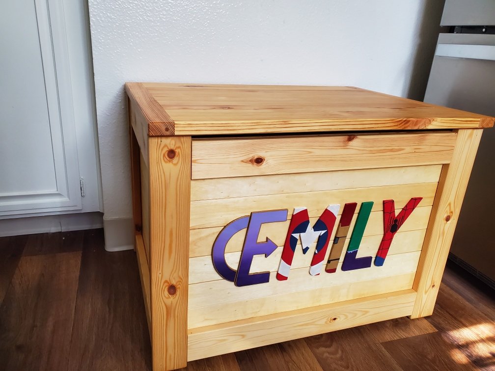

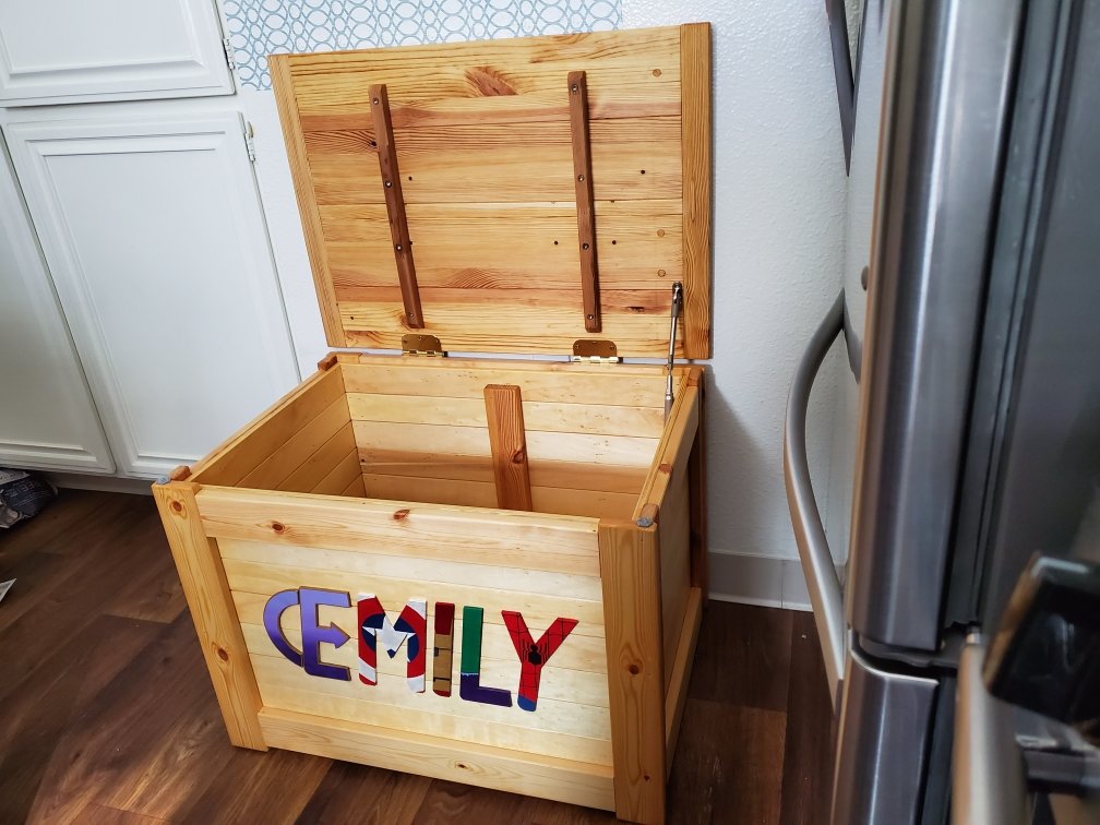

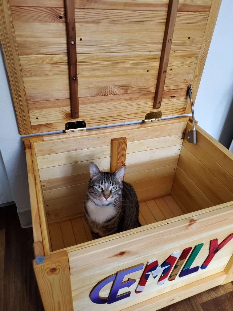

    It appears your overlord, the cat, has other plans for the box.

    Cats can't resist a box, any kind of box, lol.

    You always need approval from the foreman before the job is complete.

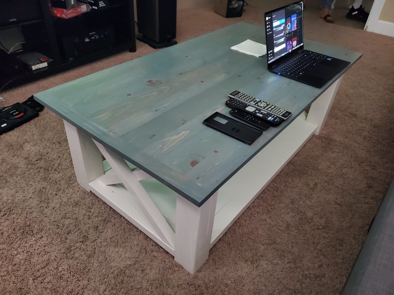

    Same boat. I'm working with a Harbor Freight pocket hole jig. It worked well enough to build this coffee table, though!

    Looks great!

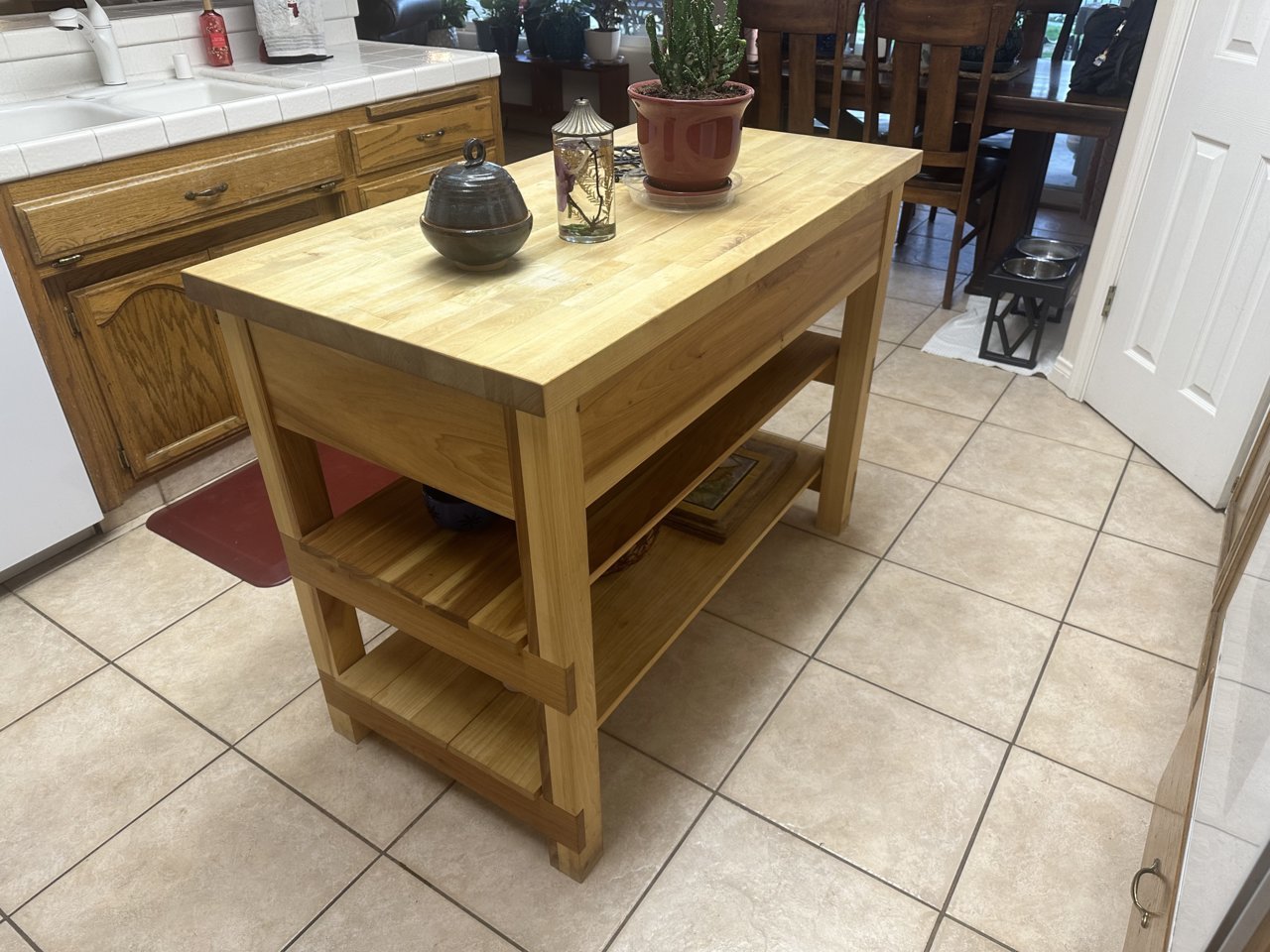

    I use a Kreg K4. I don’t think they even make it anymore. It works great and has helped me complete many projects. Here are a few more things I have built around the house using pocket holes.
    Kitchen Island

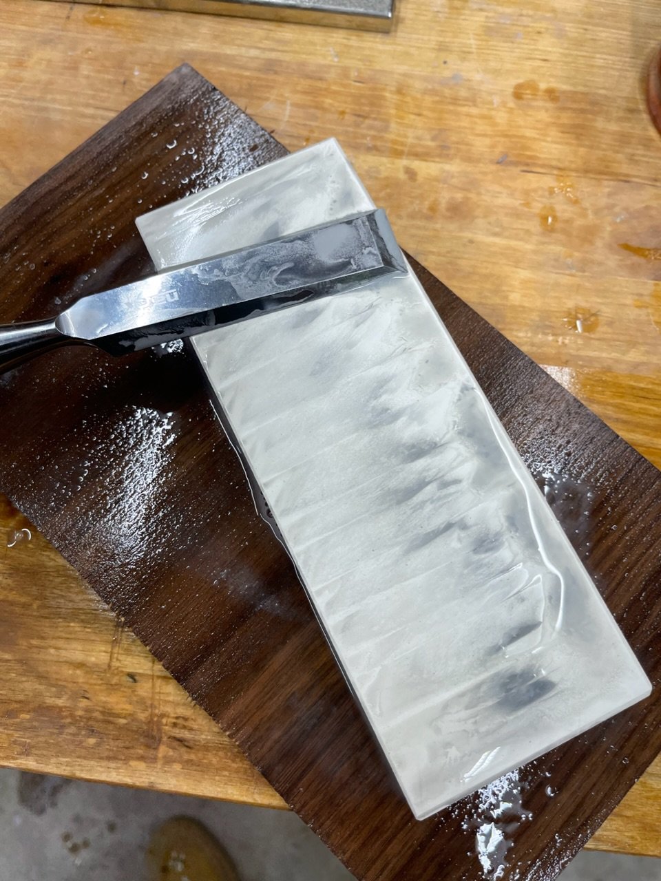

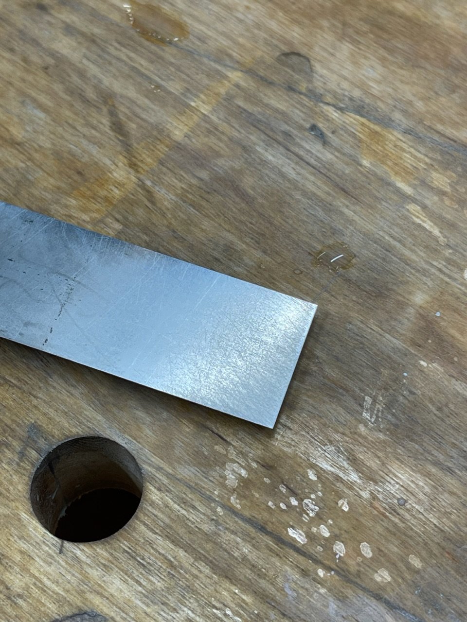

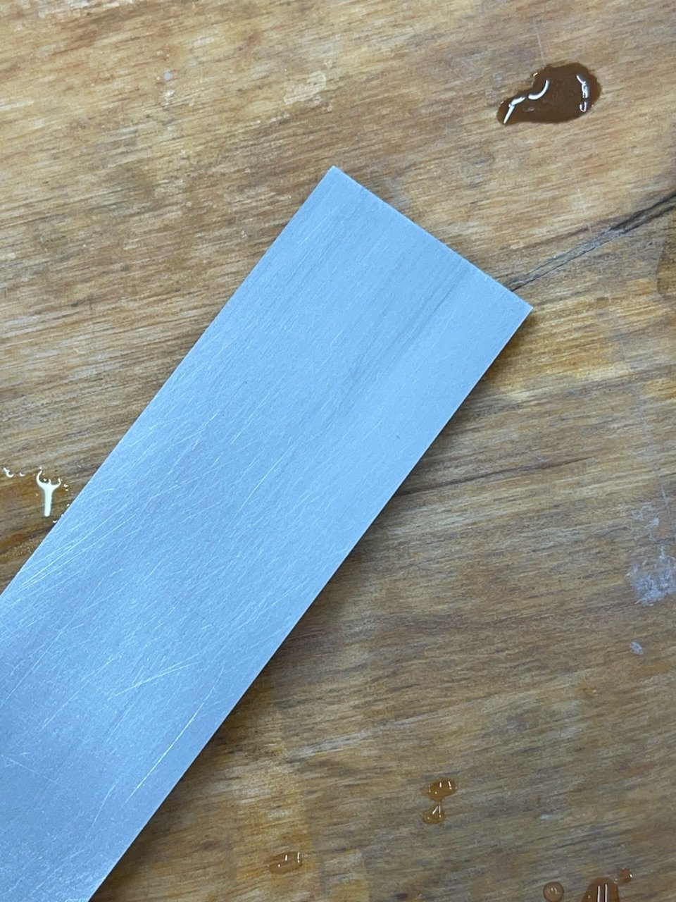

    So on my ocd fueled quest to flatten the backs of my chisels properly, I became frustrate with my limited sharpening equipment and invested in some improvements. It seems to help quite a bit! Now I just need to be more patient as I go through the grits.
    This is where I was at before deciding to get more stones and a flattening diamond stone:

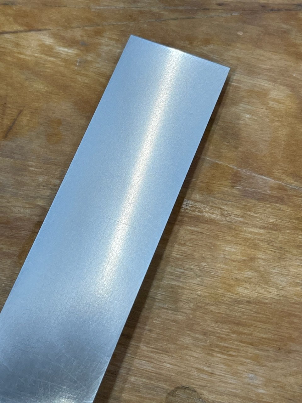

    Here’s after flattening more with my new 220 stone, followed by the 1000
    Then the new 3000:
    On to the 6000:

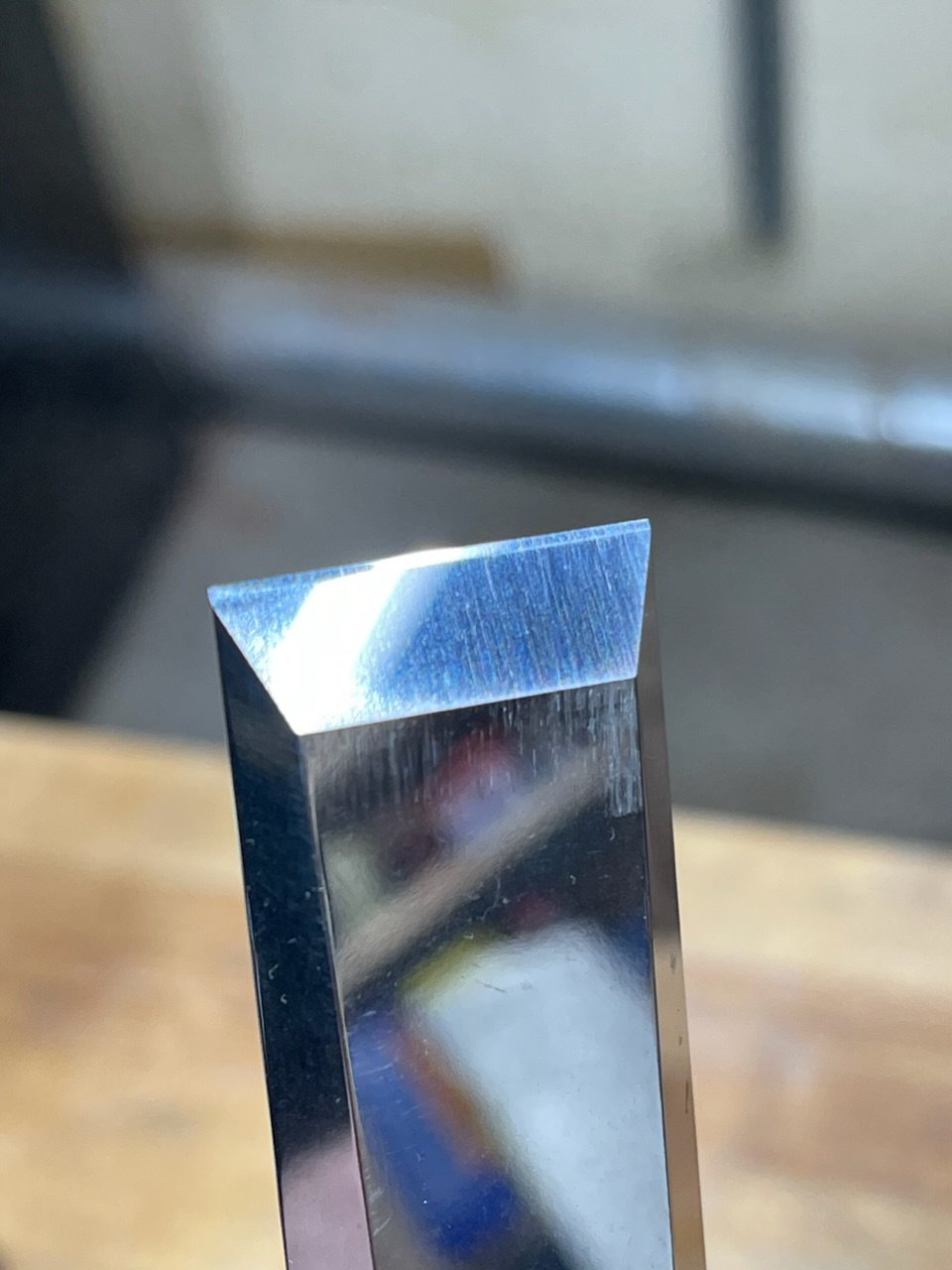

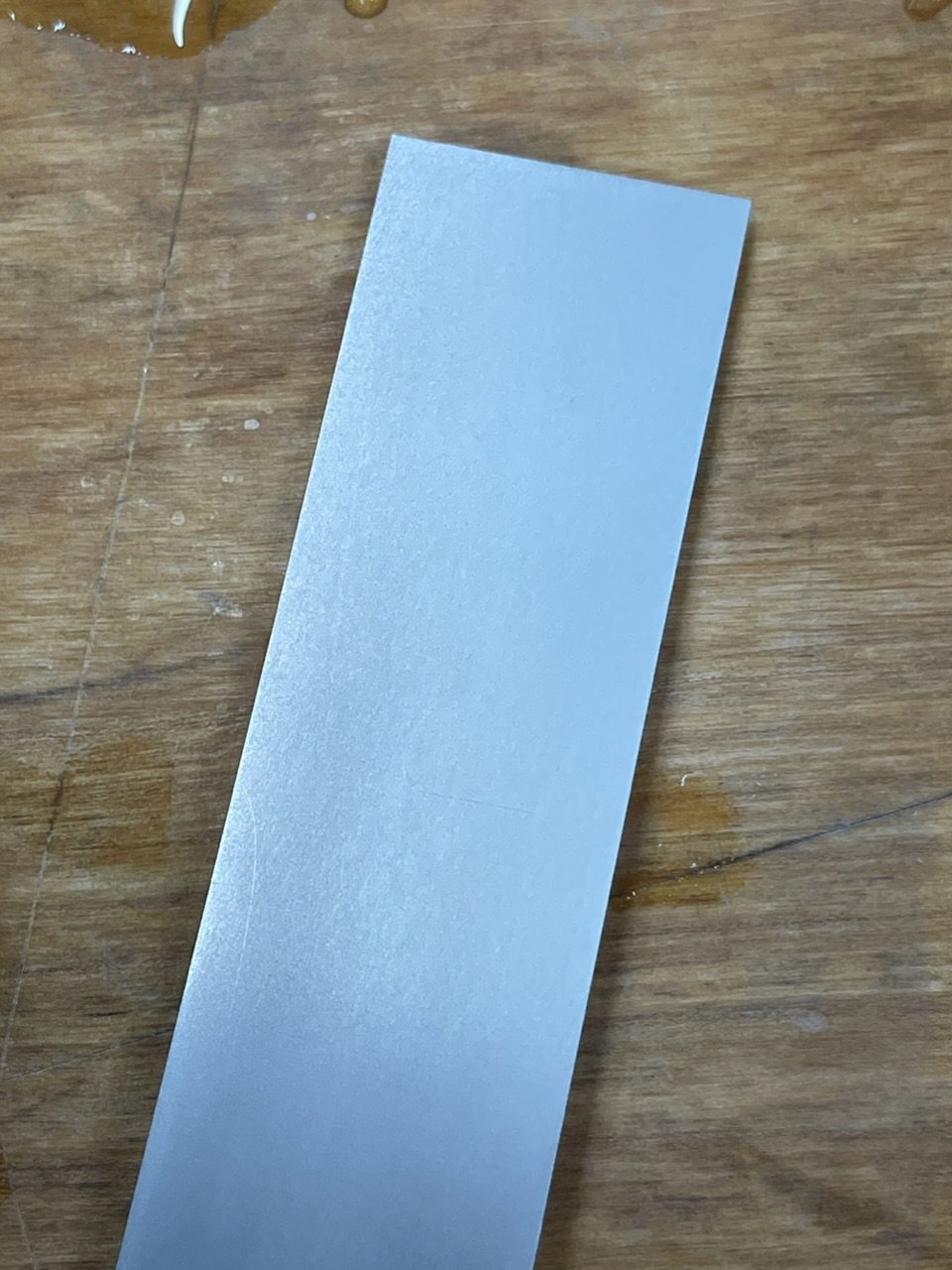

    Then I broke out the new 10,000 stone:
    that’s when I realized I needed more work on the lower grits to be able to get a mirror like finish. I’ll tackle that another day

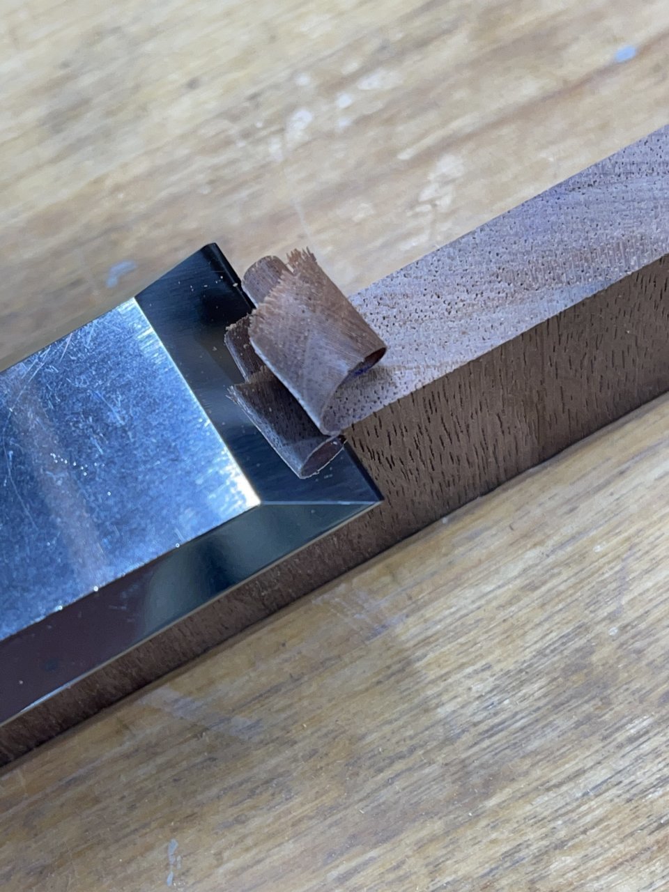

    I finished up by using the 10,000 stone on the face, then doing the micro bevel.
    Damn is it ever sharp now!
