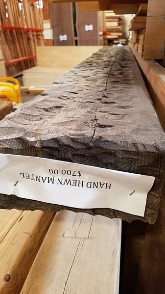

    Anyone know how to get this look? I was thinking a curved chisel and sanding... but not sure..

    An adze

    Do you just hack away at it? Does the adze have to be curved or straight blade?

    You cut across the grain with a broad axe (straight-flat blade) to score the grain. Then you cut with the grain with the adze.
    That particular mantel isn't hewed. It looks like some one went at it with a curved chisel in an attempt to antique it.
    this is what hand hewed wood looks like
    But if you want that look, you can use a curved adze (called a bowl adze)

    ..carving gouge... scrub plane (a small plane w/ a heavily cambered iron)... ?

    Awesome thanks for the help. I want to give it a shot. On some scrap wood

    If you decide to use the adze, look up the proper technique first. It's a trip to the hospital if you miss and strike yourself.

    ...you also might try one of those grinder-type tools w/ the large wood removal cutters (can't think if there's a specific name for these tools), ..but I'd imagine you could dish-out the material quickly and w/ out having to learn adze work...

    Arbortech makes those tools.

    yep, that's it!
    ...I don't own one, ..but I've seen some youtube woodworkers using them when shaping requires a good deal of stock removal...

    Interesting. I was looking at one of those blades!
    I was going to try to make a curved seat. I may bite the bullet on one of those. I don't know what other use i would have for an adze if I were to get it.

    That is emulated hand hewn, look at the right side its smooth all the way down the edge. $700.00 please, use that arbortech on a large timber 6x8 and leave it out in sun and rain for about 6-12 months... you should get the same thing exactly for a lot less. My $.02.
