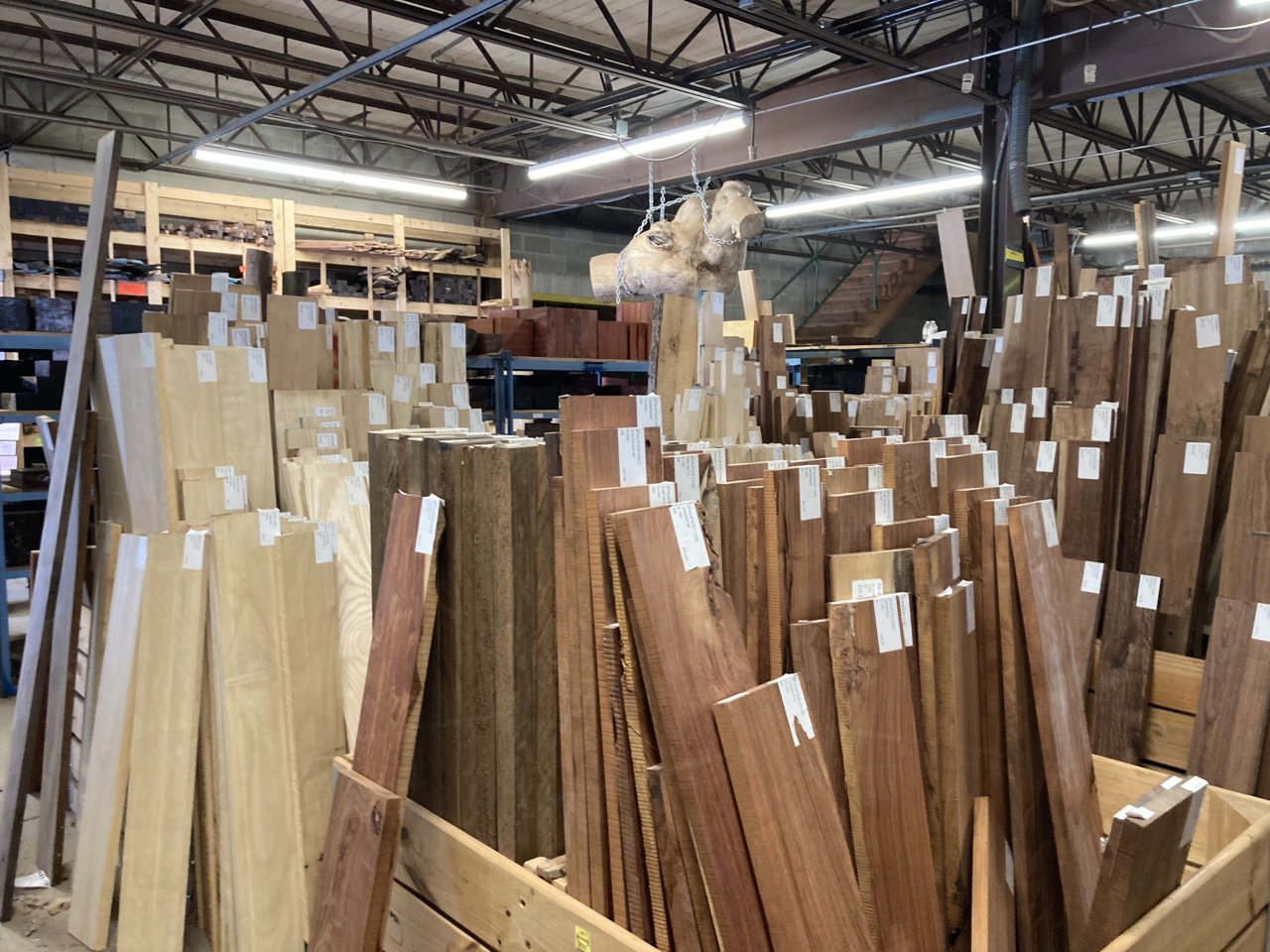

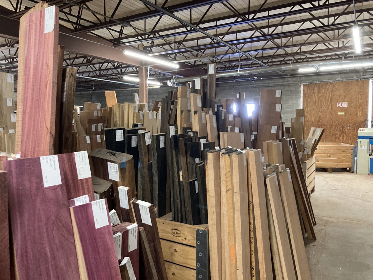

    Stickers on the wood irritates me so much. Our local joint uses wax pens.
    and yes, I know as a business the stickers are probably way more efficient at inventorying and during checkout. Stickers are just annoying

    #176243
    54,257
    Will
    Bourbon state
    Annoying to remove...for me at least

    I can’t tell you how many times I’ve sanded and started staining only to see an exact outline of the label where there’s just enough glue still present to keep the stain from penetrating. Can’t feel it, but just enough residue :annoyed:

    Ok glad Im not the only one that had that happen

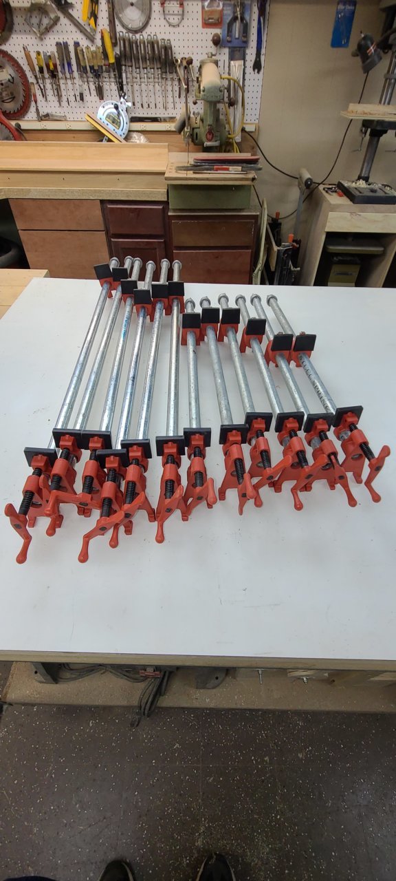

    What are your thoughts on pipe clamps, such as these? They are definitely less expensive than parallel jaw clamps, and can be made in any length. For smaller projects (boxes, jewelry boxes, chairs, small tables, etc.) would they be a good way to go, or should I just save and buck up for the parallel jaw clamps? I know one can never have too many clamps, but I'm trying to make the most of my money for how often I'll actually use them. I typically make a couple/few smallish projects per year. I'm not a high volume woodworker, although I'd like to be; there's just not enough hours in the week for my other hobbies.
    Thoughts?

    I've always used pipe clamps and they work fine. The parallel clamp are a new invention and simply make things a bit easier, but at high cost. Probably worth it for higher volume shops.

    I probably have just as many pipe clamps as I do parallel. And they often get used at the same time.

    I've got a bunch of pipe clamps and they work just fine. It's an excellent way to get a good quantity of clamps for not a lot of money. Especially when you can catch them on sale. I have some Jorgensens that I like. Rockler makes some good ones too. Bessy may?
    I use galvanized pipe.

    I hadn’t used pipe clamps until recently. They worked a lot better than the F and bar styles I have at home.

    Nice wood :evil:

    Another thing I'll add is that 1/2" pipe clamps work well for smaller things up to like 3'. They are lighter in weight, and cost less and still have good clamping power.
