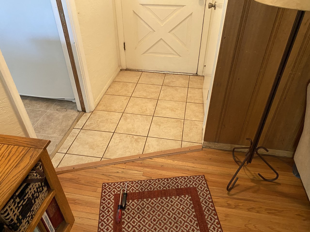

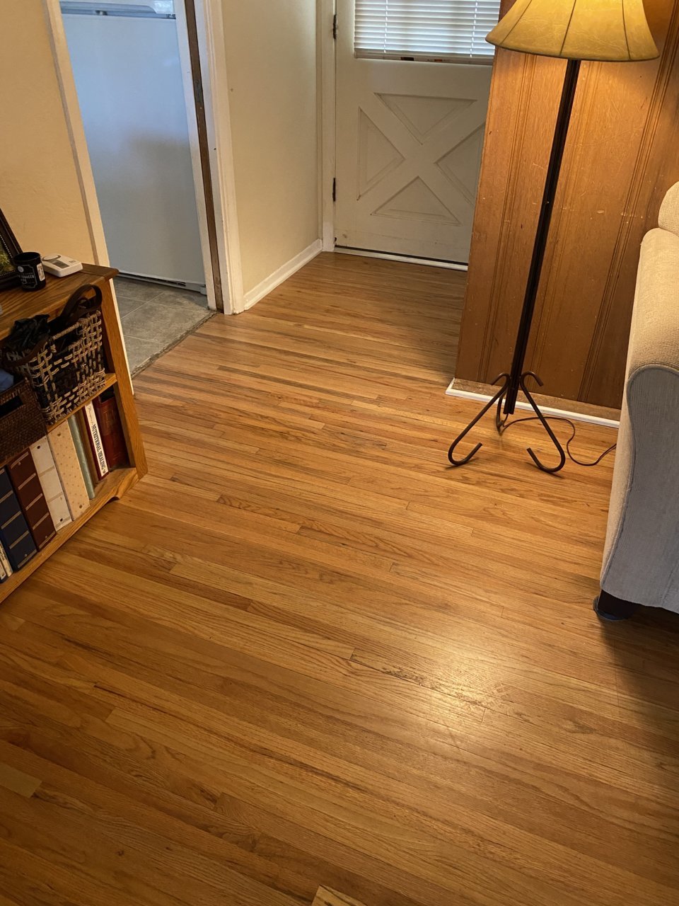

    Damn, you did great!

    It's perfect! Well done!

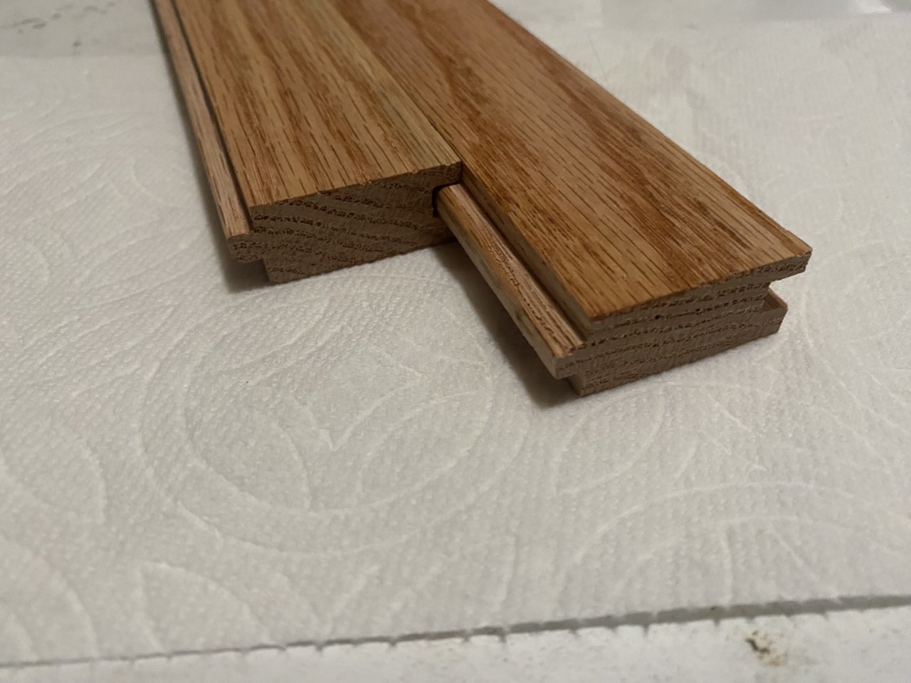

    Great match :)
    What did you shape your t+g with

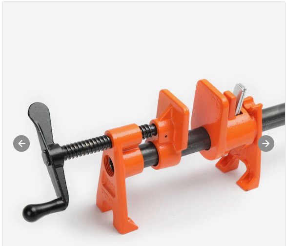

    I find the pipe to be a little on the pricy side especially for longer lengths, but I have several and they work well.

    Thanks everyone!!!
    When I cut back to get rid of the angle cuts I was able to match the original t&g. I’m fortunate to have a shaper and cutters

    Nice work, that turned out well.

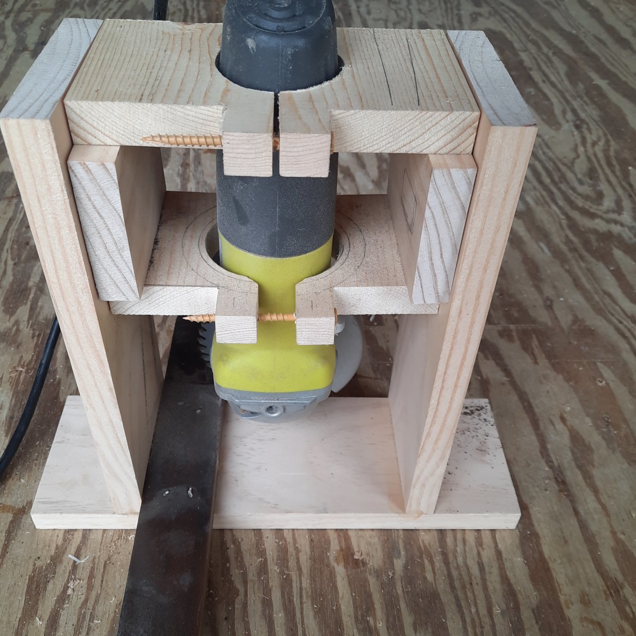

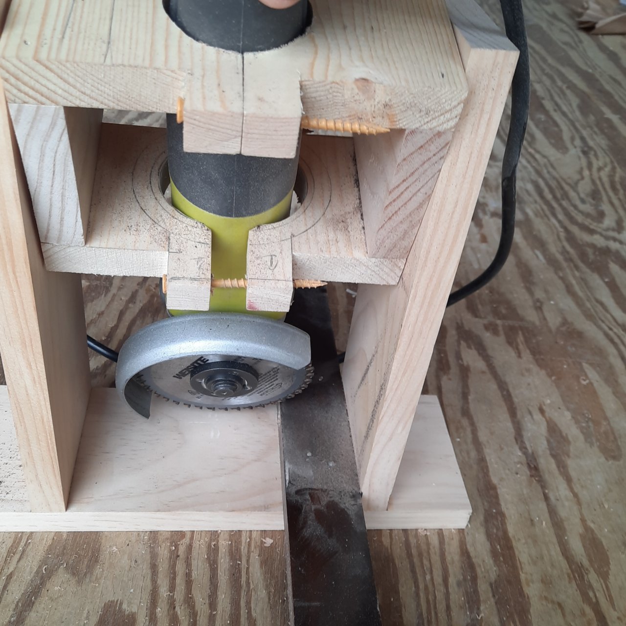

    heres my jig...i still need to learn it more but it works! Dont mind the excessive long screws they are temporary as i didnt know what size i needed when i first started. Center part rotates. I can loosen screws to get a depth up or down then tighten again.
    Front side

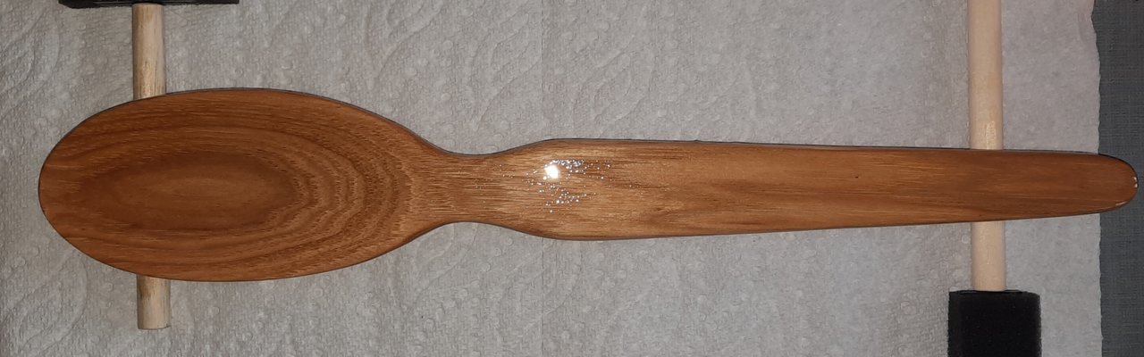

    Sanded to 400 grit, now its got first coat of finish.

    Looks great!
    You gonna trade out those screws for some bolts instead? The jig looks great!

    Yeah now that i know what size i need. Just havent got to it today.

    HAHA! I was just curious which way you were going to go with it. Do you also have jigs for the handles or different shapes etc?

    I just drew this one out, After i cut the concave portion out. I like how it turned out so Ill prob keep one as a template.
    Still a bit of sanding with a template even

    Harbor Freight has very cheap clamps. I have a few of the 24" and 36" trigger clamps/spreaders and they're good enough for my occasional project. I haven't tried any of HF's bar clamps, but I see that they have a 60" aluminum F-bar clamp for $20.

    It bends if you clamp too tight.

    I have a bunch of the 18” and they work fine. Not really long enough to bend.

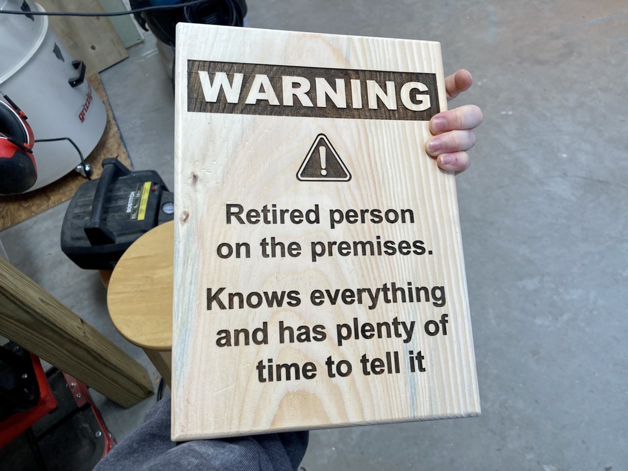

    Friggin mint.
    I have plenty of poly if you think I should put 3 or 4 coats on.
    That’s so awesome Thank You…
    Ye friggin haaa

    I already stained and got one coat on. Im not giving you an unfinished piece ya friggin weirdo. o_O
