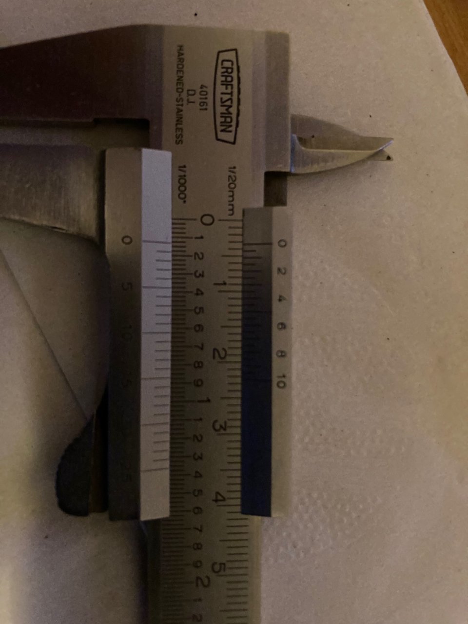

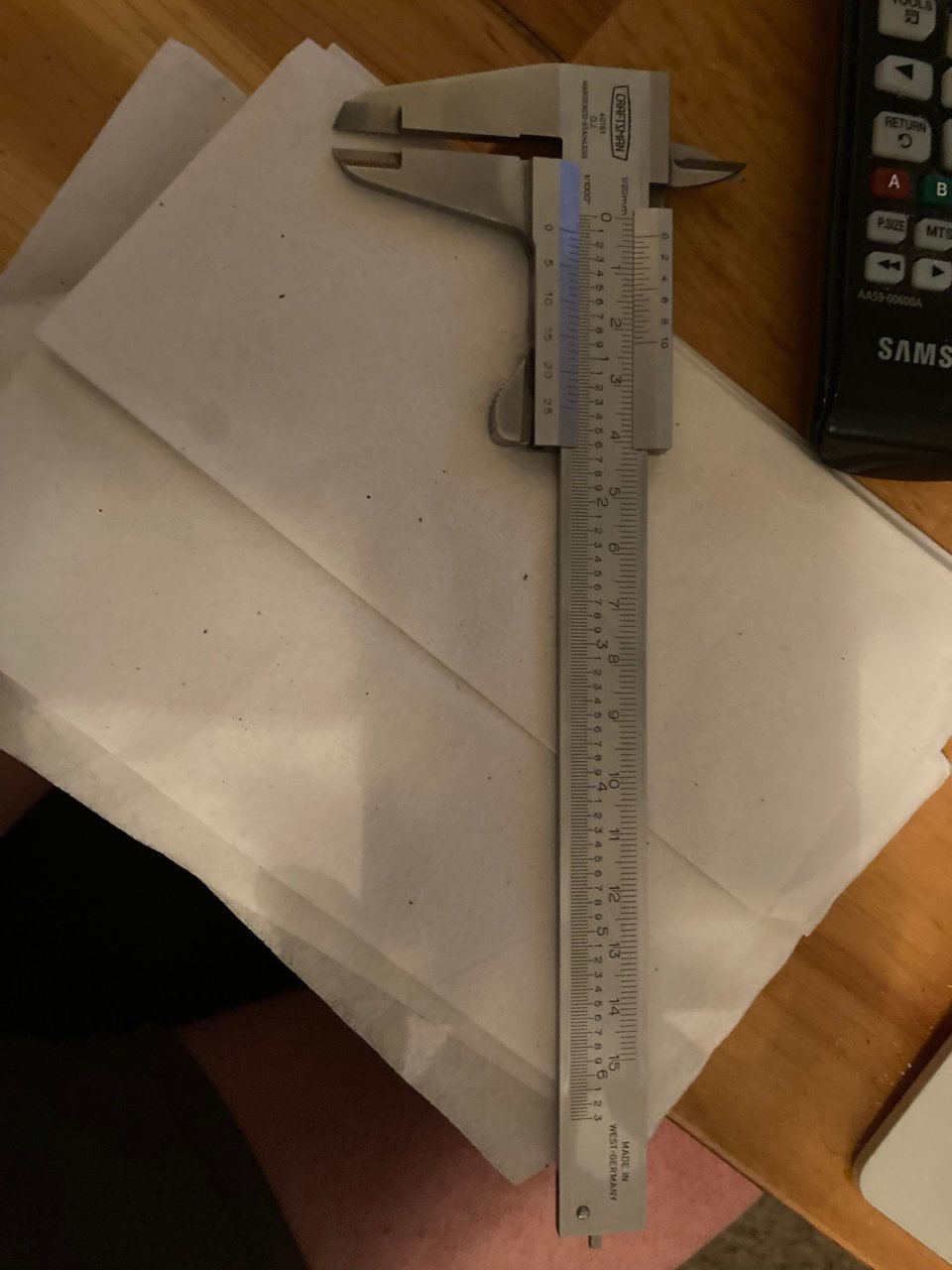

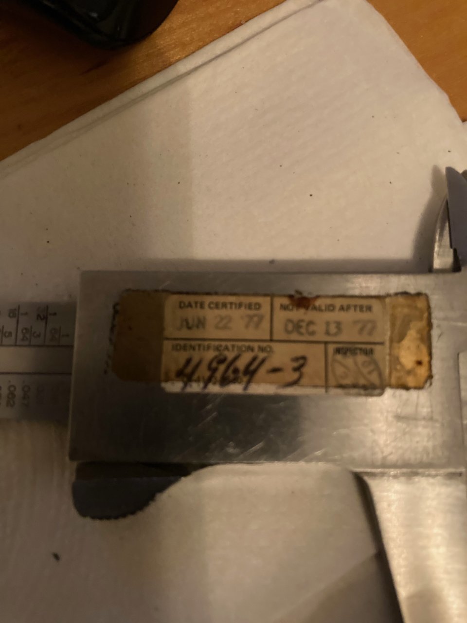

    The old-school caliper my father used as a Quality Control Engineer. 10,000,000 space-bucks to the person who can read what it measured. Also, just a tweensy-bit past last calibration.

    Pretty close to .125"

    Next contestant.

    Well, to be fair, it is out of calibration! :anonymous:

    Is there no one who can read an old-school caliper?

    Well, this vernier caliper is vexing because it mentions both mm and thousandths of inches. I have not seen that combination before.

    No idea what I'm doing but .107"?

    Response in either mm or inches is fine.You will notice that 1 in takes up 2.5-ish cm.

    I want to keep my 10,000,000 space-bucks, so ...
    The 0 on the sliding bar says it is between .125 and .150. You find the best lineup of the bars on the center bar and the bars on the slider to get the remainder between .125 and .150. Same method for the mm side.

    Sooo...
    Pretty close to .125". I'm in the ballpark at least! .129"

    Exactly. Not so easy to read the exact on those, but these days +- .001 in is not my worry.
