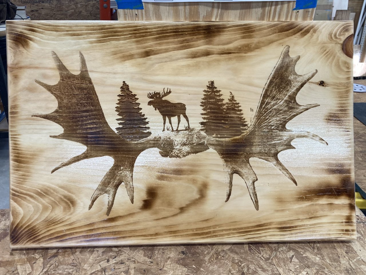

    Lasered some wood this weekend

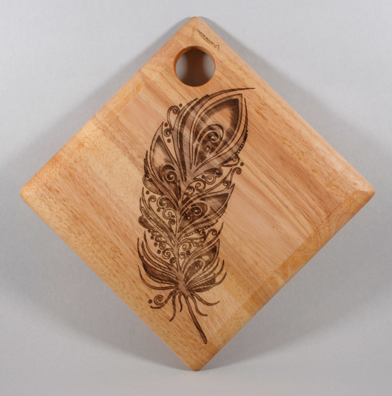

    Basic-white-girl cutting boards hammered out yesterday while waiting on the poly to dry on another hunting portrait I lasered over the weekend. :rofl:

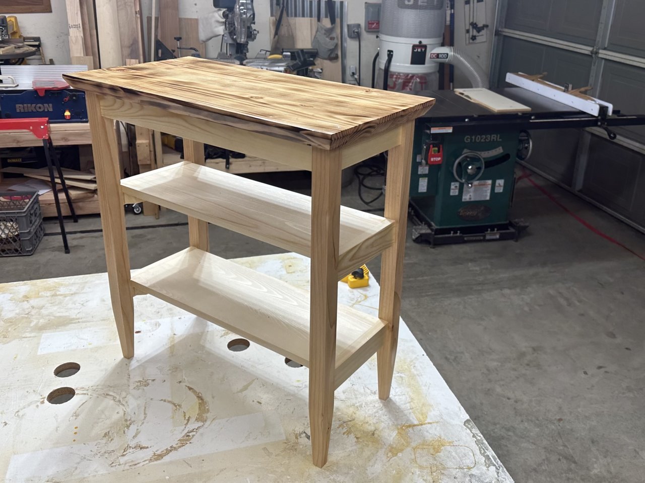

    Bedside table for my son’s new college apartment. The top and legs are made out of construction grade 2x4s.

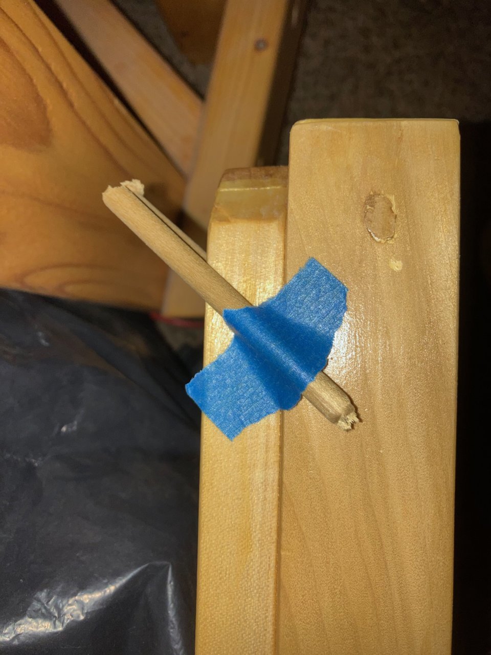

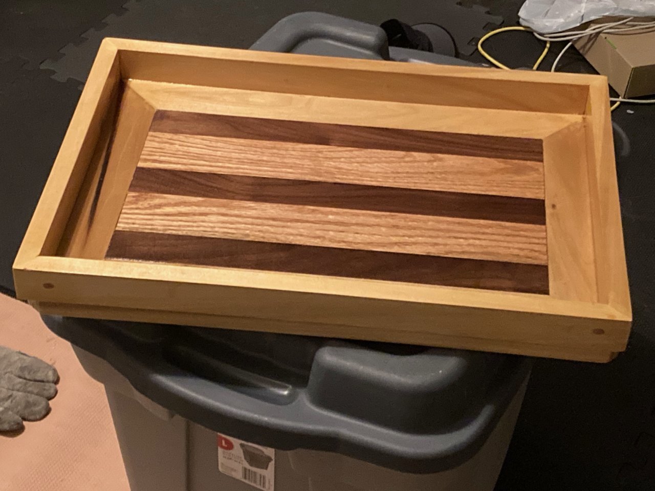

    I need a woodworking/engineering opinion. I want to make a nice serving tray as a wedding present for a nephew. I have a tray already, which any competent finish-woodworker would say "too many imperfect coats of poly" ... they would be correct. But they might accept it because it is personally-constructed.
    If your opinion is "not sturdy enough", I will restart with a better design.
    First picture is the side/top angle. Second picture is reinforcement I hope will fix it. Since it started as a rehab project, joining two failed previous projects. Reinforcement is needed because the bottom (3/4 in thick) is edge-glued to the top rim horizontally -- NOT vertically. I am adding 1/4 in poplar dowels, in roughly 45 degree holes. The dowels are 3 in long, the picture shows one of the dowels almost inserted ... well the sample peg taped on tells the tale. I cannot pound any more at 11 PM in my apartment. And you can see how much dowel remains to go in.
    The center strips are alternating walnut and oak. The rest of the tray is poplar.
    Will 8 dowels, inserted 2 at each corner at 45 degrees, at the depth you can predict, be enough to make the top-rim-to-bottom-plate attachment strong enough to last for years?

    If you added wood glue in with your dowel joint, then the joint itself is probably stronger then the actual wood. Meaning that the wood would fail before the joint, for clarification.

    X2

    Thanks for that. I hoped it might be string enough, using the angle to my advantage.
