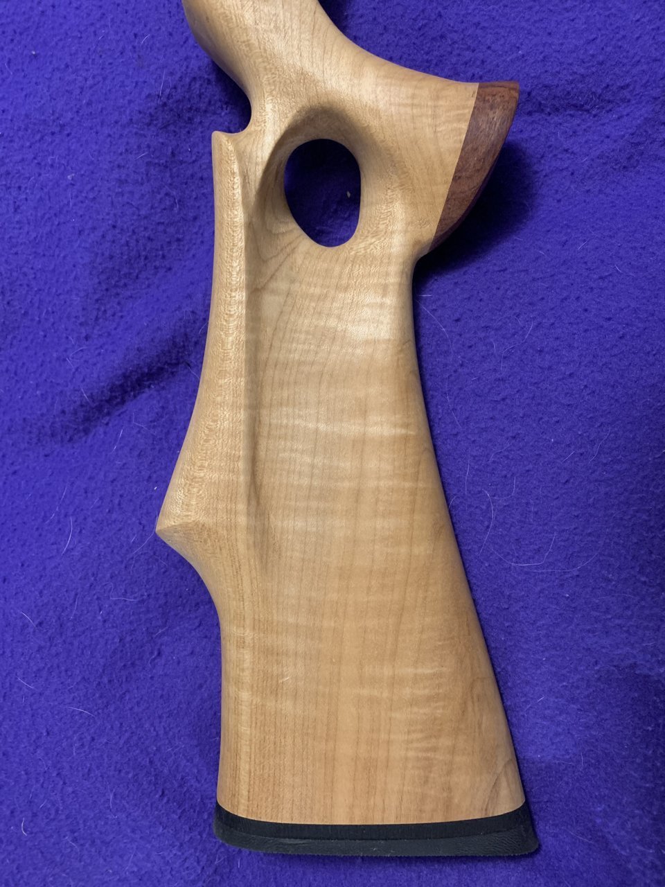

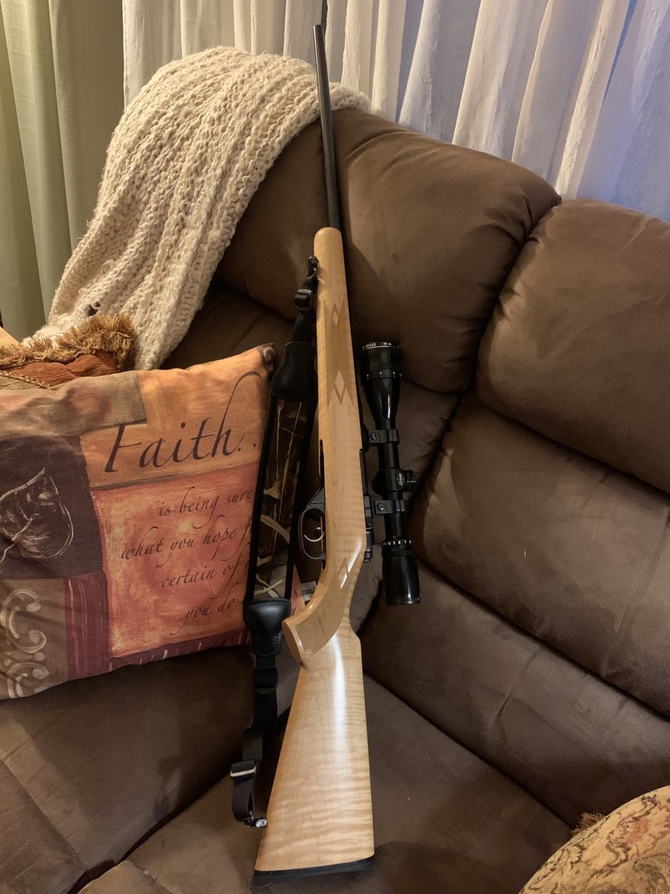

    Congratulations on your son’s graduation. I love maple…This 22lr stock was cnc’d out a chunk of big leaf maple that my BIL’s uncle logged and milled off his property in Woodland Wa. The last photo is a CZ 527 Maple stock 223. I also have access to furniture grade slabs in Grand Junction CO that I will eventually bring home. Have fun!

    Sheesh! Teach me the ways of stock shaping!

    Love to stock on the rifle. The grain looks amazing! My FIL built a baby crib that both of my boys used out of figured maple 22 years ago. It is now a family heirloom that all of his grandkids have used. It is currently fresher up and waiting for the first great grandchild.

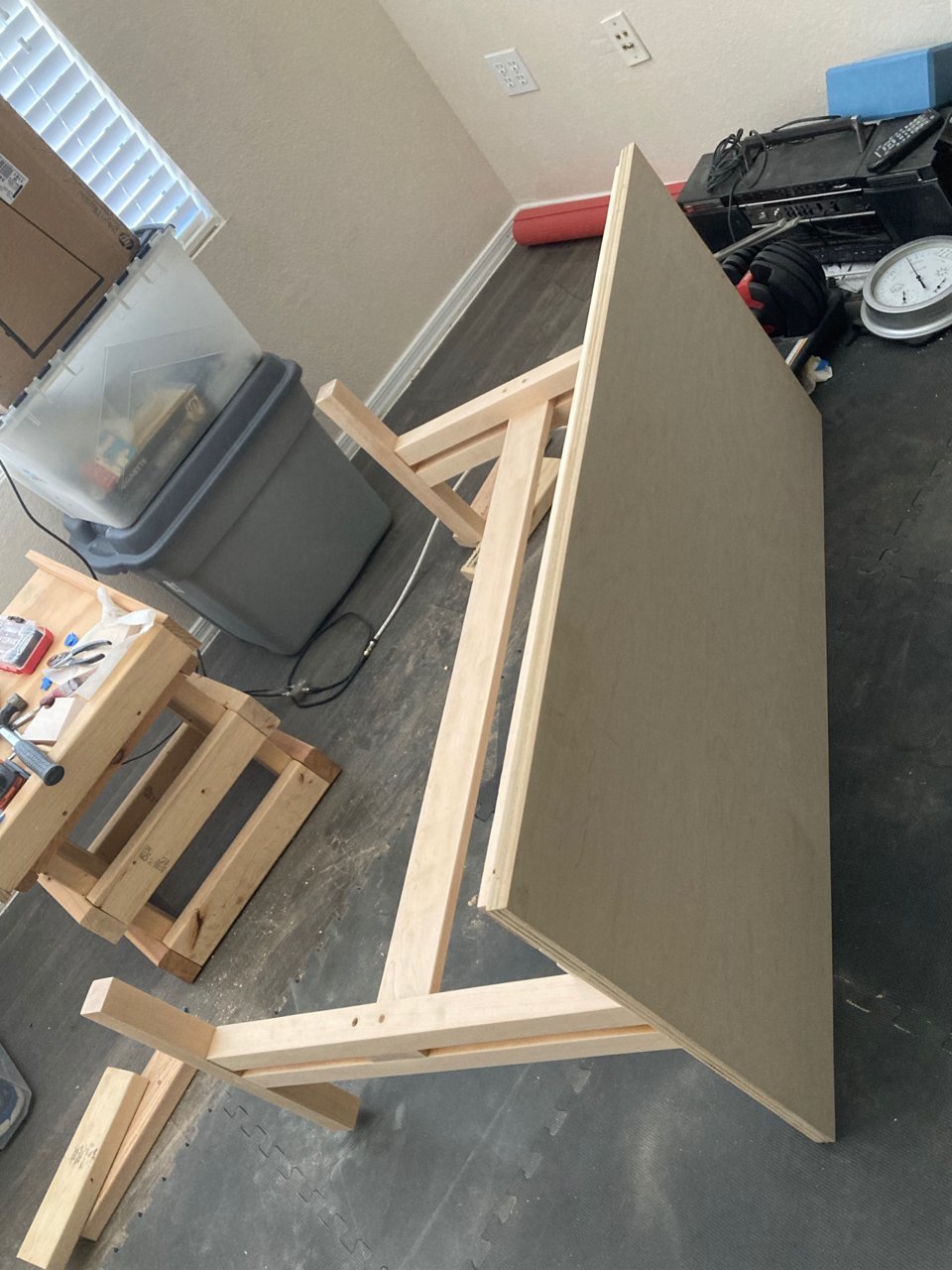

    Next question on my table project. Sanded (random orbit ... what an arm workout!) down as far as I could to remove 20+ years of oxidation from the maple. Added support braces under the table-top and screwed them into the legs and that when the top tries to tilt it must contend with those braces. Added two long under-supports on the outside edges because the top is "cupping" to bow "up" ... these new supports will at least partially limit the "cupping". Sanded to 120 by hand.
    I am tired of refitting for strength. Will add maple veneer edging to the table-top and that is it. Time to stain/finish.
    I have 26-ish sq ft of bare (as close as i can get it) maple wood. Mistakes will be obvious. I do have several maple remains to test my theories. I have read and seen "gel stain" applied as wipe-on (short demonstration at the wood-shop). But the more I read and hear the less decided I am as to final approach ... gel or liquid. Gel stain may not bring out the grain as nicely as liquid stain, but gel seems a "less effort" approach to getting a decent highlighted surface and pre-conditioner may not be required even on porous woods like maple ... and there all of the vertical surfaces. Liquid stain dries faster and allows deeper pattern reveal.
    Either way a seal of probably simple polyurethane will protect the results of the staining.
    So ... gel or liquid stain?

    If you havent already, wipe everything down with a wet cloth let dry then final sand to 400grit.
    Id test a couple scrap pieces for stain.

    Did the wet cloth but read that maple "burnishes" and closes the pores for gel by higher than 220 grit (some say stop at 150). Liquid stain maybe not but still against closed pores ...

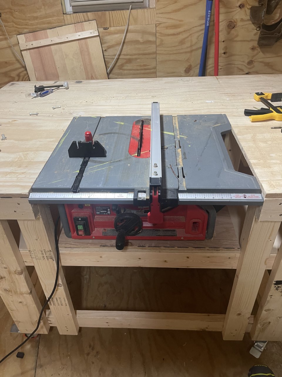

    Some may call me crazy but my 10" craftsman ive had for a decade and aside from replacing blades, its never failed me. It takes some constant attention to make sure before precision cuts that its square but aside from that it runs like a charm

    I built mine into my rolling project table

    Here’s the pic
