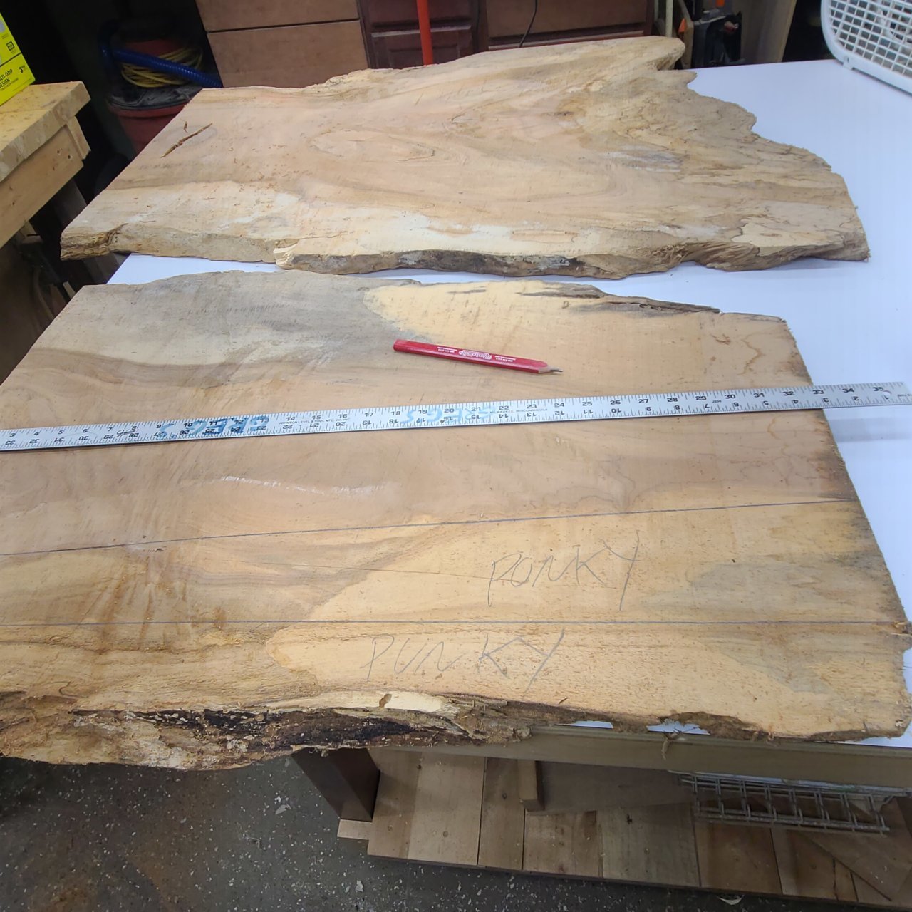

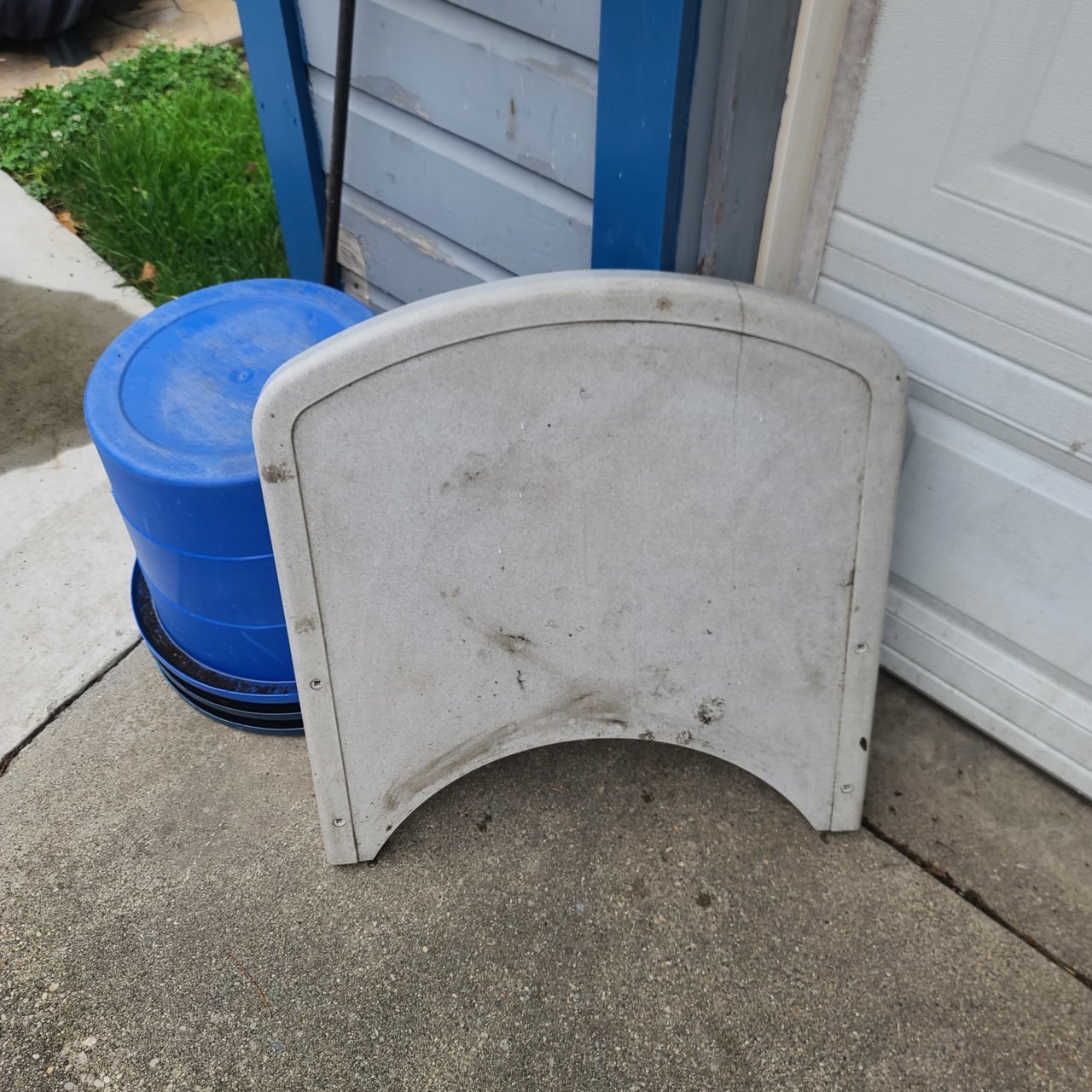

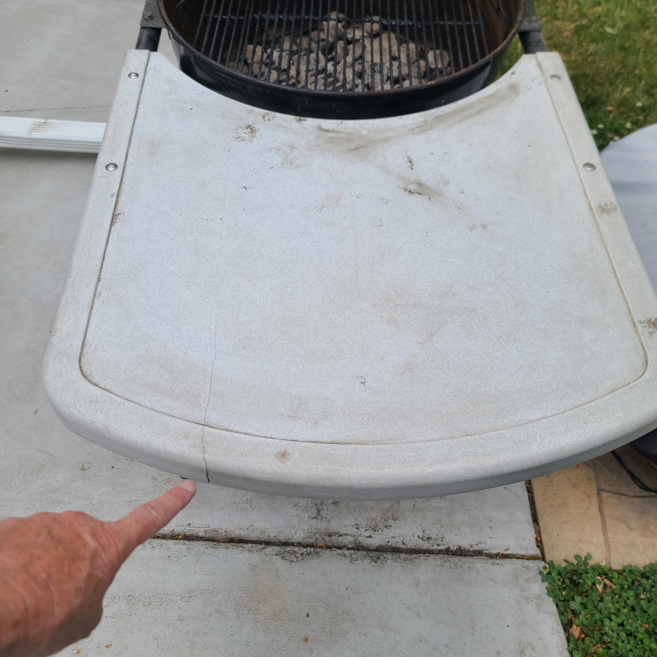

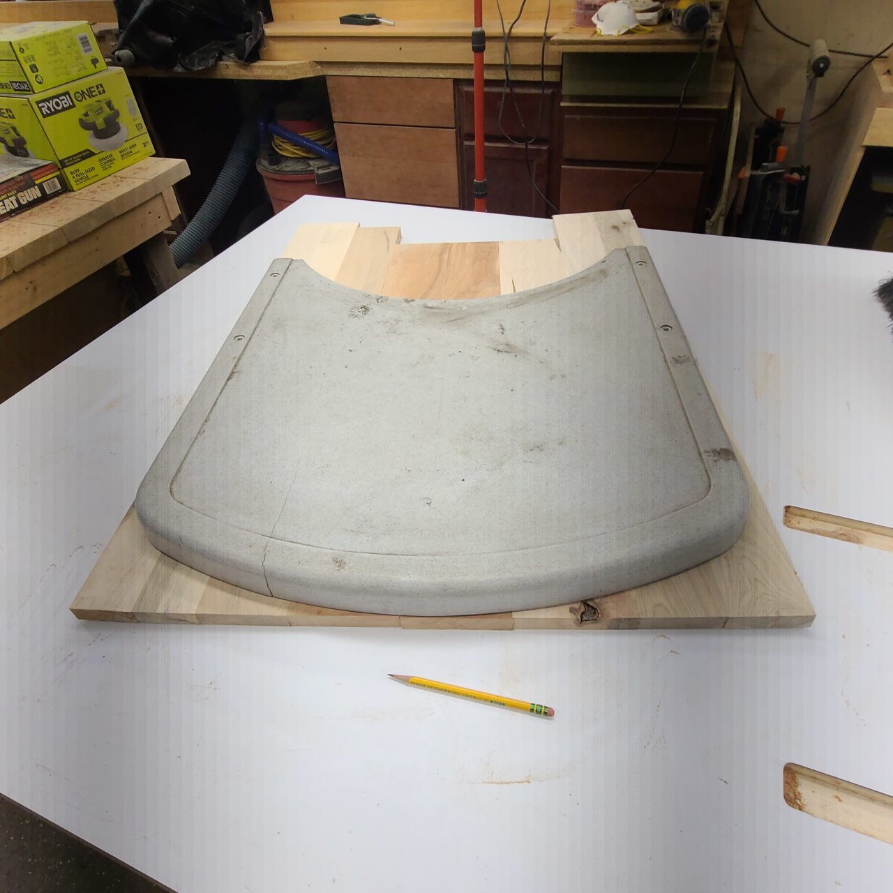

    New project is a replacement for the table on my Weber BBQ. The plastic one is cracked right in the middle.
    The crack.

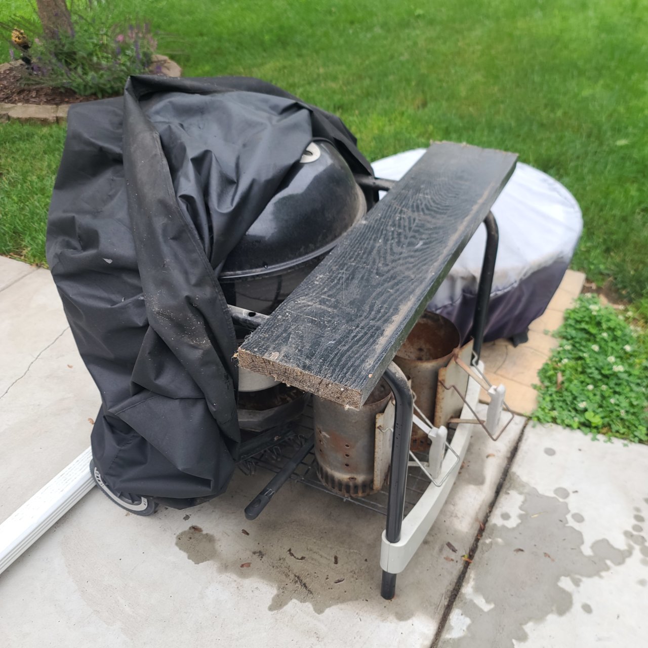

    table off.
    Just a temporary board for a table.
    the broken table will be used for a template.

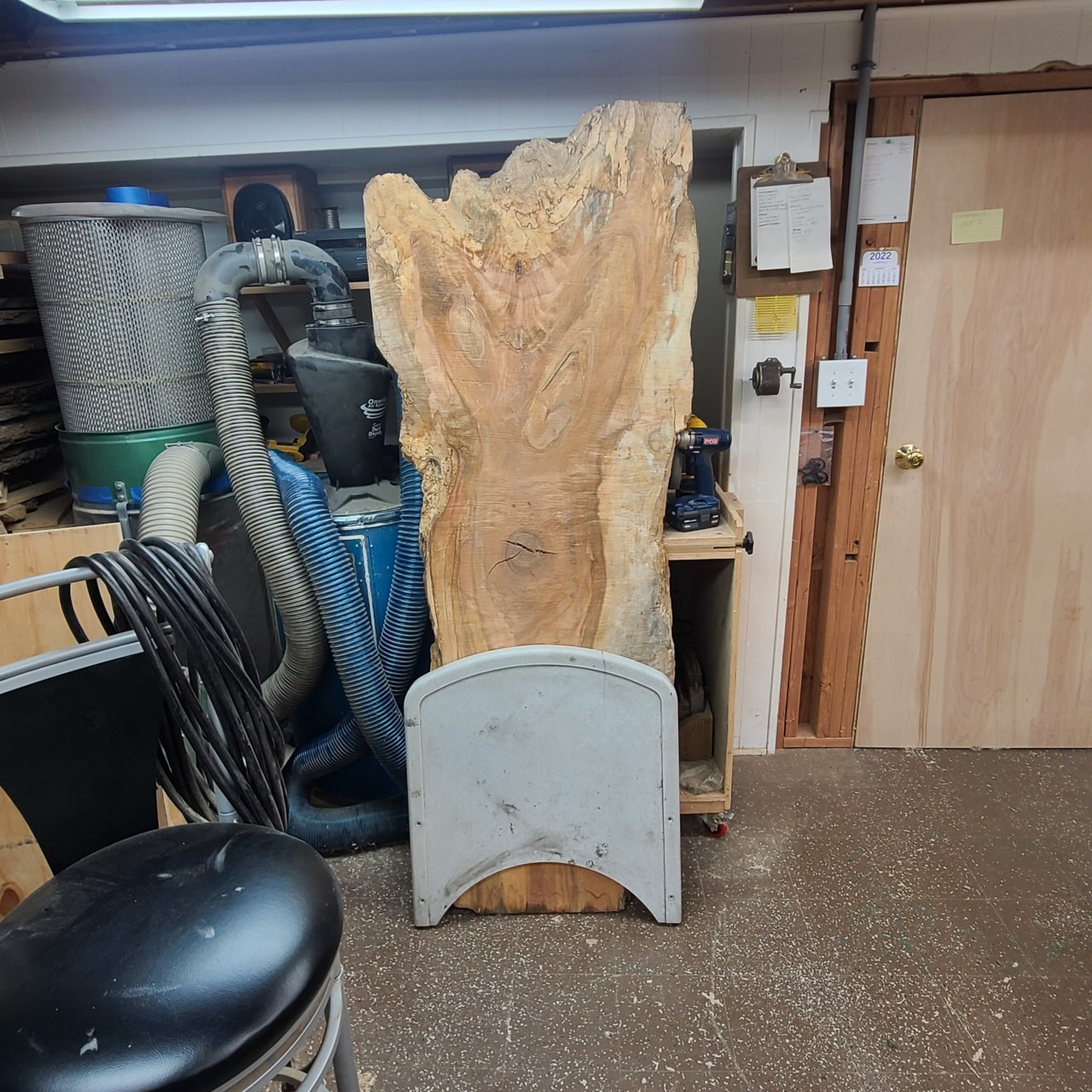

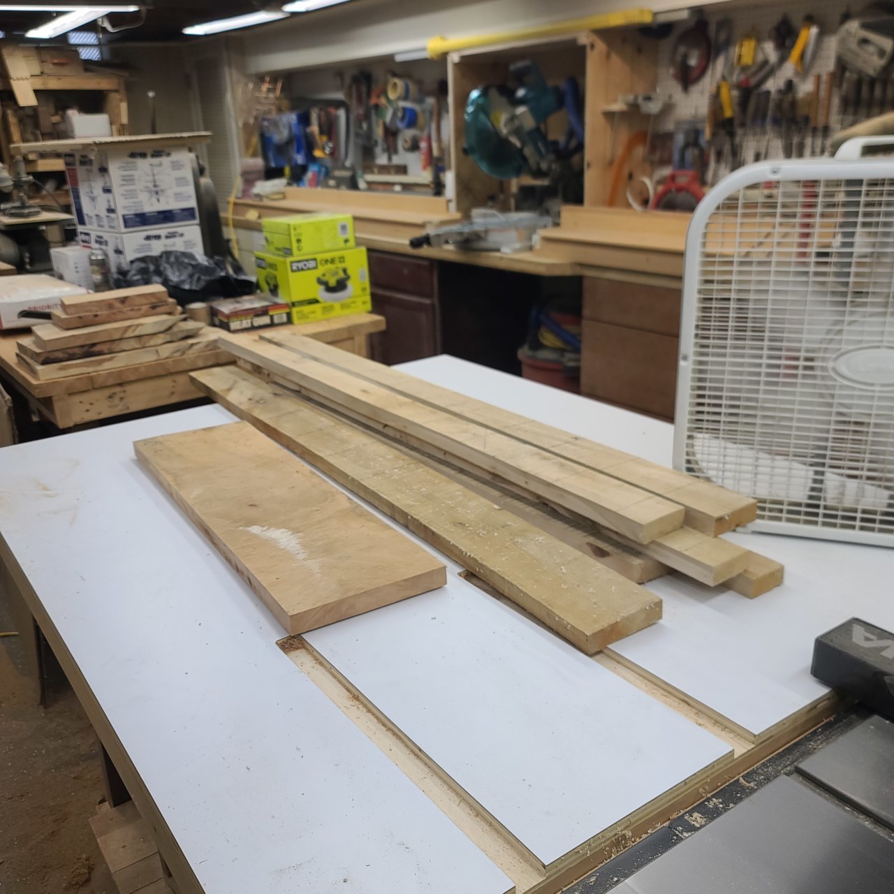

    Big slab that I'll pull a couple of boards out of. Most of the wood is punky.
    and it's got a pretty good bow to it, lol.
    Breaking it down.
    I added some 5/4" maple pallet wood that is years dry
    This will be jointed and planed to give me the boards I need for the glue up.

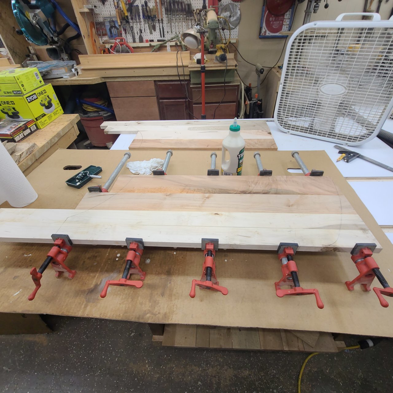

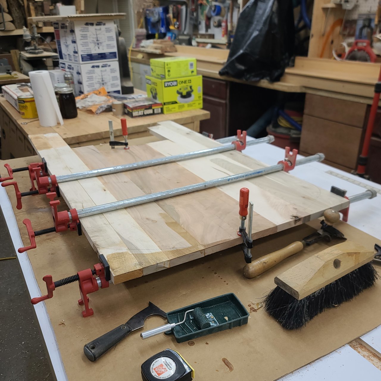

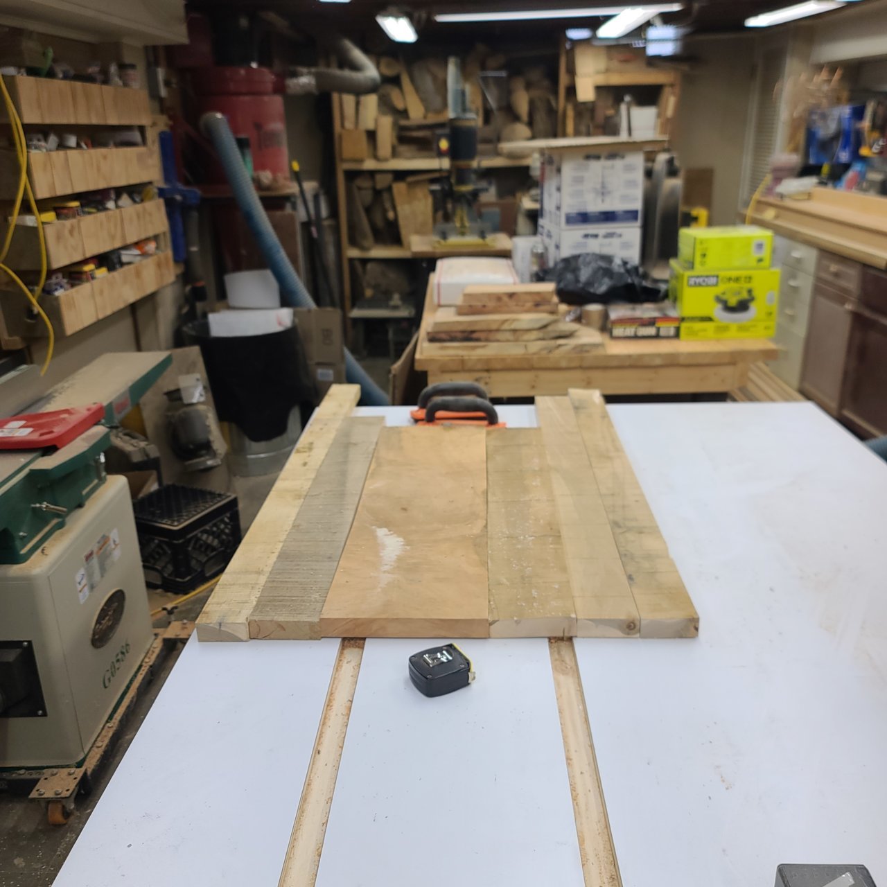

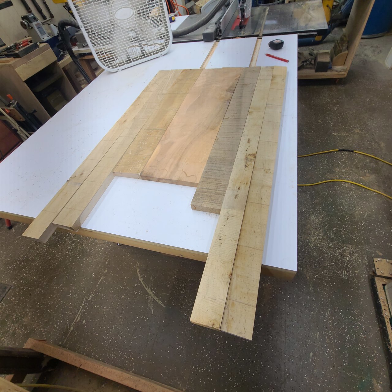

    Selected the boards for the glue up. These are jointed on 3 sides.

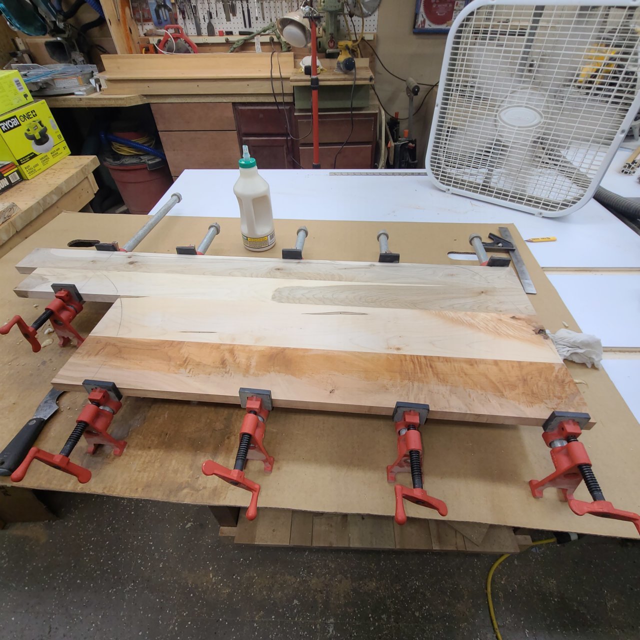

    Checking for size. The plan is for the new table to be a little bigger.
    first half in the clamps.
    Second half in the clamps.
    Then I jointed the center boards and glued it up.

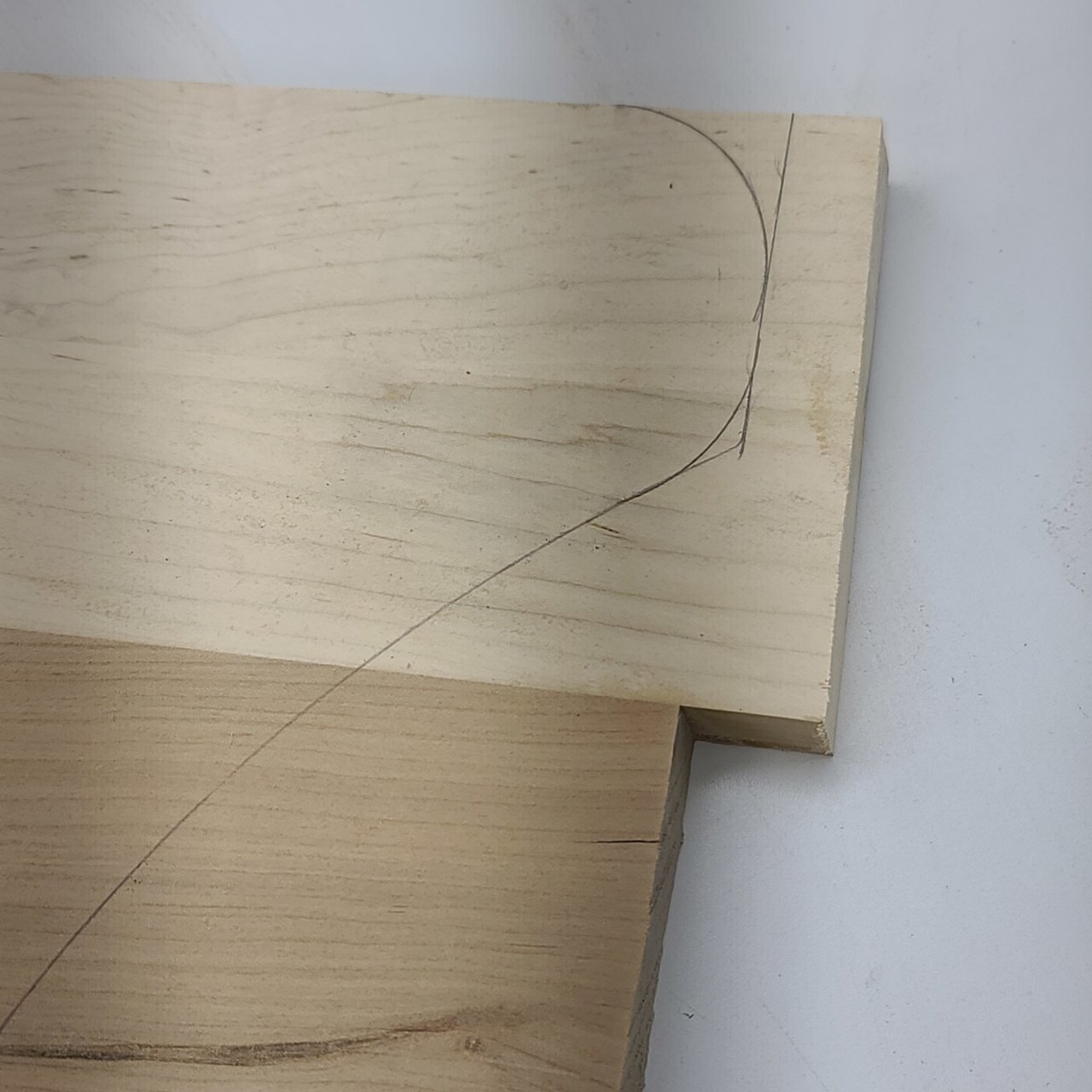

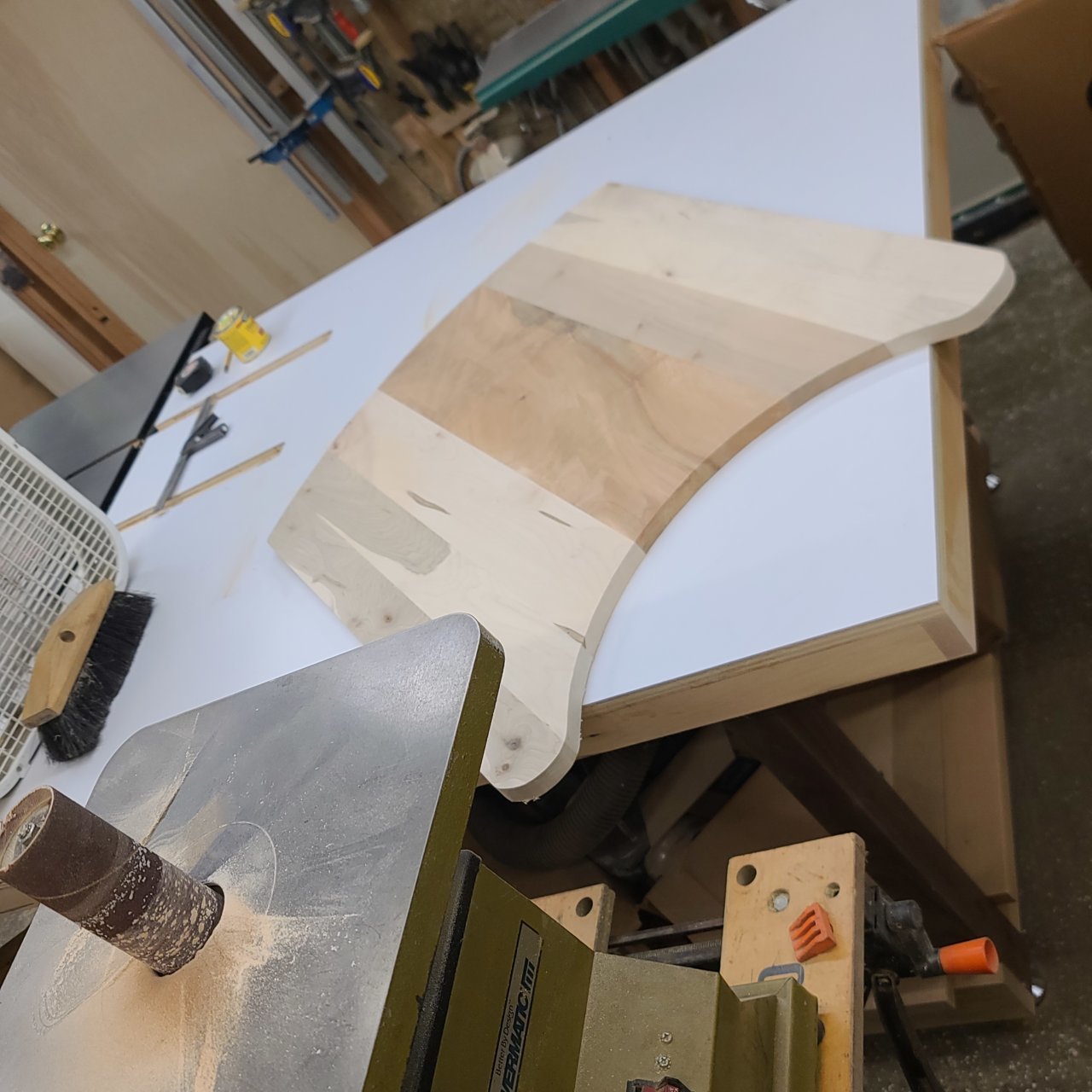

    Using the old table as a template to layout for the new table.
    Some radiuses for the ends instead of just squaring it off.
    Off to the bandsaw to cut it out.
    After cutting it out I sanded the top with a disc sander and a spindle sander to remove the band saw marks and smooth the edges.
    a trim router took care of rounding over the edges top and bottom.

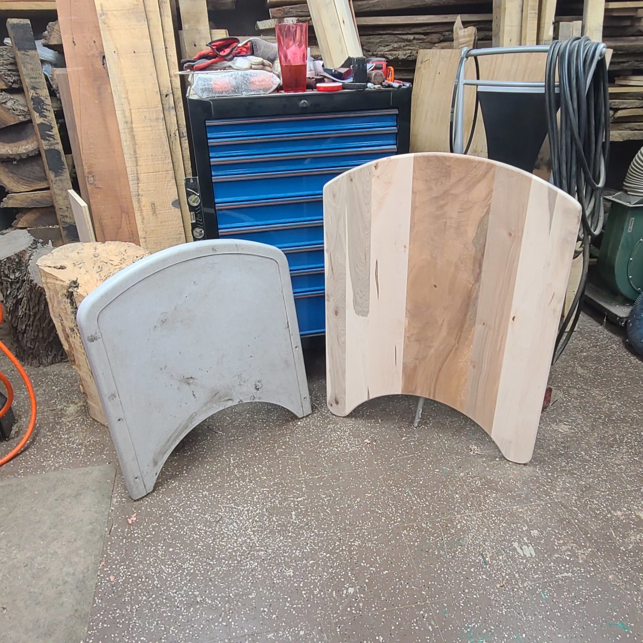

    Lots of sanding both with a r.o.s. on the flats and by hand on the edges. It's now ready for finish. It's about 9" larger in length and a couple inches in width.

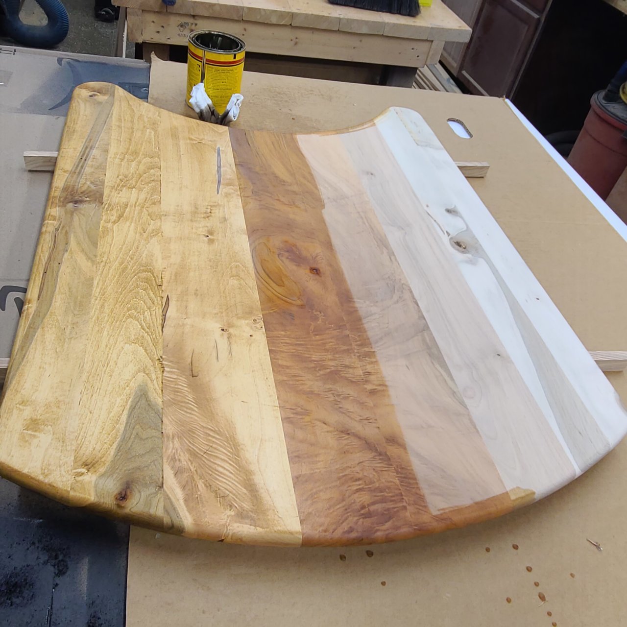

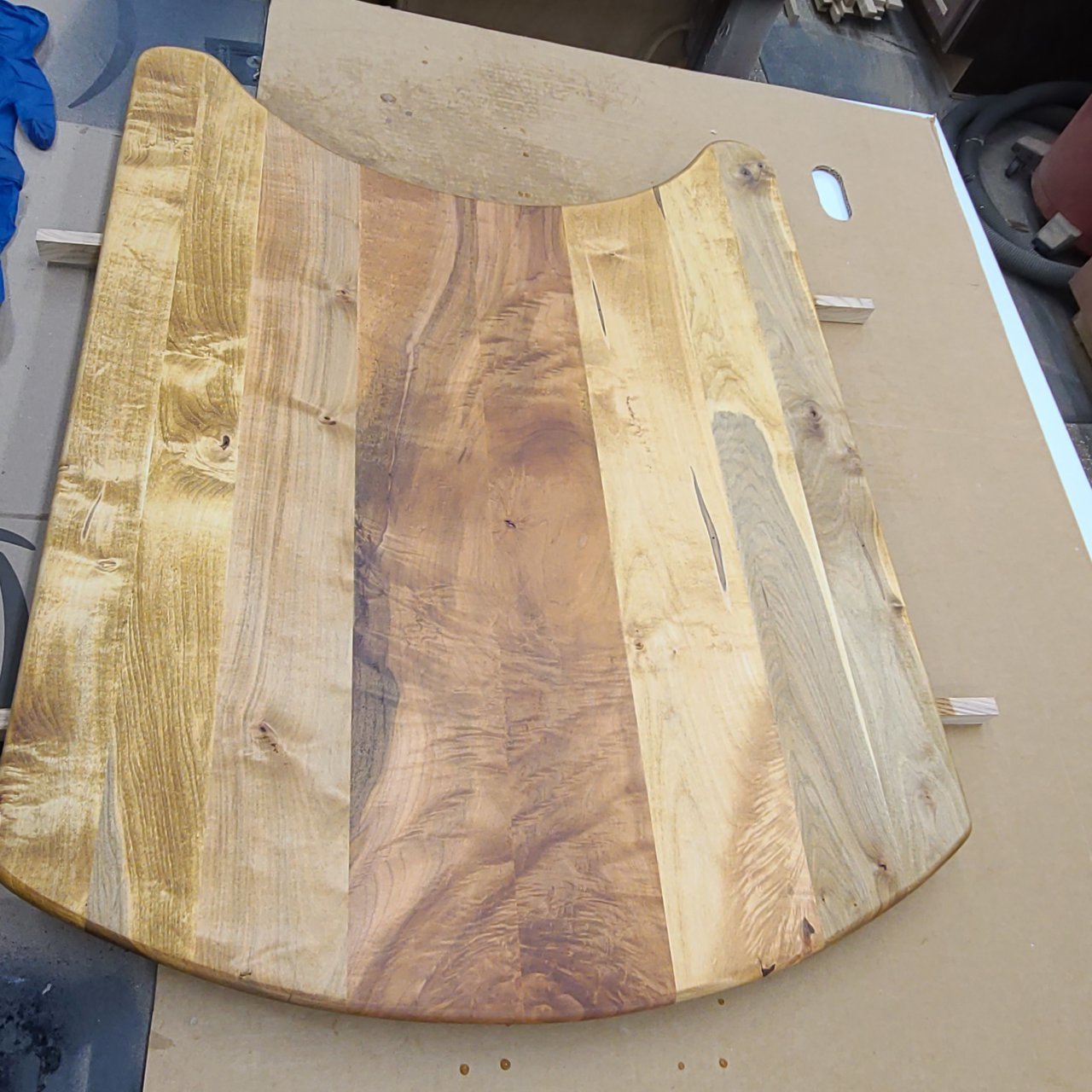

    Minwax oil based stain evened up the color of the different boards some.
    half of it with the stain applied to show the difference.
    I applied it liberally, let it soak in and then wiped off the excess. Pretty nice figure in some of these boards, the stain made it pop.
    It'll get 2 coats of spar polyurethane top and bottom.

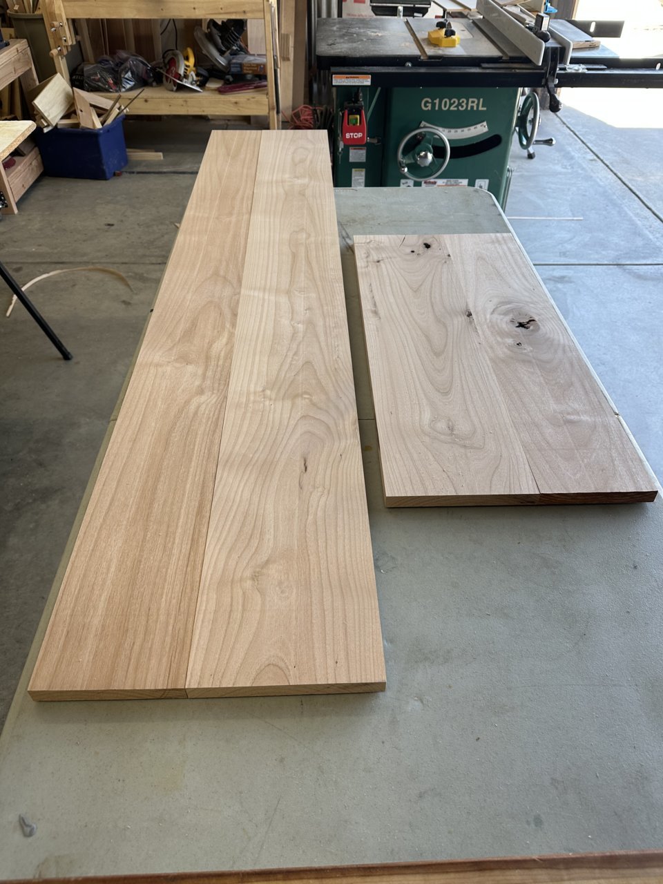

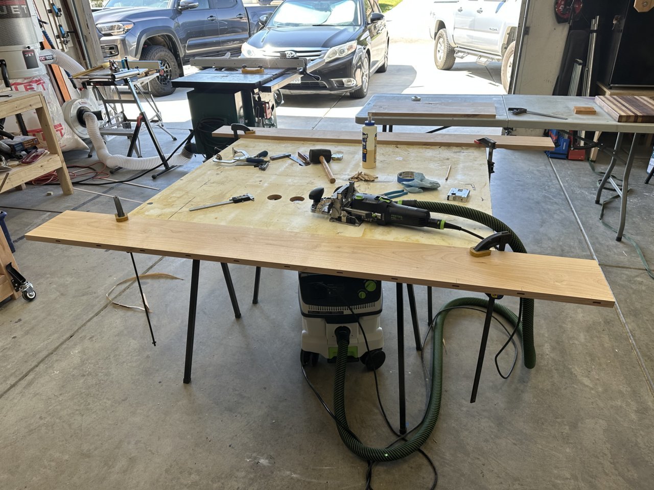

    I glued up a couple of panels made of Alder today for a new project. I used my new Domino. It made it much easier to get it and keep it flat.
