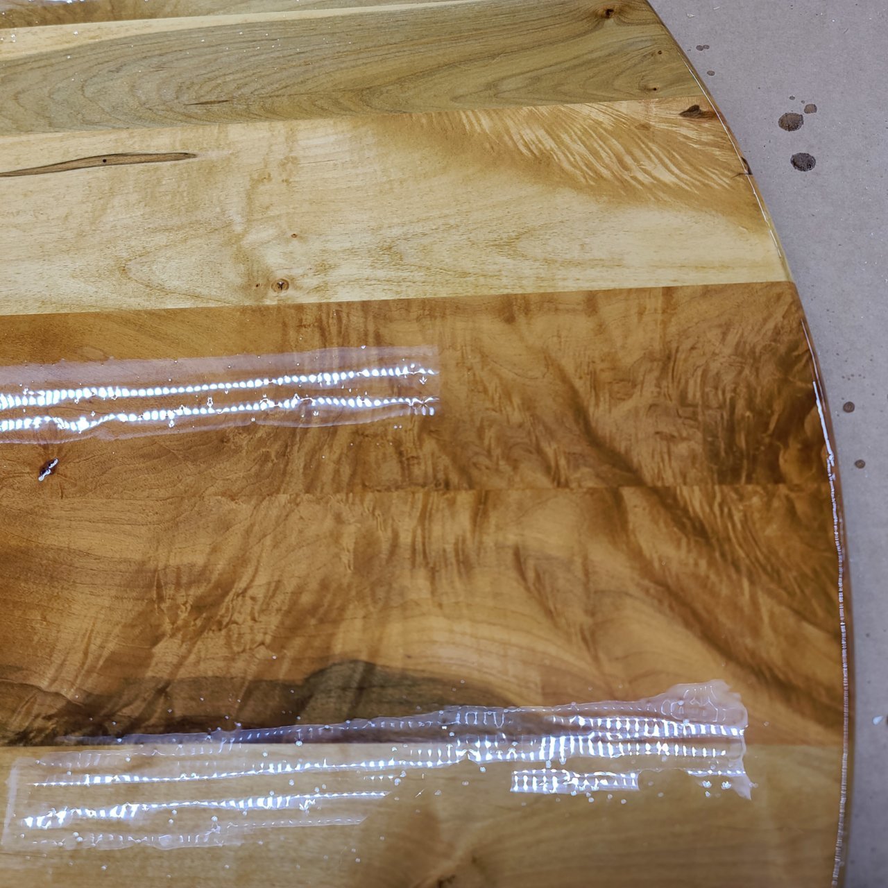

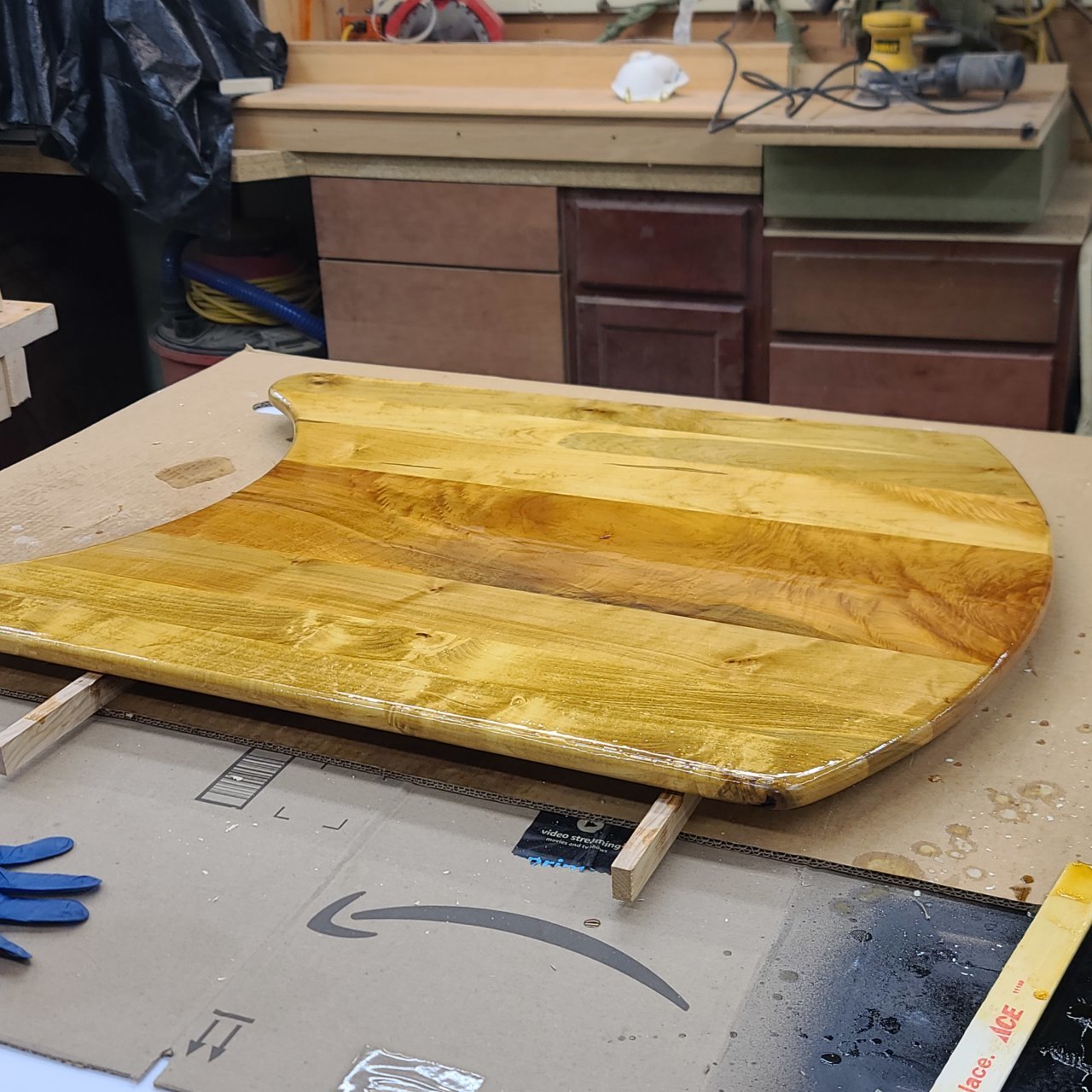

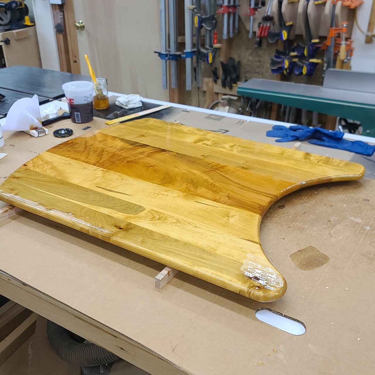

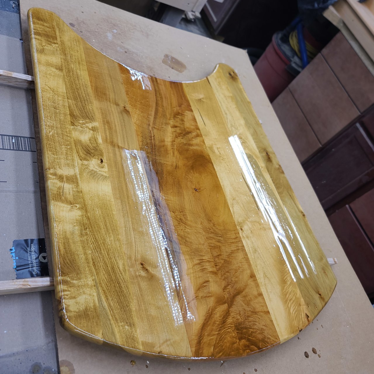

    I'm still applying finish to the BBQ table. Spar varnish takes a long time to cure, it's partly due to the fact that it stays flexible even when cured so over the years it doesn't crack. Doesn't help that this finish is years old, even though it was in a sealed Mason jar. I did strain it and I had to thin it out some with mineral spirits.
    This is the third wet coat on the top.
    I just love looking at this little bit of figure.
    Its hard to get a good pic without the reflection of the shop lights. If i stand back at an angle and then zoom in it seems to work.
    It makes it look really long though, lol.
    I'll give this a few more days to cure and then flip it and put one more heavy coat on the bottom just to seal it up.

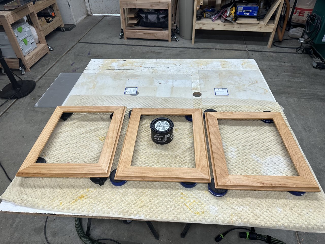

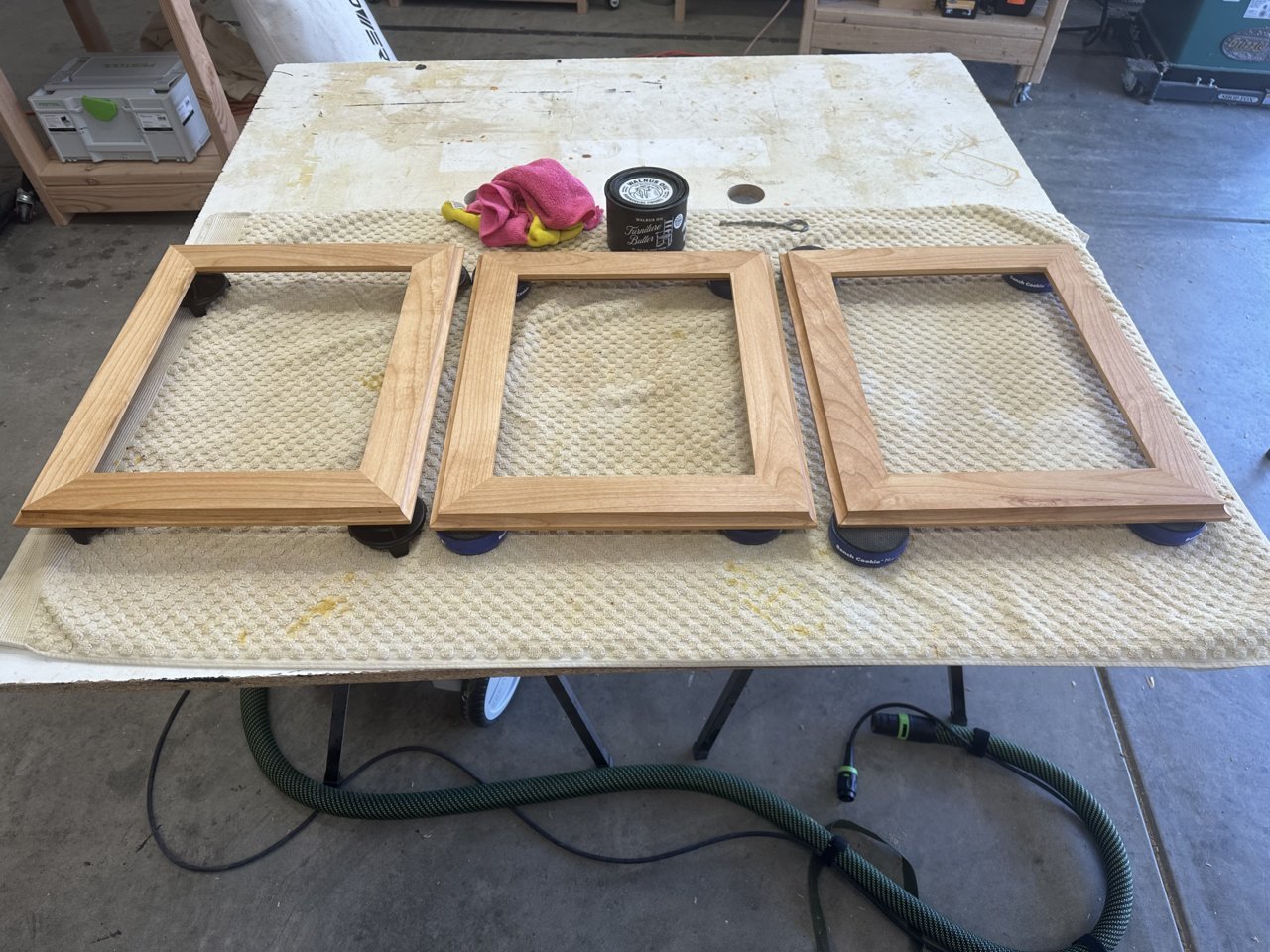

    Frames have had a cove added to the edge, two coats of Furniture Butter, and plexiglass cut. 6CD3600C-CE5E-4AD9-BACD-9144F9E47B93.jpg4C118460-9F18-4CC9-BEEA-C3450C1DCDEA.jpg B14DEB31-A925-4223-9AAA-C4B5EE07C2D7.jpg

    Not sure ive seen a frame with a cove that really adds to it

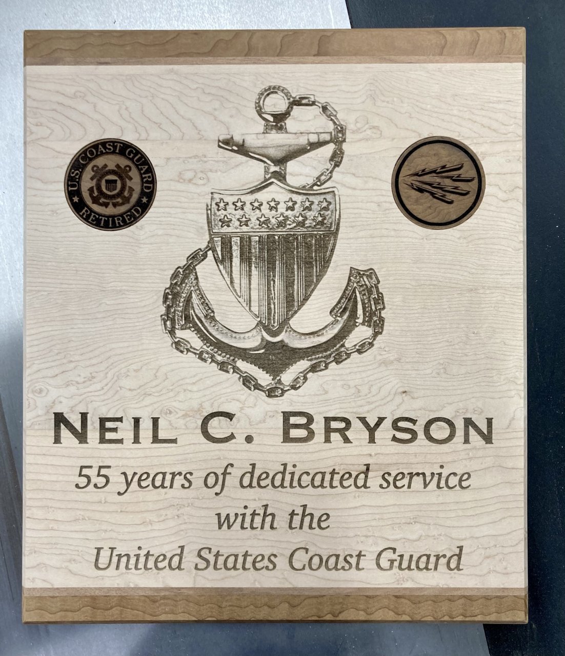

    Lasered, drilled, and put the coin inlays in. Finishing up a plaque for a good friend of mine who is finally retiring. He did 22 years active duty and another 33 as a civilian supervisor at the Sector here. He was the reason I joined the USCG and is an all around awesome dude. :rolleyes:

    Looks great!! Well done.

    Sweet!

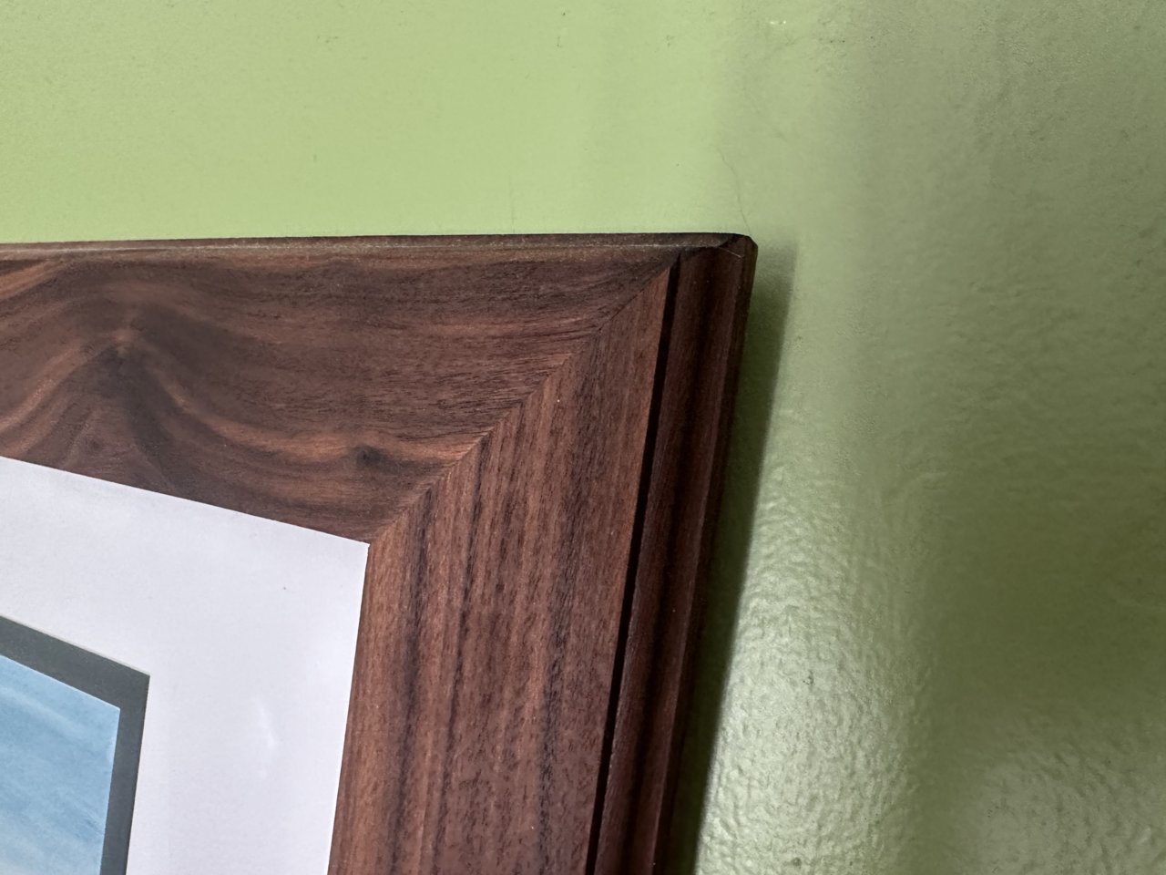

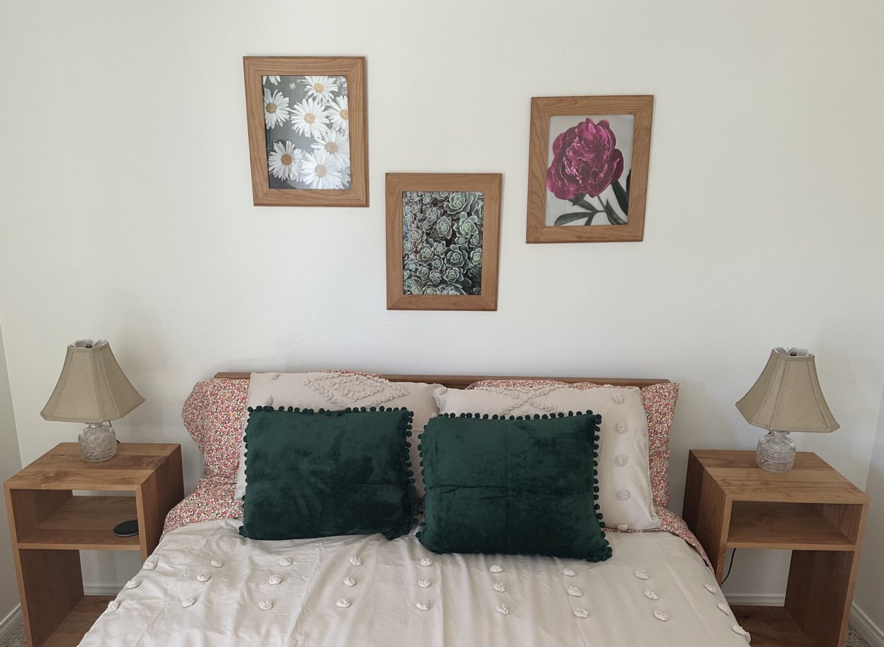

    My wife typically chooses the Roman Ogee for the edge and gloss poly for the finish. Decided to mix it up with cove and oil wax instead. She put pictures from her garden in them.
    A84F0609-D93E-4ED3-A029-7732AF4B3897.jpg 676FD95A-7485-4721-A0BA-3495855569AF.jpg
