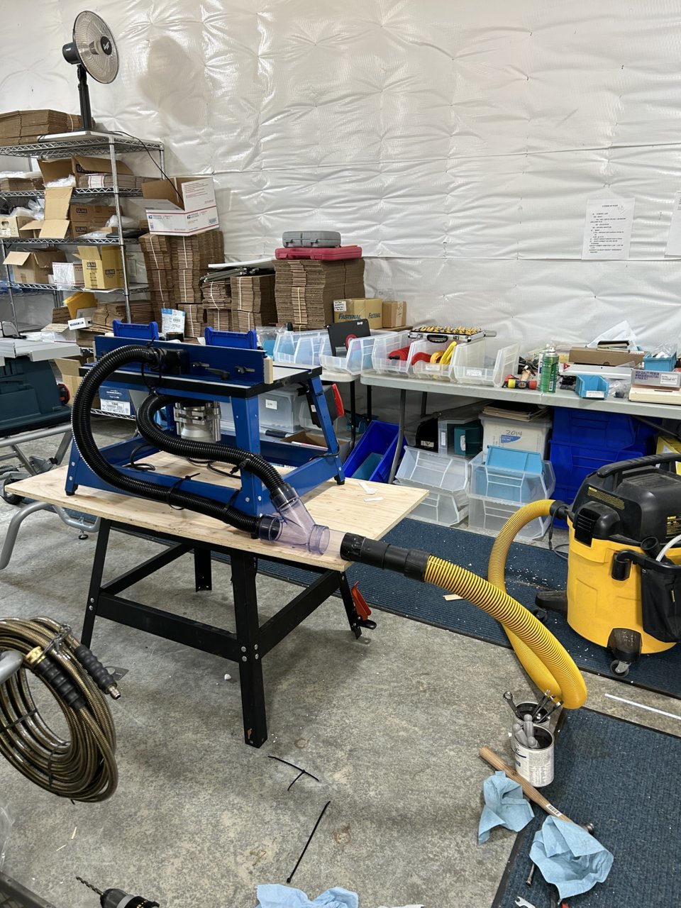

    Did a bunch or grooves. No matter what a lot of chips go forward. I mean it catches some, but not all. Oh well.

    Set something in front of it with a deflector into a 5 gallon bucket

    Hahahaha I did. Nicely actually. Thanks. I'm not spending more money on it, edge routing no problem, chips all sucked up.

    put a vacuum port on the front of the board you're routing

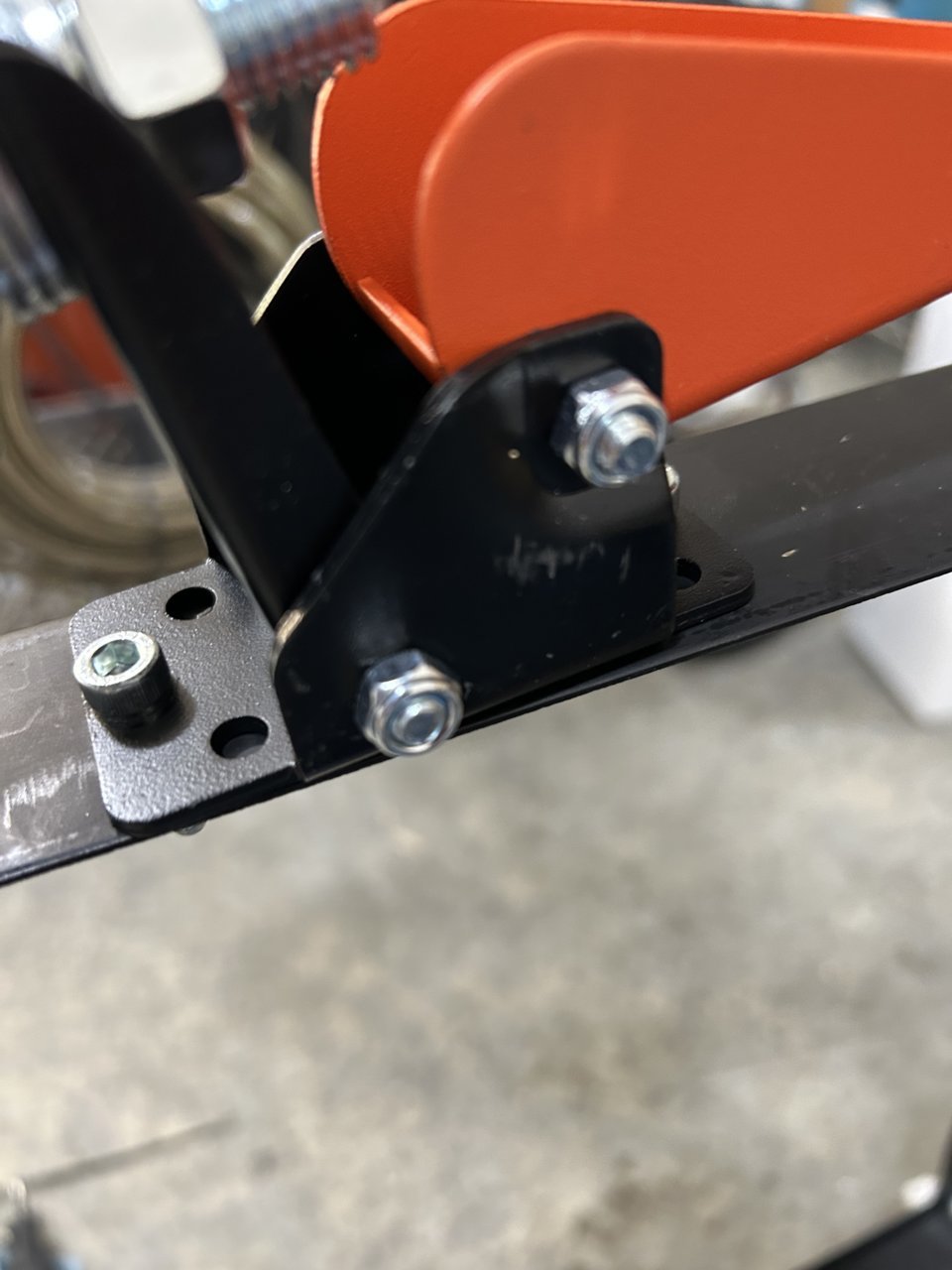

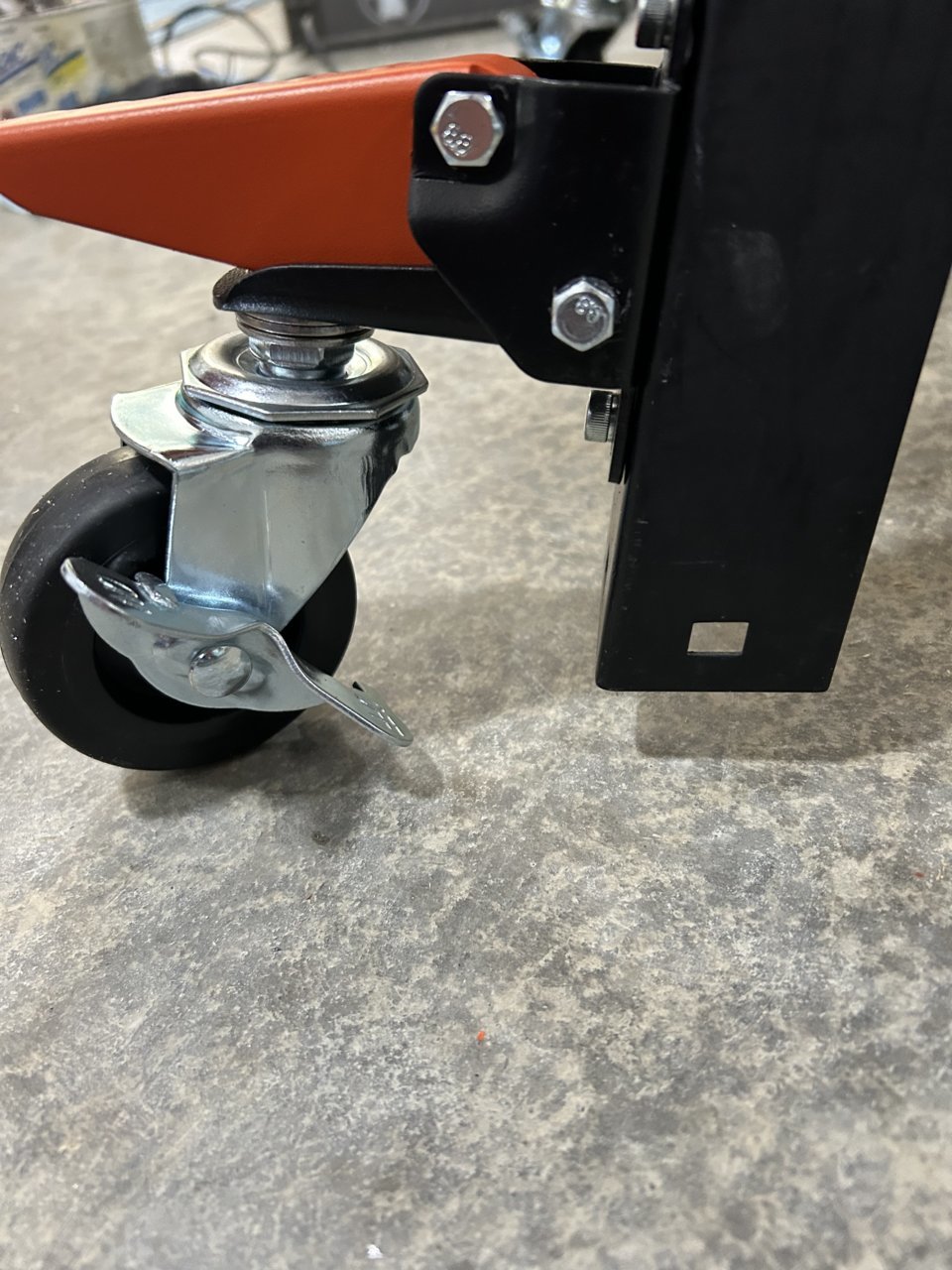

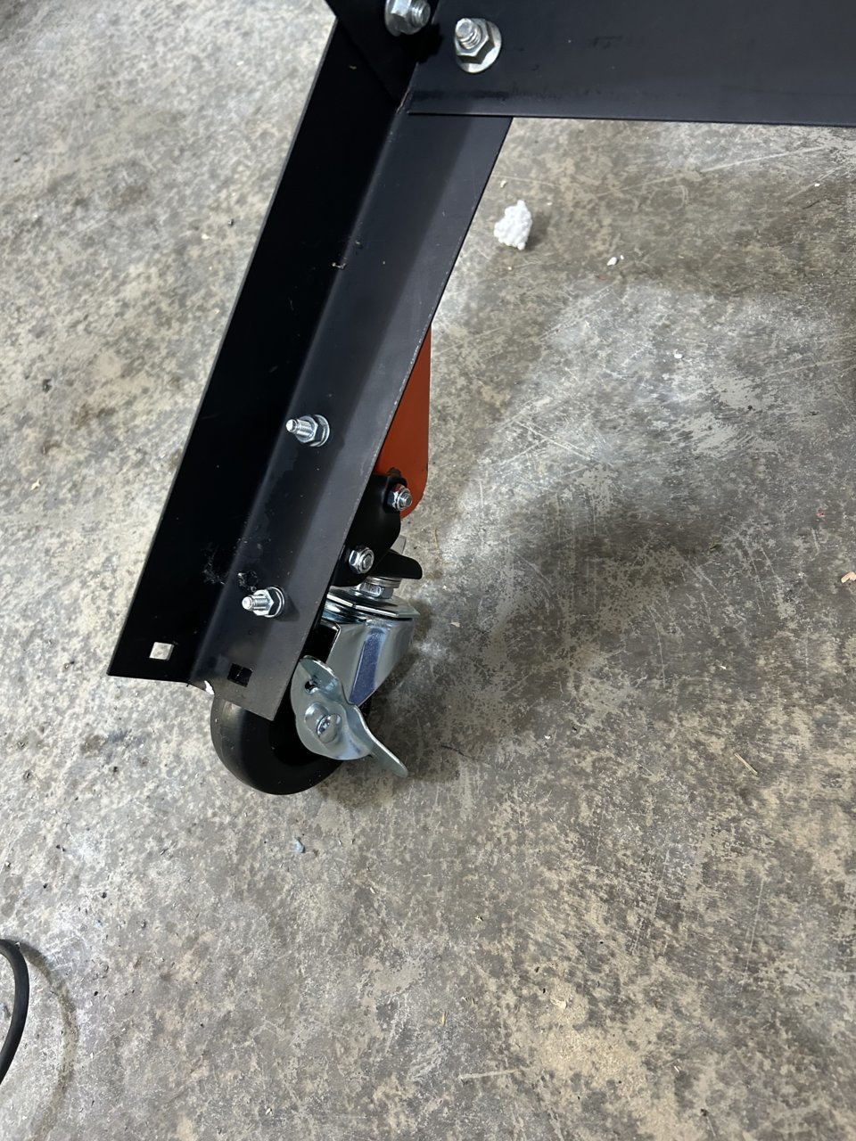

    IMG_5180.jpg IMG_5182.jpg IMG_5183.jpg IMG_5184.jpg IMG_5185.jpg IMG_5188.jpg Prepping for my colonoscopy so have to run from my shop frequently…..not much getting done on the breezeway gates. I did customize and add some jacking casters to the (now) router stand

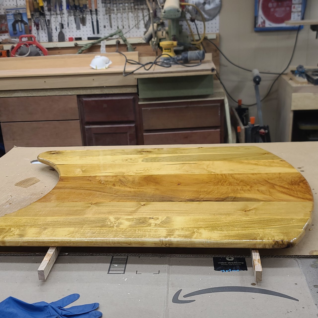

    Haven't had much time in the shop. But the top finish is dry enough to flip it and do one more coat on the bottom.

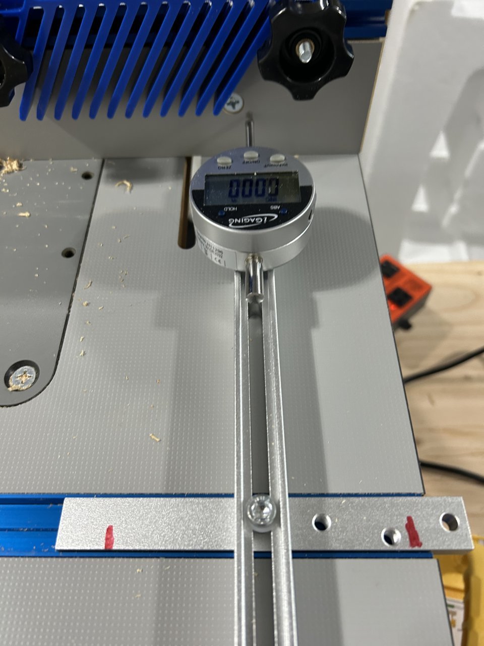

    Like this:
    For dado location is critical so set that and triple check. Then get everything else set, check position then align fence:
    Then check position again
    There was a little hilarity. After wondering why nothing was holding in place - I realized my fence face was not super tight. The fence was locked down but the fingie nuts in back weren’t tightened enough. Operator error
