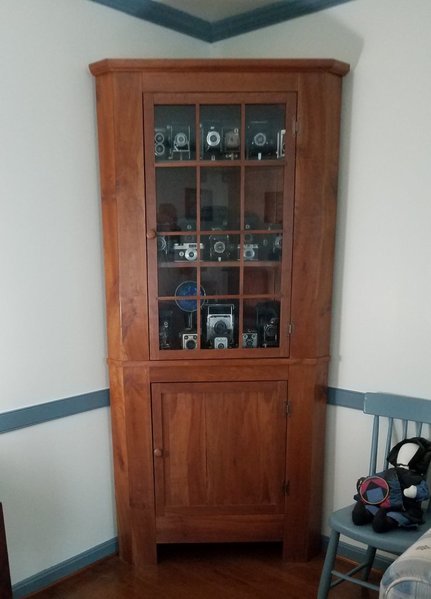

    Built this corner cupboard a few years ago to house my antique camera collection. The facade is made from a wild cherry tree I cut down myself.

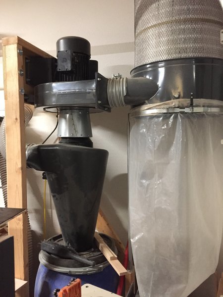

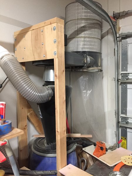

    I hooked mine up to a dust deputy, flipped the motor around and put a filter on it.

    This is the dust deputy that I used:
    https://www.oneida-air.com/inventor...&CatId={17F46883-40BB-471E-982F-E5F28583241B}
    It looks like they have a larger one now, that has a 6 inch opening, though I'm not sure the HF motor could handle that.
    The air filter I picked up here:
    https://wynnenv.com/woodworking-filters/
    I also ordered their 5" dust collector hose:
    https://wynnenv.com/products-page/woodworking_hose/
    I originally ordered 10' of hose, and just had a direct connection to my table saw, but have since split it to include the miter saw, and just use blast gates to control the air flow.
    The barrel on the bottom I bought of Craigslist from a local guy. Just look on your local list for a barrel that has the locking metal ring on the top. This is very helpful as it creates a nice seal and keeps the dust/wood chips from going everywhere.

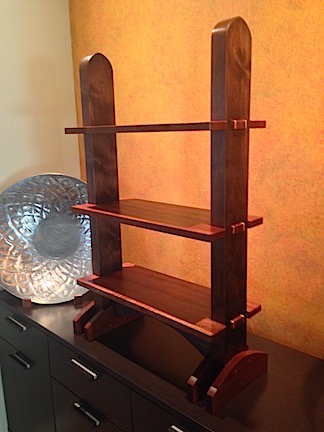

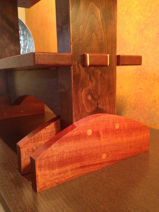

    Small bookshelf in walnut and sepele. Wedged through tenons and dowels.

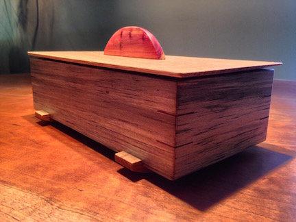

    Small box in beetle killed pine, white oak, and juniper.
