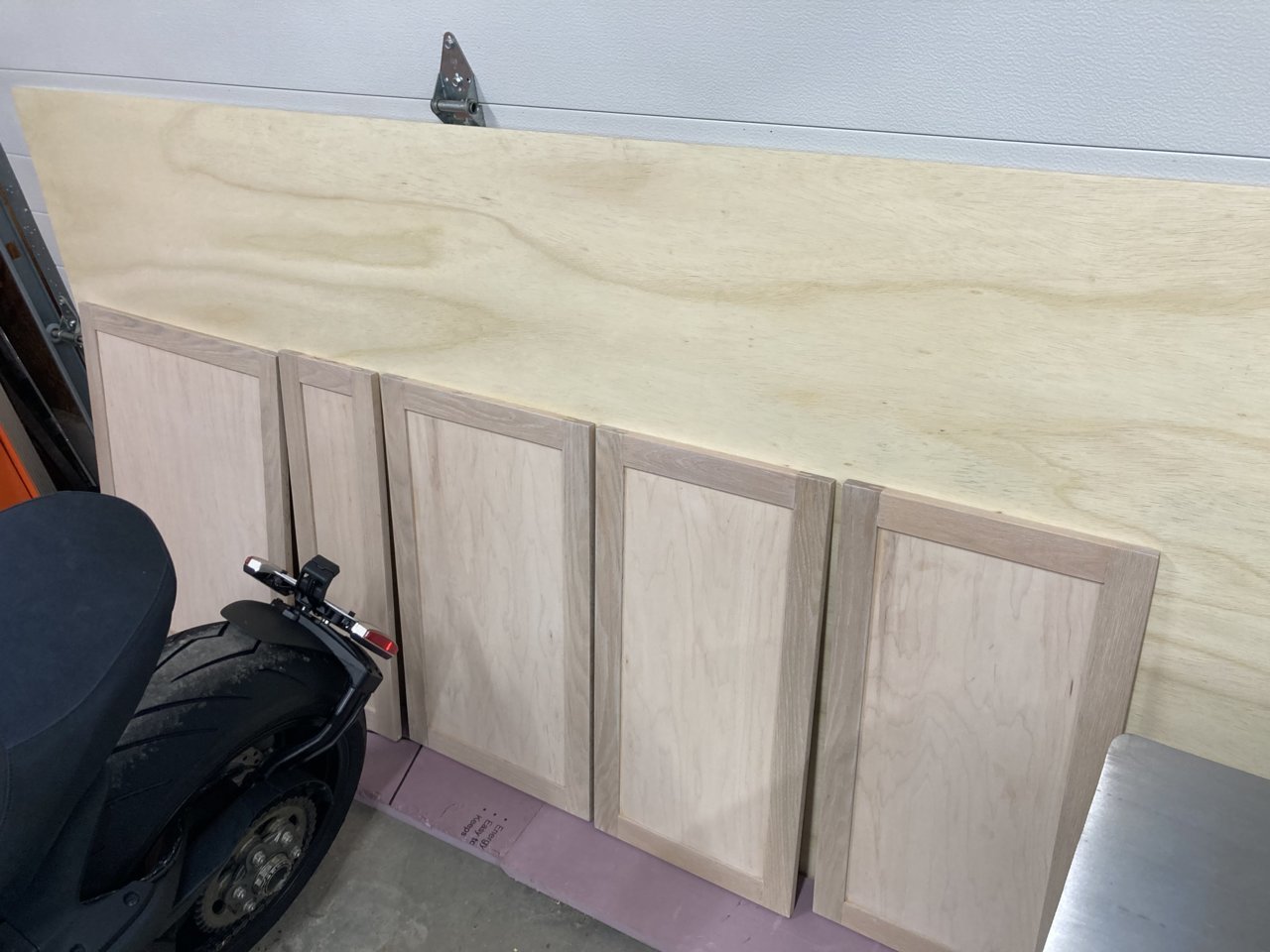

    Made some cabinet doors and just tried some of that basic-bitch white wash stain stuff. Its different I guess, will see how they look mounted.
