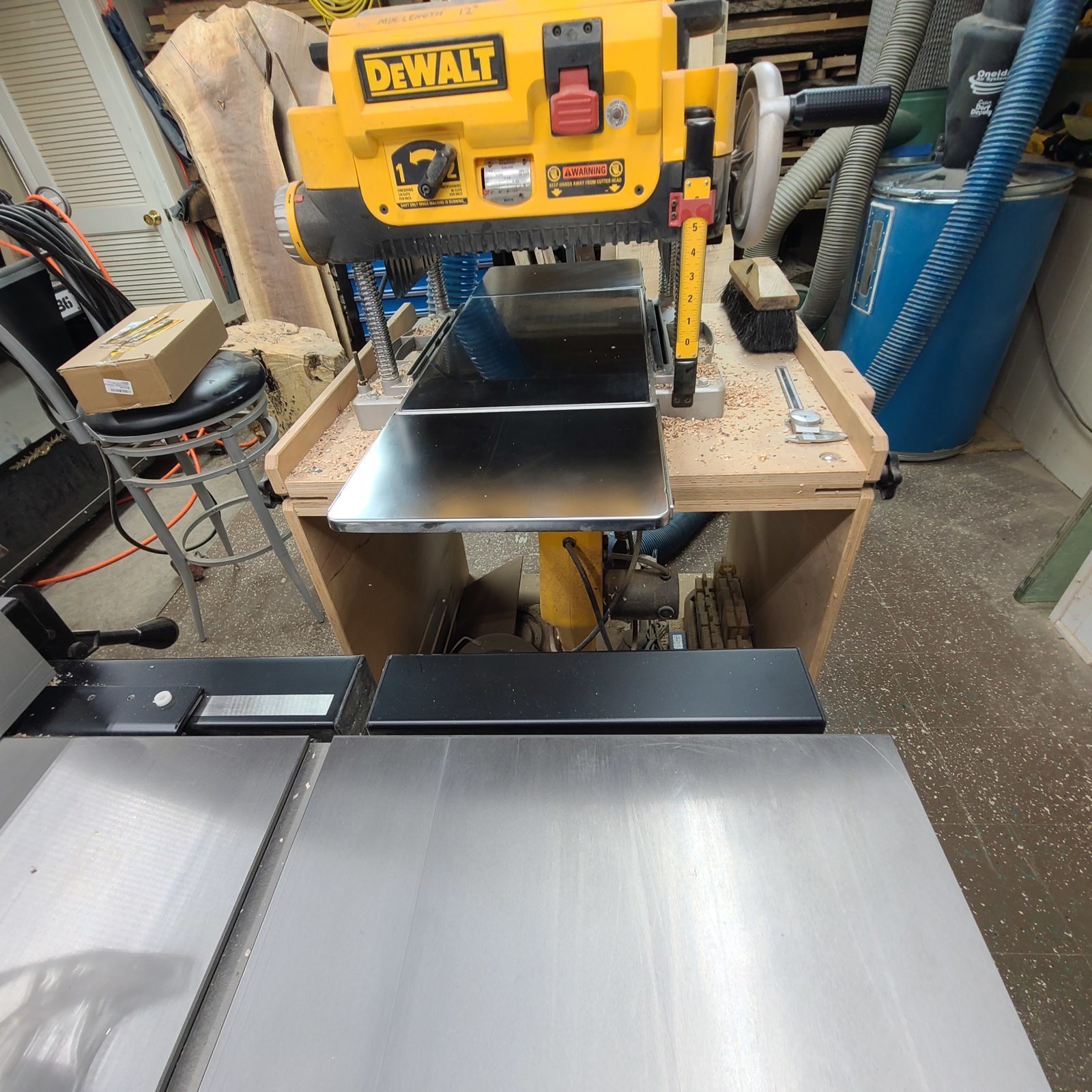

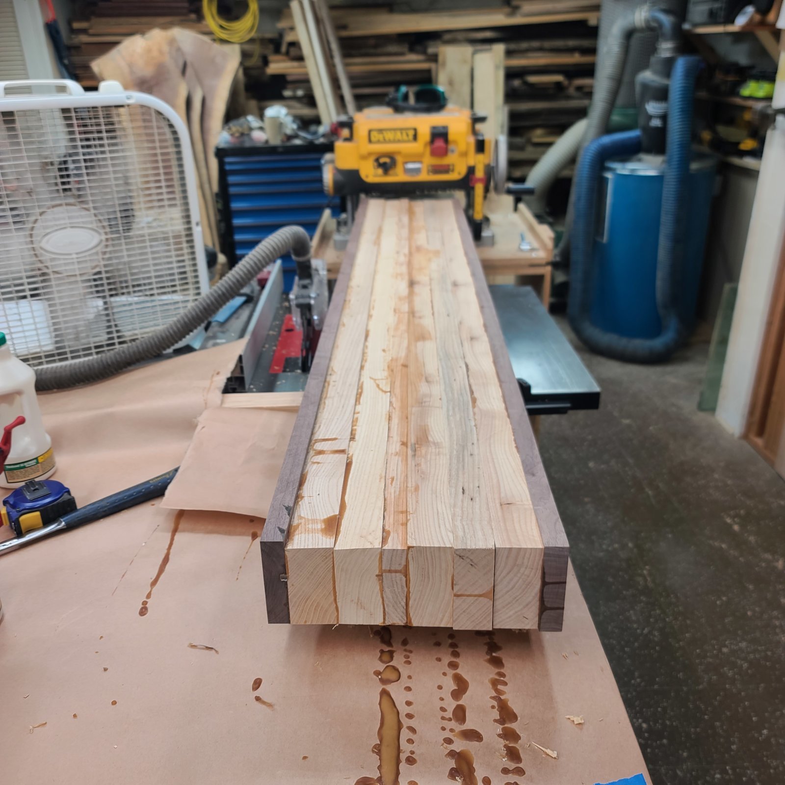

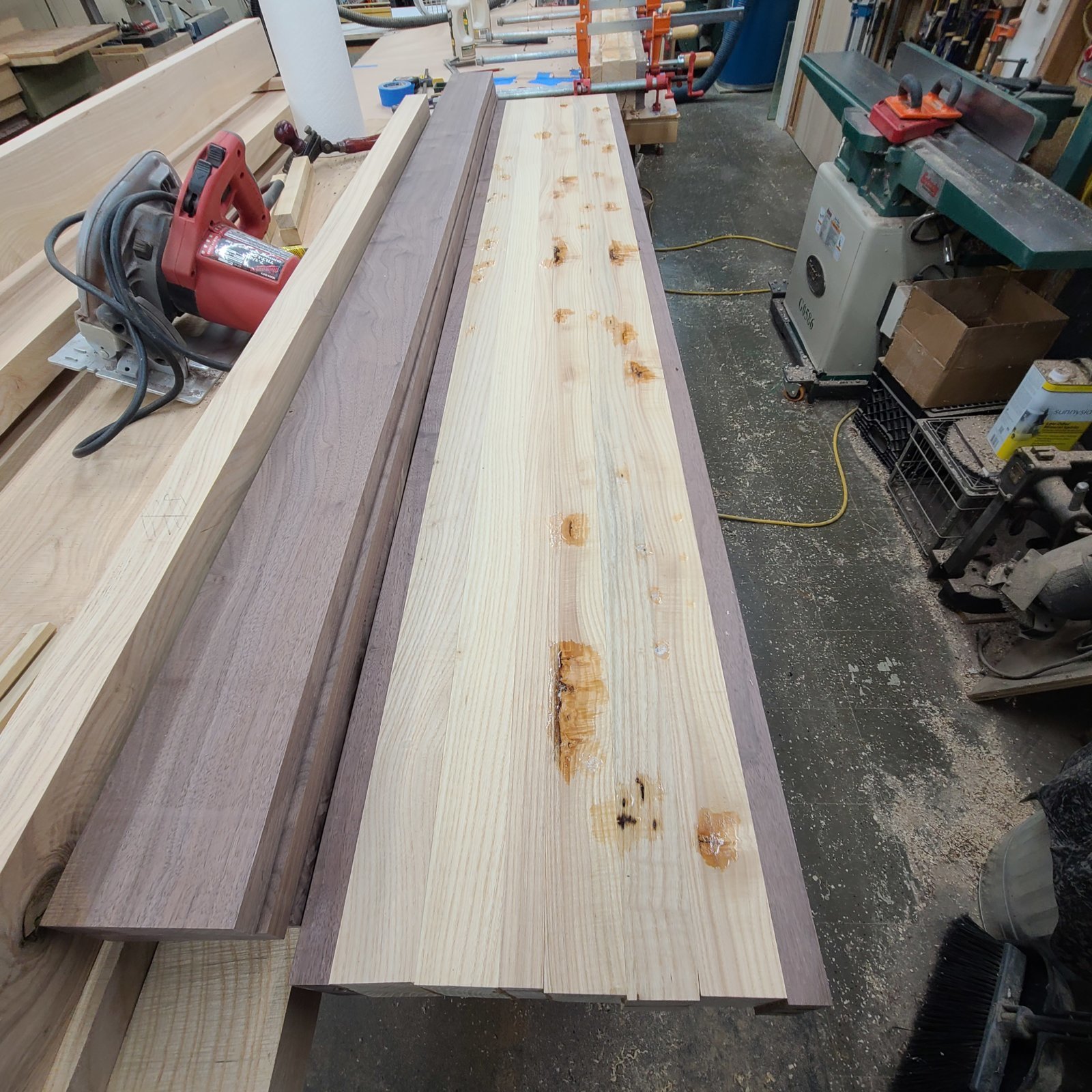

    Today's after work progress. I ran the first completed section through the planer. First time the mighty dewalt 735 ever struggled. But it was pulling a massive 12" heavy hardwood beam and cutting at the same time, lol. Actually impressive for a benchtop planer.20231020_191534.jpg
    It cleaned up really nice. I was shooting for 3 5/8" but it cleaned up at 3 1/2" close enough.
    Then I treated some imperfections with ca, I'll scrape that down tomorrow.
    Another section is in the clamps, 2 more to go.
    Last thing I did in the shop today was to wax the bed and tables on the planer, it might help with the feed of the heavy top sections.

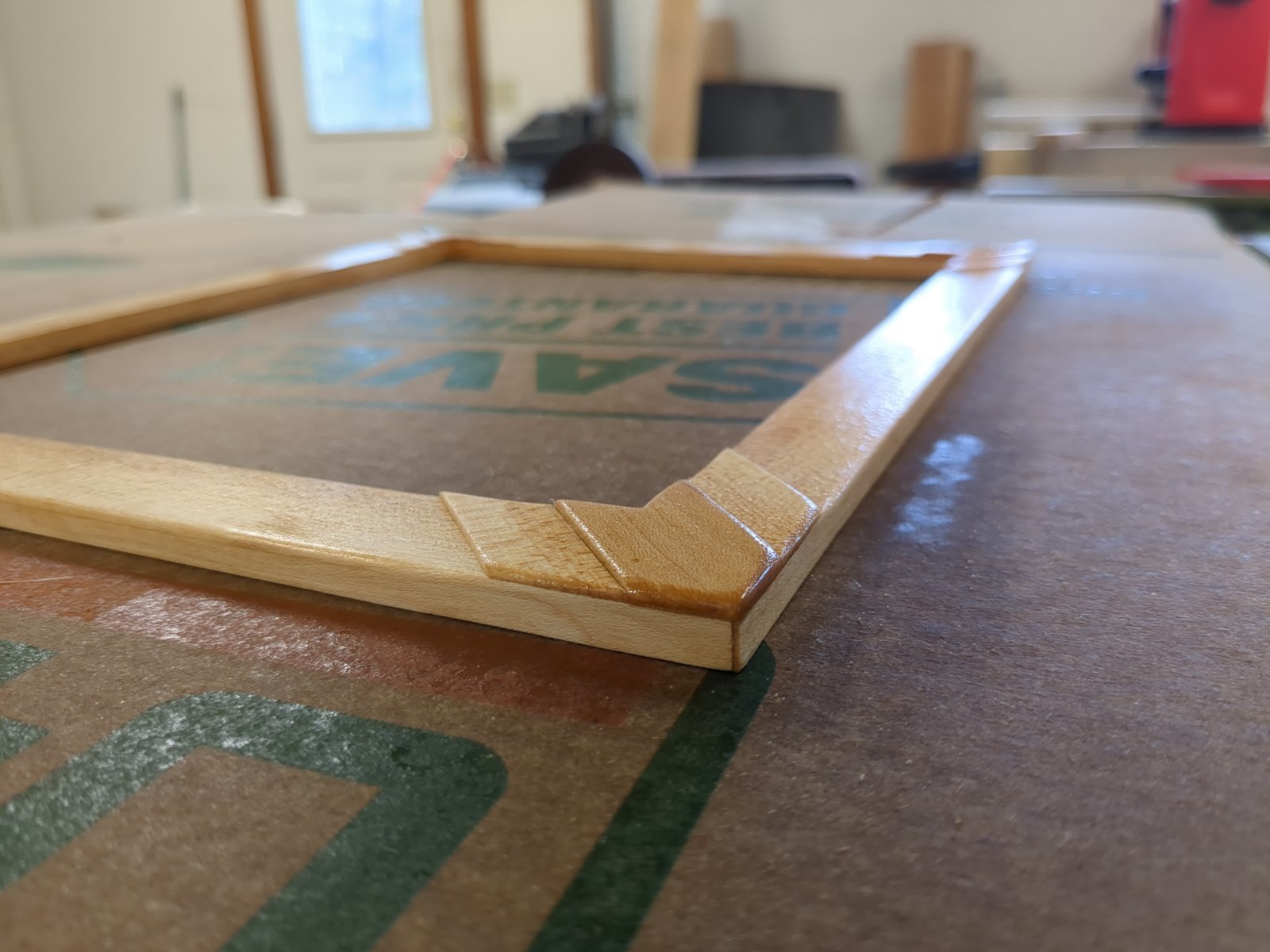

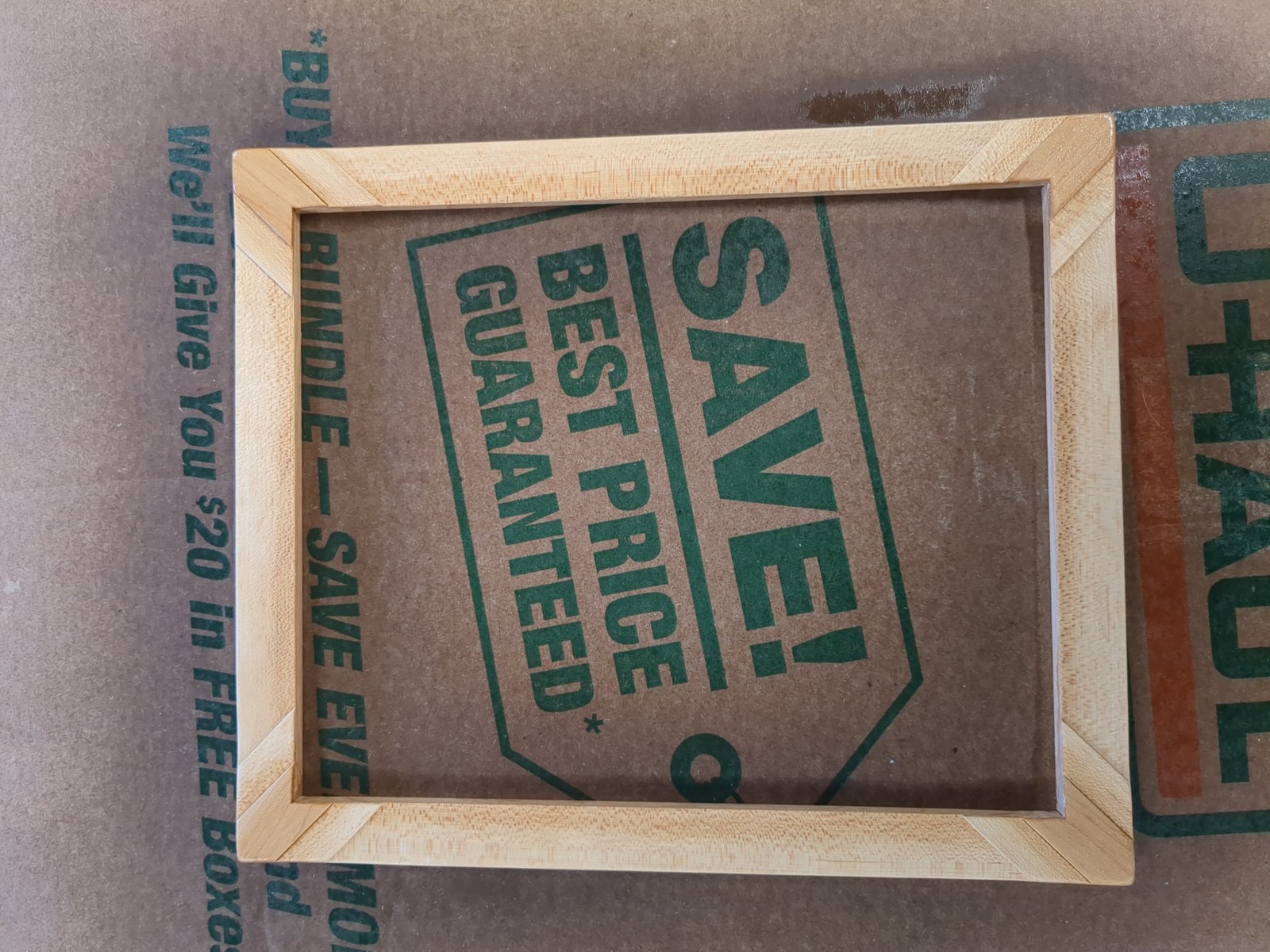

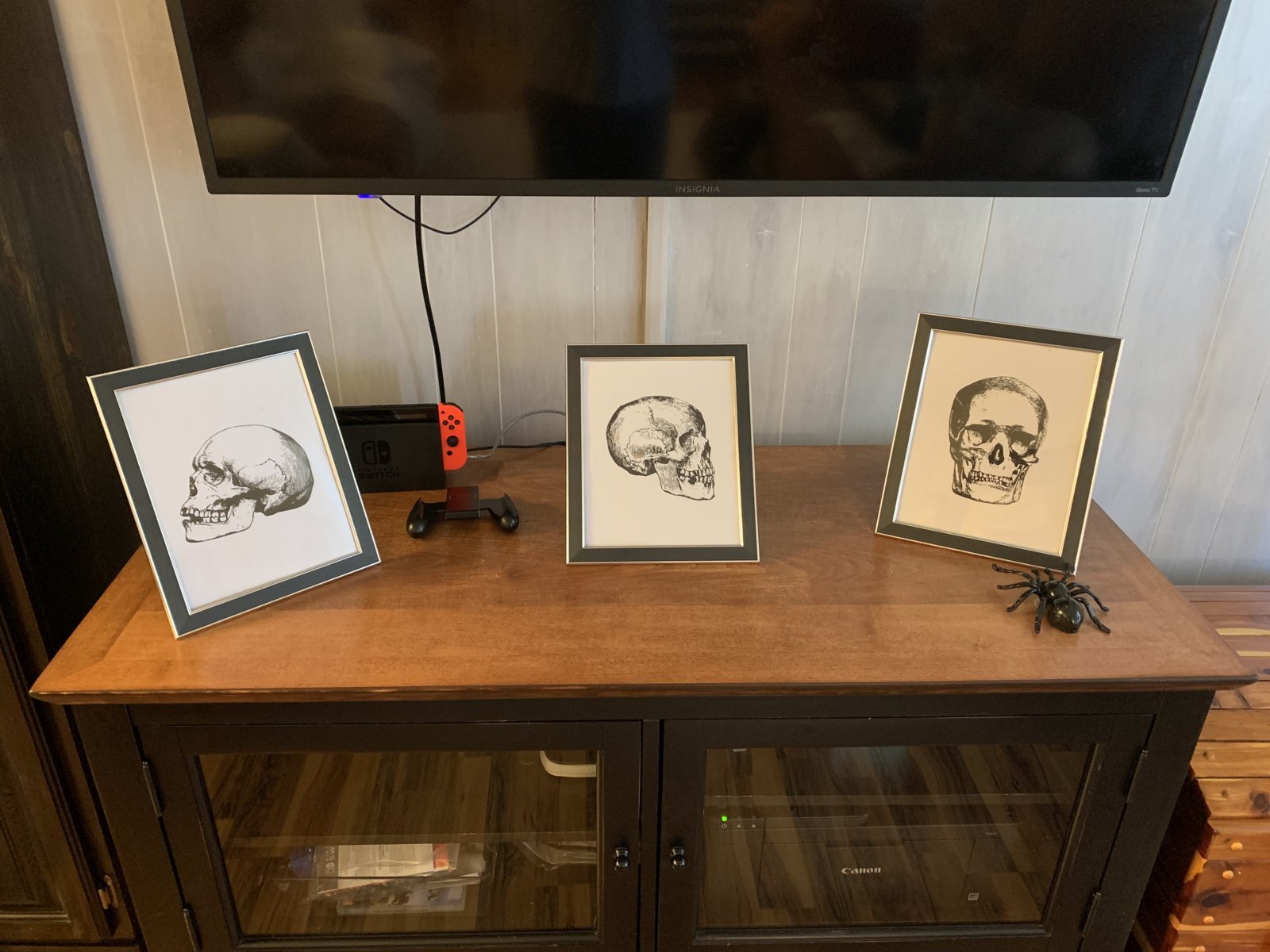

    Fuckin around in the scrap bin. I like the concept, probably next batch of frames will make a few with a bit more complicated arrangement.

    I like it. Simple is good. You want to make sure that the frame compliments what is framed. If the frame is more attractive then what is framed then that is a problem.

    I think your 5-year-old would think that even that frame does not outside their artwork.

    Yeah, these are all part of larger pieces. I'll post up photos of the batch when they're done, I need to get glass cut for them.

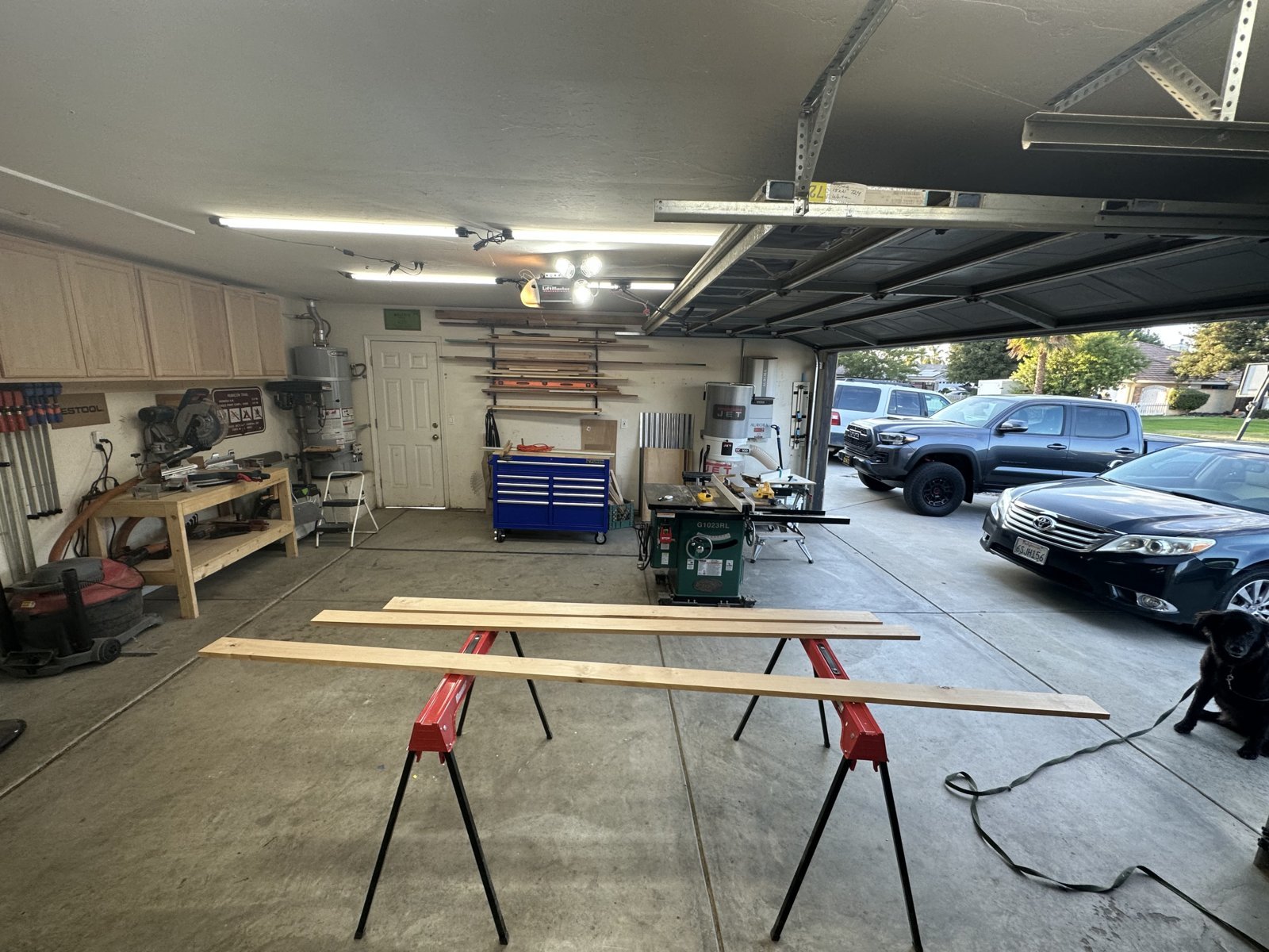

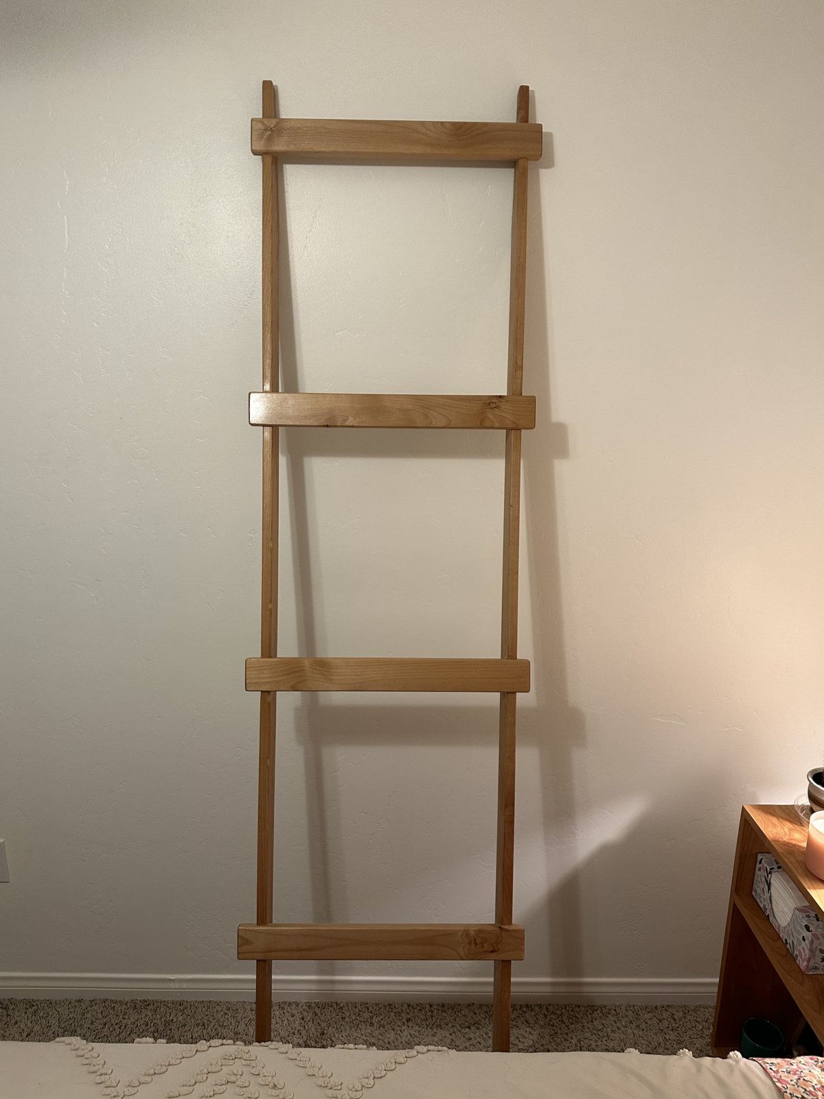

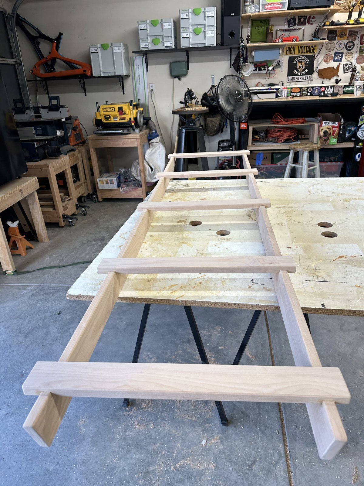

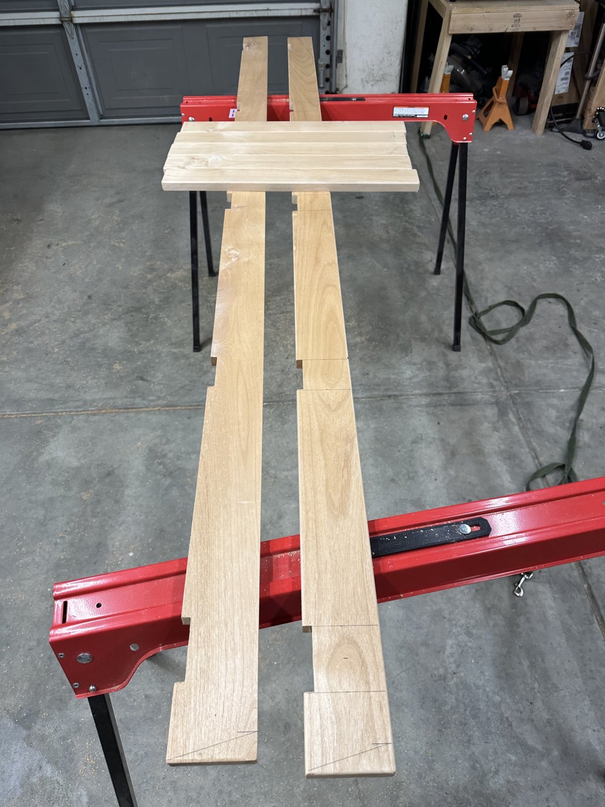

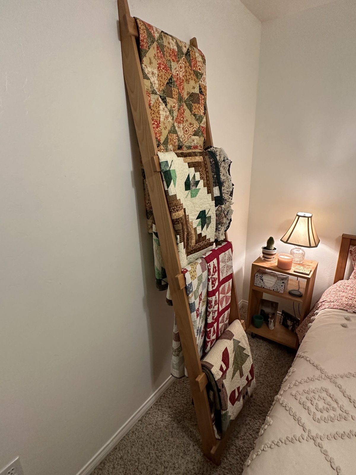

    Quilt Display / Ladder for my wife. She is going to display my late mother in laws hand made quilts on it.
    Parts cut out.
    Glued up!
    Waiting for finish.
    Feels good to make some sawdust again!!

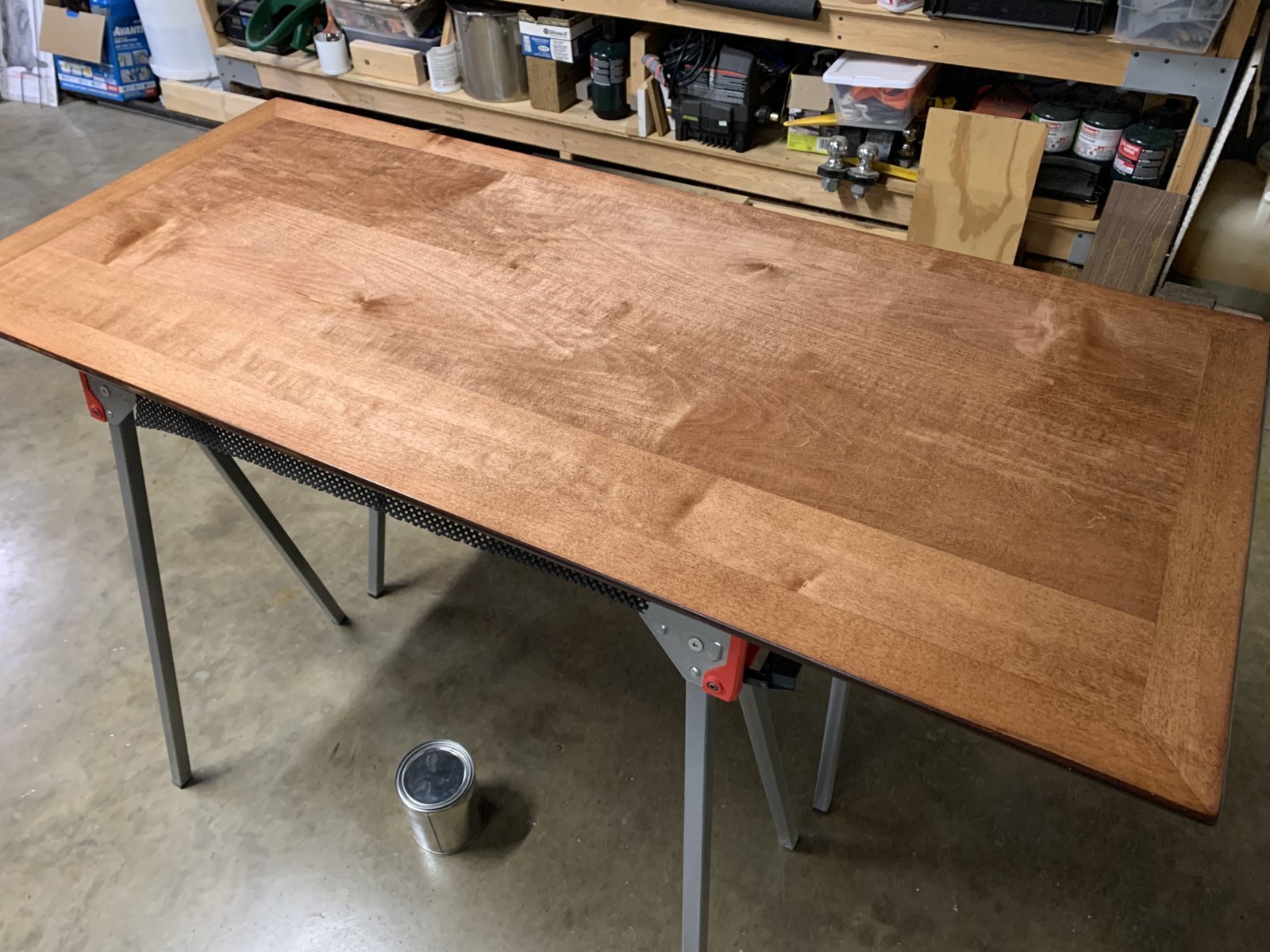

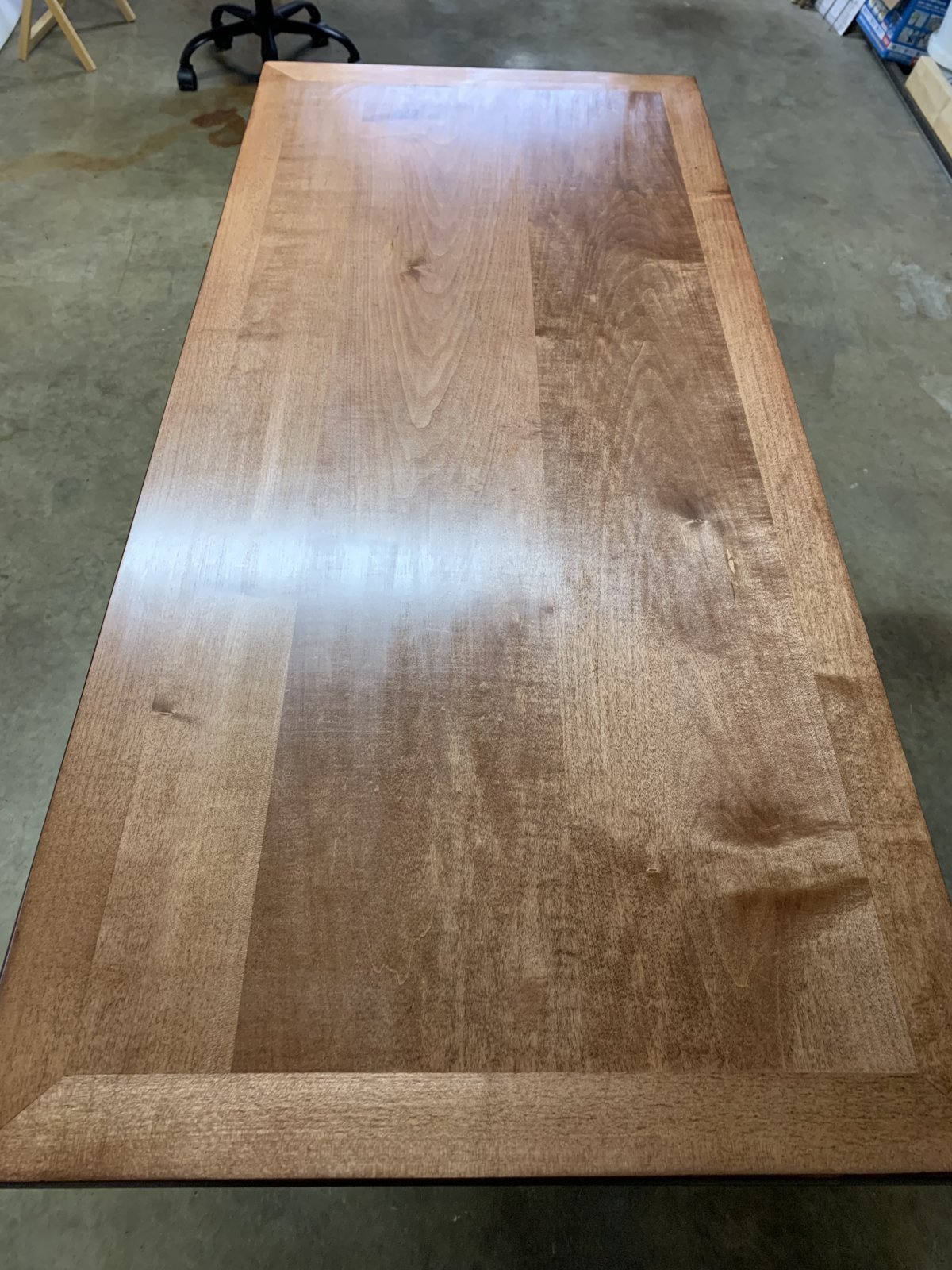

    I need to throw out this can of wipe on polyurethane, I just do not like the finish. This was the fourth coat.

    If you want a wipe on one step, I've had very good results, particularly on furniture, from Watco Danish Oil. It's very forgiving and also easy to repair.

    The finish is drying on the quilt ladder. I will post pics when it is complete.

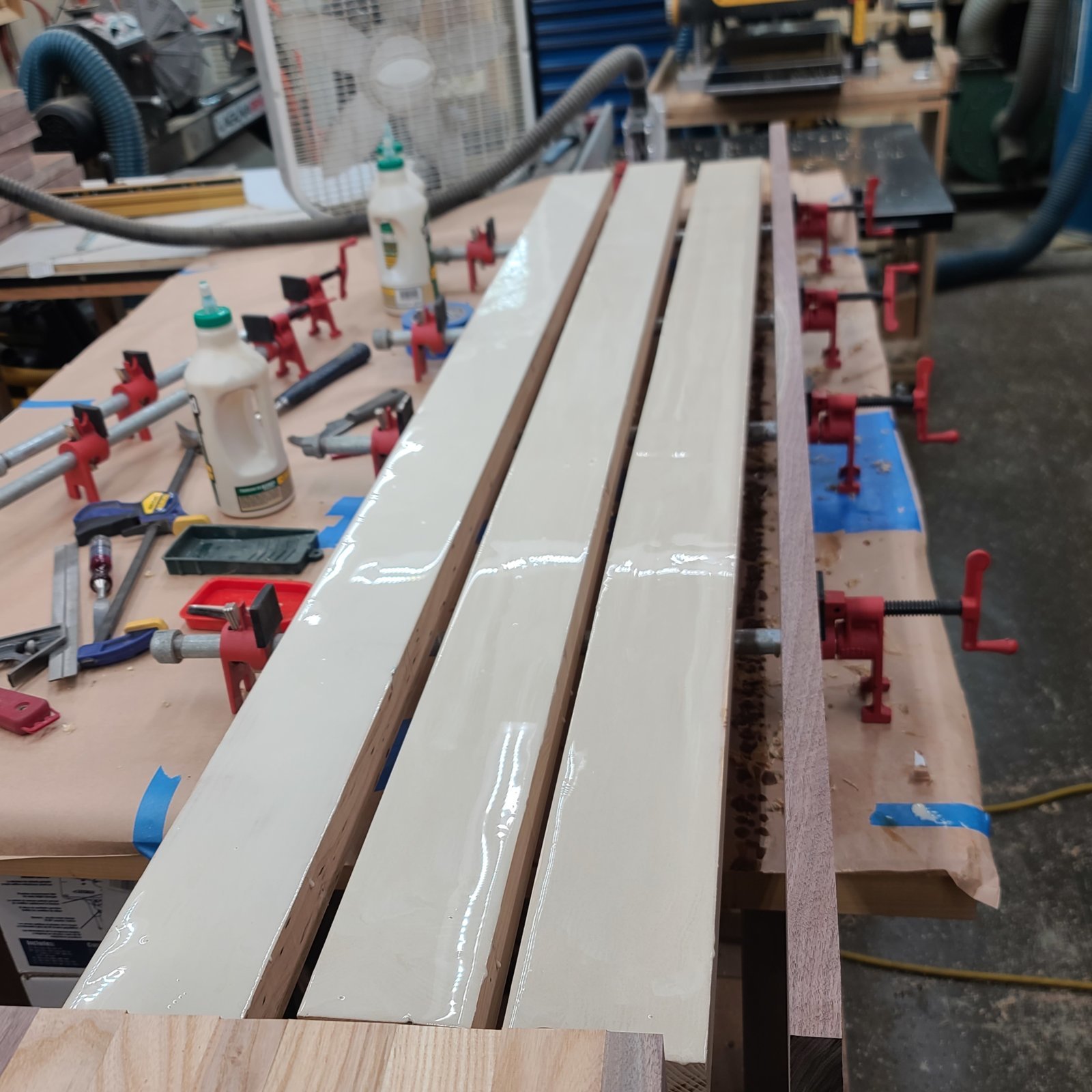

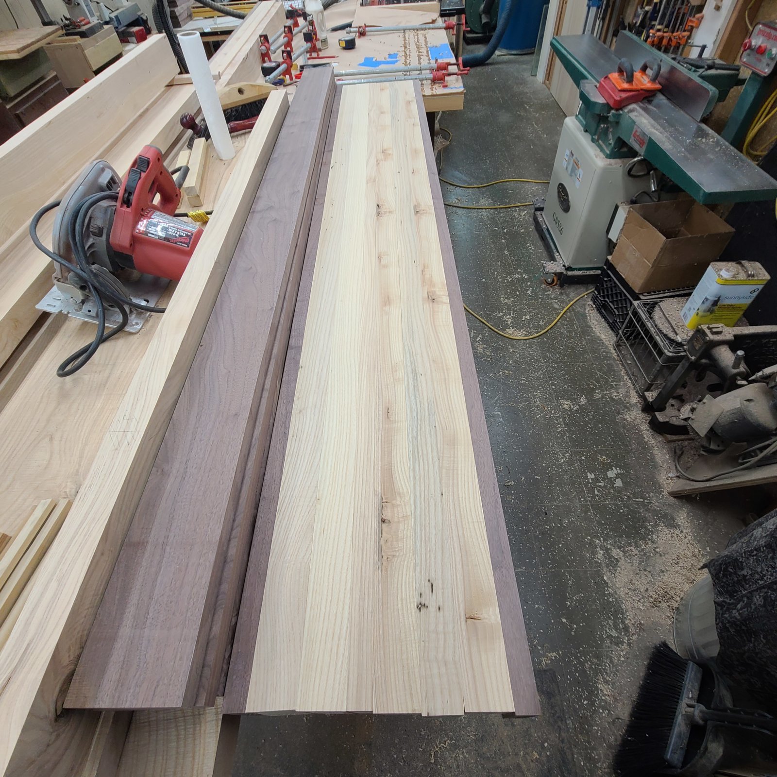

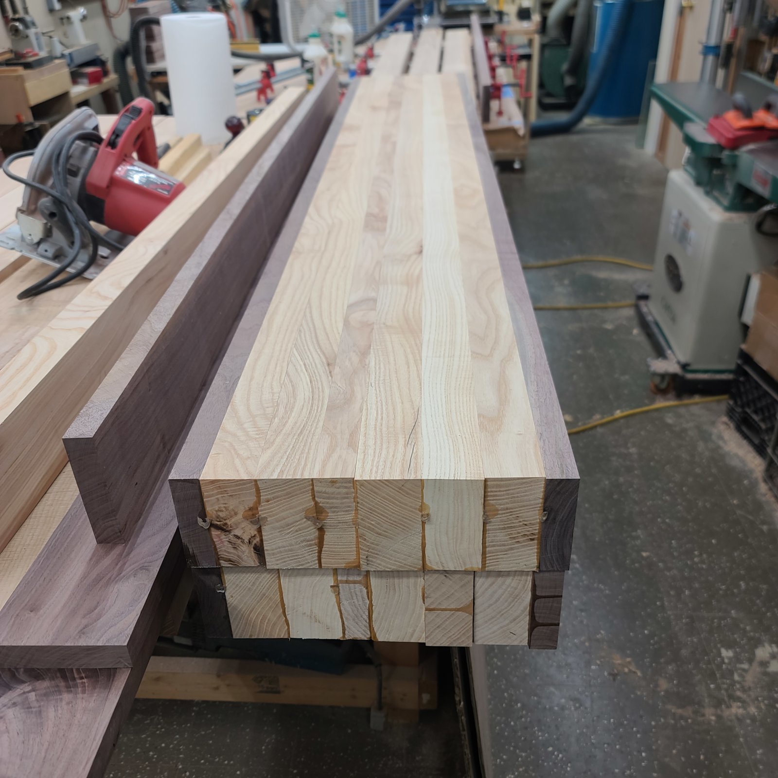

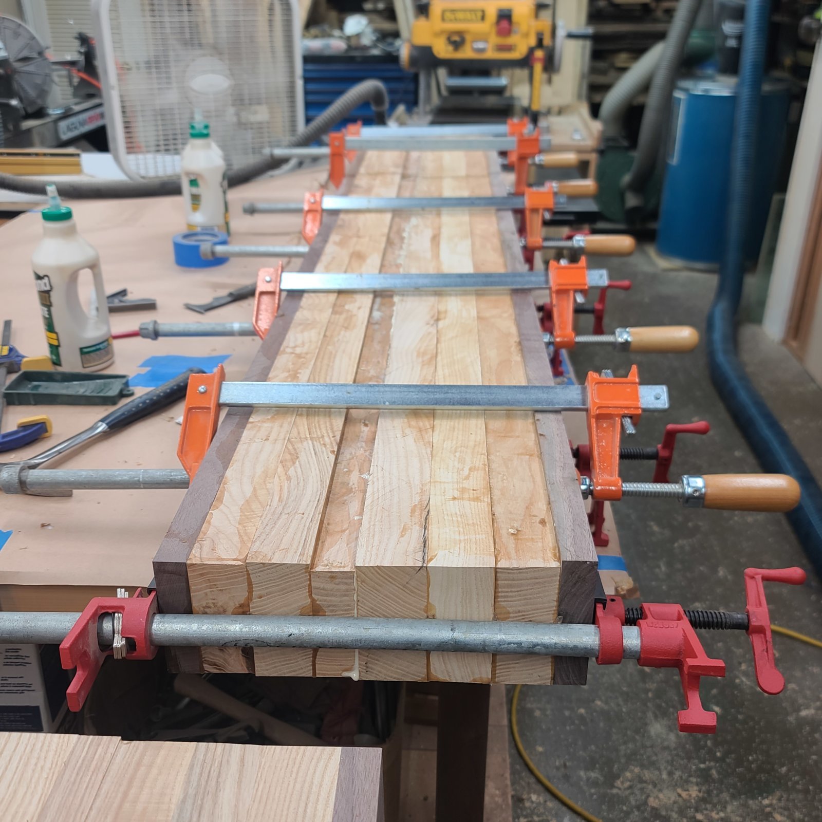

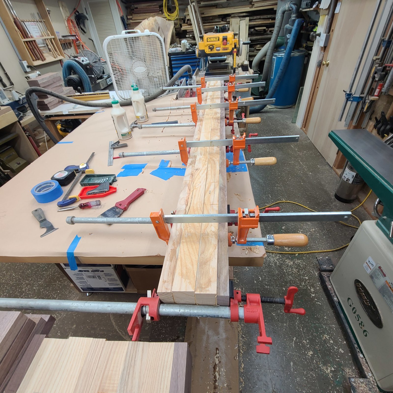

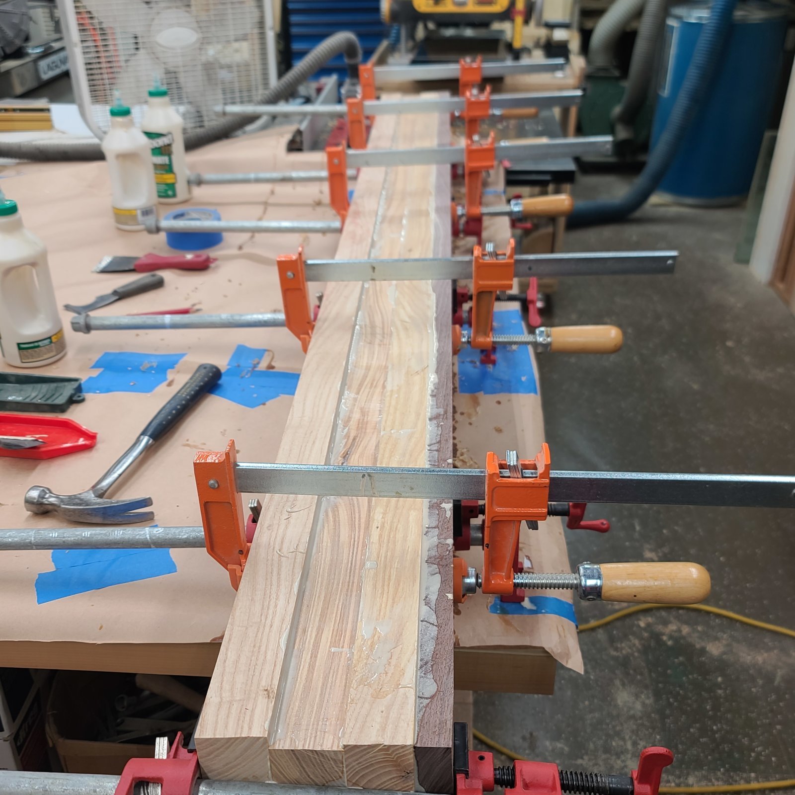

    I know this is probably getting pretty boring and monotonous but it does show the process.
    So I took the clamps off the 2nd section and ran it through the planer. If you wanna get a workout move one of these sections around, lol.
    2 done and 1 to go.
    Setting up for another glue up.
    Glue spread. I Iet it sit for a few minutes to kinda soak into the ash pores and get tacky.
    Clamped.
    I more section like this, and then glue those 2 together. Then I can move on to the legs and base.

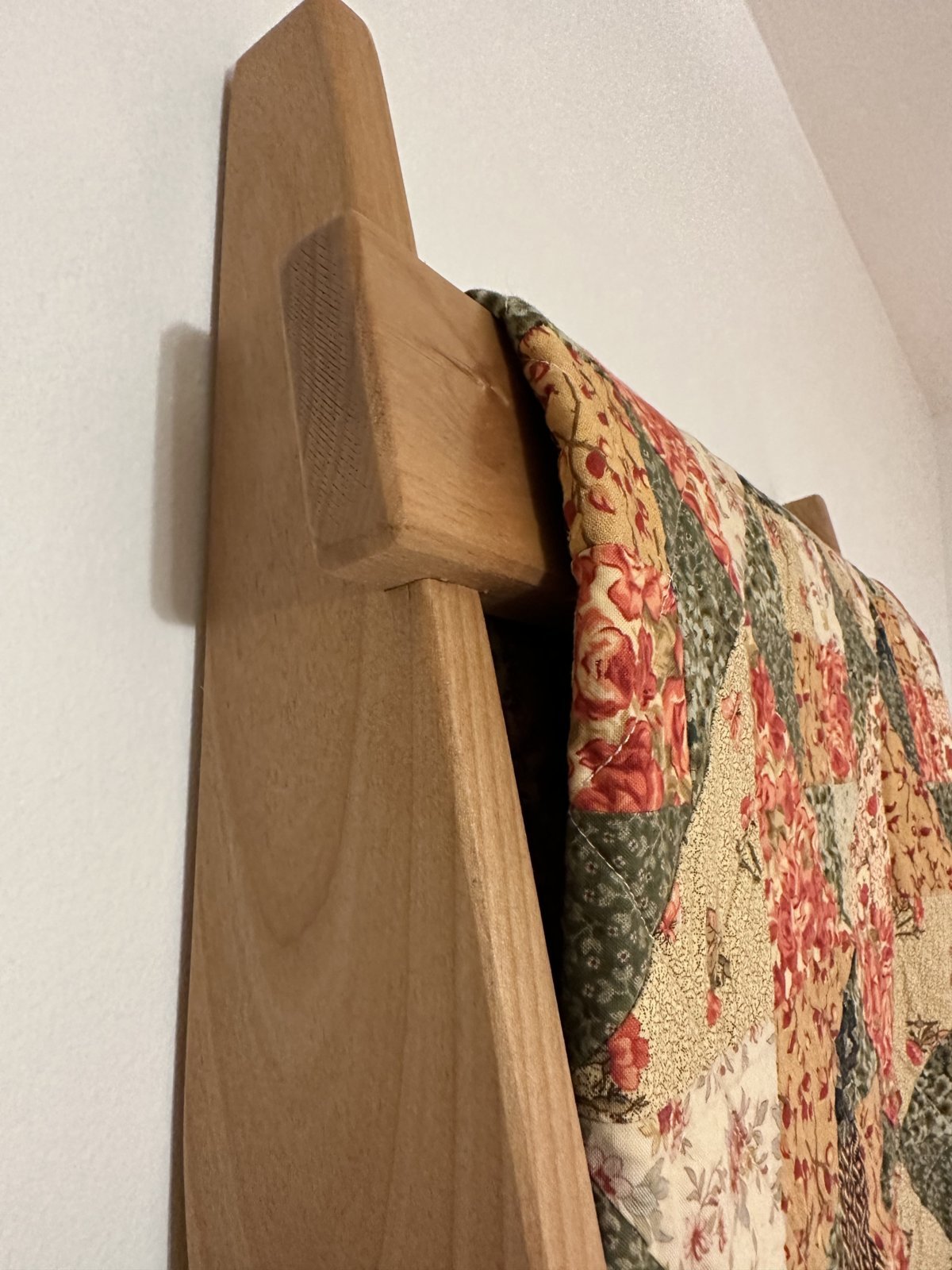

    Done! Nice quick project. Wife is thrilled.
    26DA0EDC-CCE2-4D9F-9F97-EC6770046294.jpg 14A53934-ADA7-4A41-8887-97D6AEA18D1D.jpg AE8916BB-E801-4AAD-8A52-8A165B5B9DC2.jpg
