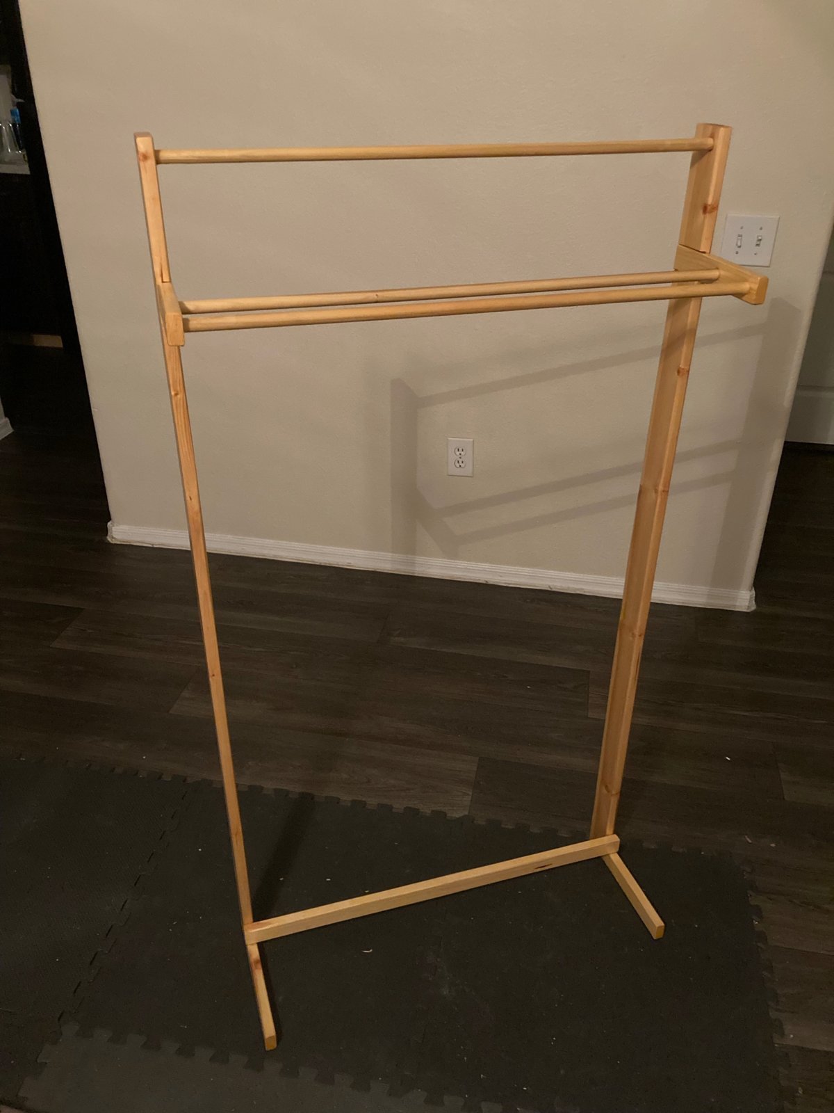

    Blowing my own horn a little, but ... if you find the towel racks in the bathroom too narrow, this is full-wide and has 3 places (two full-size and 2 hand-towels). Can freestand or you can remove the legs and add a couple of back slats and attach directly to the wall with small wall-anchors. Overlap-joints keep the sides flat.

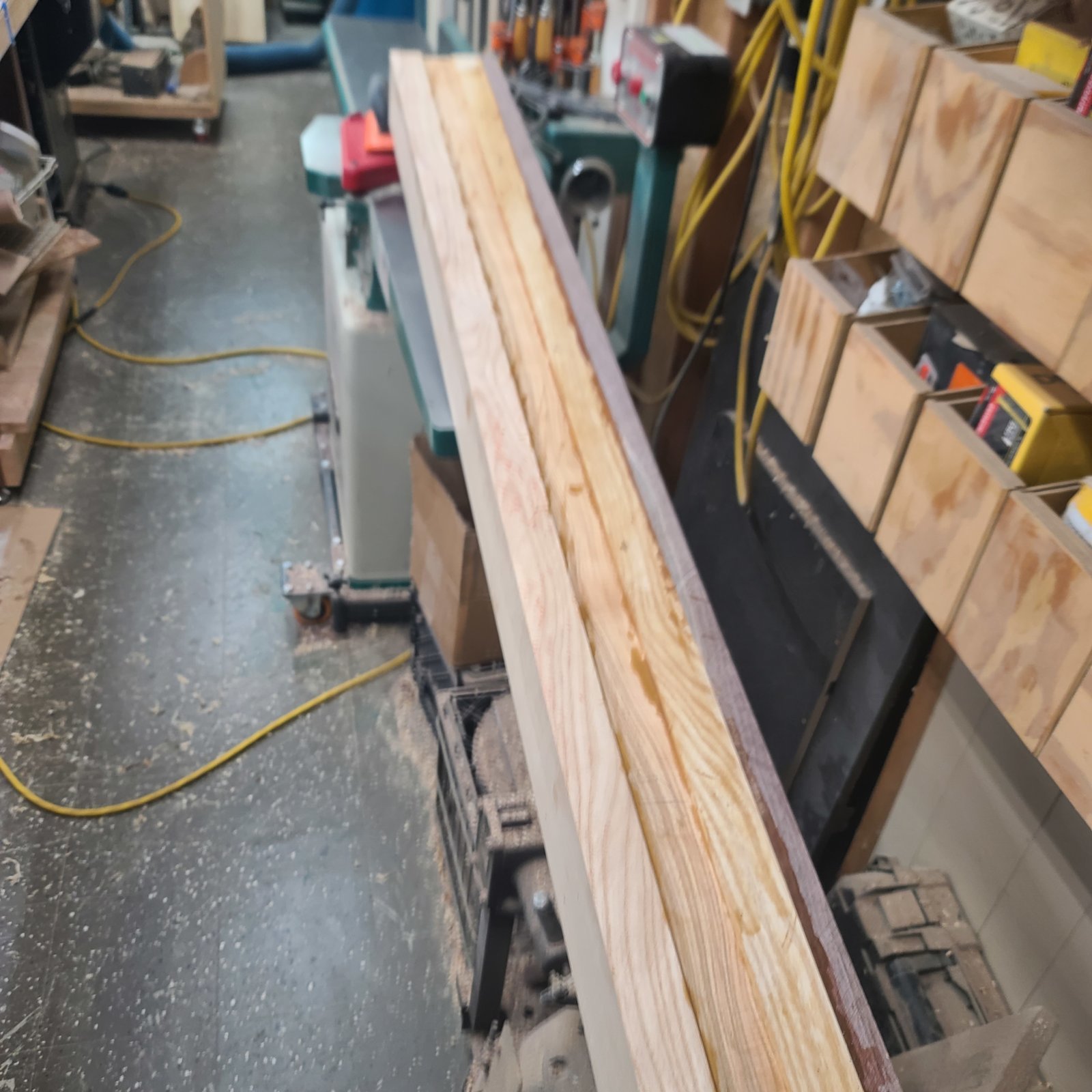

    Worked late today but came home and got yesterday's glue up out of the clamps and scraped.
    Ready to joint the bottom flat again. This is the top in the pic.
    My Betty is already in bed so I try to be respectful and not run loud machines.
    This board needs to be ripped in half and planed to 7/8" to get the 12" width I'm shooting for on each section.
    Hmmmm, bandsaw isn't too loud.
    Man I suck at resawing, lol but ready for the planer tomorrow.
    Wish I had more time, working for a living sucks sometimes. But it pays the bills.

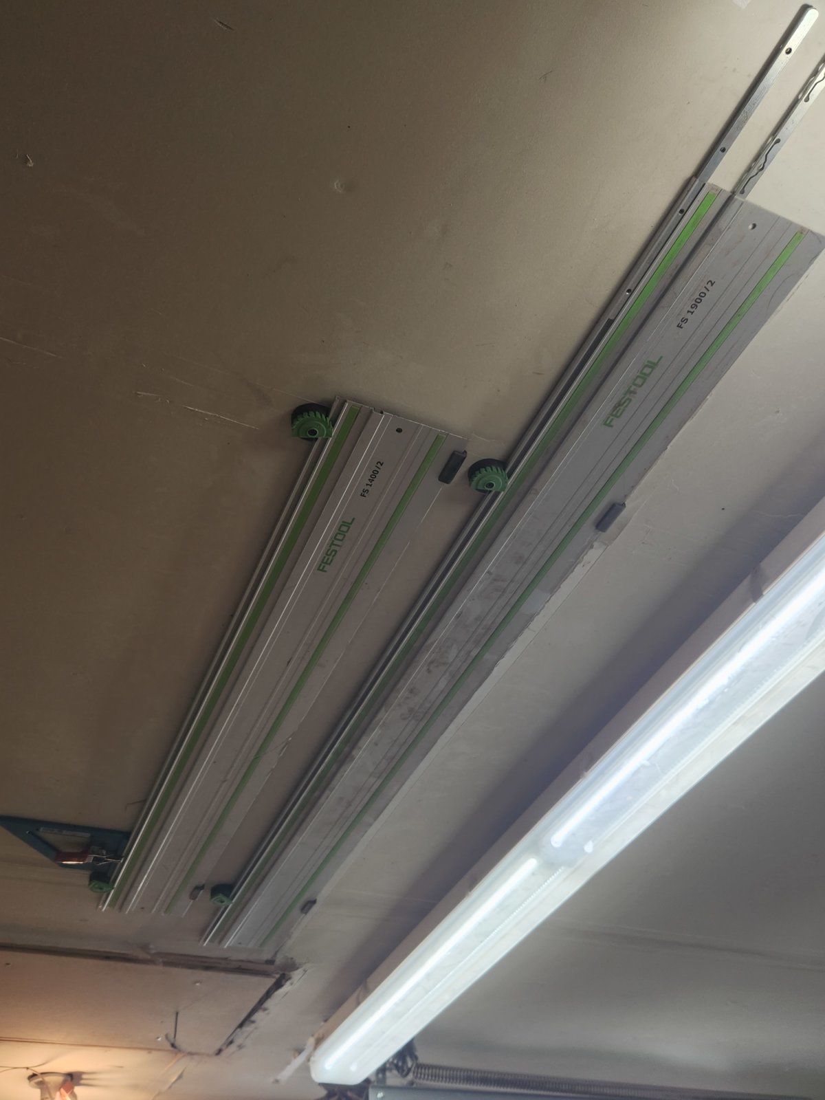

    I store mine on my shop ceiling. Take up zero floor space. I use the FastCap track holders. The work great.

    I use the fast cap too, I 3d printed mine :)

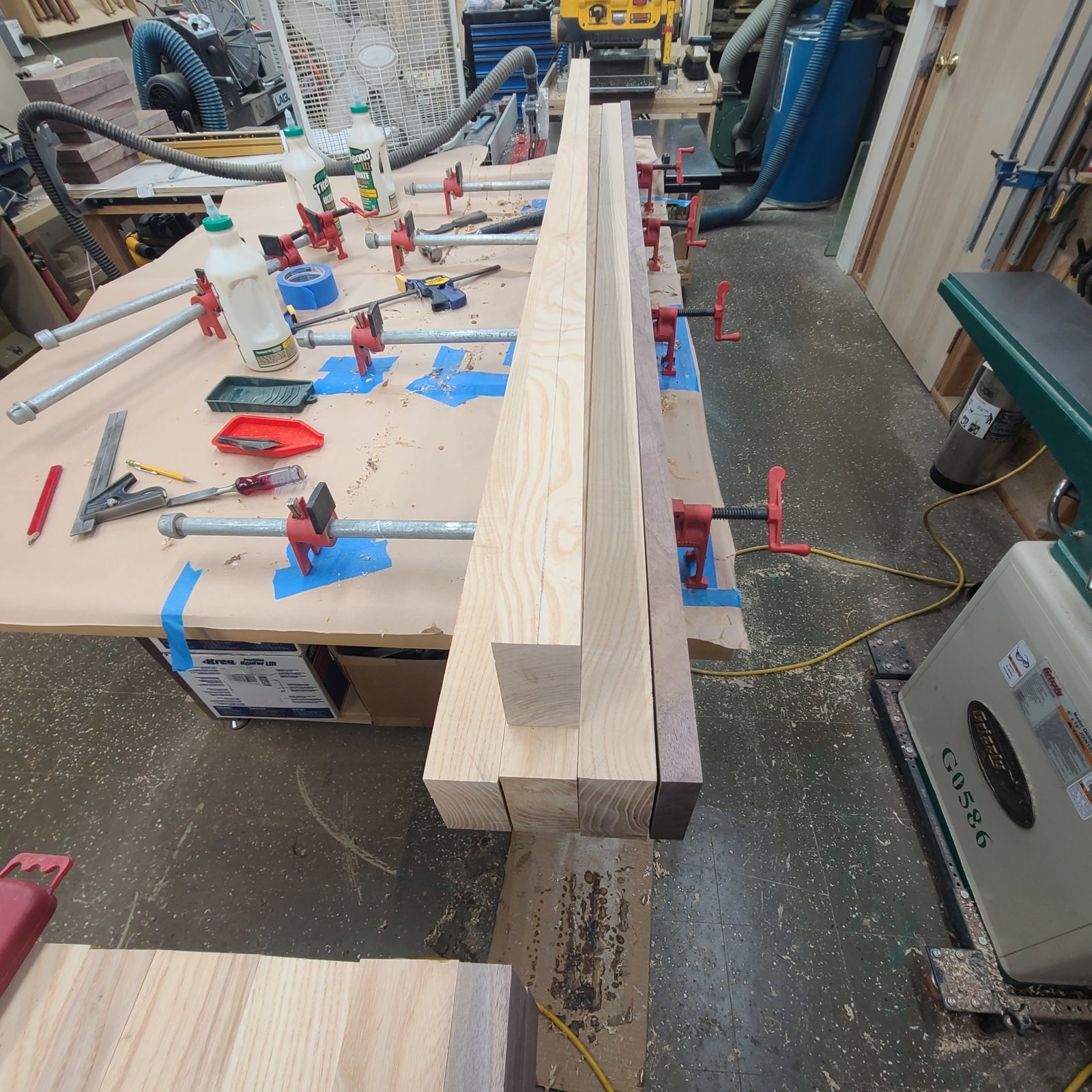

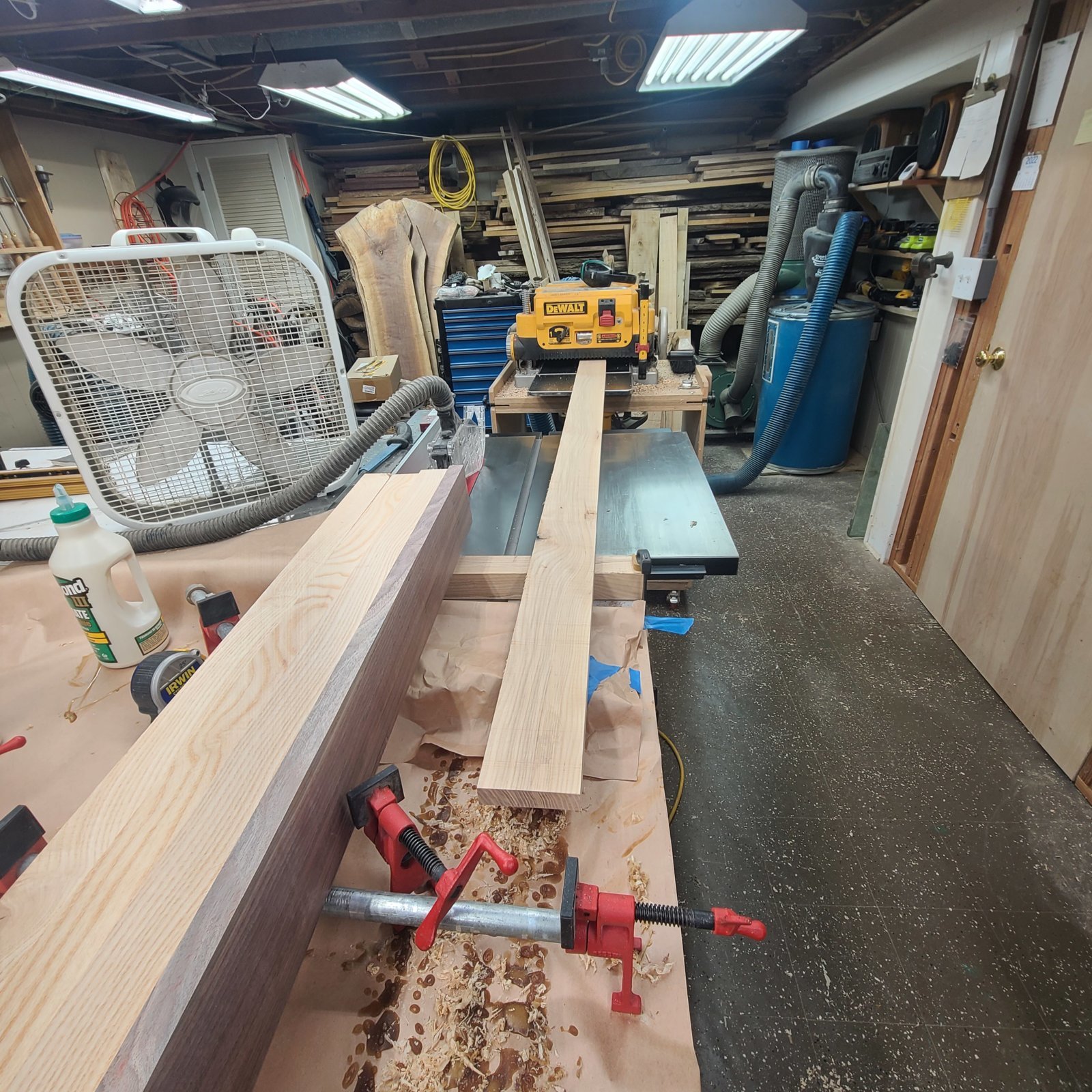

    After a 10 hour day at work I came straight home and went right down to the shop. I planed the last board I needed for the glue up before my Betty went to bed.
    And I'm out of glue! Amazon to the rescue, a gallon will be here tomorrow even if I have to work late.
    Next step will be glue the last 2 halves together to make the last section for the top. When that's cured I'll plane that down to thickness with the other 2 sections so they are all the same.

    You're just teasing me now. But I had to look up FastCap track holders . Looks like a good solution to a problem that I want to have...

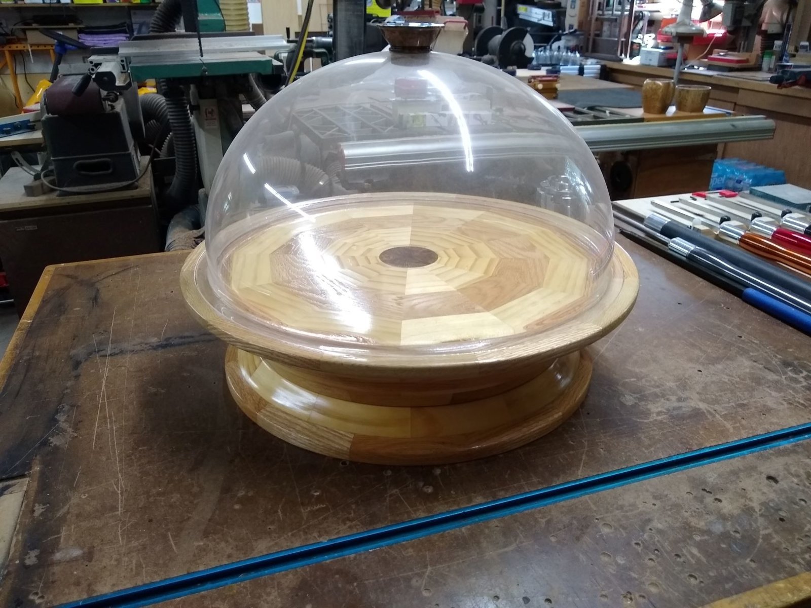

    i ordered 2 of these plexiglass domes for some other project and didn't end up using them, so decided to use up some leftover cutoffs from redoing the basements stairs, and some other stuff. i know, looks like a snow globe. cake_stand_11.jpg :D
