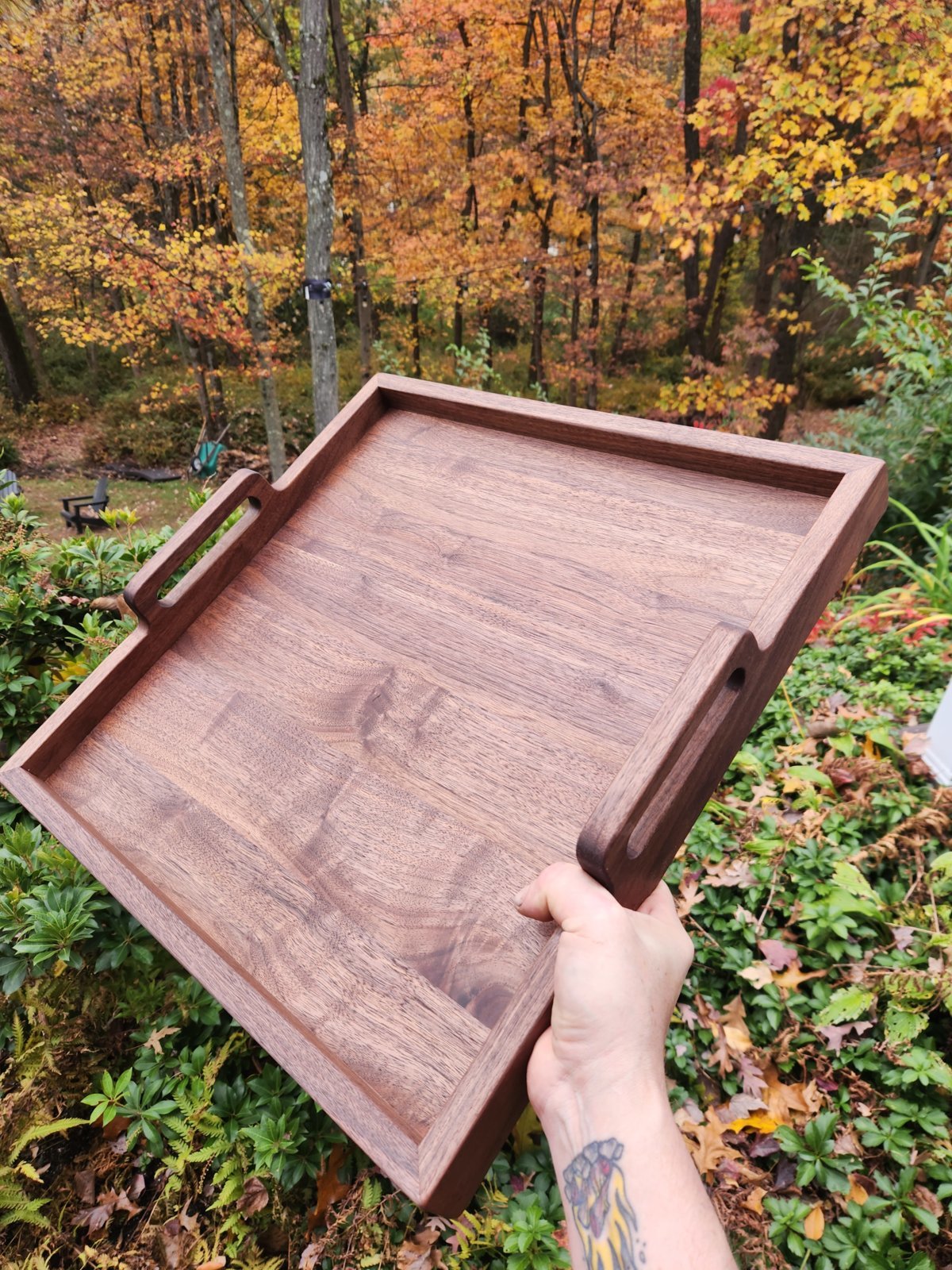

    Little walnut tray I just finished.
    I did use cauls for the glue up of this guy. It was 7 pieces of 3/4 thick wood. Even with parallel clamps it wanted to bow in the middle. It still came out with a slight bow, but the frame around the sides fixed that problem.

    Beautiful :thumbsup:

    Nice! I like smell of walnut but cherry is my favorite!

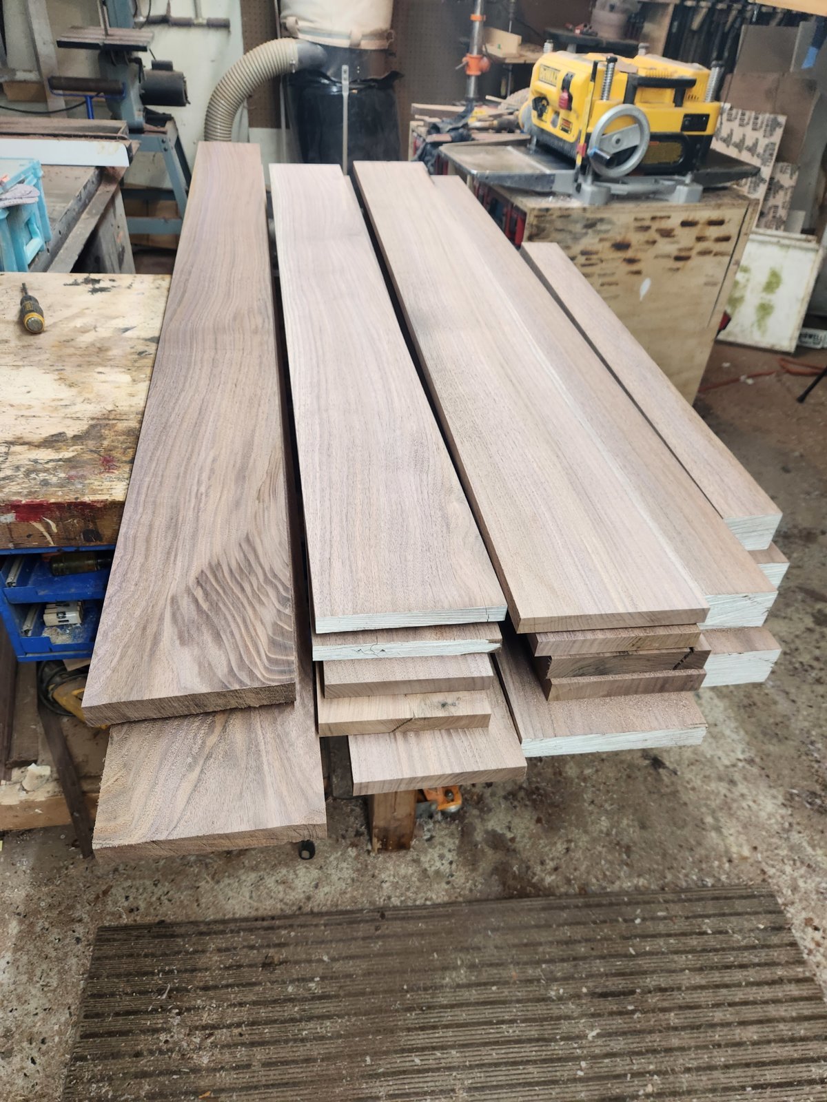

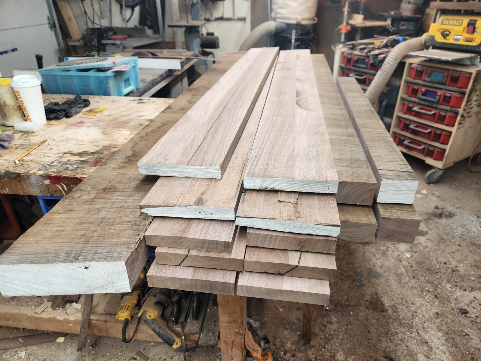

    Before and after resawing and planing all the roughcut walnut for my bed project. Gonna go for a Mid century modern kinda look. Need to glue up some panels for the headboard and footboard next week.

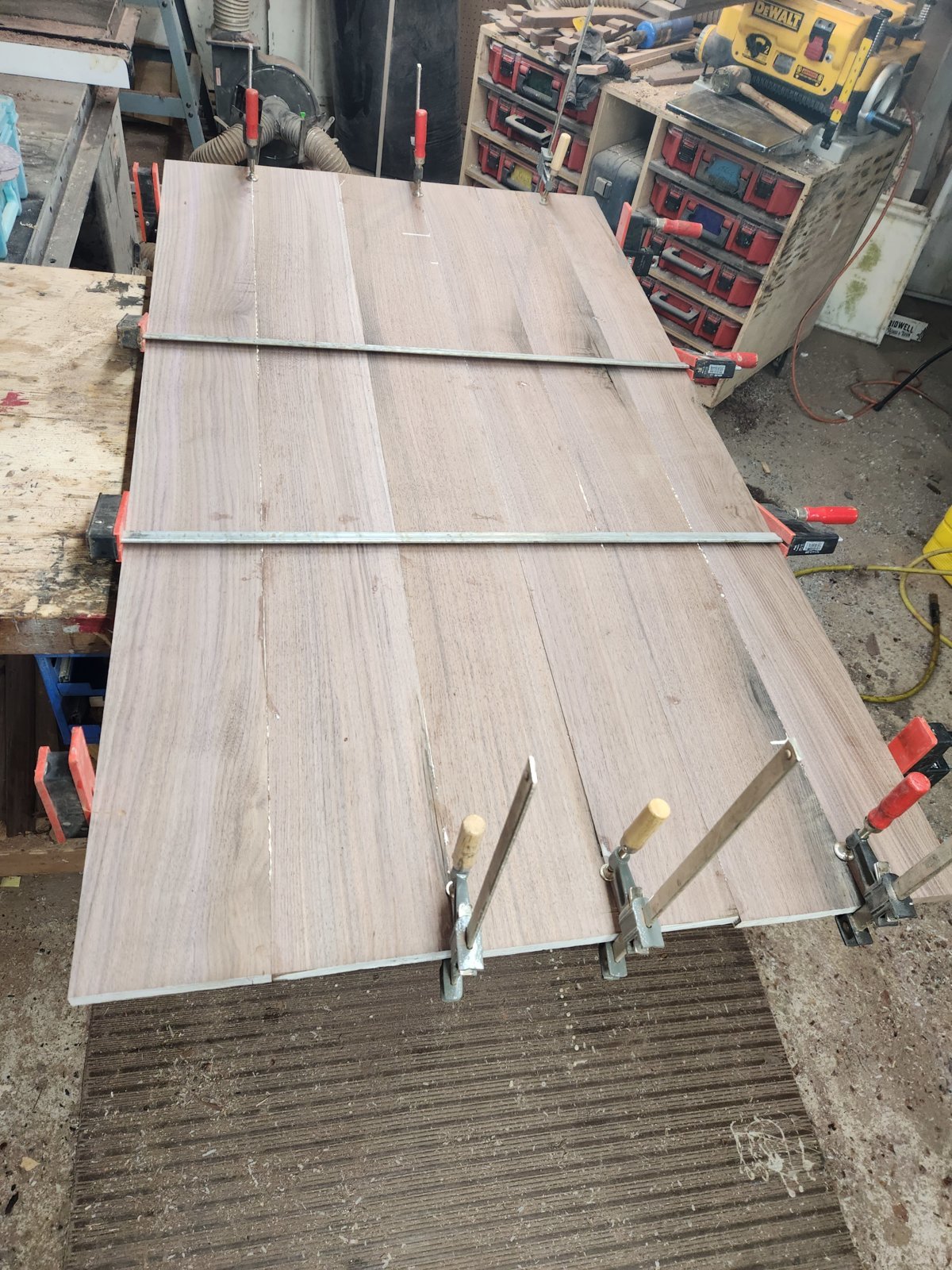

    Had the time and decided to glue up the headboard before the weekend. 4 parallel clamps and some.pony clamps on thr edged to keep the end joints straight.
