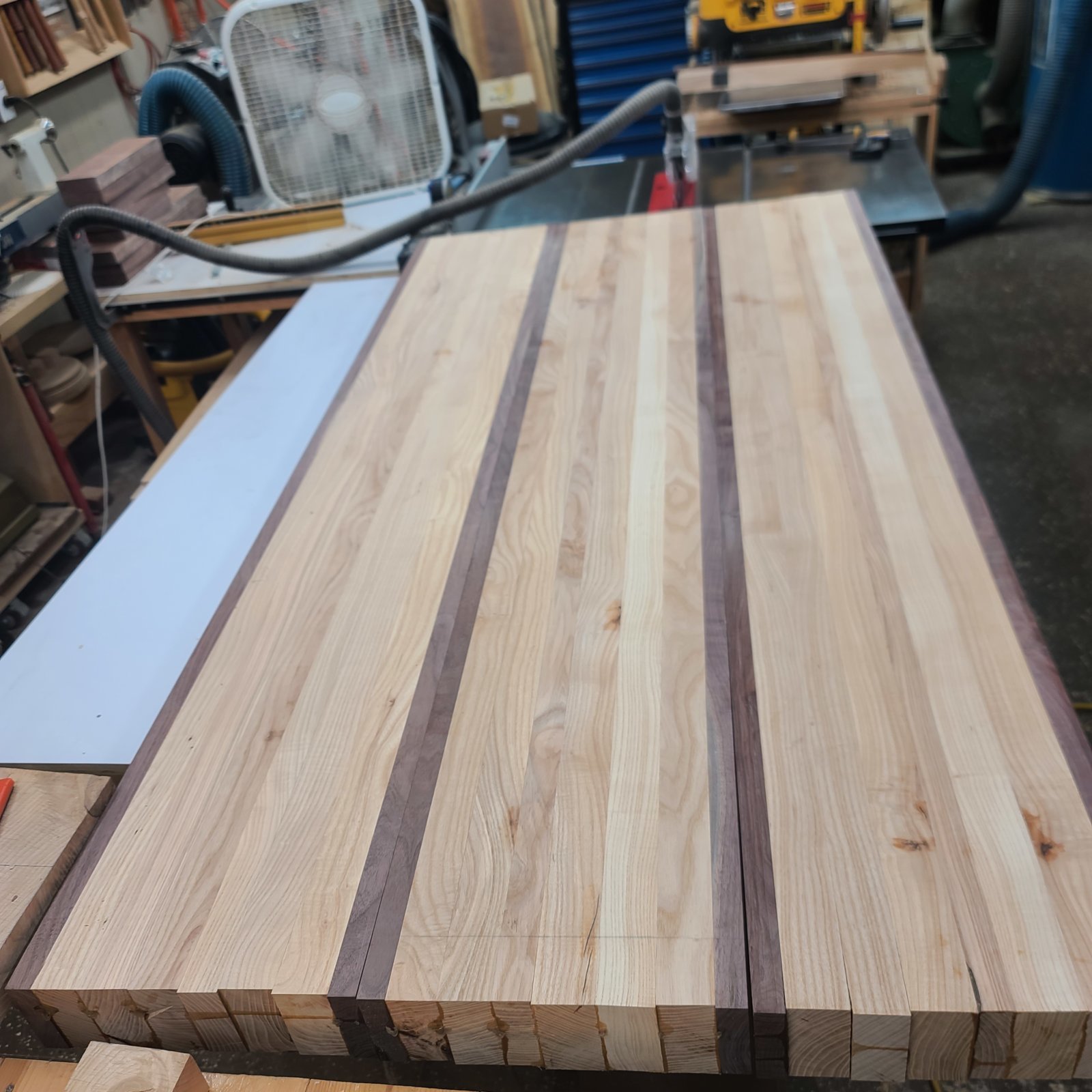

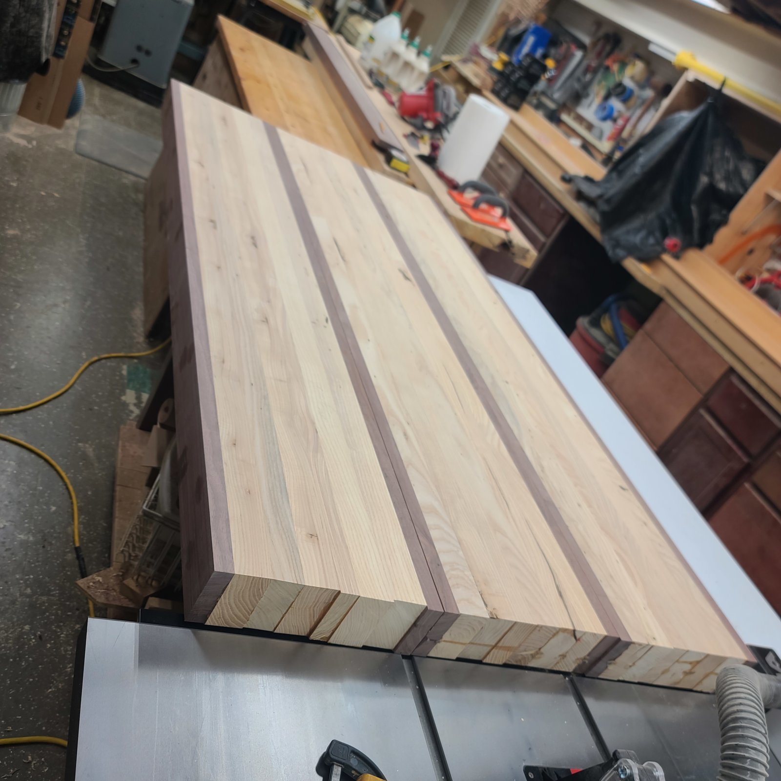

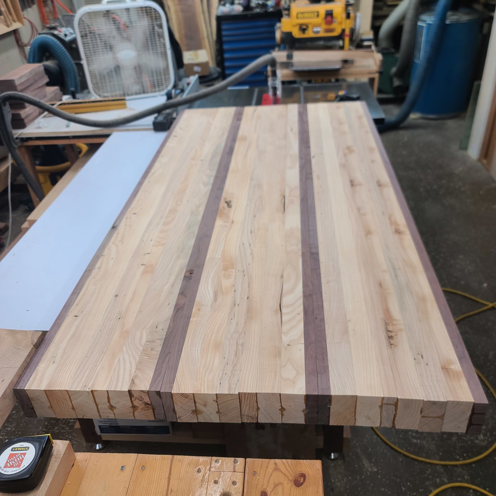

    Weell I finally got some shop time today and got the last section of the bench top planed.
    I then ran the other 2 sections through the planer for a skim cut to make sure they would all be the same thickness.
    This is the bottom.
    The top will finish up at 3' x 5'6"
    I filled any imperfections on the bottom with CA.
    And scraped it all level.
    The top side. The center sections of walnut will get 1 more pass on the jointer to make a nice tight fit.
    3 inches of each end will be cut off to remove snipe. It's almost unavoidable with sections this long and heavy with a bench top planer.

    It is amazing how the human eye can detect even slight imperfections in parallel, but cannot tell how far out. Makes the job of the creator even harder ... must still make it perfect. Especially with 3' x 5'6".

    And the funny thing is it will only be perfect once, it's wood and it will move.

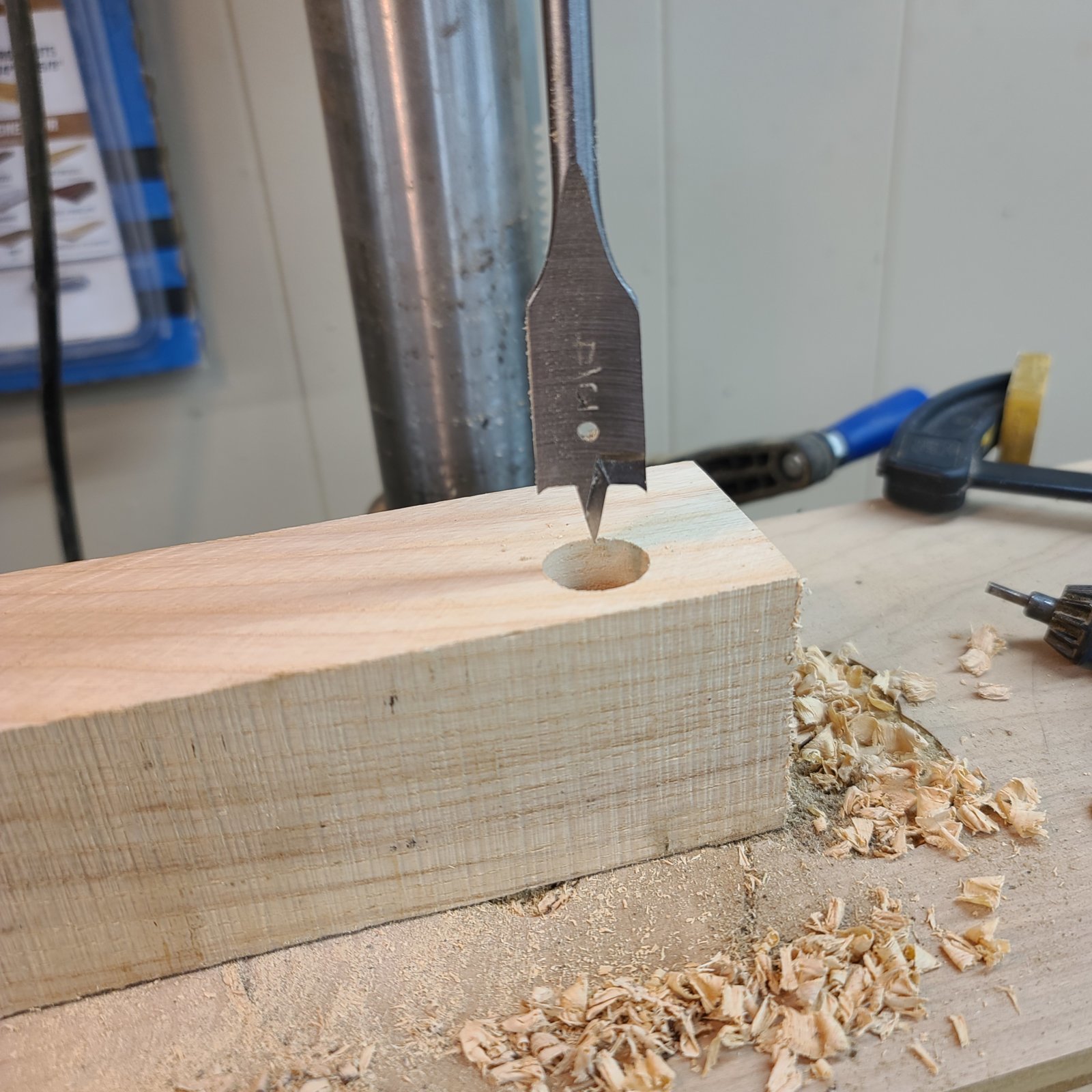

    Well I finally got some shop time today, I didn't really do any wood working but I'm prepping for that. I want the 3 sections of the top to stay separate but also be joined together for their combined weight. I want the top to come apart if I ever need to move the bench. So my plan to join the sections but not to glue them together is to use loose dowels. I don't have a festool domino so I'm going old school.
    Picked up some 3/4" oak dowels from the big box store.
    And I bored a test hole in some scrap ash so I could measure the hole.20231101_194926.jpg

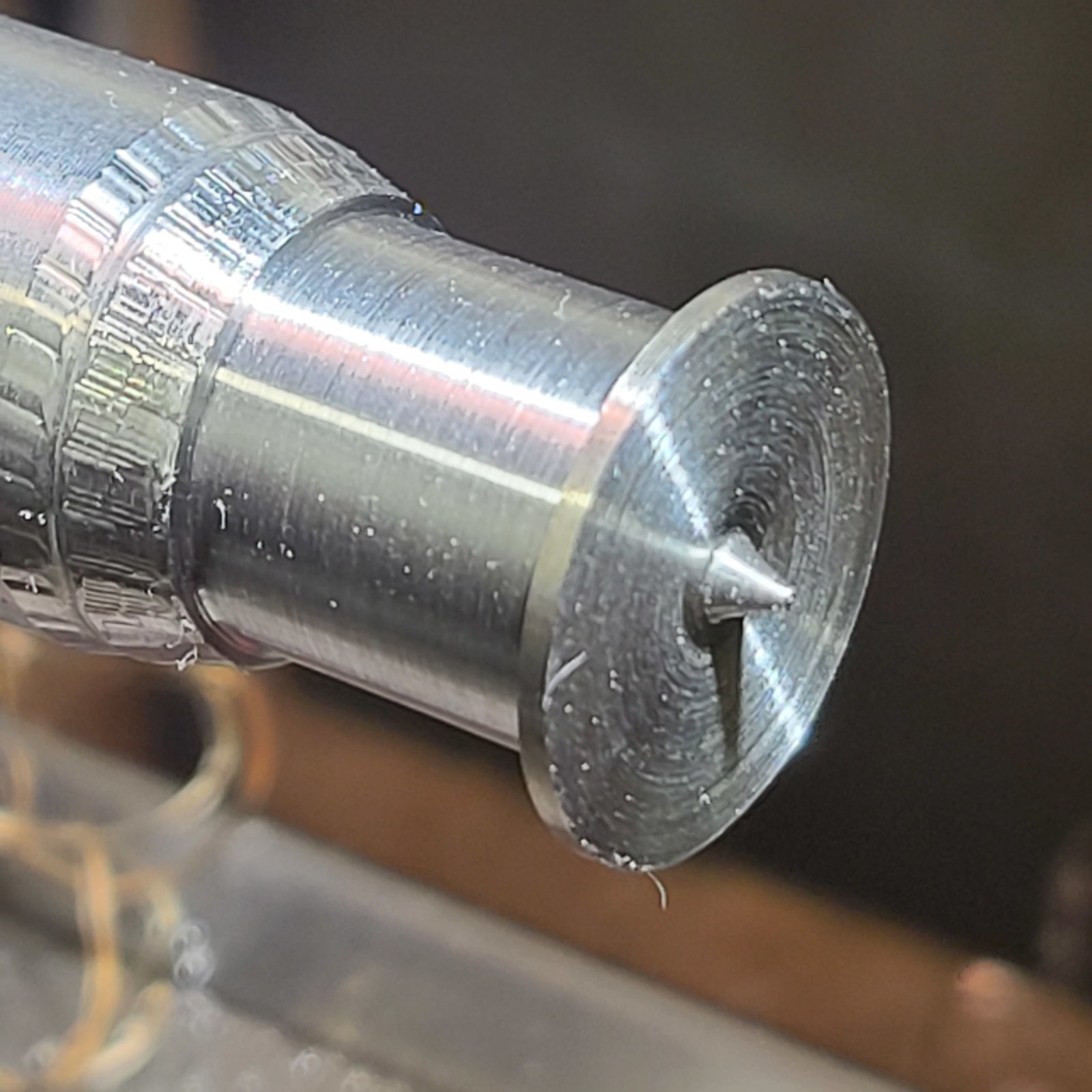

    The biggest dowel center I could find was 1/2" So off to my Southbend metal lathe I went, oiled her up and went to work. I chucked up a piece of 1" 304 stainless steel to make the 3/4" centers.20231101_195040.jpg
    Just enough point to make a mark for drilling.
    I think it came out pretty good. 1 down and 5 to go.
    So sometimes metal work crosses over into wood work. I enjoy both.
