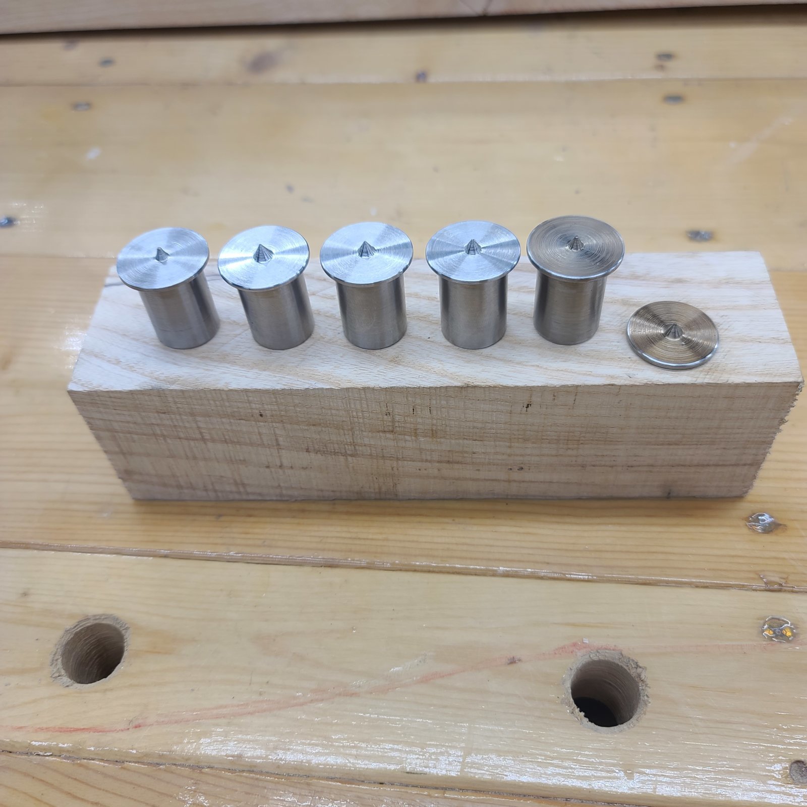

    3 done and 3 to go.

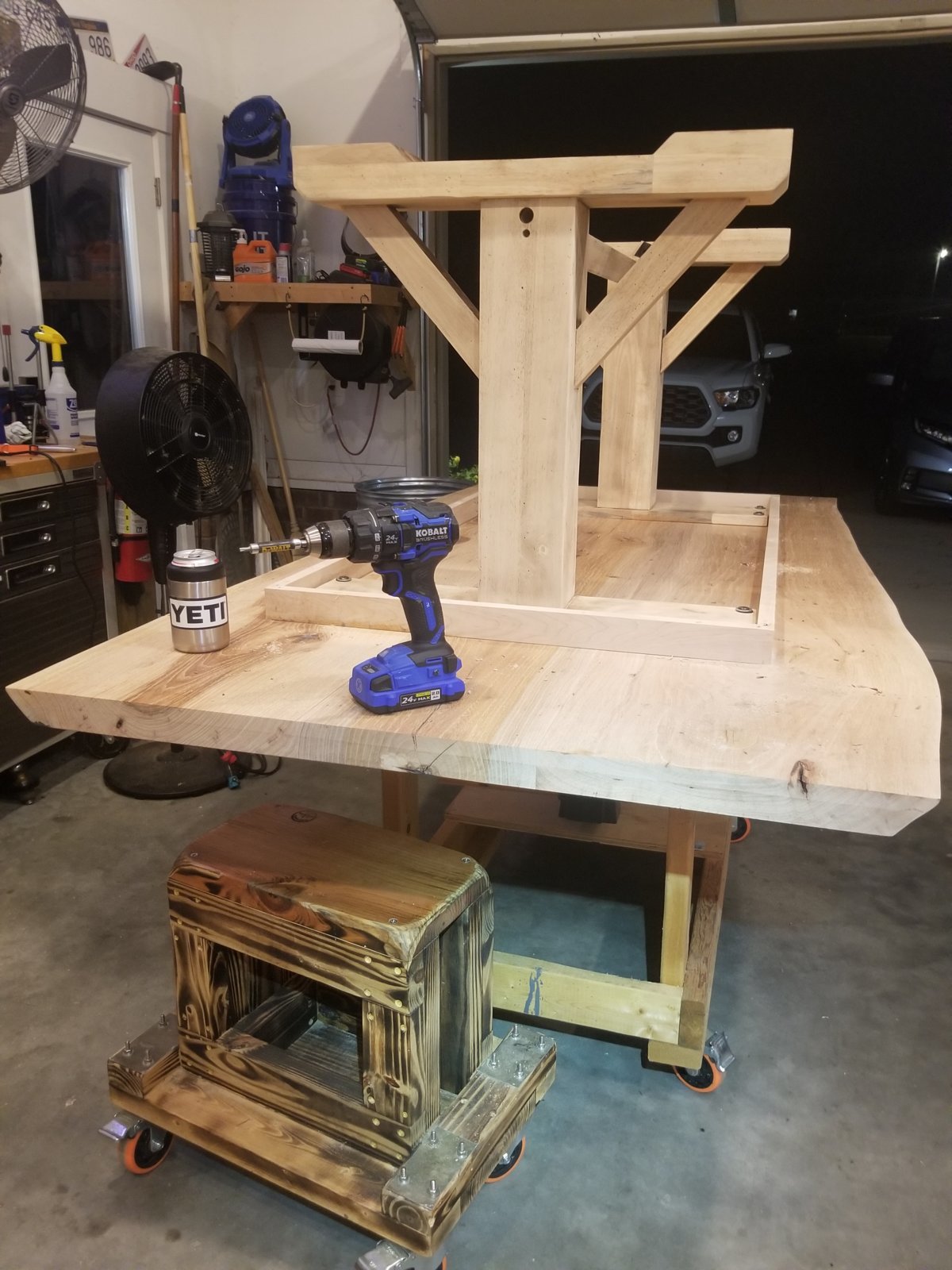

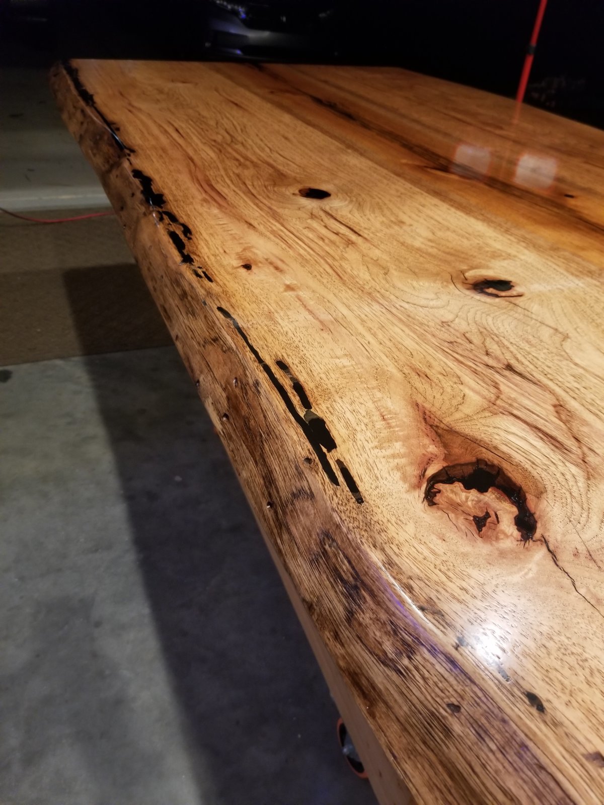

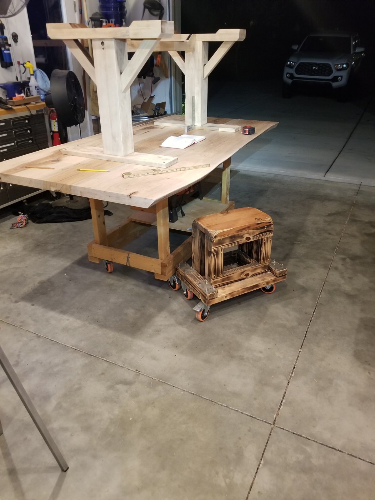

    Thanks. Years in the planning, and saving up. I build a lot of things in my shop, mostly wood, but this was a bit out of my wheelhouse.
    Here are a few more.

    And now you learned what you are actually capable of doing. Your a better wood worker than you give yourself credit for. Great job man.

    Thanks. The only real tense moment was when I was locating the barrel nuts for the leg tie at the bottom. Had to wallow a hole just a smidge. Great of it was just measure, cut sand repeat. Finish, which is what is judged by all non woodworkers, turned out great. I once had nine coats of polyurethane on a project that I wanted to stop at four. Last coat kept being trashy. So, i kept going and sanding until number nine looked good

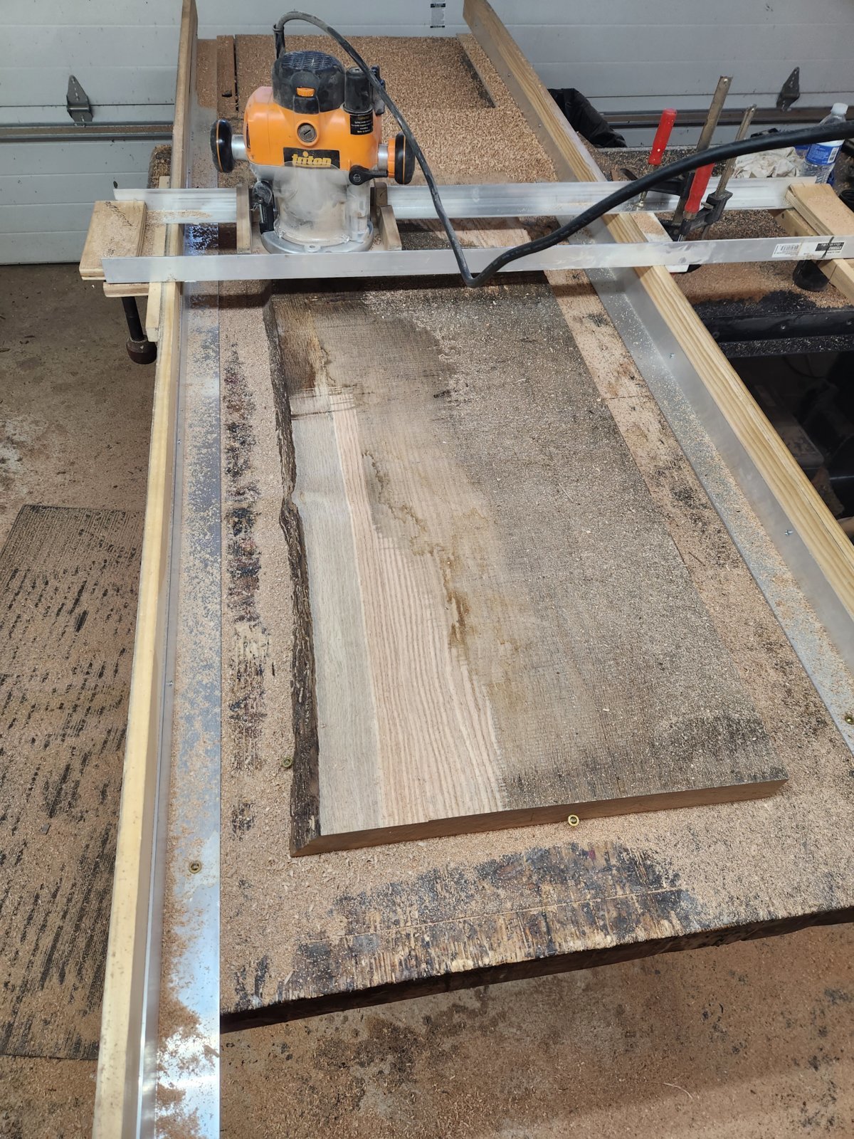

    Flattening a oak slab today for a custom bartop with my router sled.

    Building a hunting blind/house out of green (freshly cut) pine is totally acceptable but normally the rule of thumb is 1 year per inch of thickness. So a 2 inch thick slab will take two years of air drying. Where I live, NJ, acceptable moisture is around 10%. The red oak slab I'm flattening today air dried for 20 months and hit 12%, which for me is acceptable fior a rustic live edge bartop. It might move a little but but most slabs will no matter how dry you get them.

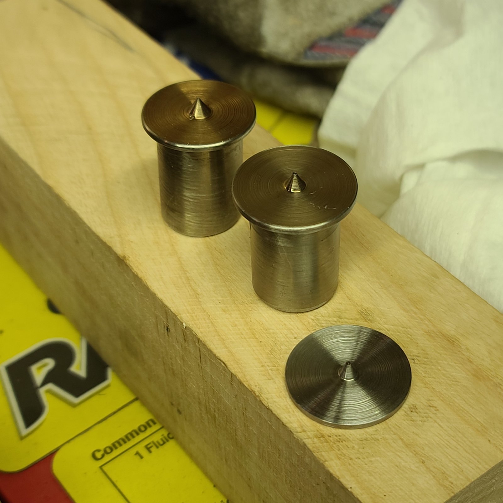

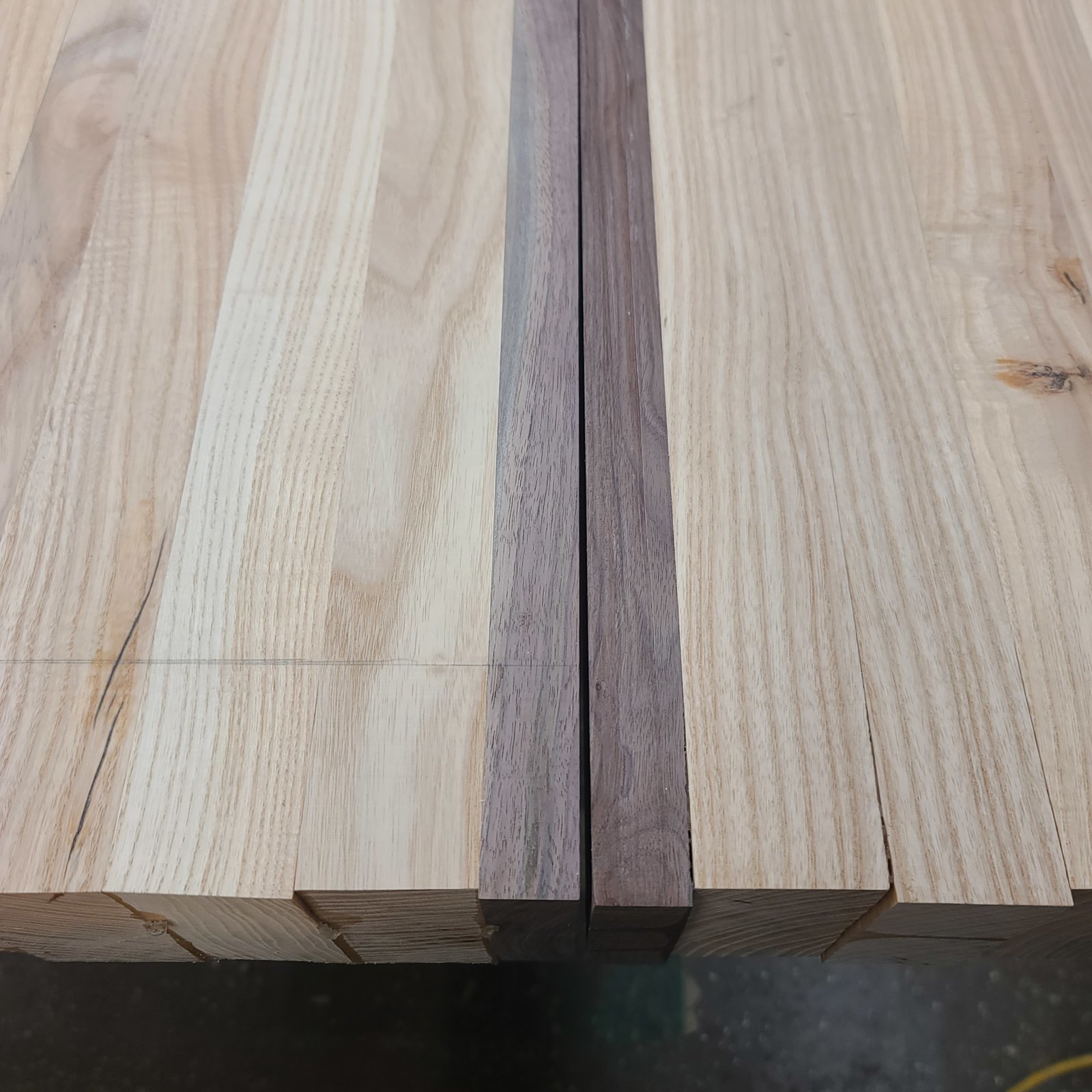

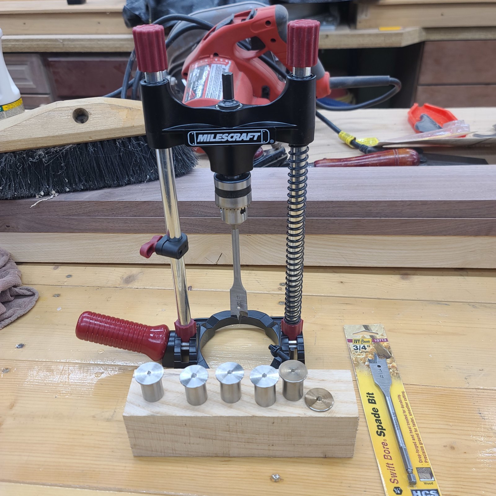

    Well I finally got the dowel center transfers made. These are stainless steel. It was fun running my old southbend lathe again to make these.20231109_170129.jpg
    I'll be using this milescraft drill guide to drill the holes for the loose dowels. Much easier than trying to wrestle the heavy top sections on the drill press.

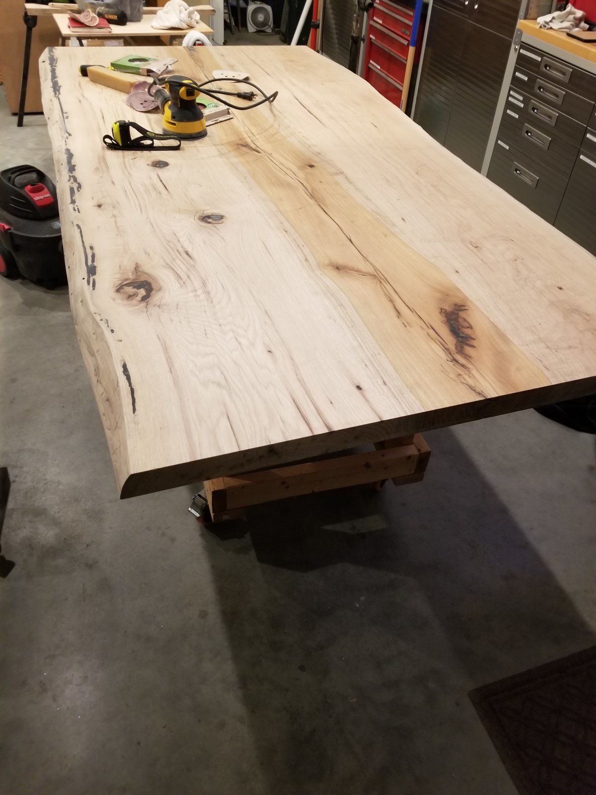

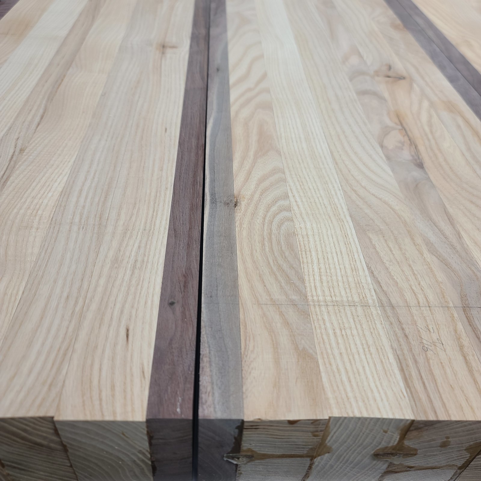

    So other various projects and duties have kept me out of the shop for awhile, that's actually a good thing as the top sections are moving a bit. Probably from the glue curing and moisture in the shop is low this time of year. Gaps have opened up about 1/8" on each end. A pass or 2 across the jointer will close it up and make everything flush again.
    I fully expect that the only time this will be closed up is the day I finish making it. After that there will be seasonal movement and I'm sure the seams will open up some, that's ok.
    The top will be a floating top for the most part to allow for the seasonal movement.
